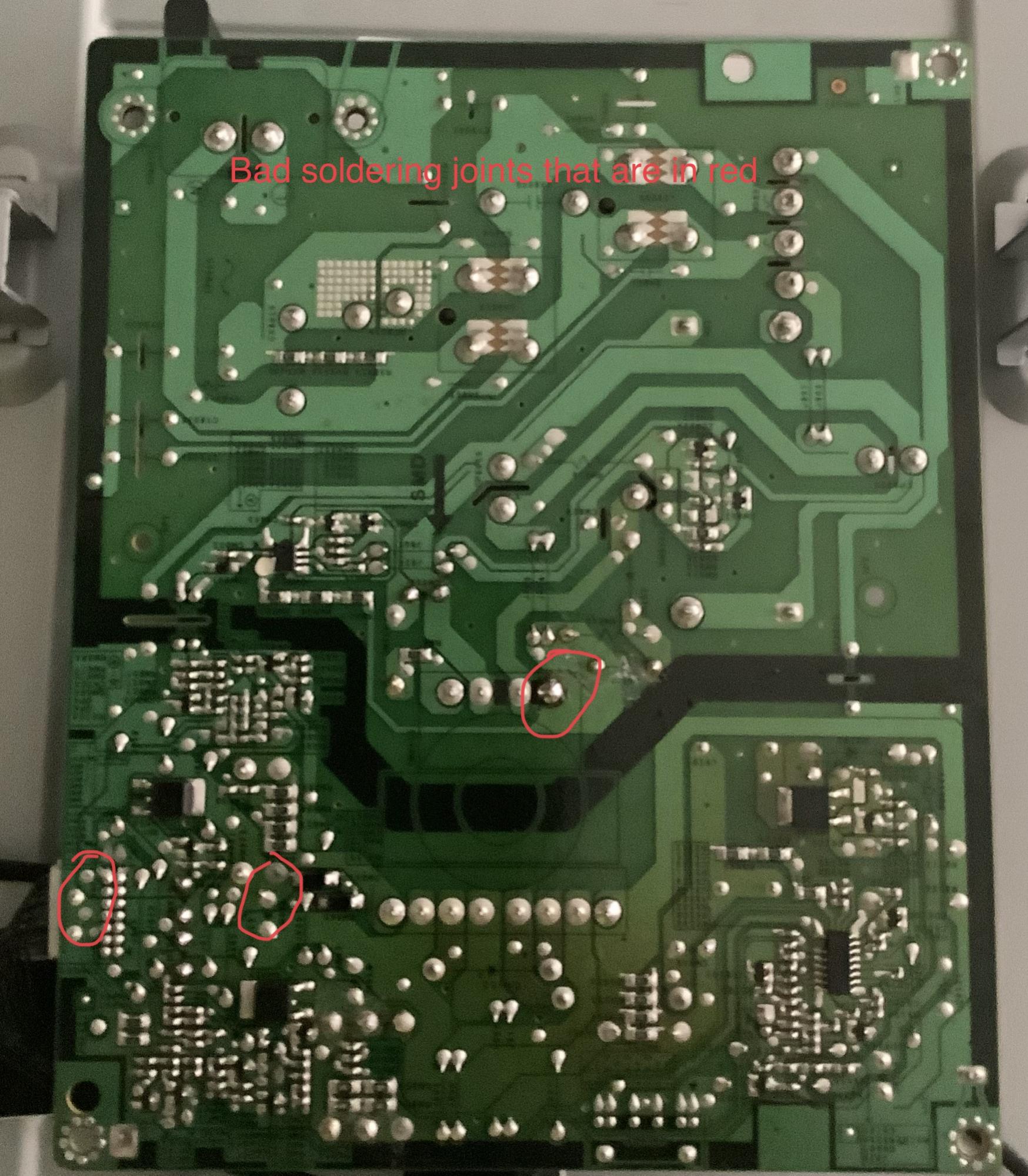

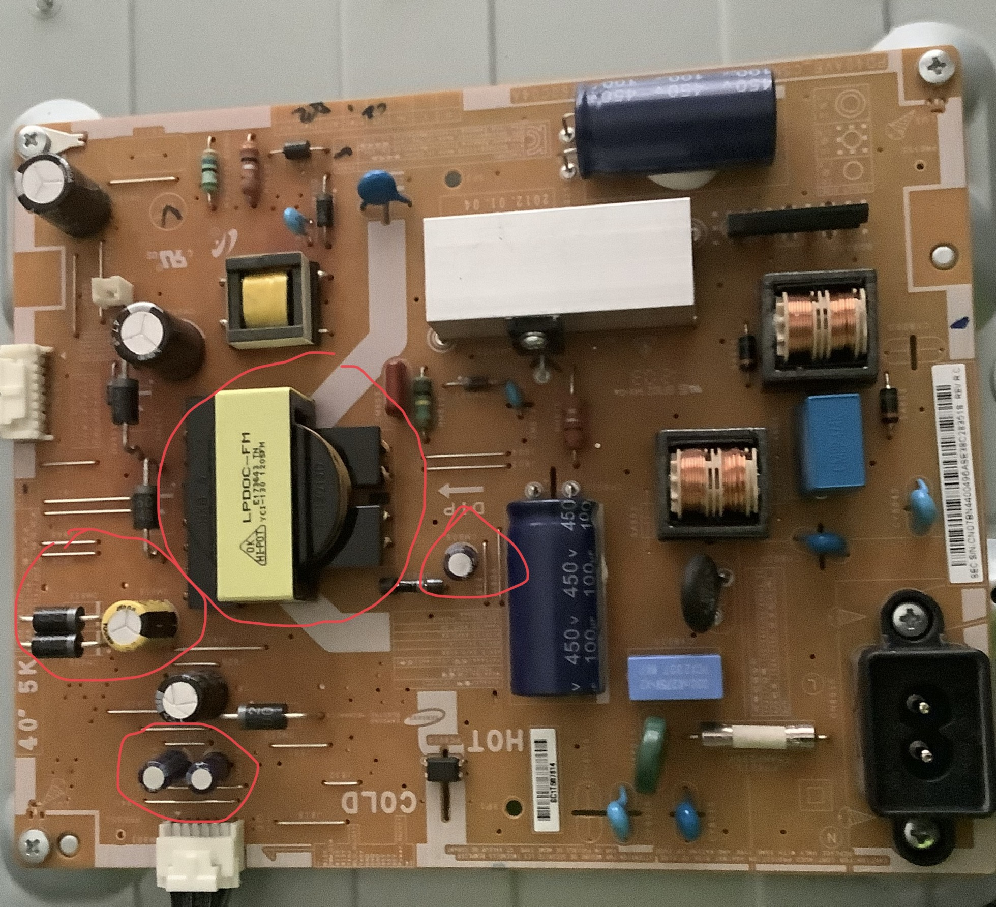

    My son friend has this tv and the issue with is it turns off randomly for no reason ( this is what was reported to me about what the issue is )
    Well I took off the back cover removed the switching power supply board and checked all of the 47uf@50 volt capacitor they all seem to have an ESR value of 0.24 and a new one has a value of 0.47 which to seem odd that all have values less than a new one has i replaced all four of them
    But this is not all I found
    First —>one of the switching power supply transformer pins had flux all over one of the pins so I heated it and even more flux came out of the soldering joint
    But this was not the only thing I found
    Second—>Two of power diodes all the pins had flux residue all over them and the same thing with these soldering joints more flux coming out from the soldering joints
    Really product quality control are real shit
    So far it has been running for about an hour now so let see what happens next

          I will take some pictures of both sides the board in question and point to each of the issues that I found these pictures are after it was repaired unfortunately I did not take pictures of it before I started the repairs because I was not completely aware of all of the issue with this TV set when my son first brought it home to me to look at it

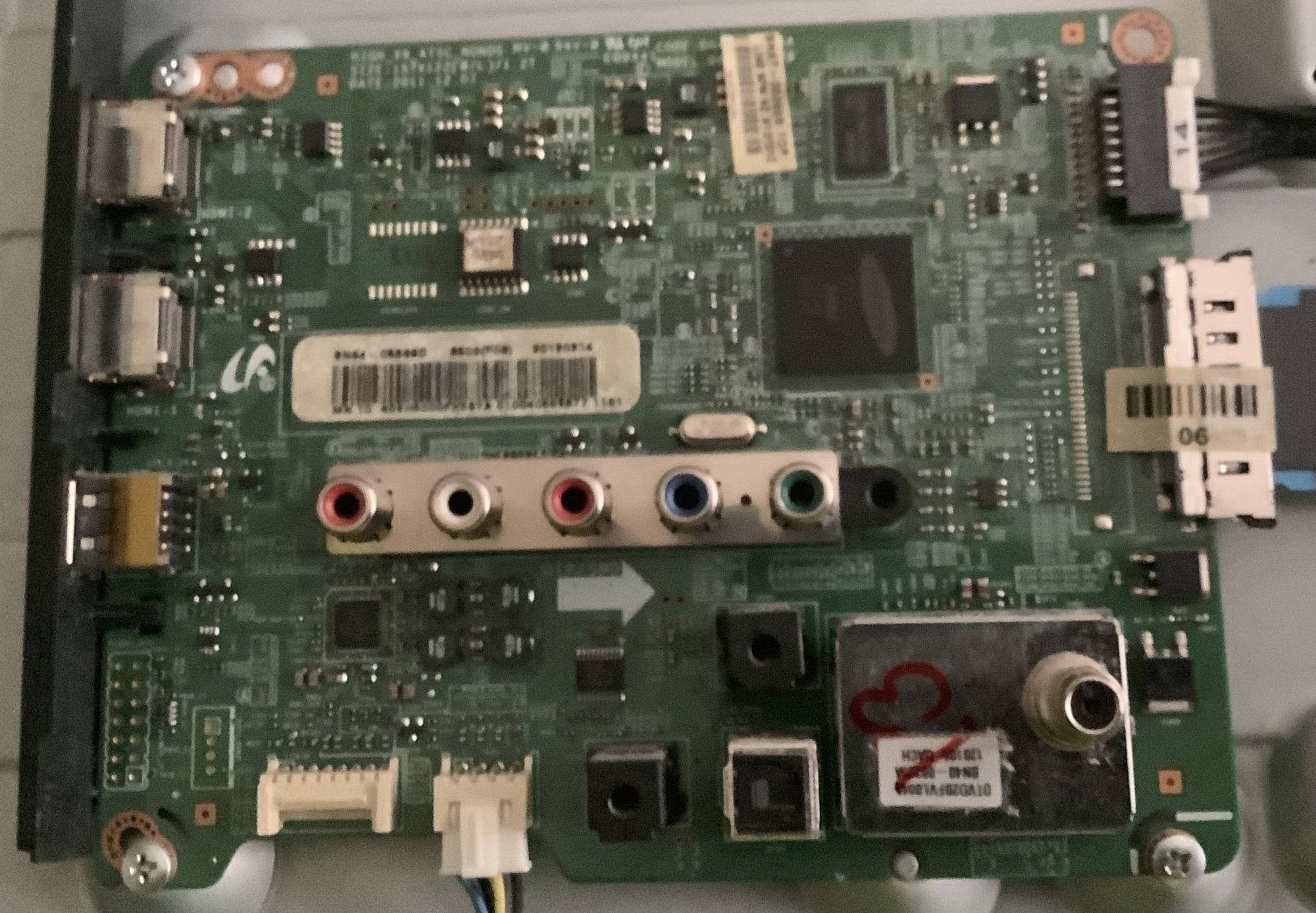

                Here are some pictures of this switching power supply board section of this tv
                It still has a good picture on the screen forensics files on Pluto TV channel internet streaming
                I have also ran it for over 24 hours in one session so it seems to be fixed correctly
                One note the other capacitors were not replaced because they seem to within reason for there ESR value for the UF value of the capacitor in question plus I did not have those capacitors in my stock pile on hand
