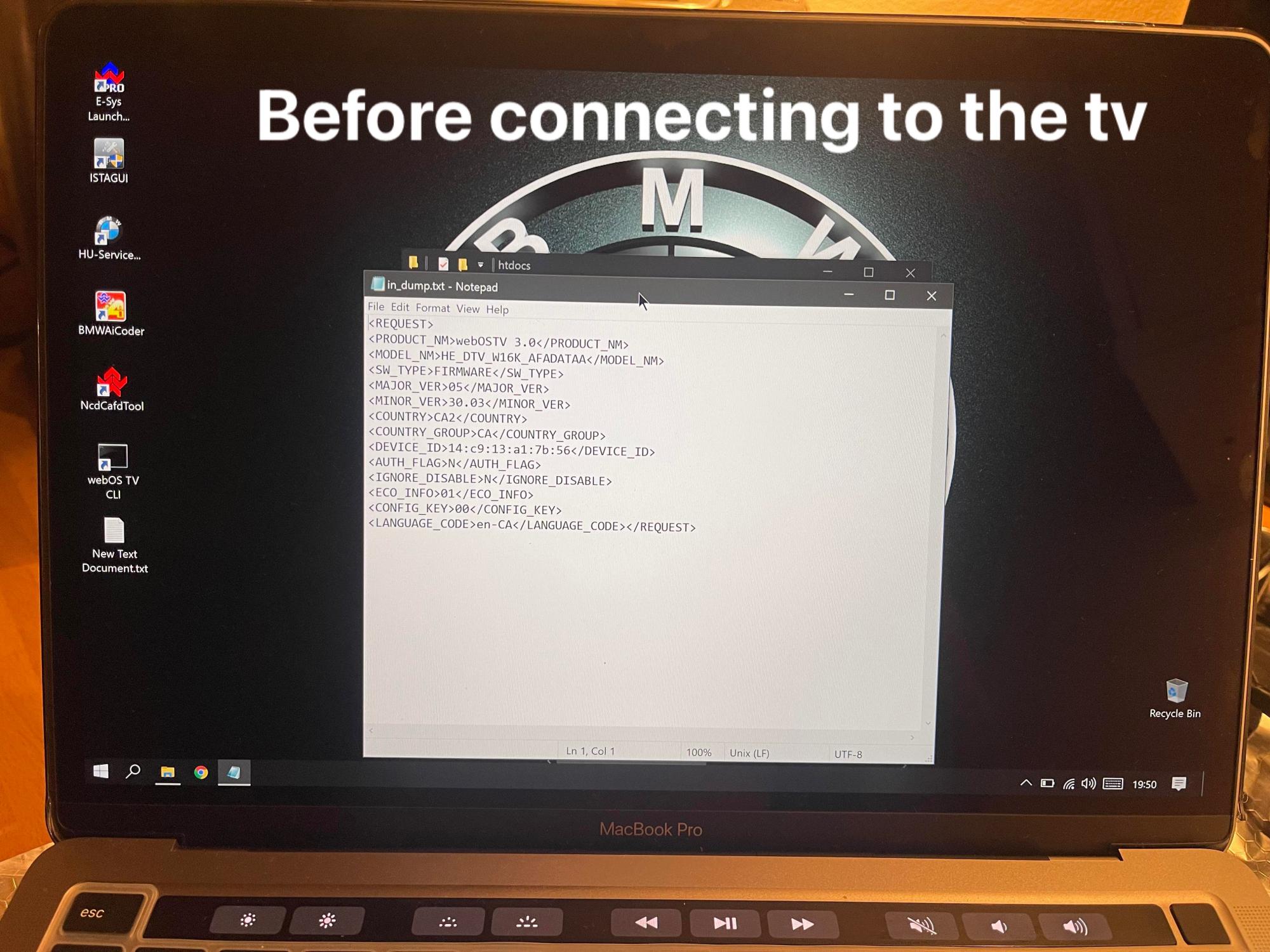

                #47
                Re: LG OLED 55EG9100 TCON troubles
                Originally posted by Diah
                here how to do in German language.. you can translate it to English via the browser. it is very easy.. attached also the Apache server.
                Nothing change in the ( in_dumb.txt ) the model_NM of the TV
                Everything it's done except in_dumb.txt

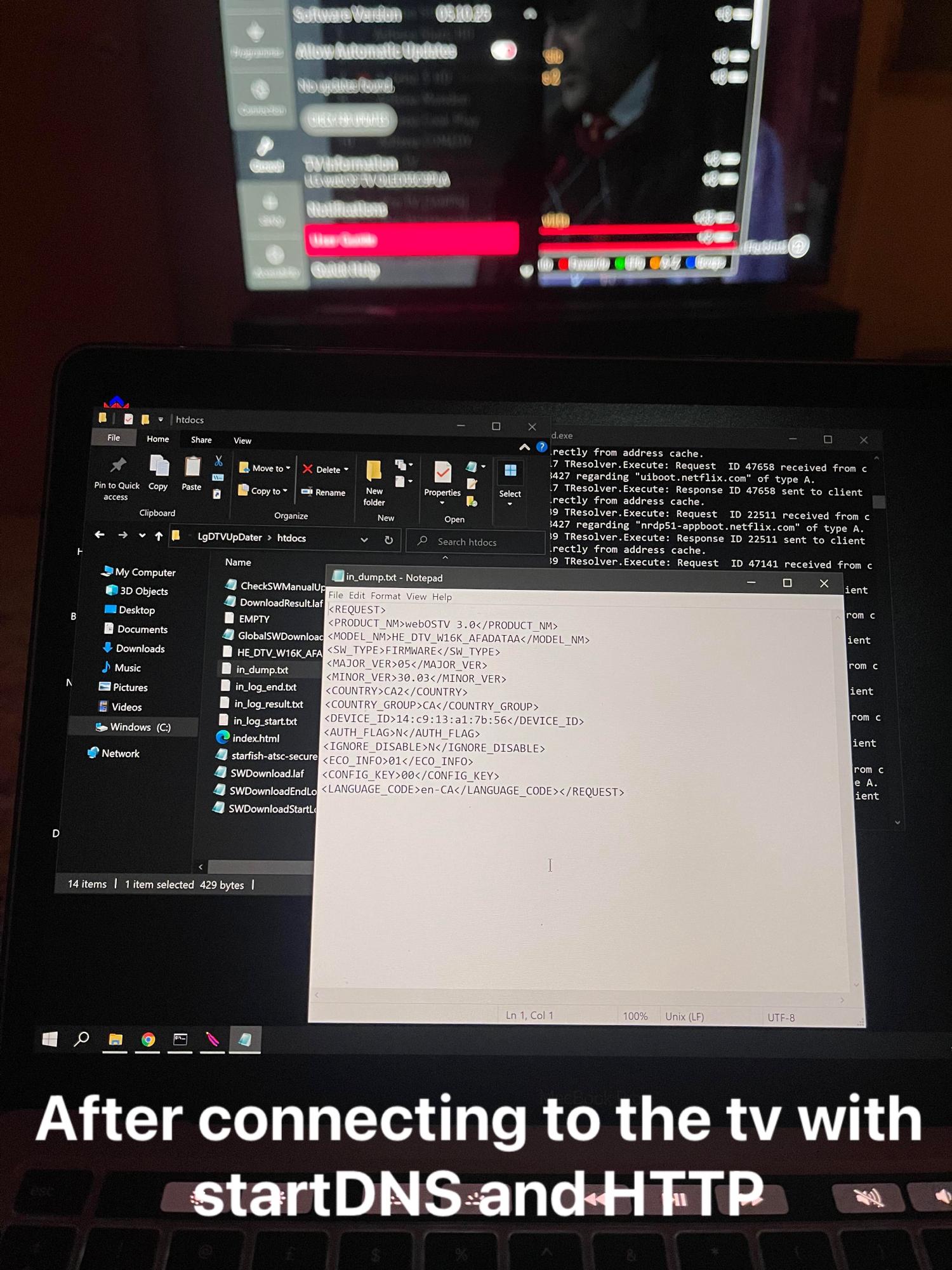

                • Diah
                  • Feb 2013
                  • 6357
                  #48
                  Everything it’s done except in_dumb.txt
                  in_dumb.txt is just quide to know the name of new file generated under C:\LgDTVUpDater\htdocs for exampel HE_DTV_XXXXX_XXXXX so look after which file generated new ... you will know this when your PC explorer setting can show the exit type of the file and date time stamp. also you can delete the perviouse in_dump.txt content it will generate new one

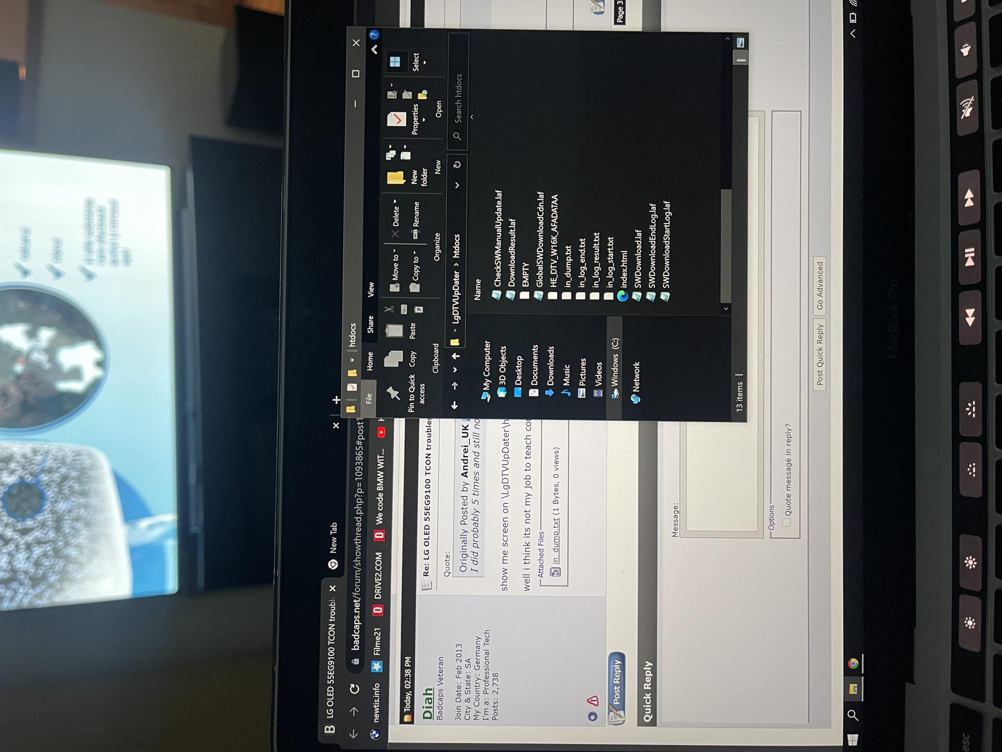

                    • Diah
                      • Feb 2013
                      • 6357
                      #50
                      I did probably 5 times and still not come up the model in the in dumb.txt nothing change on the files
                      show me screen on \LgDTVUpDater\htdocs show all files, or use this blank file instate the one you have
                      well i think its not my job to teach computer science over here.... or !!!

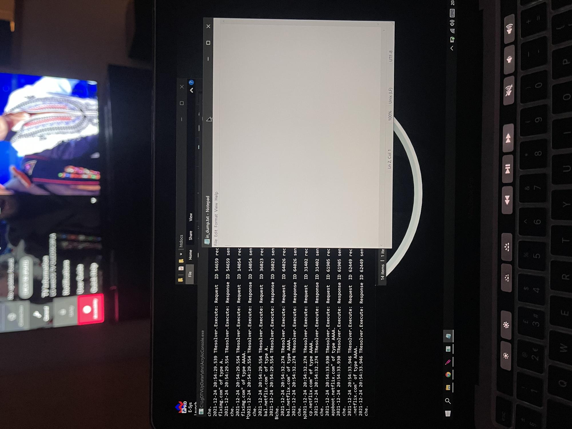

                      • Andrei_UK
                        • Dec 2021
                        • 30
                        • United Kingdom
                        #51
                        Thank you for taking from your time, but stii the same nothing written even on blank files

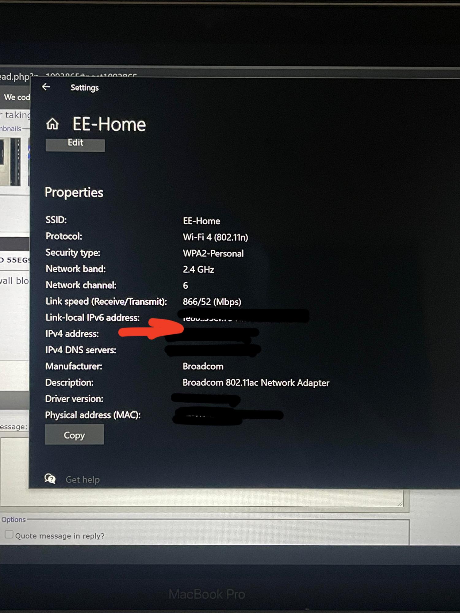

                          • Andrei_UK
                            • Dec 2021
                            • 30
                            • United Kingdom
                            #53
                            yours pc firewall blocking communication , or you write the ip gate way on the tv wrong
                            No luck same , I try wifi, wired connection same , I even try 3 firmwares and the original one too

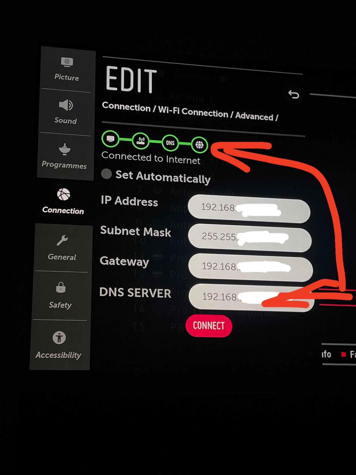

                            • Diah
                              • Feb 2013
                              • 6357
                              #54
                              with wifi never work... only LAN
                              GATEWAY --- yours PC IP
                              DNS Server ---- yours PC IP
                              yours PC should with LAN too
