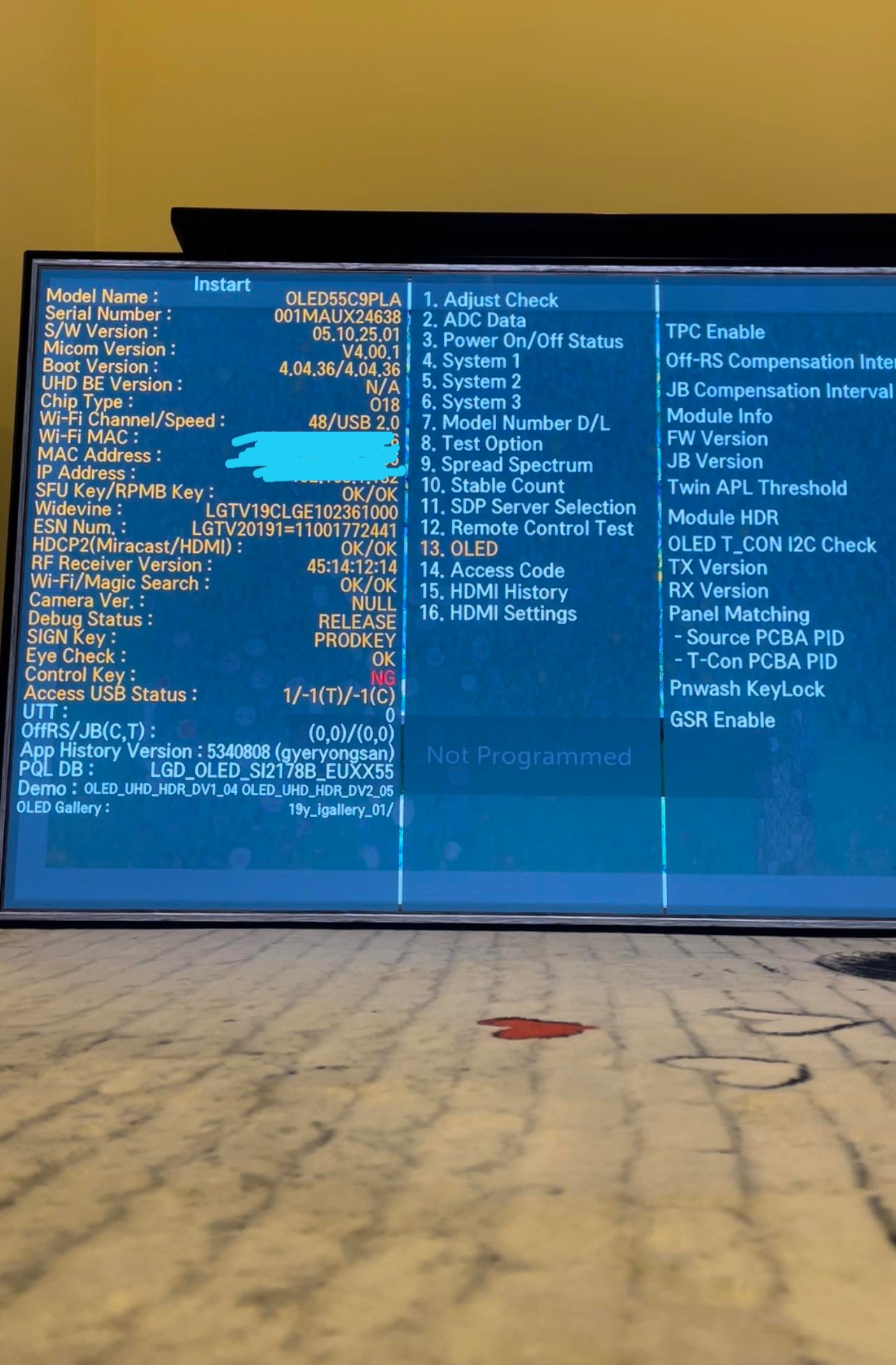

    Re: LG OLED 55EG9100 TCON troubles
    Originally posted by Diah
    can you show us here same page IN_START of the original T-CON in place ?
    did you sent IN_STOP before while original T-CON in place ?
    Hi , I remember now that I did update to last version firmware when I fix all the parts ( new motherboard, new T-CON from broken screen tv ) to the panel with the T-CON that switch off after few sec with messages in IN-StART “power_off_due_to_cooling”.
    I did IN-STOP after few refresh pixel and nothing changes from the vertical bands
    If I swap the old T-CON even with his original motherboard or new motherboard will work but like I said it's switch OFF after 30 sec
    See pic attached with the good panel and new motherboard + OLD t-con

        • Diah
          • Feb 2013
          • 6614
          Originally posted by Andrei_UK
          I did IN-STOP with the Original T-CON then boot restart and same as usually turn off tv ( POWER_OFF_BY_COOLING(0x65) message on IN-START at Power ON/OFF status
          it tell the story from yours last IN_START photo.. the old T-CON matching with Panel. the new one was NG also the interface of the new T-CON are different from the old one. wait of yours USB JTAG and do the eeprom work or downgrade

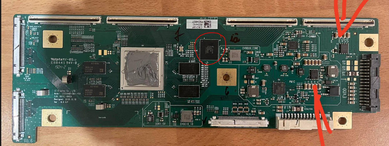

              By the way the eeprom chip it the one i made a sign?
              • Diah
                • Feb 2013
                • 6614
                read the lable of it and you will know for sure

                  • lotas
                    • Jan 2016
                    • 4899
                    • Russia
                    #29
                    The photo does not show the EEPROM, what you labeled as mosfet transistors.
                    The only chip where the firmware is located in this photo is U3 (NAND or EMMC), the marking is not visible in the photo.
                    • Andrei_UK
                      • Dec 2021
                      • 30
                      • United Kingdom
                      #30
                      Hi , thank you, for confirming that, that makes hardly now to read data from the NAND I didn't see in the pic for NAND reading device in the one I just order for eeprom chip
                      Any easy ideea how to copy data from the one you said? Thank you
                      • lotas
                        • Jan 2016
                        • 4899
                        • Russia
                        #31
                        Maybe something is on the back of the T-con.

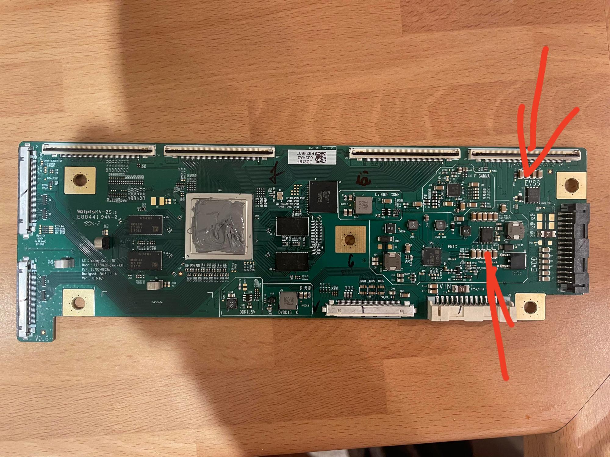

                          • Andrei_UK
                            • Dec 2021
                            • 30
                            • United Kingdom
                            #33
                            No luck to be flush the NAND the chip looks to sensible to be unsoldered and re soldering
                            I m still searching what parts from the old T-con made to turn off after few sec probably by any parts getting to hot and then go to protection mode , what about the MOSFET ? Can be the problem?
