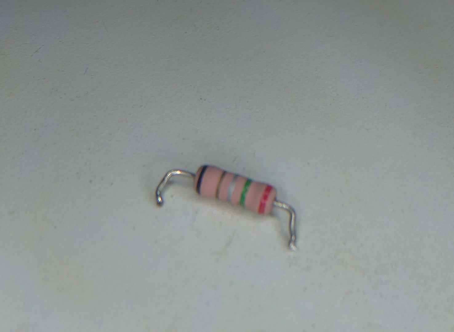

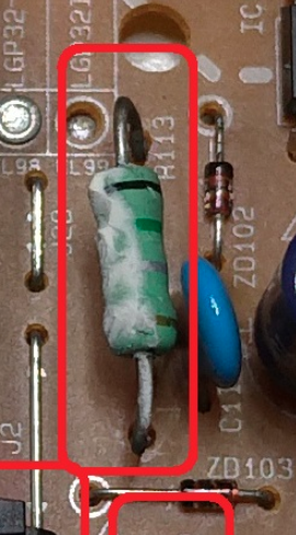

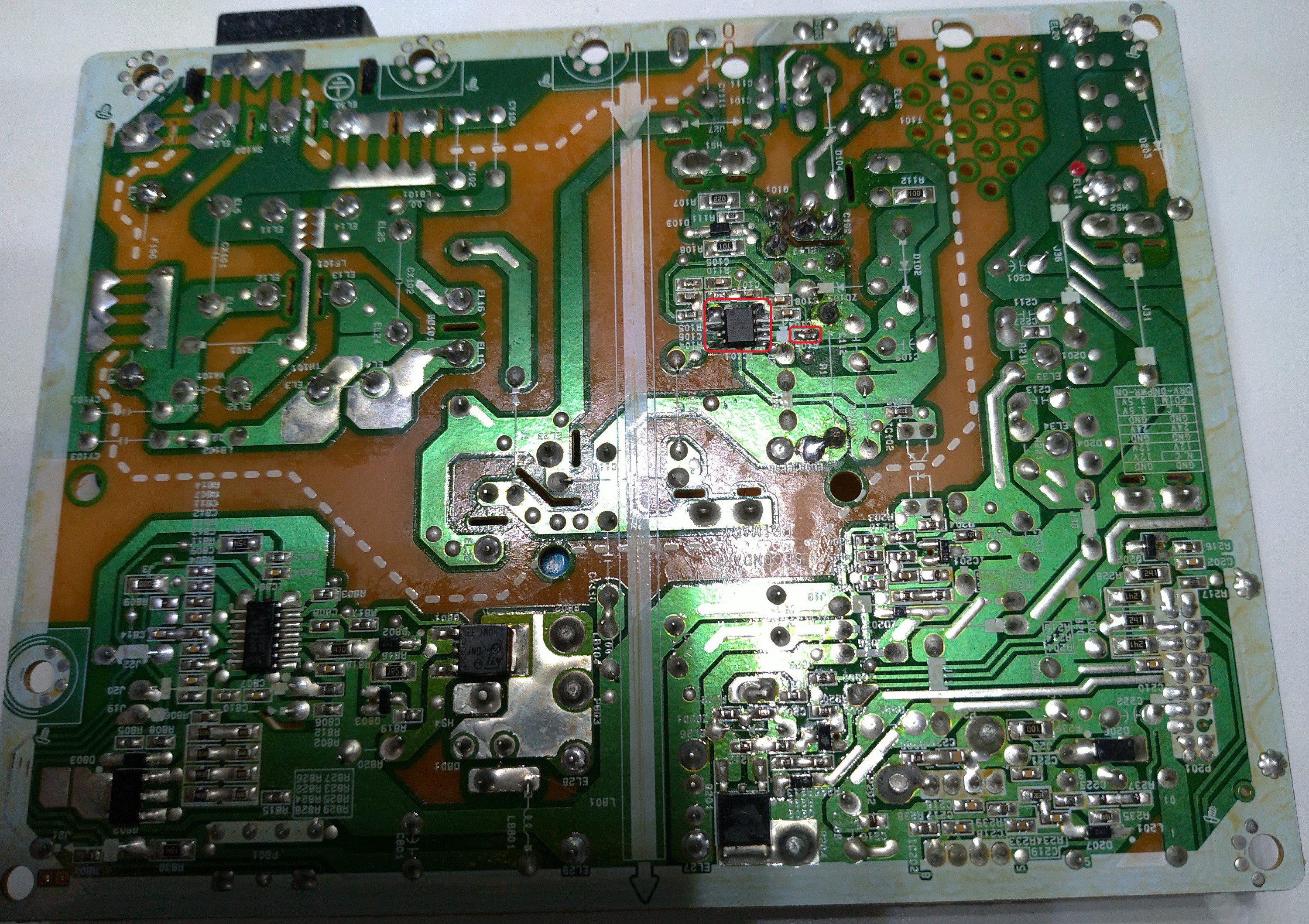

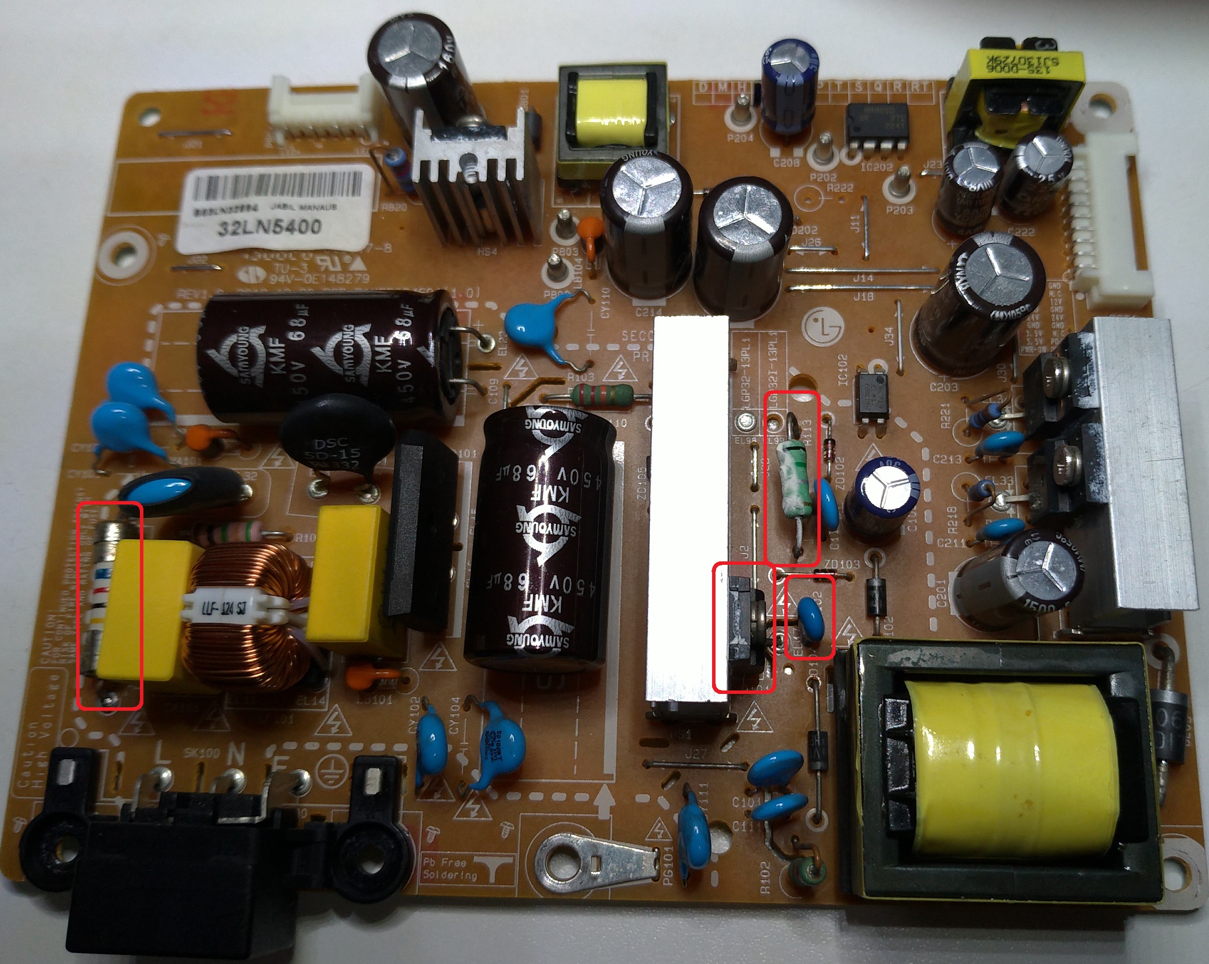

    TV was on and the owner heard a pop, the power supply 331J 1kV cap blew up and damaged the main mosfet, resistor, main fuse and the PFC controller.
    The MOSFET was an 11A 650V MOSFET, I put an 11A 600V which is the closest I have, the resistor color code was not standard, I replaced with another one from another LG PSU PFC section, it's less than 1 OHM, seems to be called rOCP.
    Now it powers up and LEDs + Mainboard works fine but with a hellish noise like coil whine, it is coming from the primary, from the transformer or the inductor, it's not bad soldering, the thing is, when powered up the voltage on main caps are 262~280V, strangely the tv works like that, this TV should have PFC, it's not boosting, the only thing different now is the rOCP and the MOSFET.
    I circled the components that were exchanged in the photos. The photo of the lone resistor is the original rCOP that went open.

    Power schematic LGP32-13PL1

          You need to install a proper 0.25Ω resistor, 1Ω is too large and will upset the ocp of ic101

            From the photo it is already 0.05 Ohm, +/- 5%

              The last black band is what caused this, it has no purpose in the resitance value or tolerance.
              I've fixed it, it was the resistor R113, supposed to be 0.25Ω, the one I wrongly replaced was 0.05 Ω, the PFC could've blown up from the overcurrent, I did a parallel association between an 0.3 and 2.2Ω, ended up with around 0.26, that was good enough, TV is fine.
              List of parts replaced:
              Q101 MDF11N65B
              C102 330pF 1kV
              R113 0.25Ω
              R106 220Ω
              F100 5A
              IC101 Sanken SSC1S311A

                The black band on the end usually means non-inductive.
                With the wrong value resistor, the ic would be operating in the wrong mode, this would result in the noise from the transformer.

                    Hi, old thread bump but what type of resistor is this?
                    Is it a wirewound resistor or metal film resistor?
                    Does it matter if a metal film resistor is used?
                    Also is it a 2W resistor?
                    Thanks :-)
                    Edit ok going by that schematic file it's a wirewound resistor :-)

                      it was a 2W resistor, standard type? don't know the material.

                        Been told it should be a fusible resistor

                          If you use a wire wound it should be a NON-Inductive type as well
