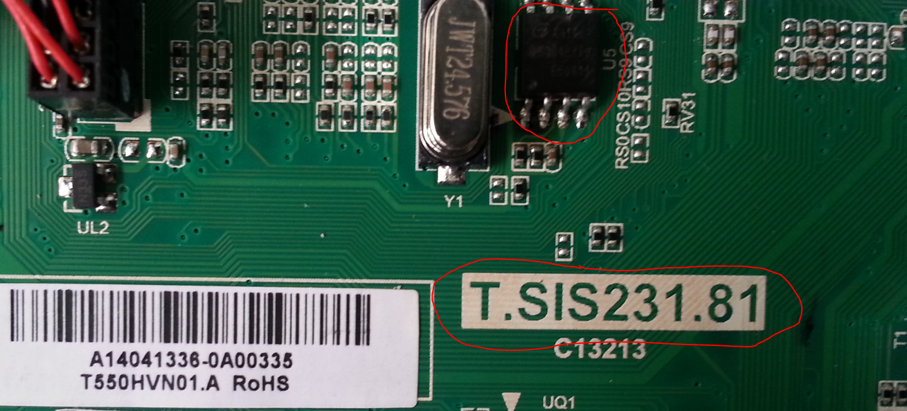

    Hi guys,
    I have a Teac LCD [Model: LE5050FHD] with an issue.
    As soon as it's powered on, the TEAC splash screen loads and then the green power light flashes from green to red over and over for 10 or 15 seconds. The TV then restarts. This loop seems infinite.
    I cant seem to find any firmware for this model to update, if is does exist.
    Whats the next step? Take the back off and look for blown transistors someplace?
    Thanks in advance,
    Steve

    Re: TEAC LE5050FHD LCD TV red/green light
    Do you have a chassis (Main Board): T.SIS231.81?
    You have a programmer, you need to reprogram the spi flash W25Q64.
      Thanks for the pic, ill open it on the wekeend and have a look.
      How does one go about reprogramming it?
        Steve
        Using the programmer.
          Steve
          I dont know what a programmer is. I'm assuming it's some sort of device? Please enlighten?
