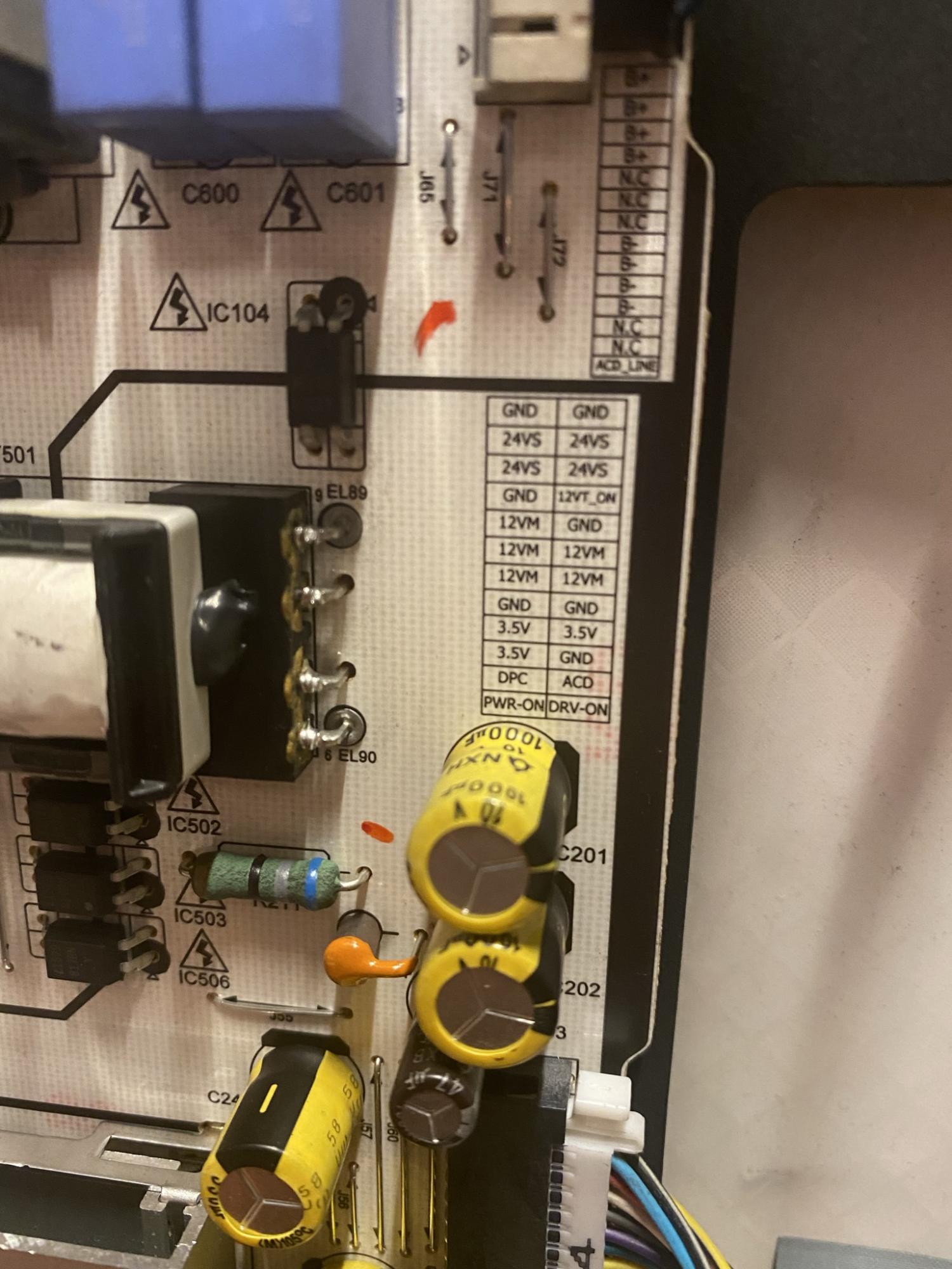

              Re: LG OLED Problem 55EG960V
              Just to clarify, i mean supplying power to tcon, so i guess 12v+24v, and nothing other
              to take those tensions by the internal PSU you must turn on a pair of control signals.
              So post a photo of serigraph tables around connectors on PSU..
                Sure here is the pin out to the main board connector
                  Just put a jumper 3,5v-PWR-ON-DRV-ON-12VT-ON
                  post PSU model number

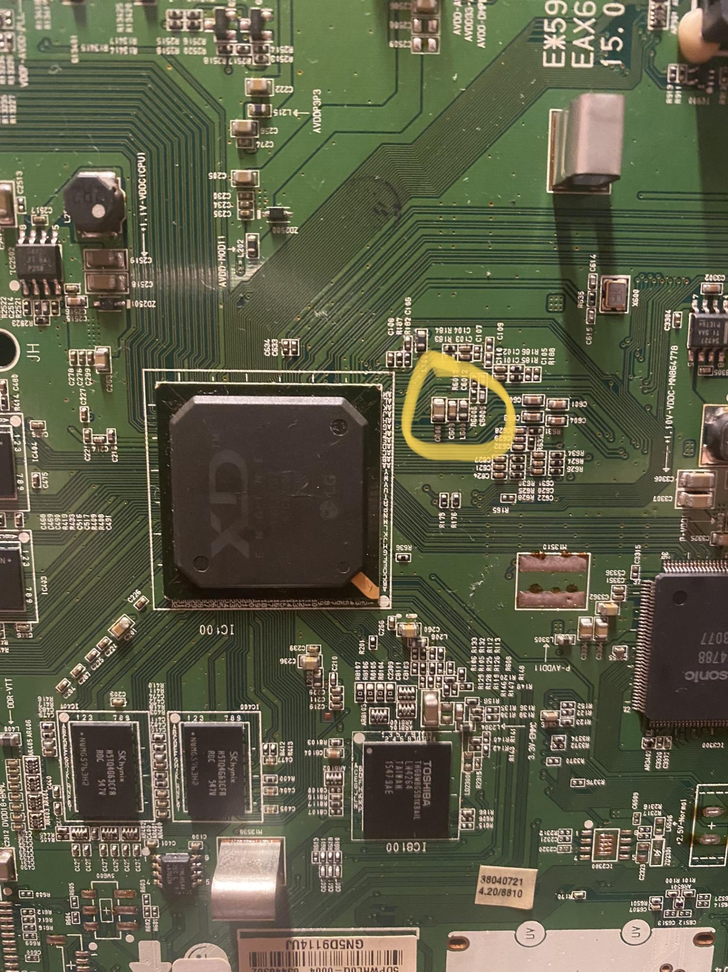

                                Well I know there was no physical damage to the display it just started off with a garbled image on HDMi and the apps and then not powering up.
                                So I would say the main is the problem.
                                But I can’t source one to test.
                                I’m still trying to find someone to reball the cpu
                                But I have found some dead shorts coming from the cpu on several caps
                                  How do you know if them comes from CPU without a schematic? If you think that you can post photos of what you are measuring but I'm convinced you are wrong due to the progressive damagement
                                    The sectioned circled is where I find the dead short to ground
                                      Check if the top 3 terminals of those components and bottom 3 are connected together..
                                        The bottom ones are all connected to ground but the top ones on the first two are not.
                                        But the 3rd one is grounded
                                        Both sides
