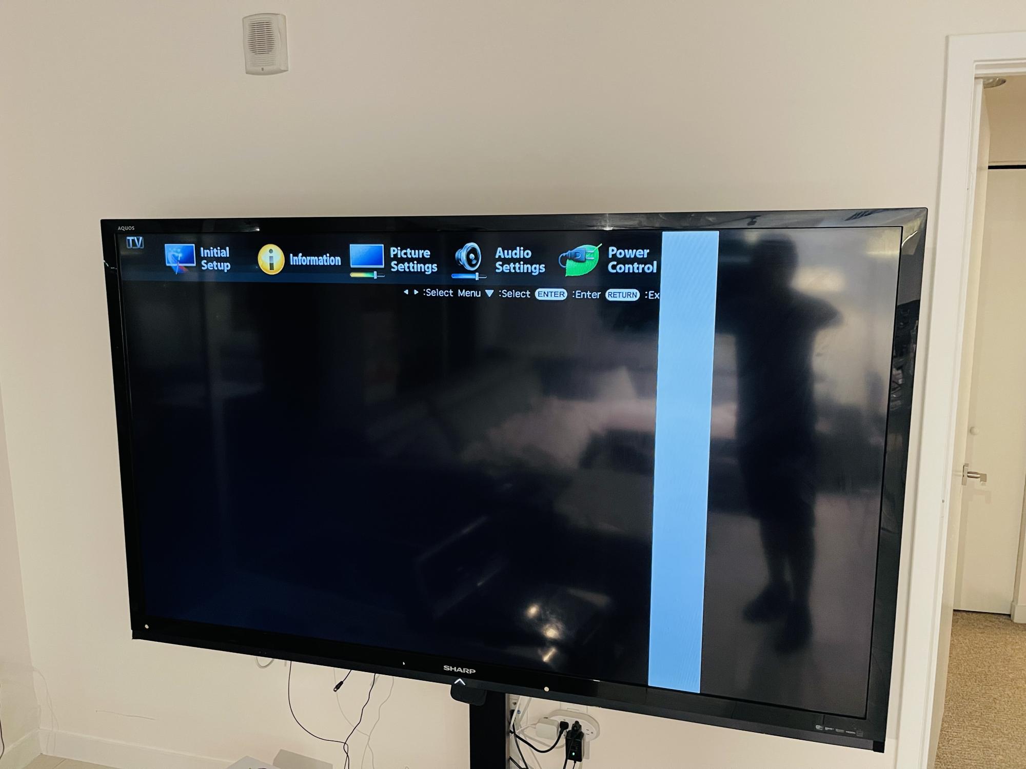

    Sharp LC-80LE632U T-con? white stripe?
    Hi guys- does this look like a bad t-con board to you? It weird that it is only 1/4 the screen and not 1/2. I don't want to order the board without you guys looking at it since I'm a novice.

    Re: Sharp LC-80LE632U T-con? white stripe?
    Don’t think it’s a tcon issue. Looks like one of the panels Cof tabs is damaged. Pretty much non repairable without expensive specialized equipment.
      Originally posted by Storyteller12
      Don't think it's a tcon issue. Looks like one of the panels Cof tabs is damaged. Pretty much non repairable without expensive specialized equipment.
      My thought too. Thanks for looking!
