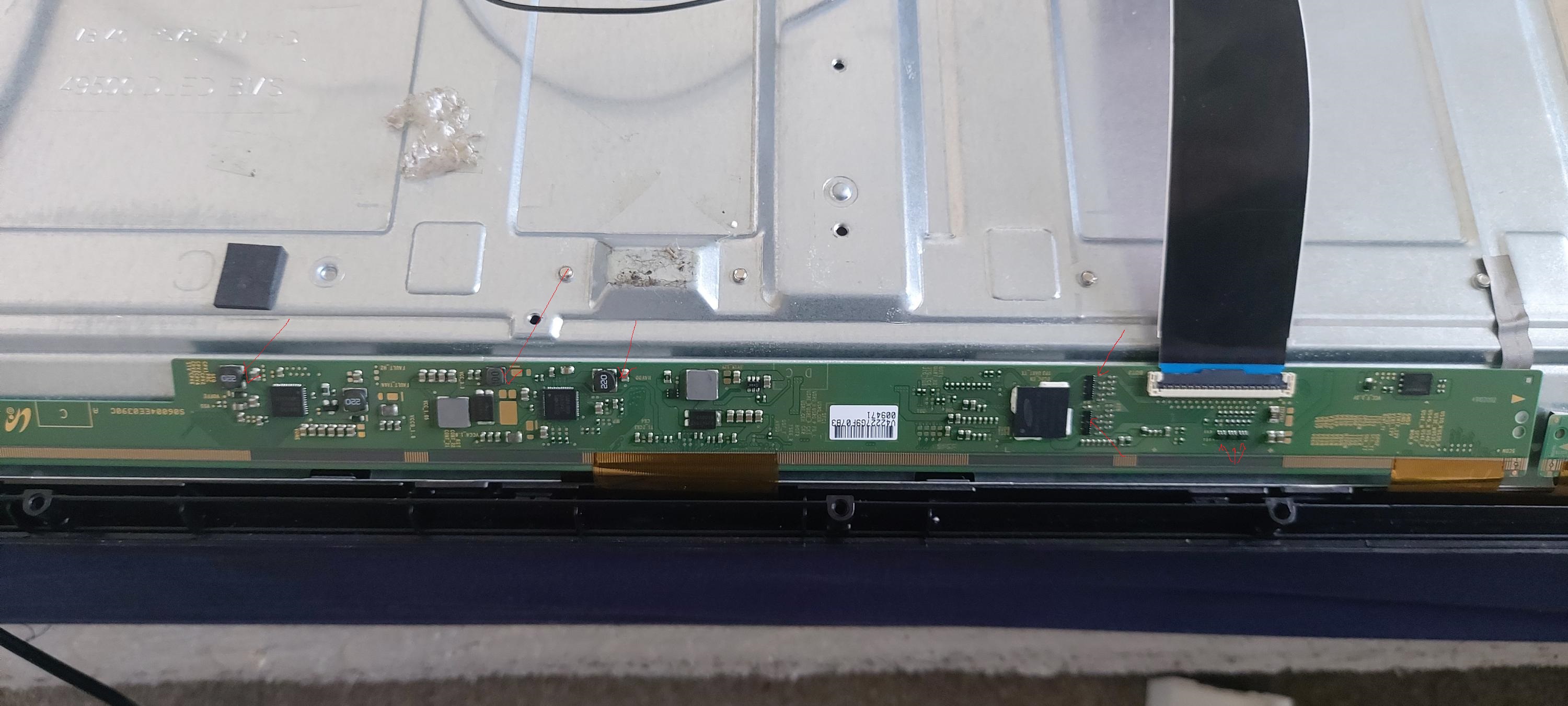

    Hi all bit of a newbie in this one I have a 49 inch pana that's not showing any picture bit if I put the av board in a cracked screen tv it comes up with a picture . Bottom board fuse is OK

      Measure the voltage each side of the tcon fuse.
        Re: Panasonic tx-49fx550b no picture
        12.43v ether side
          Check that board for a short.
            What would I check ?Best place to start?
              The SMD diode networks, the coils and the caps.

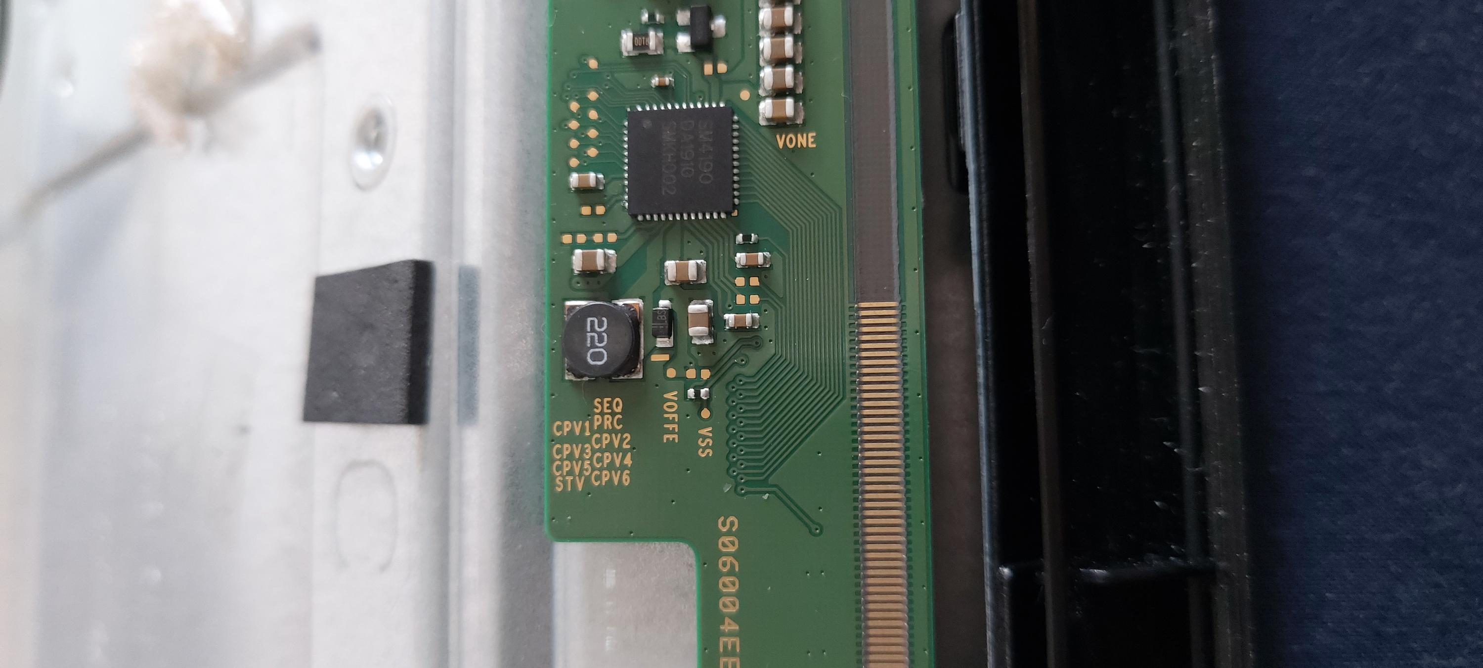

                  Check for shorts to ground on the coils and caps and the arrowed devices i believe are diodes.
                    Will do . What's the best way to test these apologies Im still learning
                      The diodes you test with diode mode placing the probes on each pin opposite each other then measuring again after reversing the probes.
                      For the coils put your multimeter into resistance mode with the black lead on ground, same with the capacitors.

                          On this one with the 220 on with black to chassis it's beeping on all 4 corners but the other 220 's ain't
