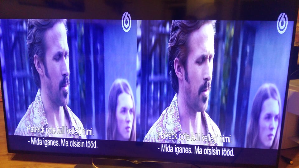

        So I decided to give it a go. New main board inside my tv. Sadly it doesn't quite cope with the t-com board. Is there any way to fix this problem? Should I try installing my original TV's software onto the new main board? Or is this somekinda 3D mode?
        Also tried with the new T-con board but no picture at all with that one.

          Re: Can I use different VESTEL panel on mainboard?
          Is a wrong panel setting
          Your panel is a Samsung core
          The new main is from a BOE core panel
          You need to change the panel profile in Service USB operation with a USB stick
          Or a USB update with a software for your panel
          Here is a USB update for your panel :
          https://we.tl/t-slf070wyTn
            Tavitara, thank you for your input! I downloaded the file, but it says FINLUX. Won't I be needing a Finlux remote after this firmware change?
            If anyone could direct me to a proper firmware update tutorial I would much appreciate it! I don't want to brick my new main board.
              Is easy if you know
              If you don't is more complicated
              An universal remote control for service is enough , Vestel usual code work on Finlux
              Save your complet profile from your tv JVC in this stage with original remote
              USB update with my software Finlux
              If the image is corect now , save only profile for panel VES650QNTS-2D-U11 with universal remote
              Reload original profile JVC
              Write panel profile with the file for panel VES650QNTS-2D-U11
              Or write just the profile for panel VES650QNTS-2D-U11 on your tv
              But i don't have now , maybe someone
