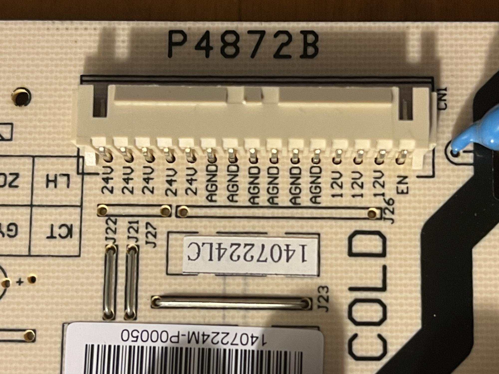

    LG 60LB5200 No power , completely dead

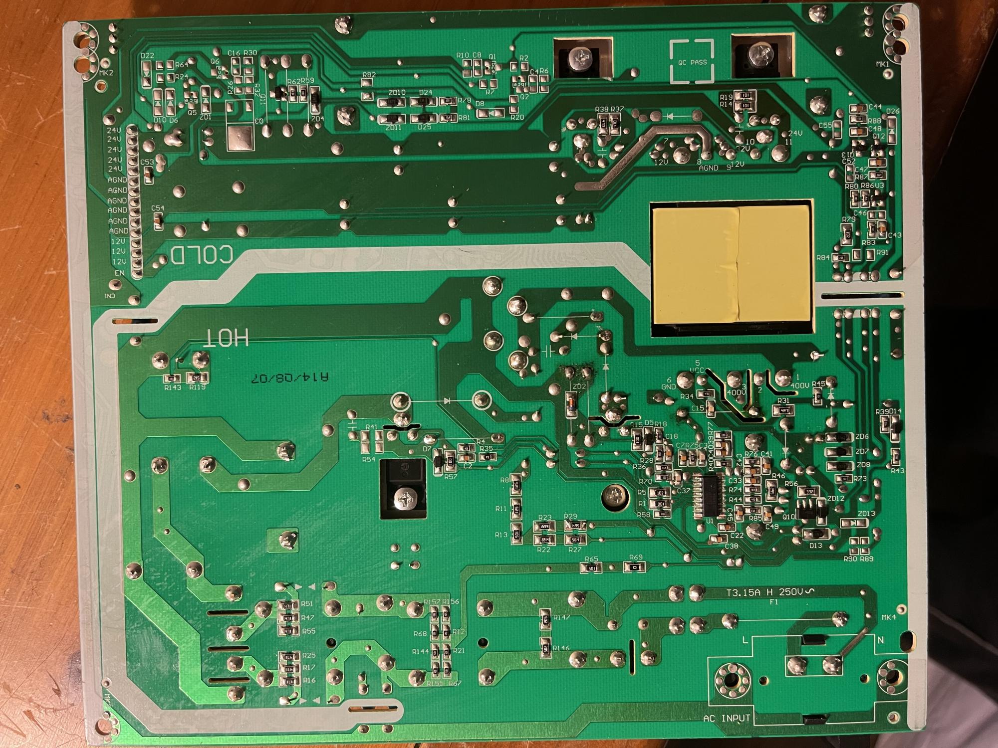

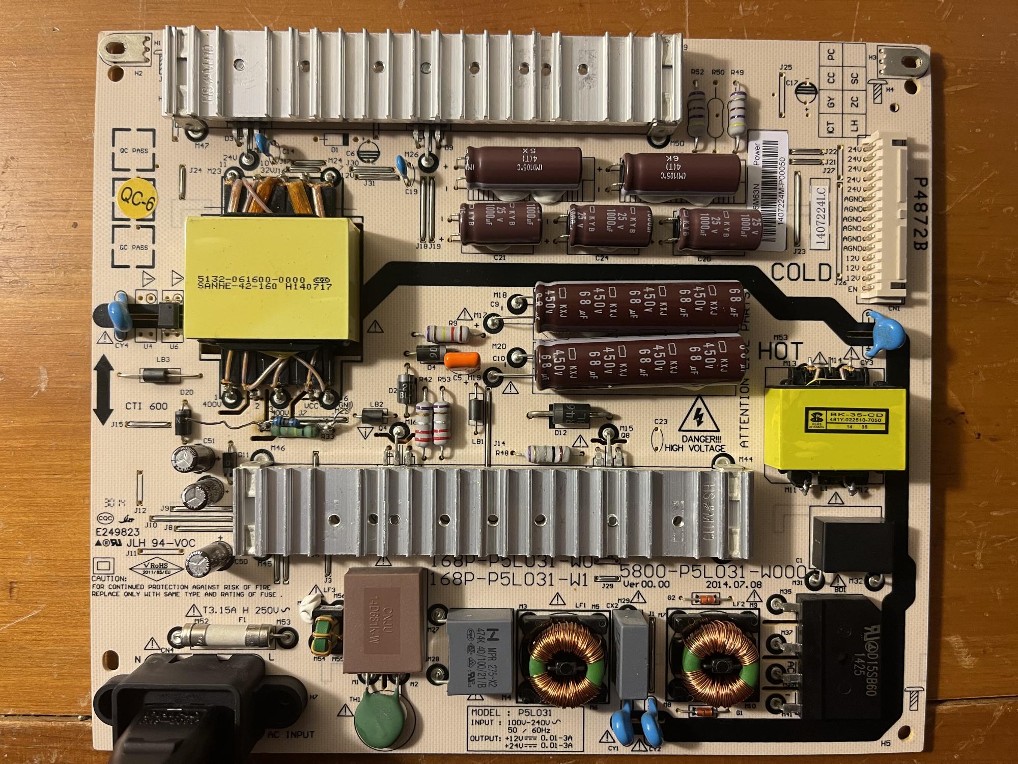

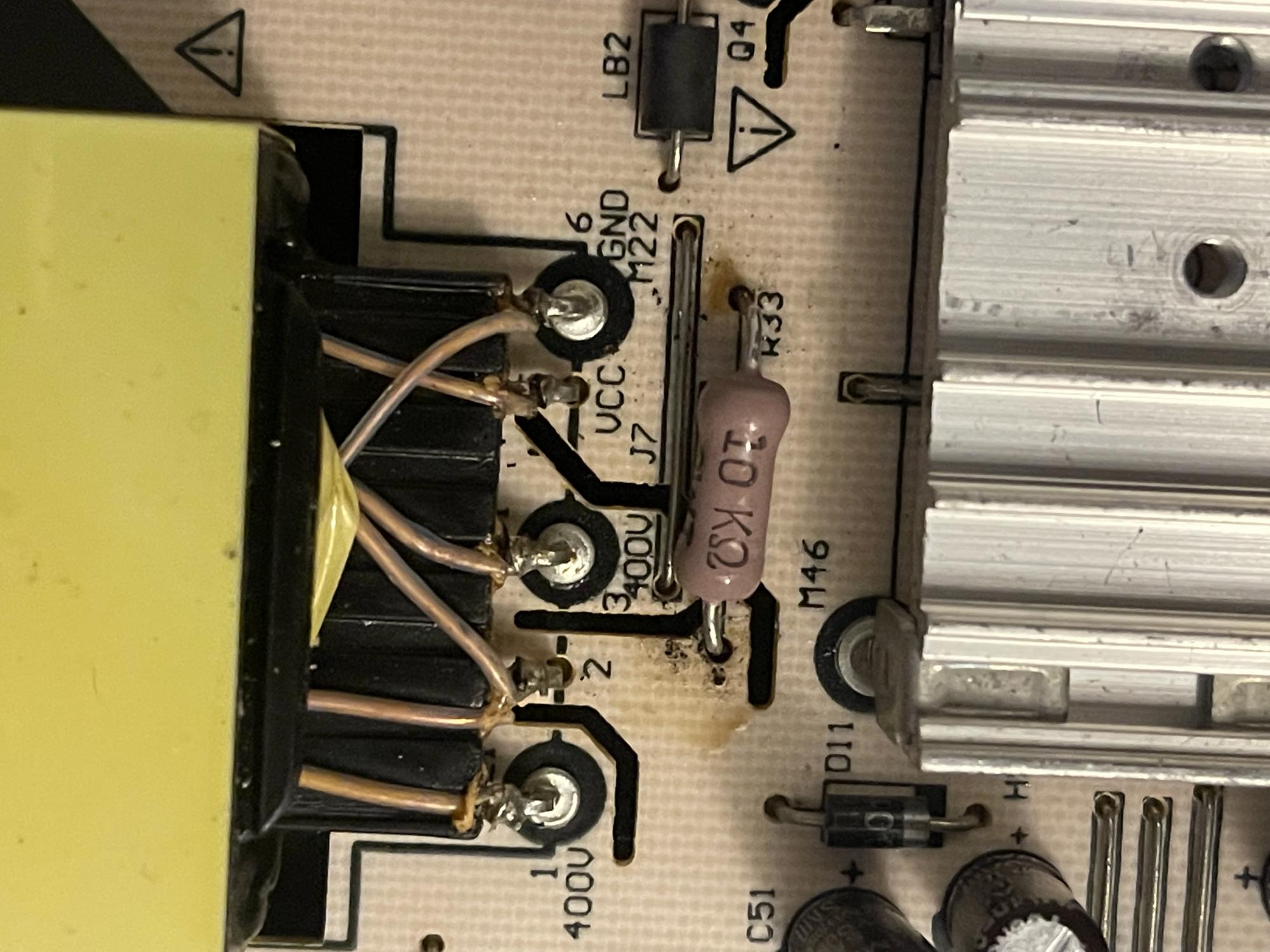

    I have this lg that is giving me trouble for the past 2 days with a faulty power supply unit (I assume because this is an always on power supply) .
    Initial findings:
    Got it dead. So I opened and checked for any badcaps’ or mosfets and interestingly everything was fine, except a R33 resistor that got infinity reading This particular resistor is connected to one of the secondary winding of a transformer to the HV pin of IC tea1755t . The big filter caps reading was 168v . Both 24v and 12v outputs were absent (0v) . I have seen an older post for this same tv and found that r33 was a 10k resistor but unfortunately I didn’t have one in stock. So I paralleled two resistors and managed to make around 9k. But still the caps showing the same voltage and the cold side is dead. I checked the pin 1 (vcc) to pin 2 (ground) voltage and it reads few milli volts only. After 2-3 minutes one of the resistor which I paralleled (which was a 1/4 watt one , pls see the pics) started to produce smoke. So I stopped working on the board now and realized that my experience is not enough to move forward in this situation. Any thoughts?

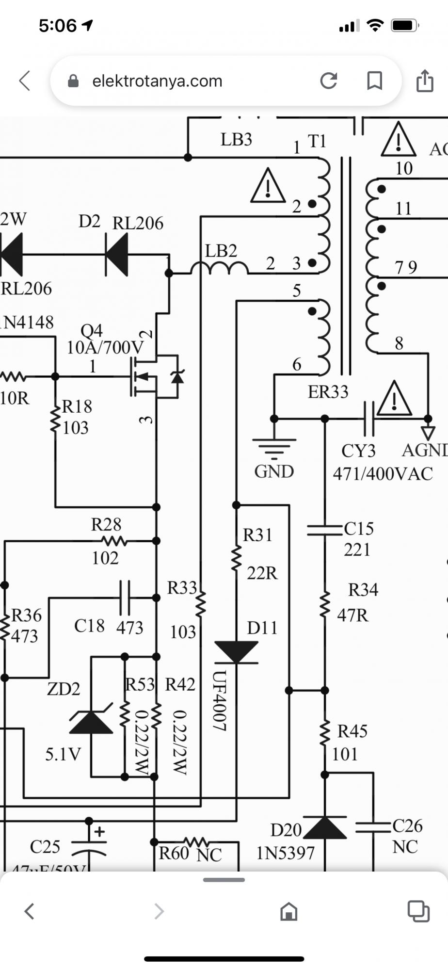

    The following is the link to the schematic of the power supply.

    Re: LG 60LB5200 No power , completely dead

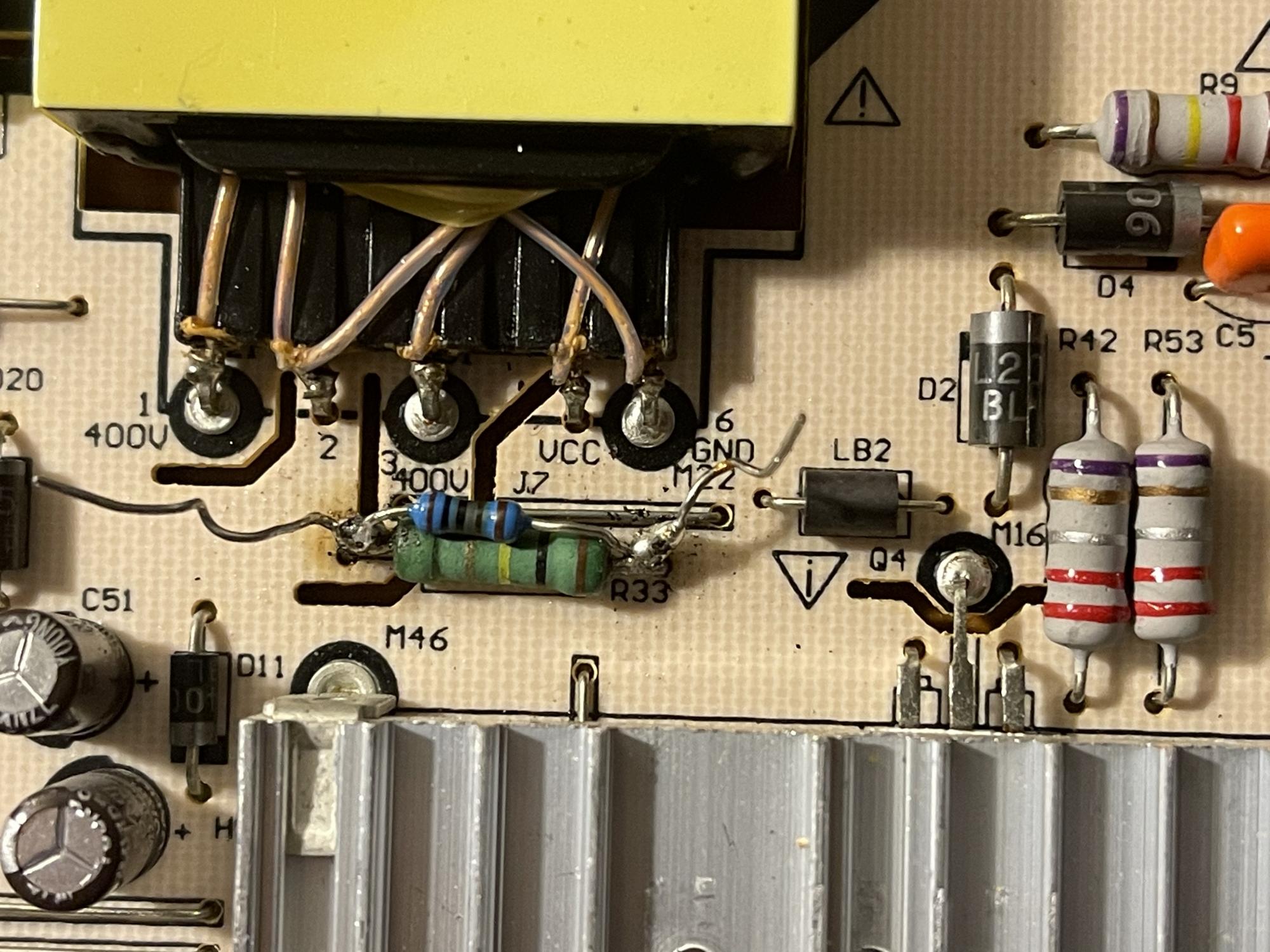

    It is very likely the ic is bad, it is about the only part that would cause r33 to open.
        Hi, I replaced the IC but still showing less voltage on the 24 v and 12 v connection, as well as 169 volts at the 400v places.
        Any inputs at this point?

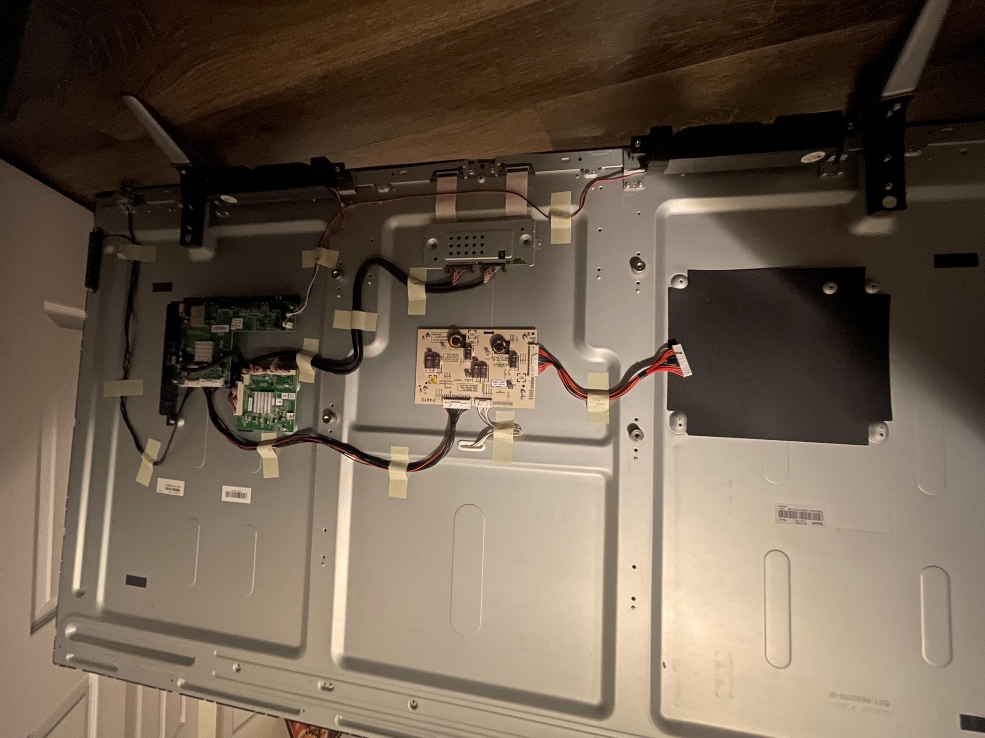

                                No, it is not connected to the main board at this time. The voltage across c25 is 15v and across c51 is 20v . I am going to connect the psb to main board soon.

                                  • Anooc7
                                    • Jun 2021
                                    • 26
                                    Update: So I hooked the psb to main board and the voltages (24 and 12 outputs) dropped to 4.2v and 2.2v (where it was 16 and 8 before). I checked the r33 resistor (10k)that I replaced and it is showing Mega Ohms.

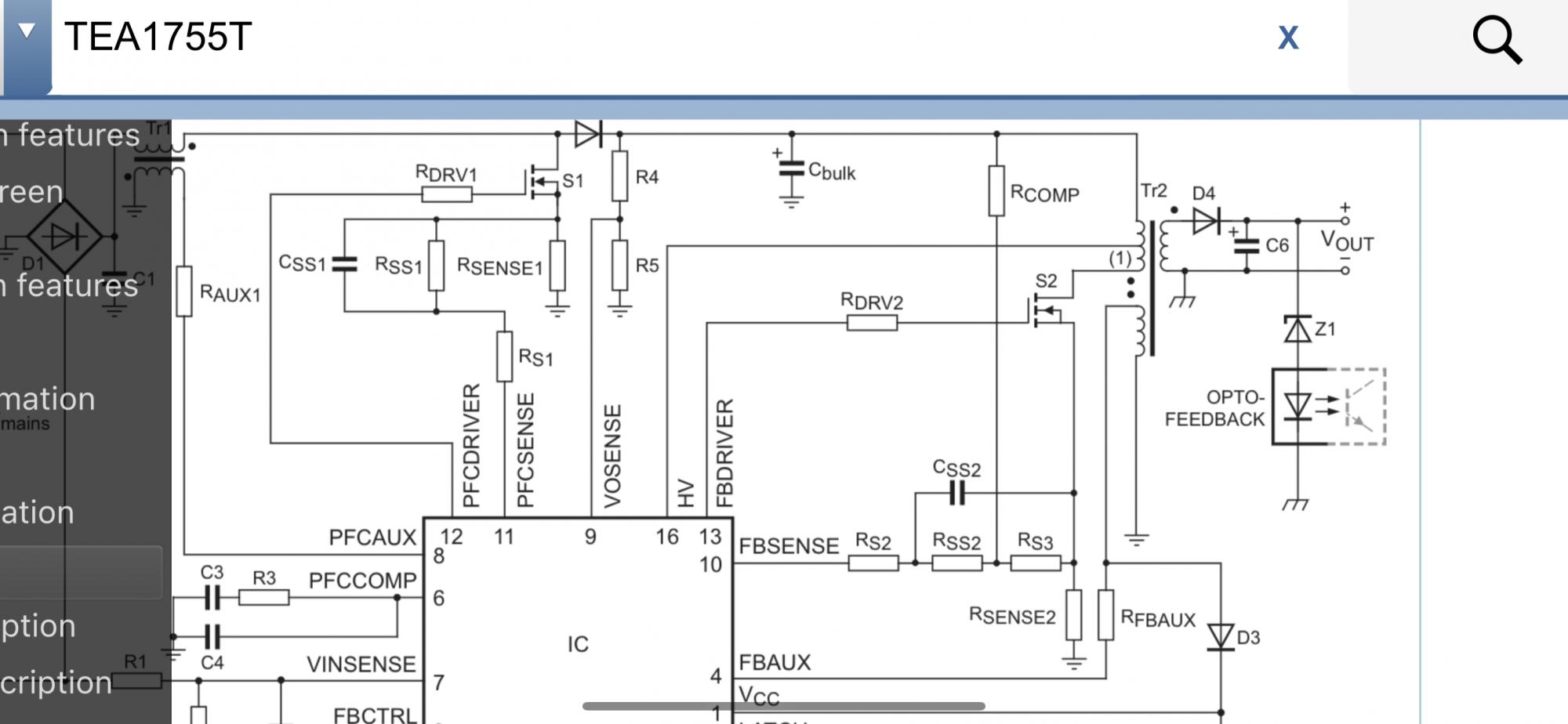

                                    I am including a practical circuit which I found from the data sheet of Tea1755t ic , there is no resistance in between the hv sens pin and the transformer, so can I short that with a jumper? (Instead of r33)

                                      Have you checked the value of r33 in the schematics? It is very strange there is no resistor in this schematic, i don't have seen datasheet, if hv pin is the startup pin the current must be highly reduced, but something excapes from me, why a central take in the primary winding and not the end wire if resistors are integrated in chip? i must read the datasheet.. never seen a primary side with more than 4 terminals. Very odd.
                                      • Anooc7
                                        • Jun 2021
                                        • 26
                                        From the schematic it is labeled as 103 , I found from a previous forum posting that its a half watt 10k resistor.
