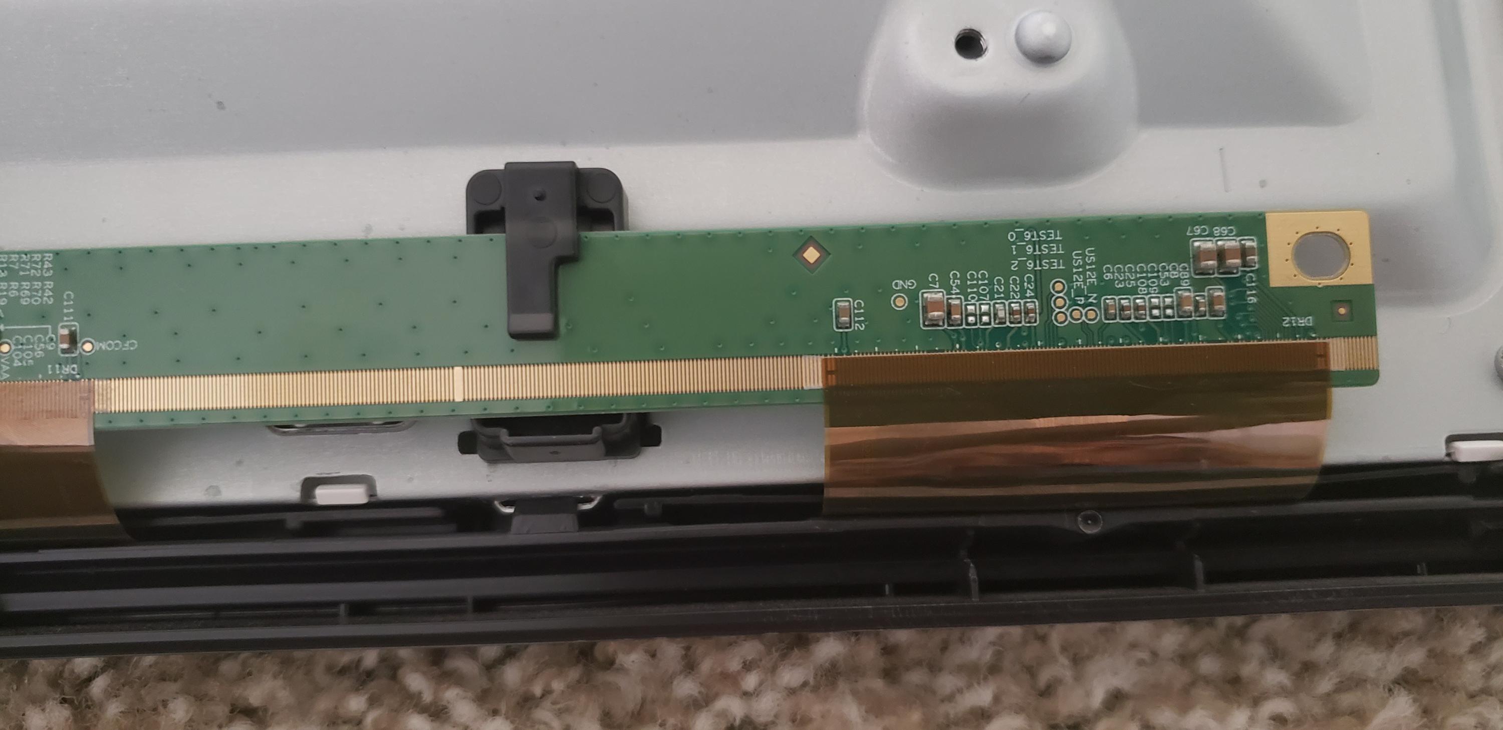

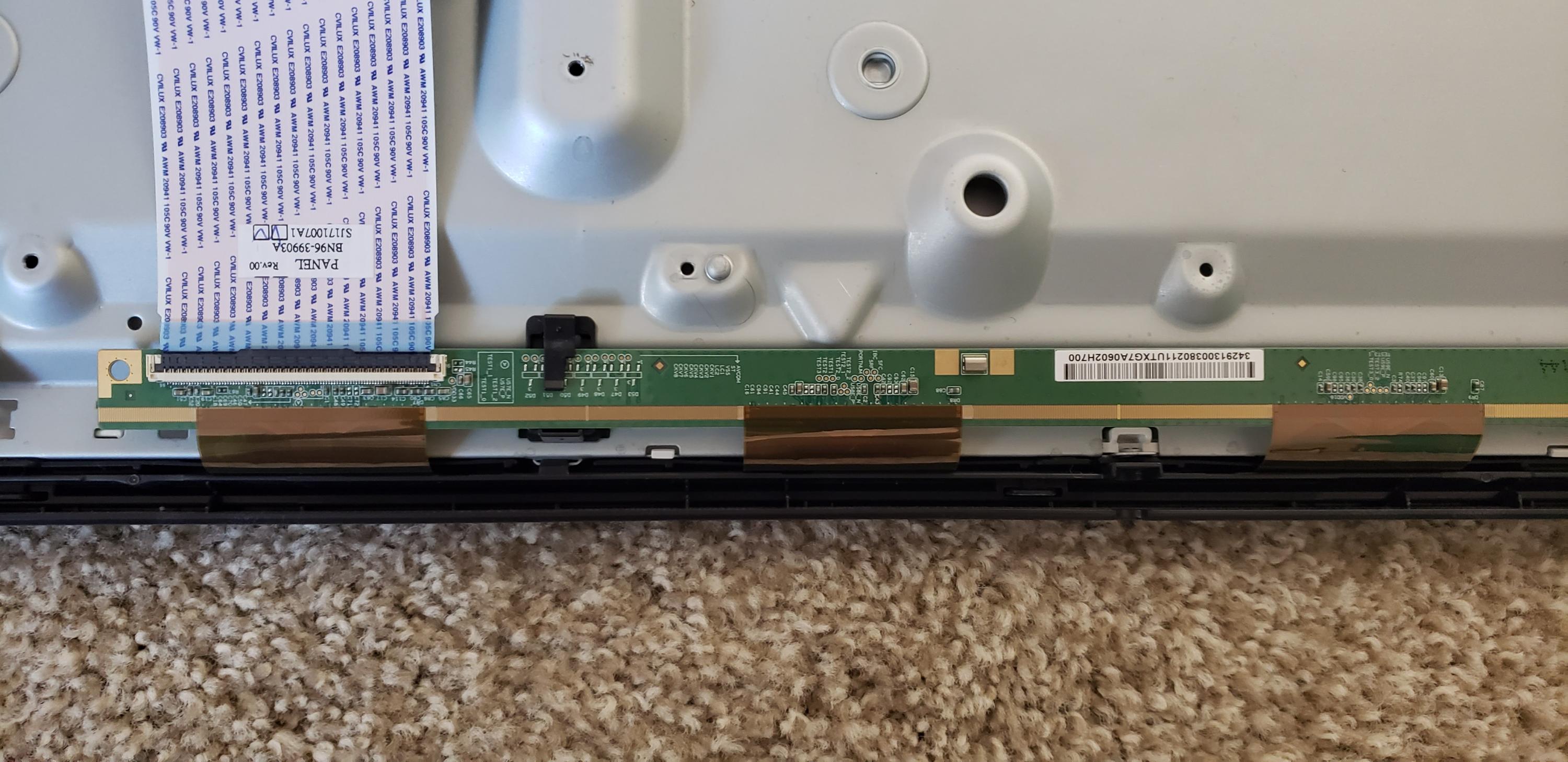

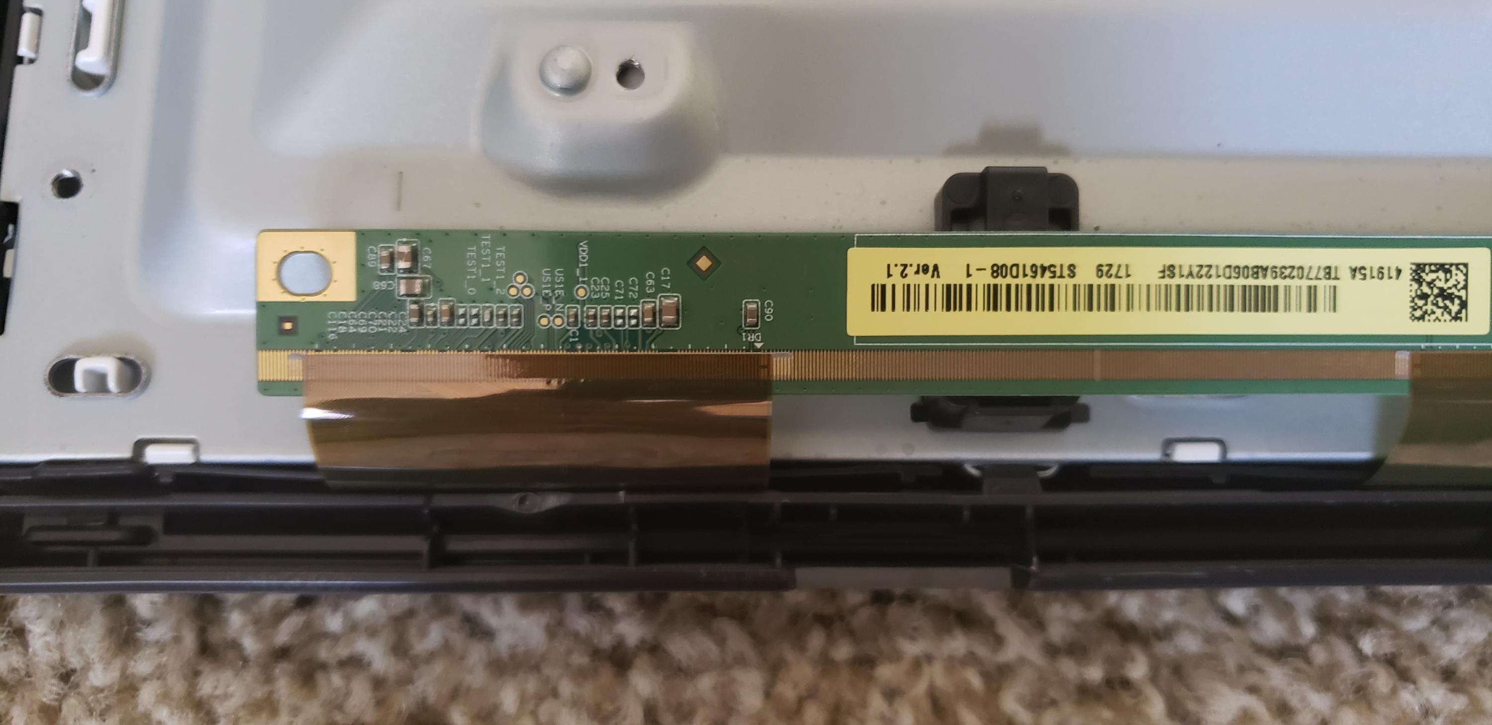

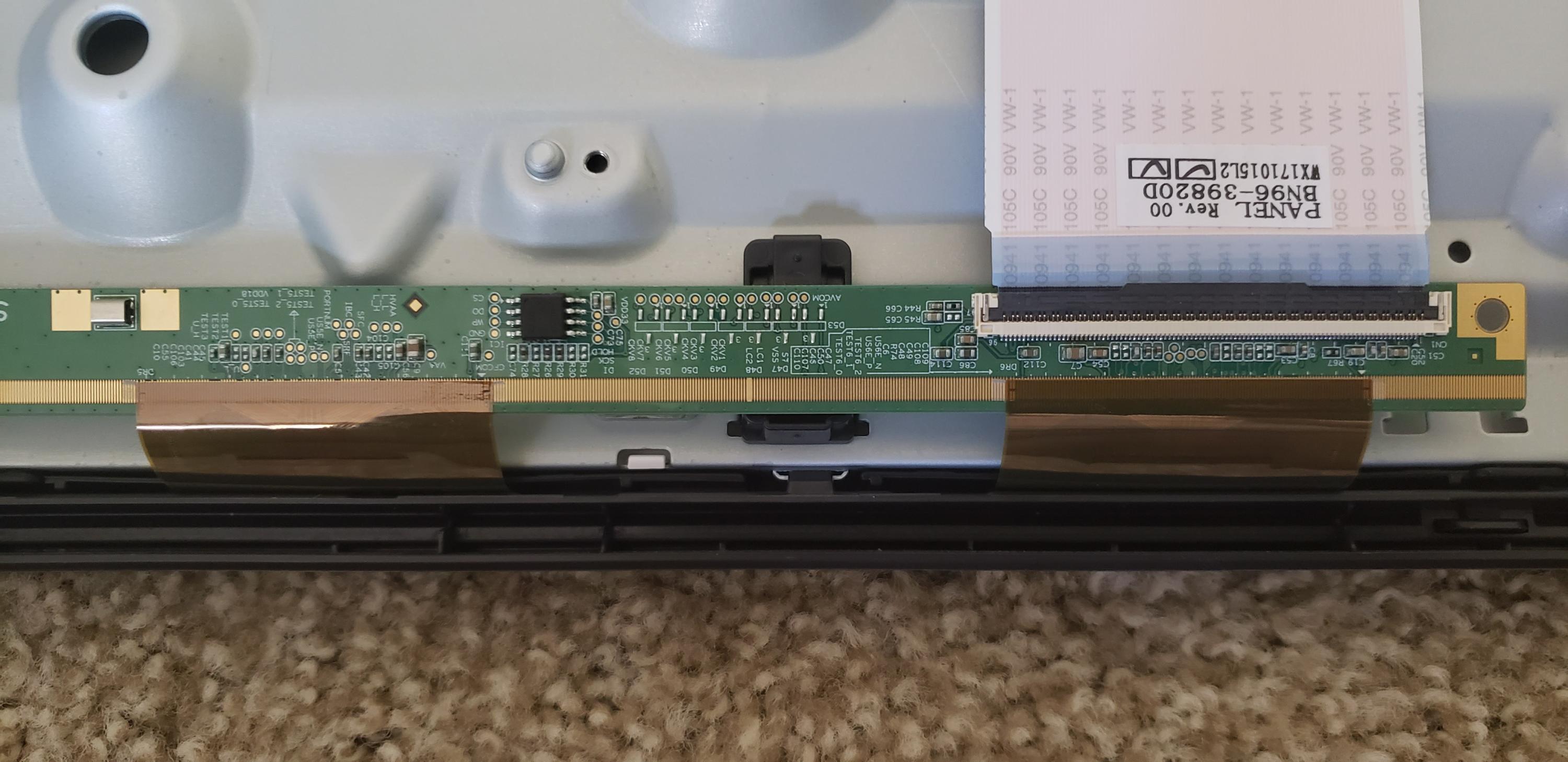

    Set stays on if right side ribbon is disconnected and starts rebooting if it's connected so that means there is short on right side driver board. However without right ribbon connected also there is no VAA voltage. Is it expected or something else is also wrong? Could that be issue on the main board as well?
    • Davi.p
      Hobbist Tech
      • Sep 2009
      • 4297
      • Italy - Milan
      Re: Samsung UN55MU6290 Boot loop
      In certain models if not both half of screen are connected but only one the tension not come out, so you don't know which side has problems, maybe if you block VAA only with tape the rest of tensions come out, try, first one side per time..
      • anupkg1985
        • Sep 2020
        • 180
        I tried with removing big caps on driver board however no luck, same symptoms are there.
        • Davi.p
          Hobbist Tech
          • Sep 2009
          • 4297
          • Italy - Milan
          So you removed all big caps in both boards? maybe is not enough, some times there are some caps for the HAVDD, in yours maybe HVAA that fails, have you checked by magnifier first? In post #11 i can't see well, aren't there any diodes? Marked with Dxx... If there are test them. But without instruments is difficult..
          • anupkg1985
            • Sep 2020
            • 180

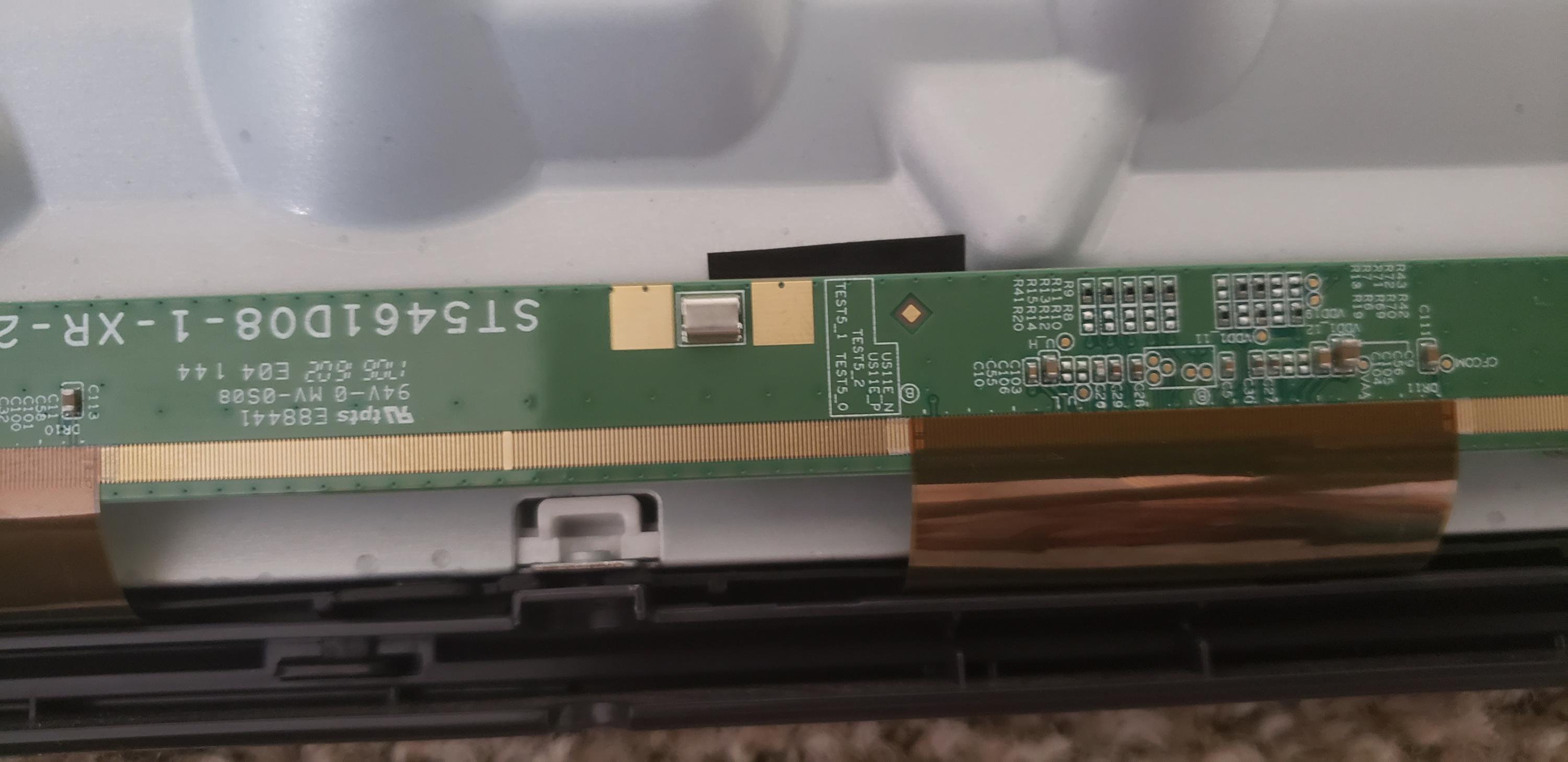

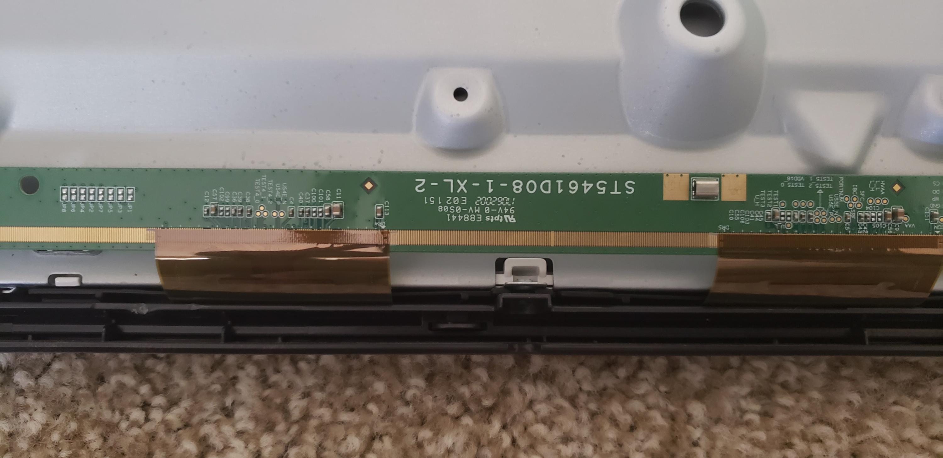

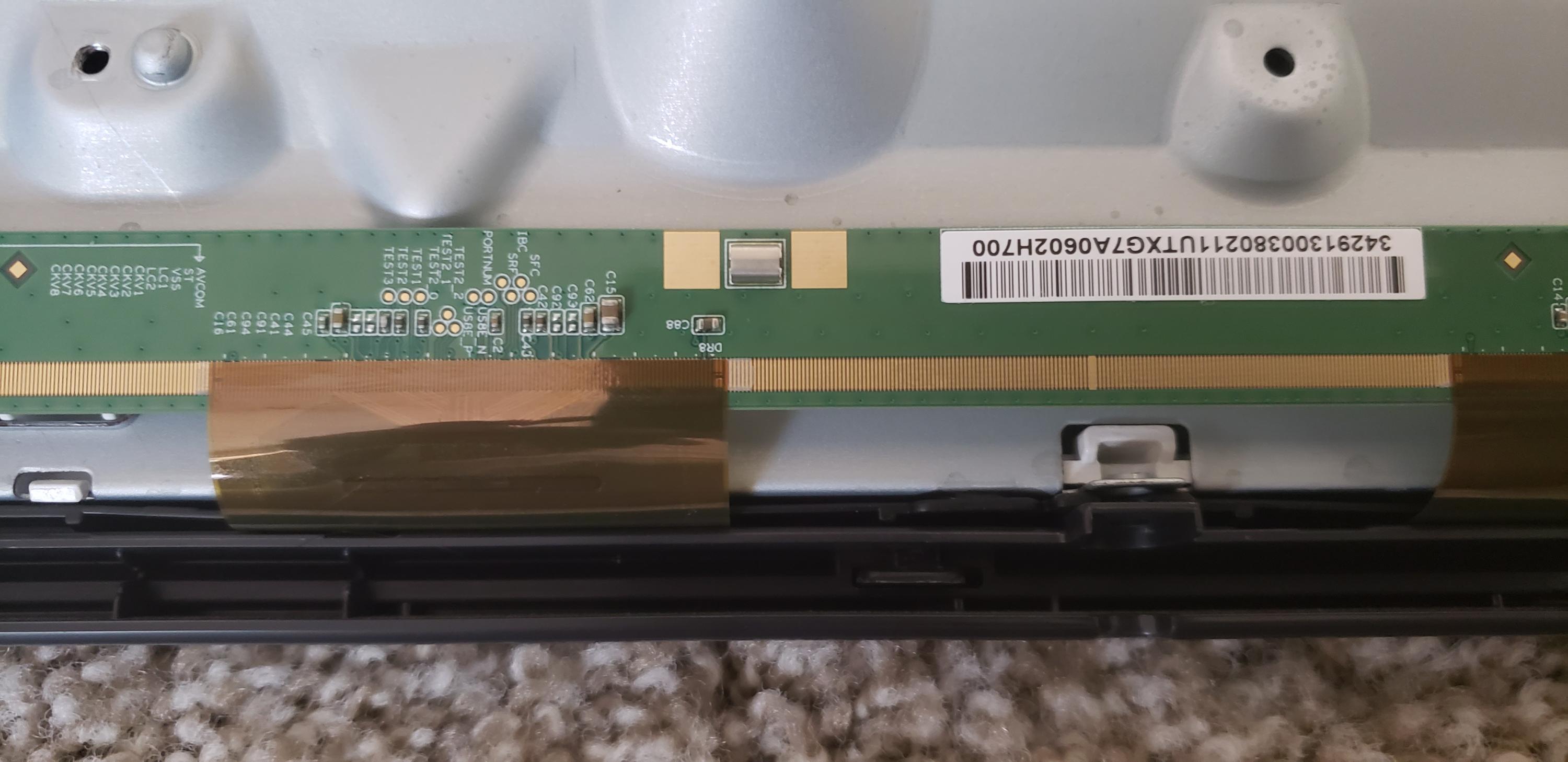

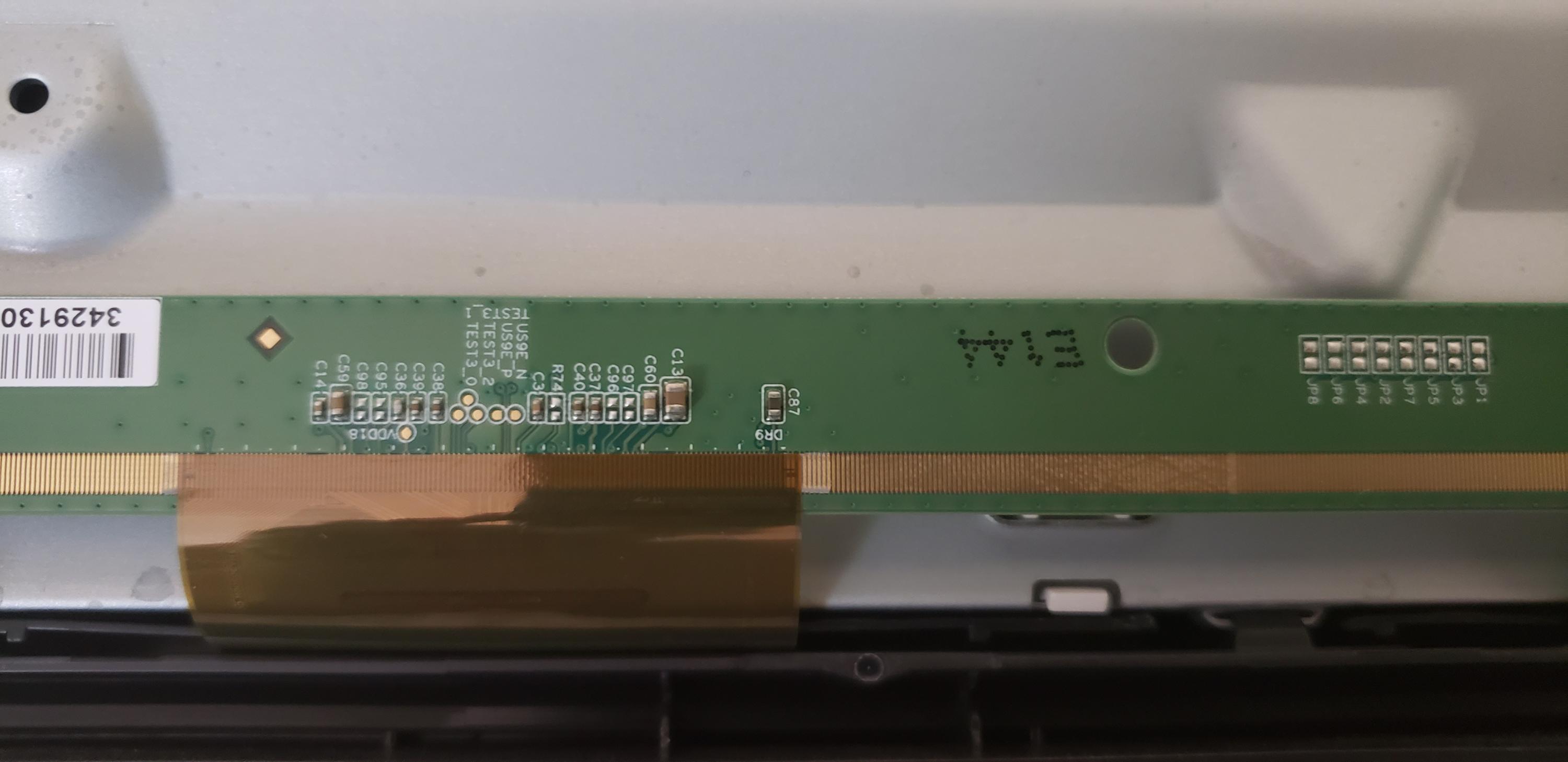

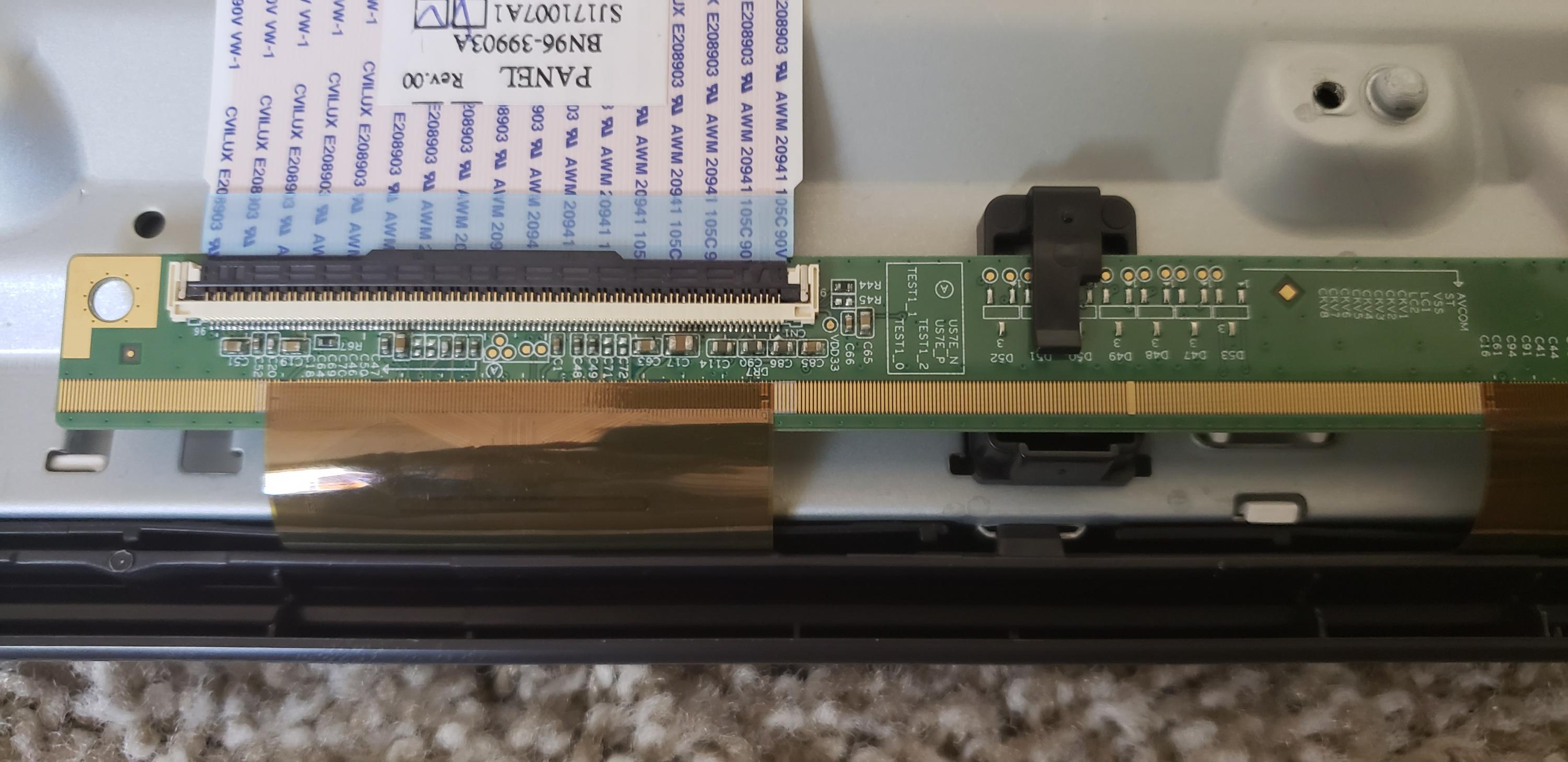

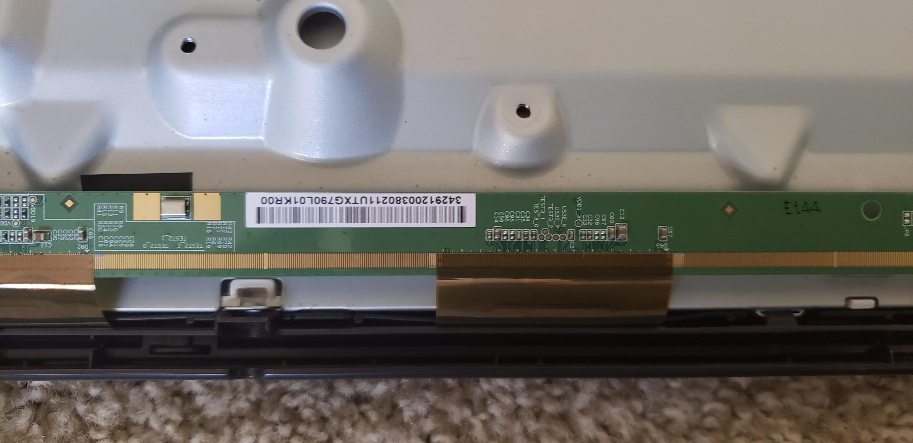

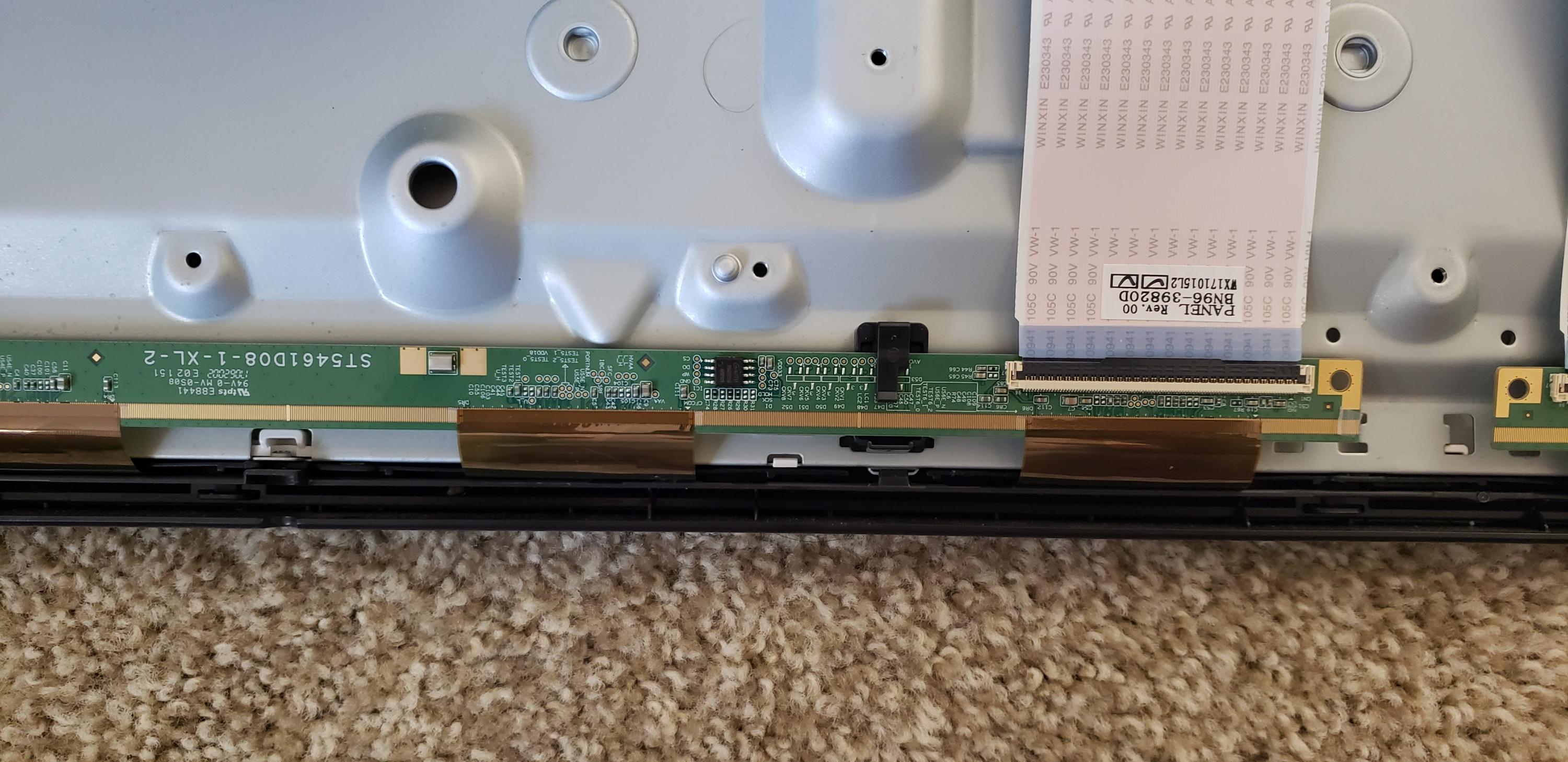

            I understand that, getting a hot air station. Also find the pictures of the both side boards, I didn't notice any diode on the board. All I could find are caps and few resistors.
            • anupkg1985
              • Sep 2020
              • 180

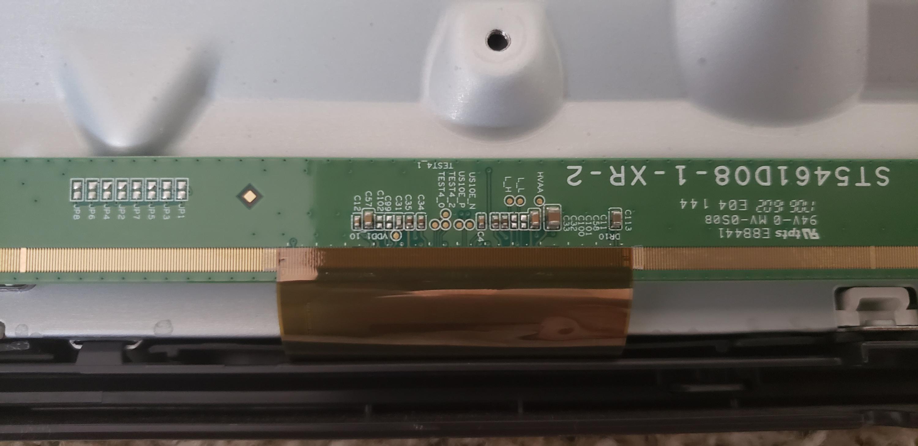

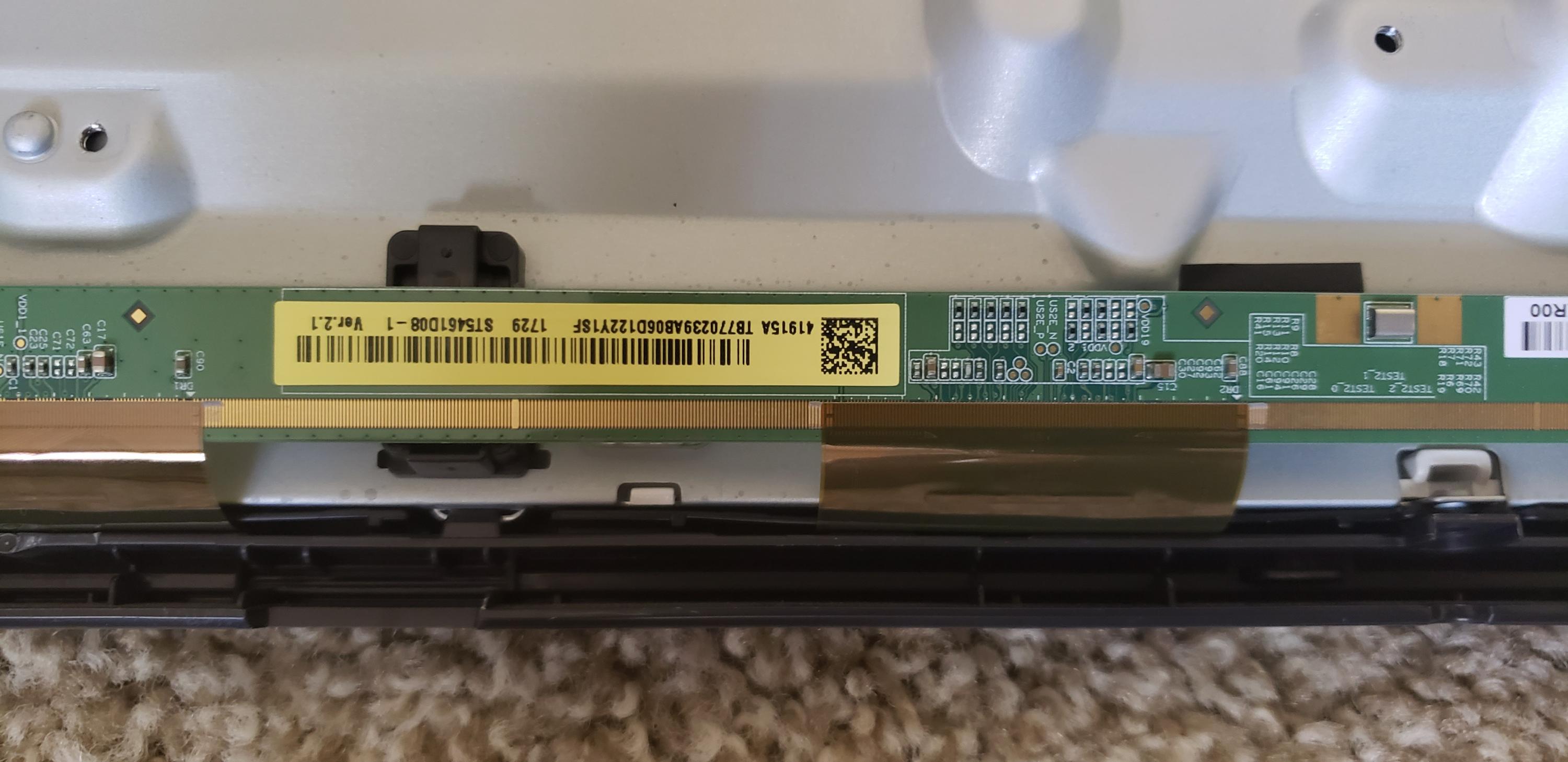

              Attaching few more snaps as post limitations of 10 photos.
              • Davi.p
                Hobbist Tech
                • Sep 2009
                • 4297
                • Italy - Milan
                As i have said, there are some caps that holds HVAA, them must measure about 8,5v, if you find some of the caps that doesn't hold any charge but are smaller than the ones on VAA them are supected. It's a long job without instruments.

                        #31

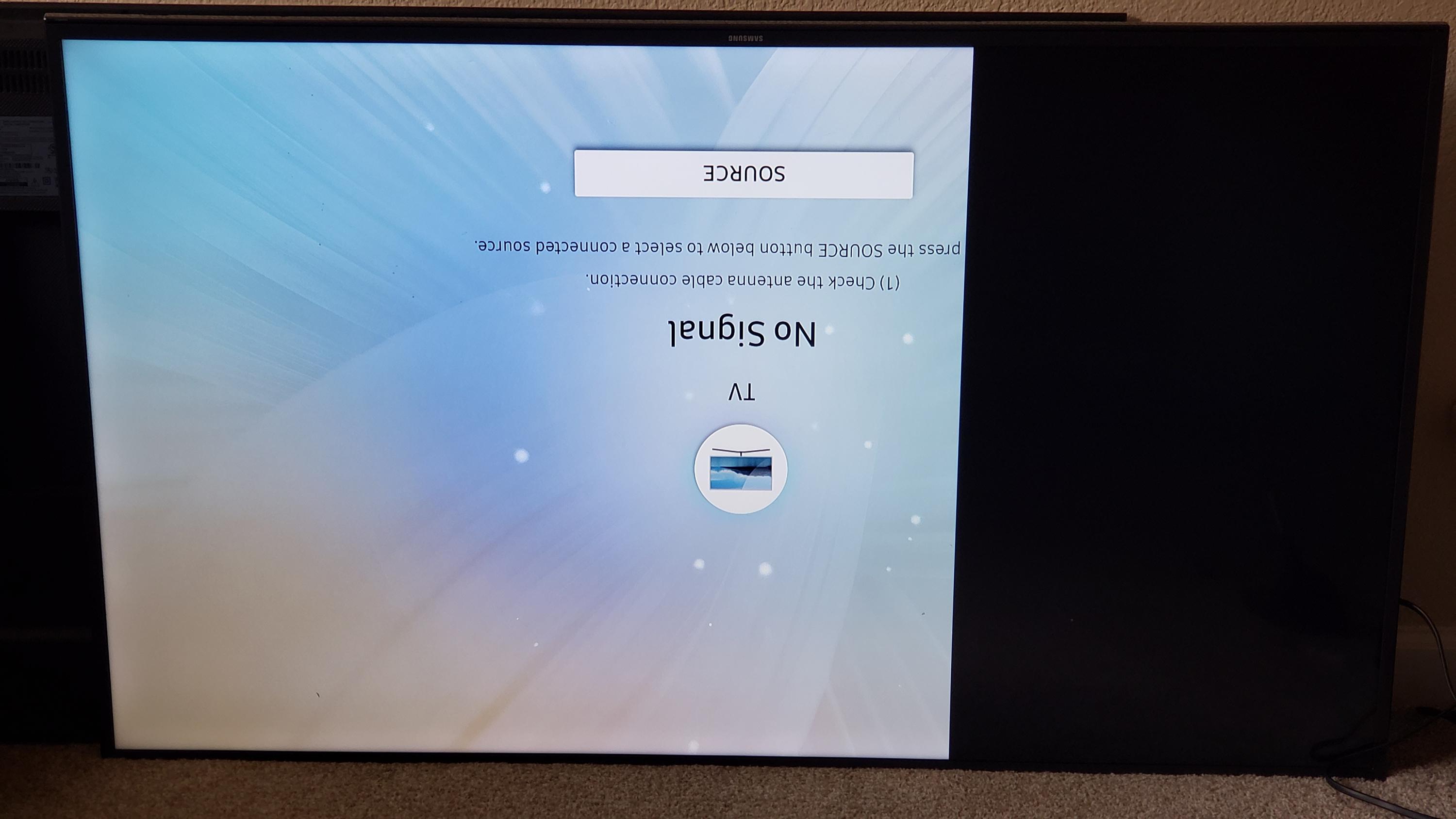

                        Update- Checked fee more caps on faulty side however no luck. I gave up on it and decided to remove cof tab bonding cables and after removing 3 tabs tv fired up and could see 3/4 od the screen. Not sure if the short was in the panel itself. Could someone confirm?
                          You removed the bottom side tabs? No comment!
                            Yes, did I make a mistake? I know it's not repairable now however as I said, I gave up and just wanted to check whats the issue. Does that mean panel was ok?

                              #34
                              I don't remeber this discussion, i can read it again if i have time to lost but it is unuseful now, removing source cof it's always bad thing and they weren't surely the source of problems, you could have sell entire tv for giving to a more expert tinkerer. It's a bit sad but anyway it's your choice. Maybe there was other tries to do..
                              ...and, for instance, by removing for last the inner tab you did, if i'm right my diagnosis was right then bad cap on a distribution board..
