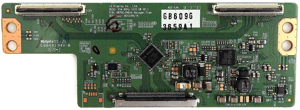

    Hi.
    I have two LG 47LY330C with main board problems - no image. Tv's have back light, status led ok, and turn on or of if the power button is pressed.
    I have 5 main board's EAX654486303 (1.0) with the same problem. Tried reflow in one, firmware and flash from ones to others. Got nothing. I'. the rest is ok, i had a good main board to test, tv is now far away...
    The panel is a LC470DUE (FG) (A3)
    Does any one have a firmware for this panel or a better idea?
    Thank's

    So it can be problematic in T-Con - 6870C-0481A

      Re: LG 47LY330C Main board problems.
      No. I know T both t-con are ok. I think cpu issue on all boards or firmware, due to the fact that firmware is not the same for different panels.
      Thank's...

        There is a firmware for LG 47LY345C-ZA EAX65486303 (1.0) H27U1G8F2CTR, MX25L8005, right?
