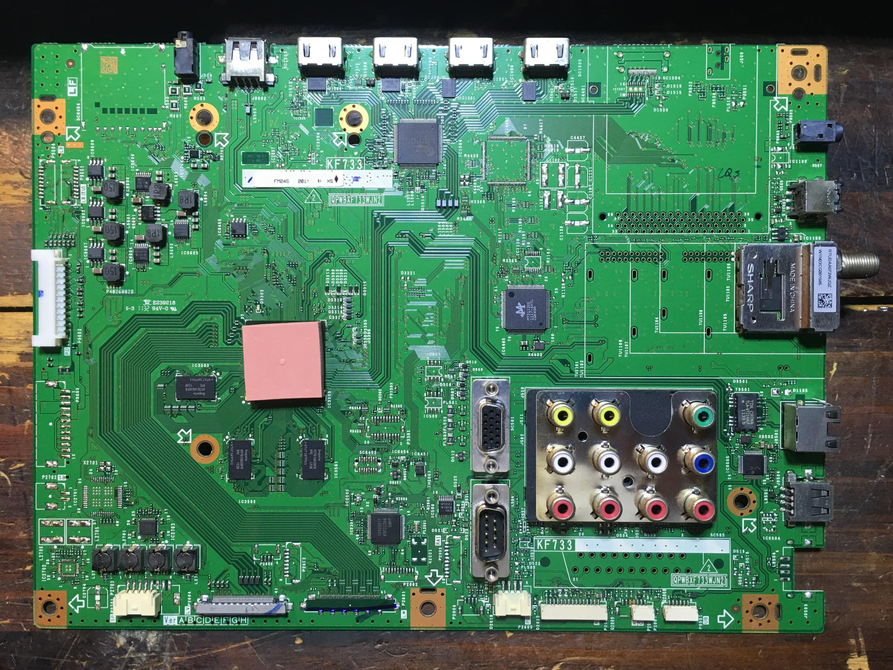

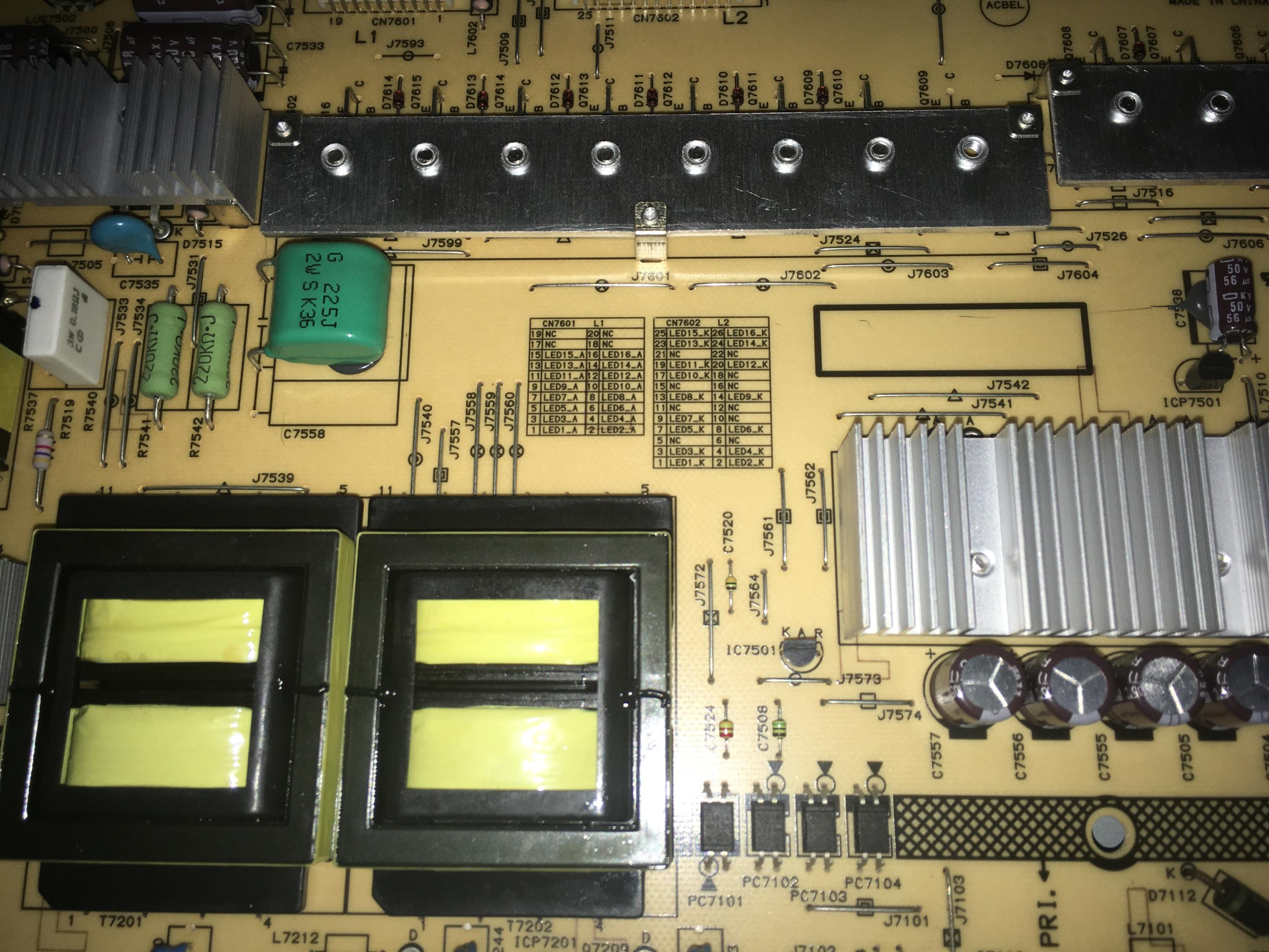

    A little more background information. The initial blink code on this TV was (2-2) Power supply error 2 UR+13V error. I also noticed that buzzing sound in the PFC area. After checking the UR+13V filter caps and rectifiers and finding nothing wrong, I refreshed the solder joints on the major components (transformers, FET's, diodes, caps, large inductors). Then I took a look at the PFC and noticed that it was lower than I thought it should be and it fluctuated. When the PFC is off the voltage on the bridge rectifier/filter caps (C7220, C7222, C7223) was normal and did not fluctuate. When the PFC turned on the voltage on the filter caps fluctuated between 310v and 316v. Also the voltage on the bridge rectifier fluctuated between 150v and 220v. Even with this fluctuation the output voltages were stable and where they should be.
    After refreshing the solder joints I put the power supply board back on the TV. Now the 2-2 blink code was gone but the 2-5 showed up.
    Because of the 2-5 blink code, I check the T-Con/Panel. When I disconnected one or the other ribbon cable between the T-Con and Panel I still got the 2-5 blink code. When I disconnected both ribbon cables, the TV powered up as normal. The PFC remained the same. I expected the PFC to be around 380 - 400 volts, but it remained fluctuating near 300v.
    What I am wondering is if the PFC is too low to handle the 12v outputs when the T-Con/Panel tries to power up, and this is why it's giving the 2-5 blink code and not because the Panel is bad.
    Note: Though the PFC voltage does not increase when the TV comes up with the two Panel ribbon cables disconnected, the buzzing increases as the backlight intensity increases.
    Last edited by SdlewisSr; 07-12-2021, 01:07 AM. Reason: I forgot to add images. So here they are.

          Update: I fixed the low PFC voltage problem. I temporarily replaced the four 750k ohm SMD resistors (R7233, R7234, R7235, and R7236) off of pin 8 (HVSEN) of UCC28061 (IC7201) with four through hole 750k ohm resistors. Now all voltages are good. The PFC voltage is stable at 390v. Also the buzzing is gone.
          However, that did not fix the 2-5 blink code. With the two ribbon cables (or just with one or the other) connected between the panel and T-Con board I get the 2-5 blink code. With both ribbon cables disconnected the TV comes up with no error, backlights and all.

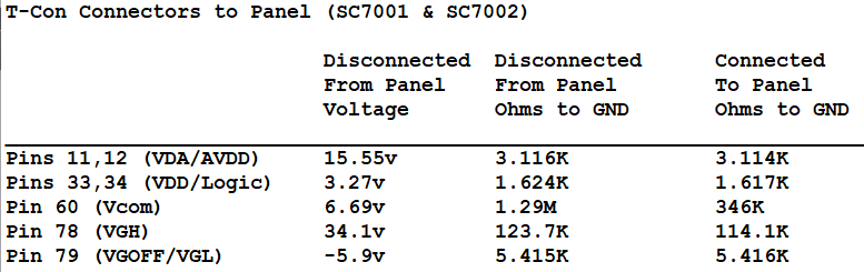

              Update: I checked some of the main voltages on the T-Con board at connectors SC7001 & SC7002 without it connected to the Panel. I also checked the resistance to ground of these same pins with the T-Con disconnected from the Panel and then again with the T-Con connected to the panel. (See attached chart)
              The voltages appeared to be normal. Only the Vcom pin resistance changed a lot. This may be normal.
              I'm now wondering if the 12v regulator (IC7504) on the Power Supply board is failing under load.

                                    You mention the resistance changed, but how about the voltage between panel connected and disconnected? Maybe I missed it but if one is loading that could lead you down a logical path, particularly if that voltage loads with either TCON output ribbon cable connected.
                                    • SdlewisSr
                                      • Oct 2015
                                      • 146
                                      Re: Sharp LC-80LE632U 2-5 blink code
                                      With both cables connected, from the time I plug it in until I get the 2-5 blink code and it shuts down, I have 12v coming to the board at P4804, but no voltages on Pins 11,12 (VDA/AVDD, Pins 33,34 (VDD/Logic), Pin 60 (Vcom), Pin 78 (VGH), and Pin 79 (VGOFF/VGL) at connectors SC7001 & SC7002 .
