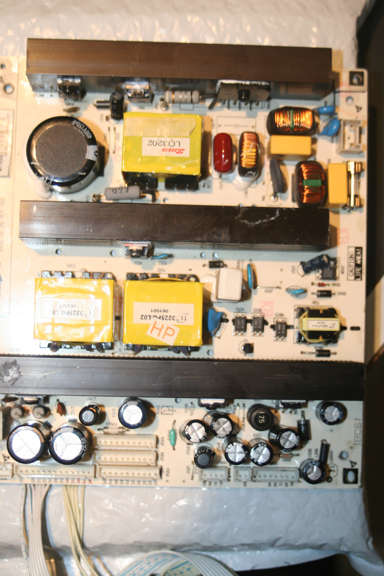

    Butchered Insignia NS-37LCD power supply
    I think I may be over my head with this one .

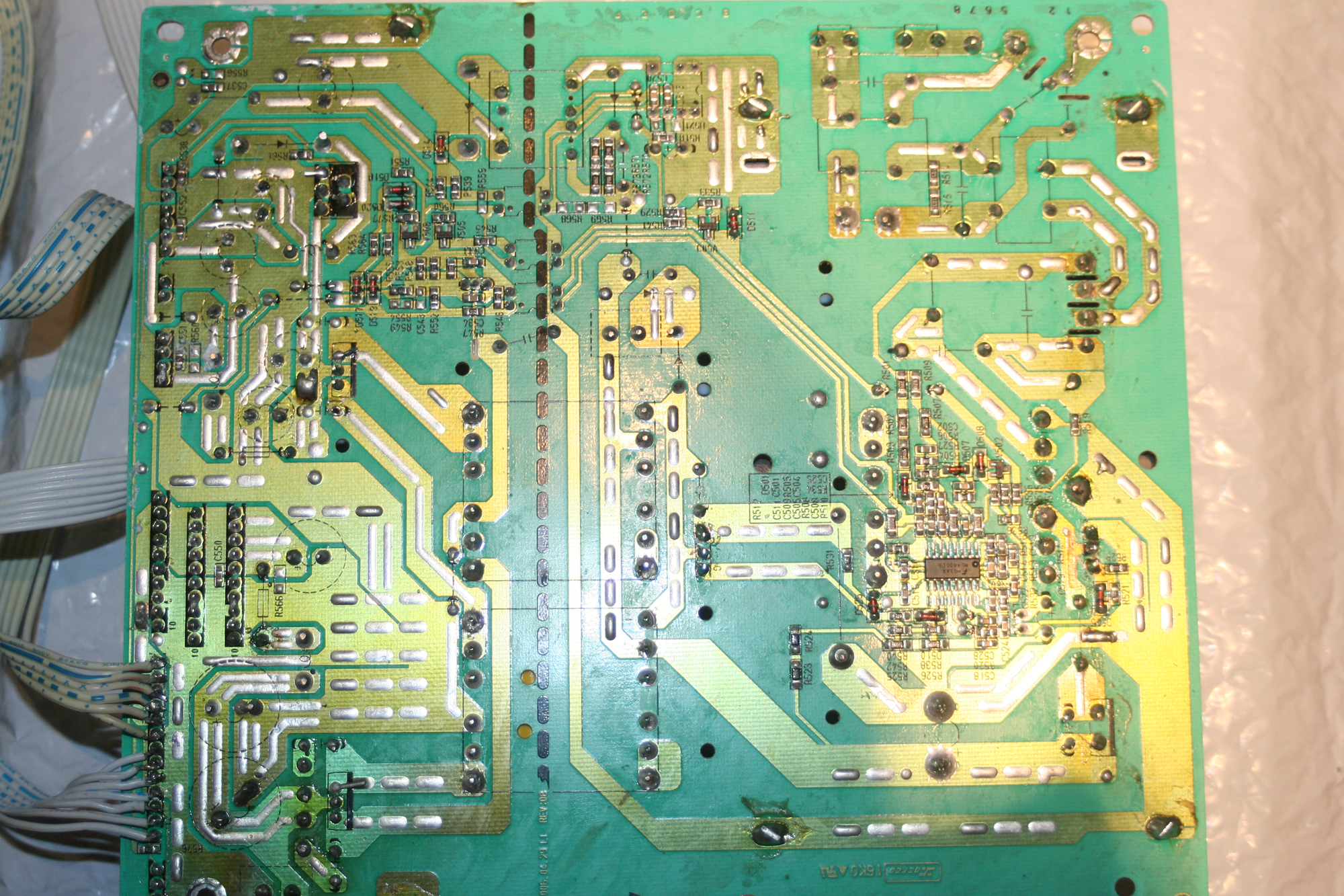

    Pictured here you can see the power supply which does not work. It looks like the previous tech or in this case butcher left his handy work for all to see
    I do get the 5 volt control power thats it the 24 volt reads 5.68 volts same for the 18 volt .
    What I would like to know is what else can I measure the caps look okay but I know that is not always the case . I would really like to work through this problem but will need some help.
    Cheers
    Ron

    Re: Butchered Insignia NS-37LCD power supply
    I am new to tvs, not so new to curcuit boards. It looks like the patch cords were soldered to the board on the wrong side and when you lay the cable flat the two end wires look like they cross over each other, reversed? I have seen this type of power supply on other tvs. I would replace the power supply before trying to fix someone elses mess. The problem you have is the power supply my not have been the only problem.
