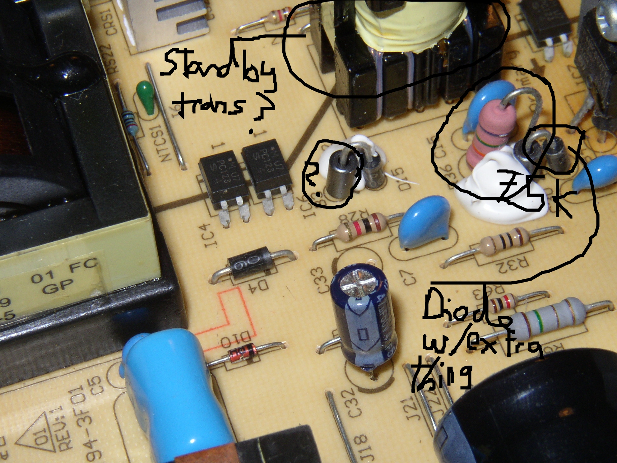

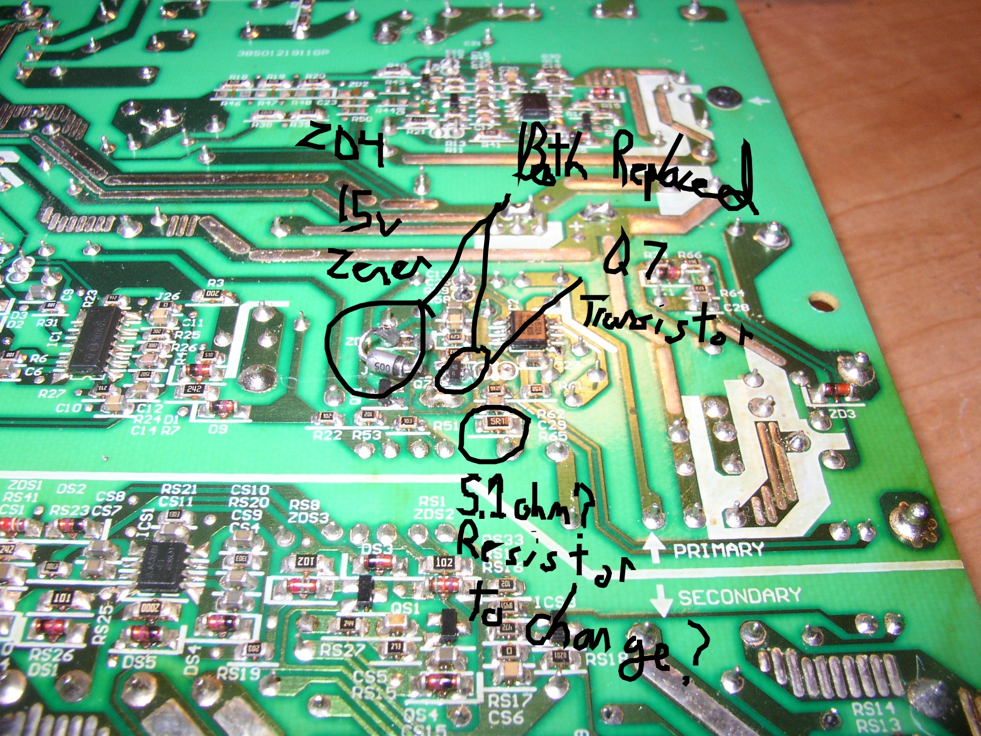

      ok, have board in front of me, i am assuming also that you are talking about hole through component side, as there are no diodes near that area on surface mount side. I am also assuming that the standby transformer is the smaller transformer nearest to the standby output.
      On the primary side of board there is one larger resistor, color violet7,green5, orange000, gold+/_%, so that is 75000value?, it is inbetween a ceramic capacitor and a diode with an added metal cylinder (like a smaller version of the thing that sometimes a power cord is wrapped around), next to that is another resistor with brown1, black0, black0, gold = 10value?, after that, i do not see a zener, just more resistors. If it is 4.7 or 5.1 it would start with a green or yellow band.
      After writing all of this i looked at the surface mount side again and noticed some surface mount resistors, 1 which says 5R1 which is 5.1 ohms, is this the one you were speaking of down and right of the bad zener diode. Well, i'll try and get some pics up of both areas.

        Here are some pics, not sure which side of board resistor is you are speaking of although i am leaning towards surface mount.

          Yes. that resistor is it good?
          And, make sure that small capacitor (electrolytic) is replaced. Also one or two small capacitors in PFC circuit and other small caps (in hot side) for 24V supply as well.
          Cheers, Wizard

            ok, i took off the resistor that is in question r65, 5.1 ohm smd resistor. I tested it on the 200 ohm test, and it reads 6-6.1 ohms, does this mean that it is bad, too much resistance?
            As for the capacitor that is out, i decided it would be a good idea to replace all caps on board. At first i only changed out bulging ones. Waiting on them and 5r1 resistor in mail.
