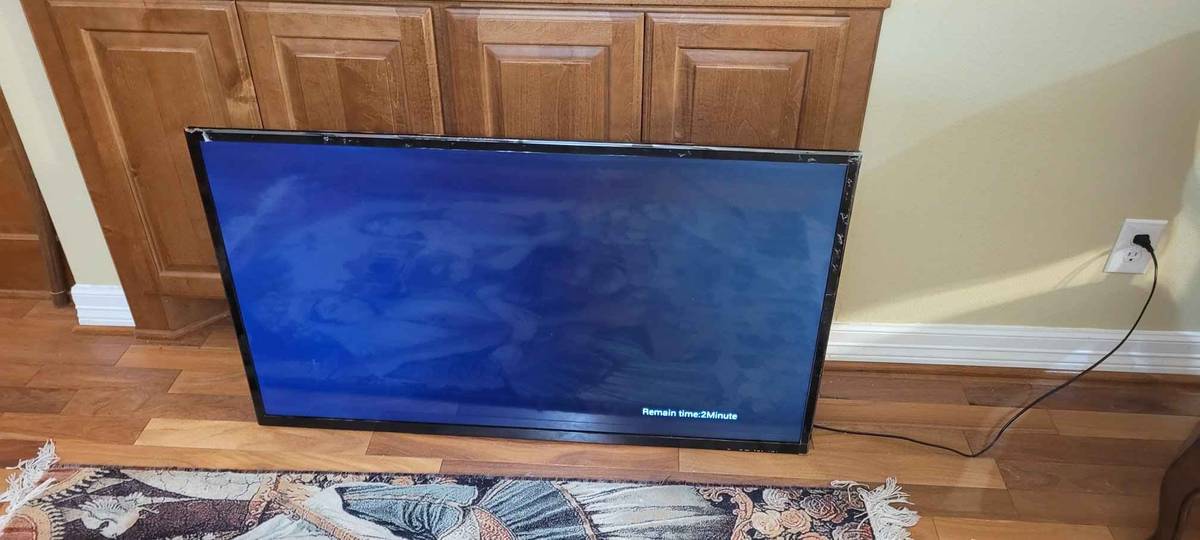

    I dont have this in my hands yet but was curious if anybody has seen this. He says it powers on then shuts down after 2 minutes. In the pic it has text that reads remain time 2 minutes.

    Perhaps it's because there is no input signal so the set automatically powers down or the sleep timer is set.

        I did get luck on one occaision. The set had an on/off switch at the rear and someone had switched it off and that was the only problem.

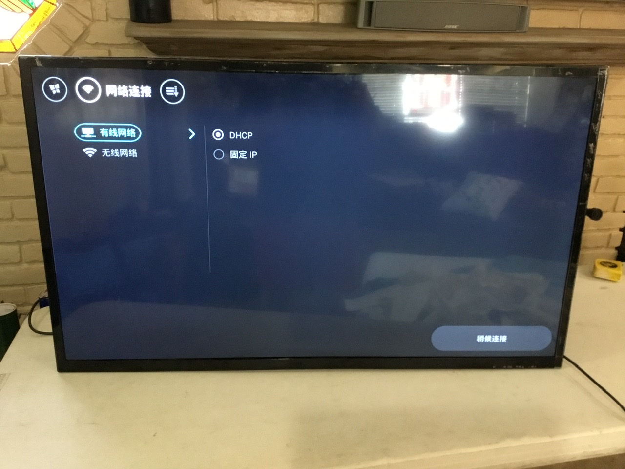

          Well this is a new one, maybe brought over from China. It was in English and I stupidly did a reset and now all Chinese. Need to order remote for it , buttons are finicky.

                Re: Phillips 48in
                Yeah buttons on bottom, they were kinda working before reset. Had to be pushed several time to get response but no response not in the language.
                • Hornnumb2
                  • Feb 2011
                  • 218
                  Re: Phillips 48in

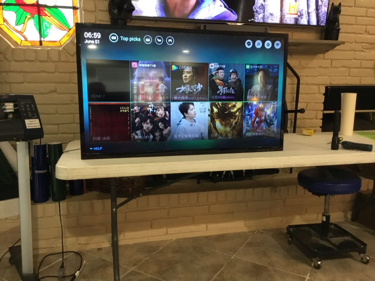

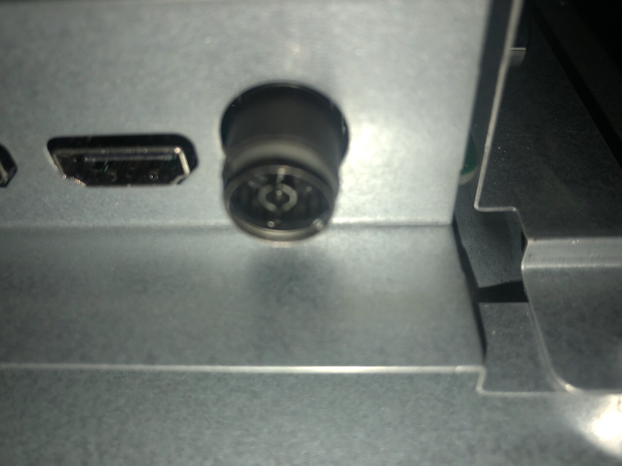

                  Well finally got it back to English and seems to be running fine, I got it for my travel trailer and I guess China uses a different connector then coxial. Any idea if I can get an adapter for it use antenna.

                    So out of curiousity wht was it shutting down after 2 mins.?

                      The adaptor could be "9.5mm PAL TV Connector to F Female Antenna Connector/RF Connector for CATV"
                      https://cz-cable.en.made-in-china.co...-for-CATV.html
                        It was some kinda timer but I went through the menus and couldn't find were to change it. That's why I tried the reset. No time limit now.

                          I guess if I want to watch Asian shows I am all set, could I flash it to English software?
