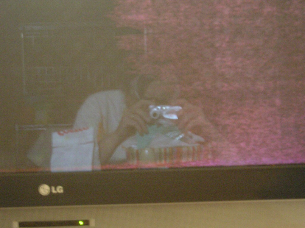

    This is another Craigslist bargain. The original owner indicated it was working perfectly, then one day it would not turn on. He loaded it up and took it to a shop where for $50 they told him it needed a Y-Sus and the Y buffer. Total cost to repair was unreasonable, so he put it up on Craigslist.
    A quick check shows this is one of the models with the infamous Y-Sus failures. Remembering Wizards recent posts, I opened the set up and checked the fuses on both the Y-Sus and Z-Sus boards; both are good. Then I checked the power at both boards (AFTER the fuses) and I see both voltages as specified on the sticker. 5Volts also checks out.
    The only other item of note is a red haze or sparkles on the right side of the screen. It's only visible in low light conditions, and even then doesn't show up too well in the picture I attached. (Ignore the guy reflected in the screen, he's just an old coot who lives here).
    Is this a sustain or buffer problem, or is it a panel failure? I do have a scope available, but the awful Korean / English training manuals give me a headache.

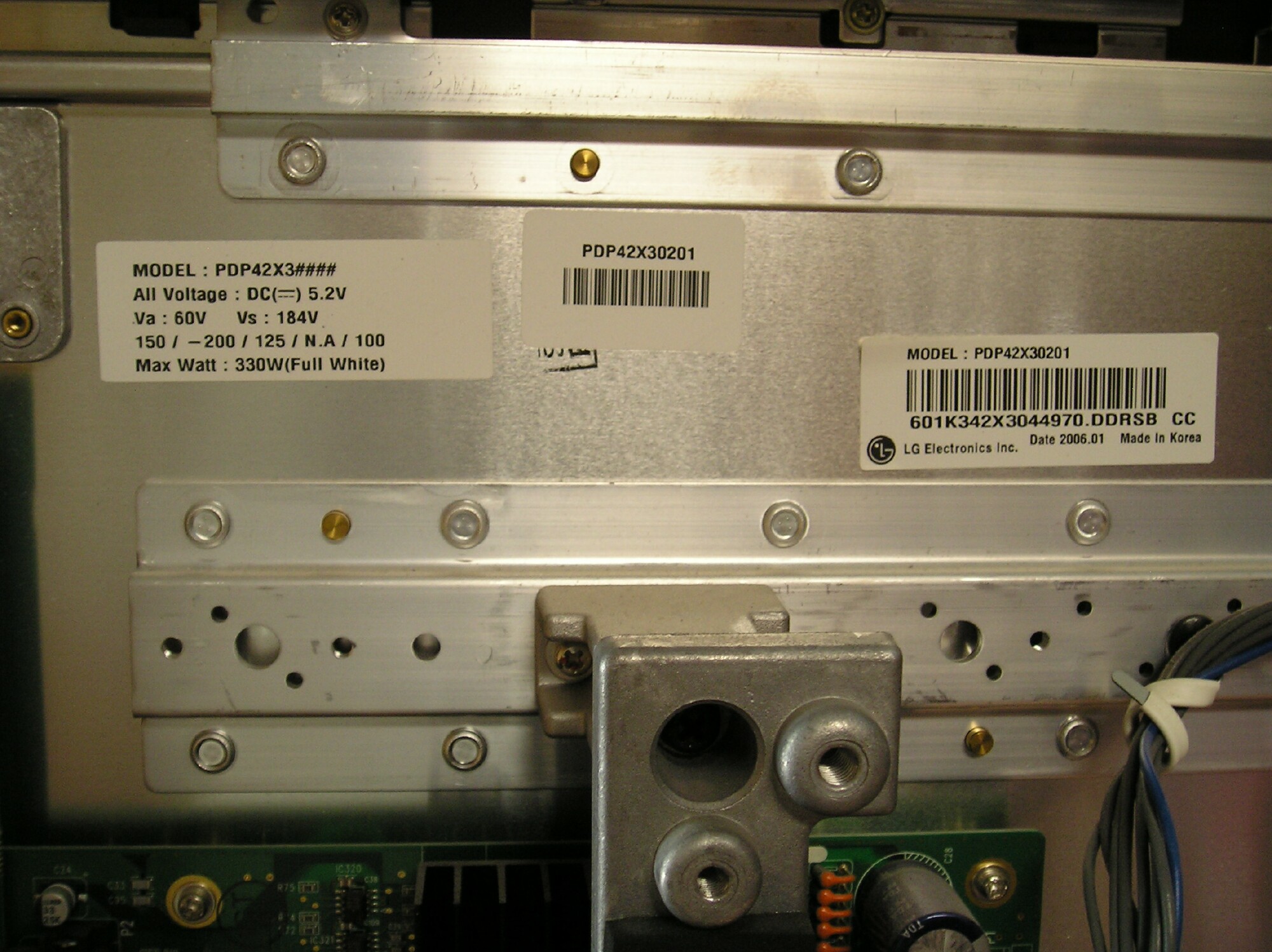

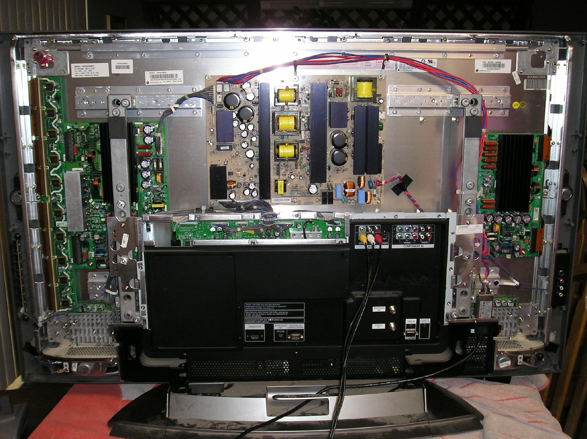

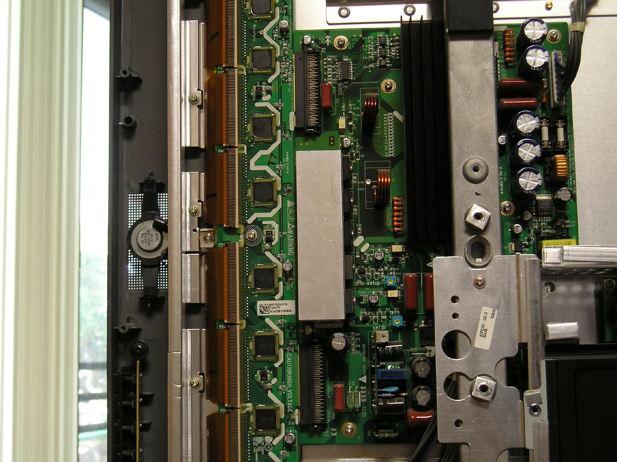

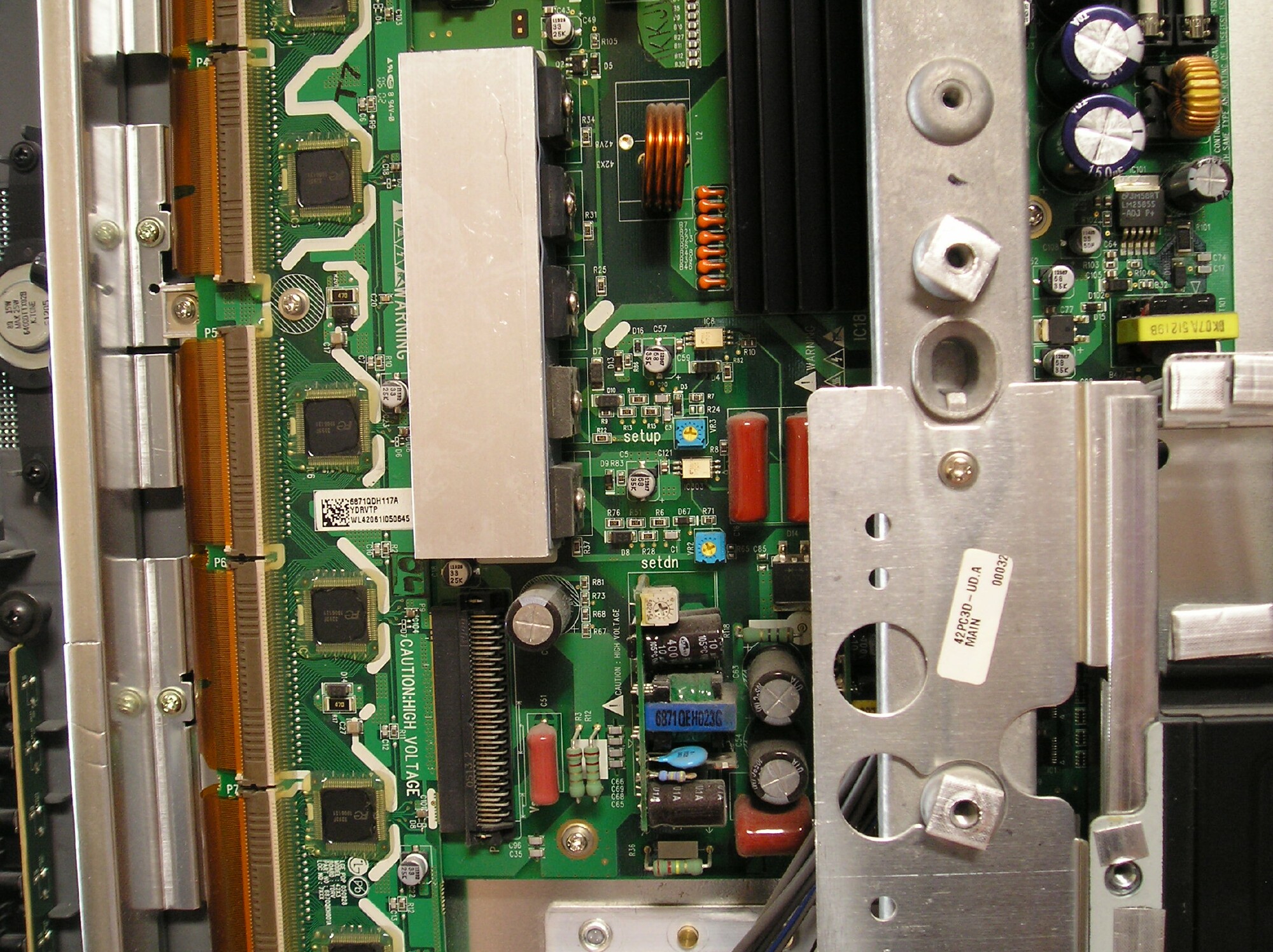

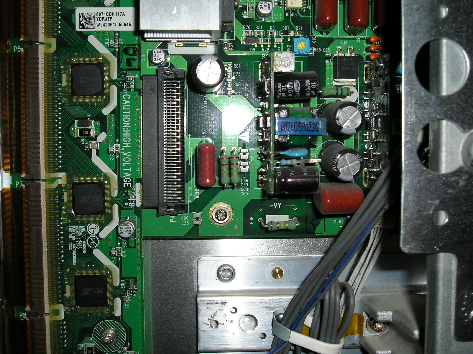

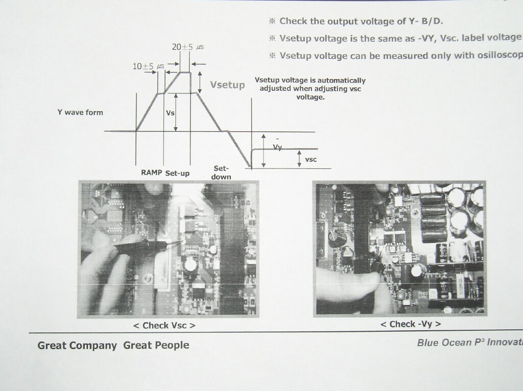

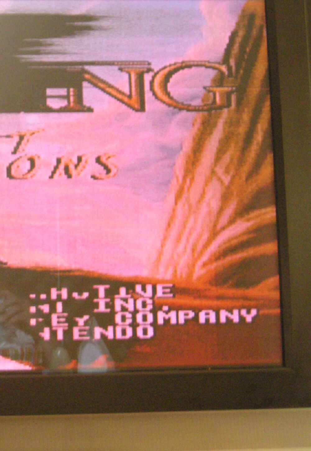

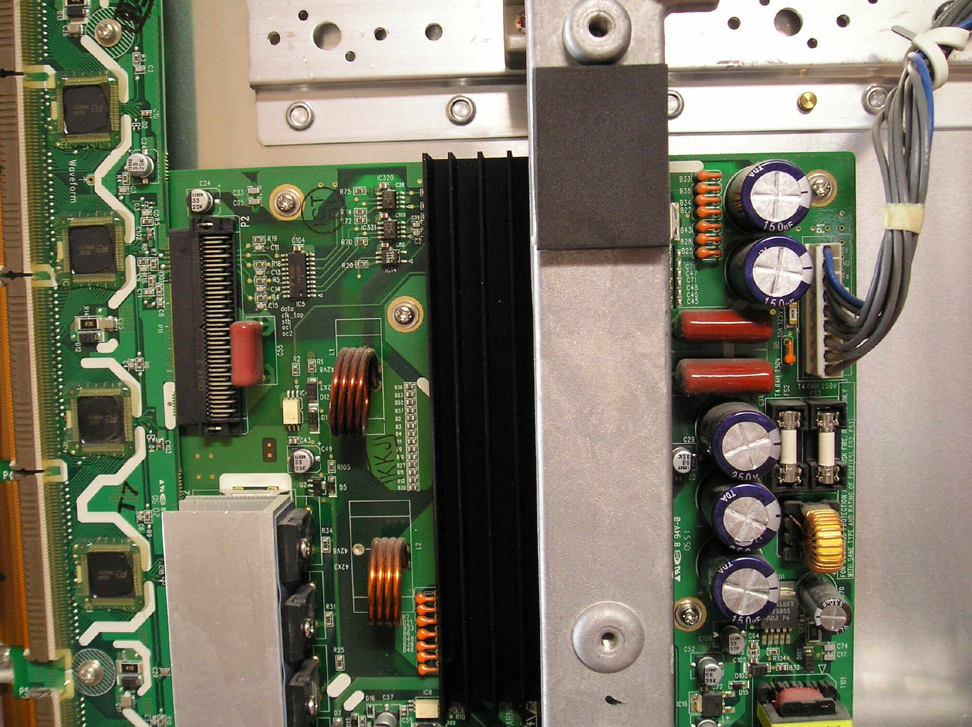

      Well, a little (darn little) progress has been made. A bunch of brain cells got together and stirred up the idea of our Super Nintendo to the AV1 input. As you can see, a badly distorted image is visible.
      The pictures in order are:
      1. Screen shot
      2. Back of the set with cover off (Yes, it's unplugged).
      3. Labels on panel
      4. More labels on panel
      5. The Y-Sustain board and the Y-buffer (driver?) board
      6. The upper portion of the Y-Sustain board and a portion of the buffer. (Wizard, is the 'Waveform' test point significant?)
      7. The lower portion of the Y-Sustain board and a portion of the buffer. Note a bunch of pots I did NOT touch.
      8. Detail of the lower portion of the Y-sustain. Note label indication test points for VY and pins carrying Vsc to the buffer.
      I've gone over the training manual you referenced, Wizard, but while I've gleaned a few bits of information, I'm nearly clueless about what I am seeing. The two things that come to mind is this is probably not a problem in the main board or the panel control board. The video is being passed to the display. The second is this seems to correspond to page 33 of the Training Manual. Should I be measuring Vscan? Checking the Waveform test point with my scope? I do have it at hand, but I would rather not subject it (or myself) to 200 volts.

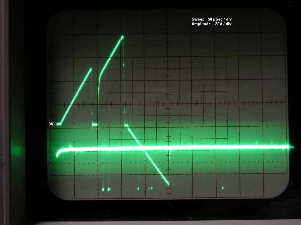

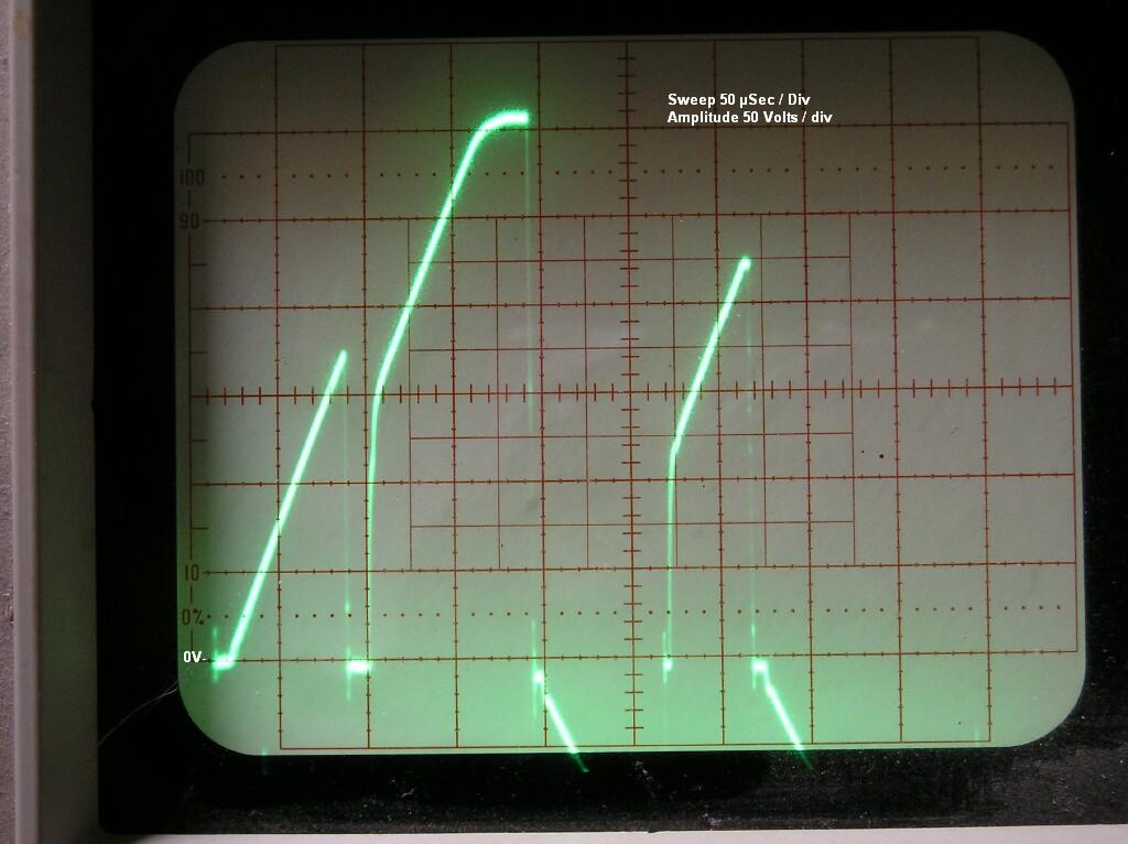

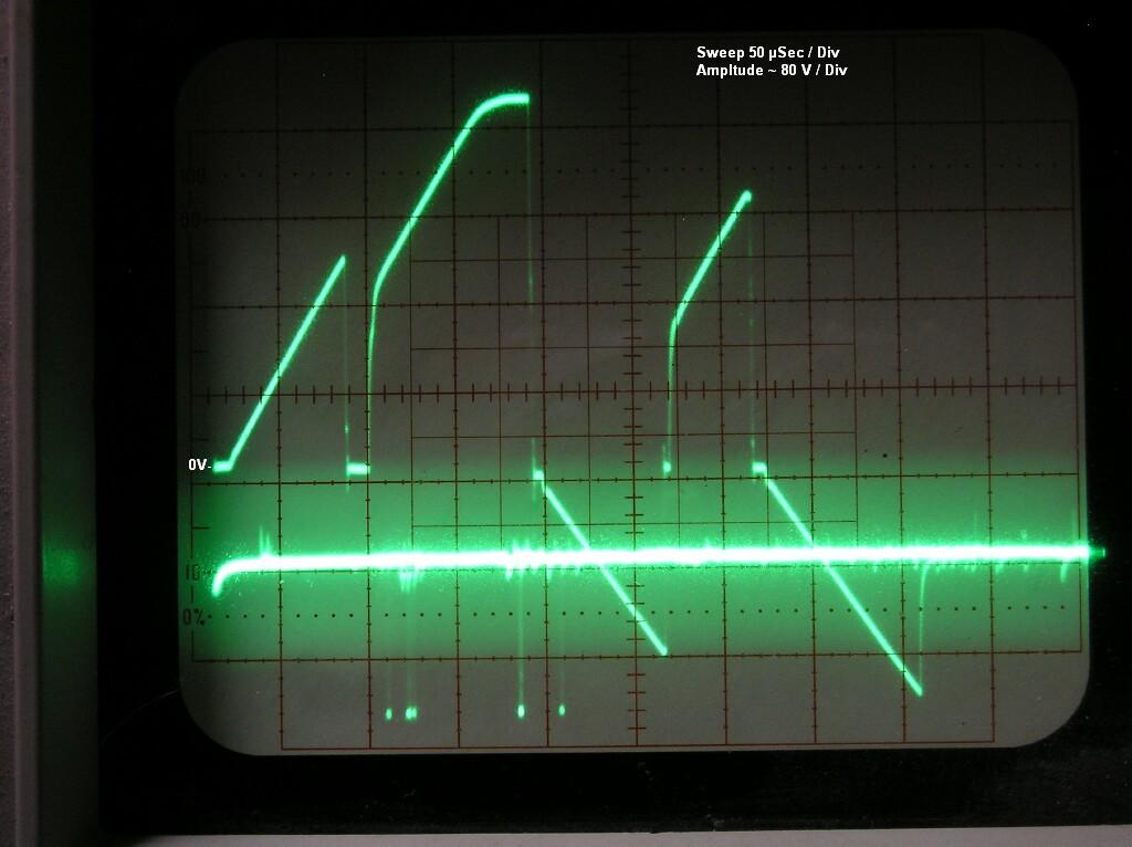

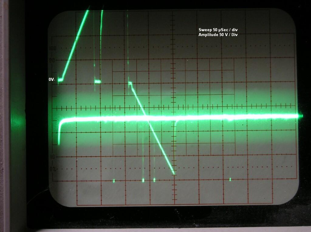

        I'm shooting in the dark here (literally, the lights in the room were off when I took the following pictures to reduce screen glare). The waveforms were taken at the point on the buffer board labeled 'Waveform'. The scope settings are noted on the pictures, as well as the approximate 0 Volts point. The TV was showing the opening screen of the Super Nintendo game 'The Lion King'. (And I've got the theme engraved in my mind - HELP!!!)
        The ideal waveform is also included. The obvious difference is the plateaus shown in the ideal waveform are not present on the actual waveforms. I'm not sure if this indicates a problem in the buffer (driver) board, a problem on the Y-Sustain board, using an incorrect input signal, or other user error.
        Vsc measured 124 Volts and -Vy was -199 Volts.

          I think this is taken with white field or black field on the screen. Does not look quite right.
          Move around probe test points till you find one that look right. Usually on the Y-buffer board.
          Cheers, Wizard

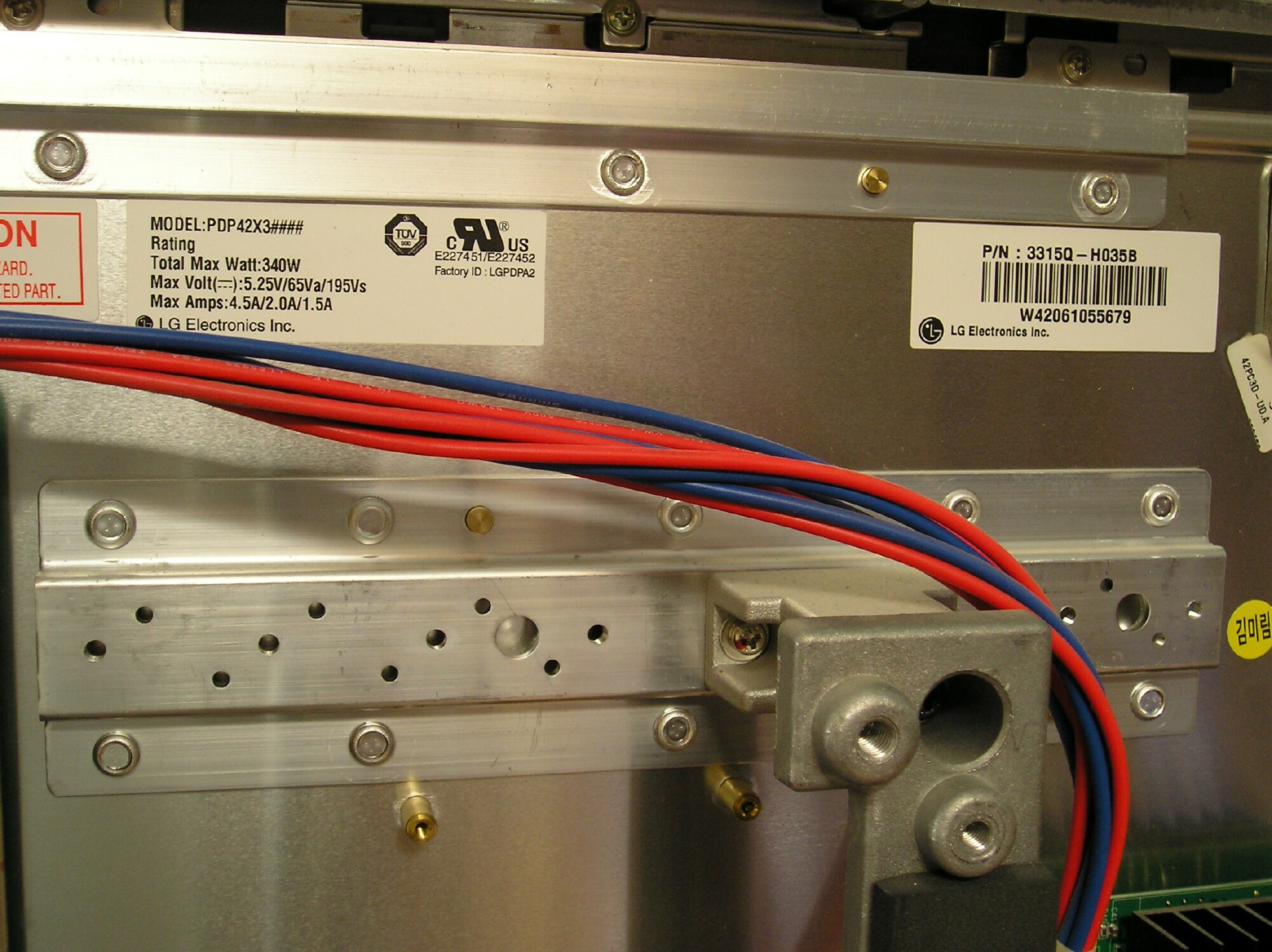

                  Well, we are making progress. I was able to purchase a pair of NEW Z-sus boards for a company in Miami at a ridiculously low price. I now have a pair of working 42" LG plasma TVs. I was thrilled to discover that the 42PC1DA had less than 700 hours on it, and a fantastic picture.
                  The 42PC3D-UD didn't turn out quite so well. It has over 9000 hours on it. While it will blow away a CRT TV, there is a slight pink tint to the screen, especially noticeable when I set it to display a white screen. The service manual does give instructions on adjusting this. The first paragraph begins

                    Use grey scale bars and adjust for white and untinted grey. That is done with rgb drive and low light rgb adjustment in the service menu.
                    Pink is worn out panel 9,000 hours is what does it especially on torch mode.
