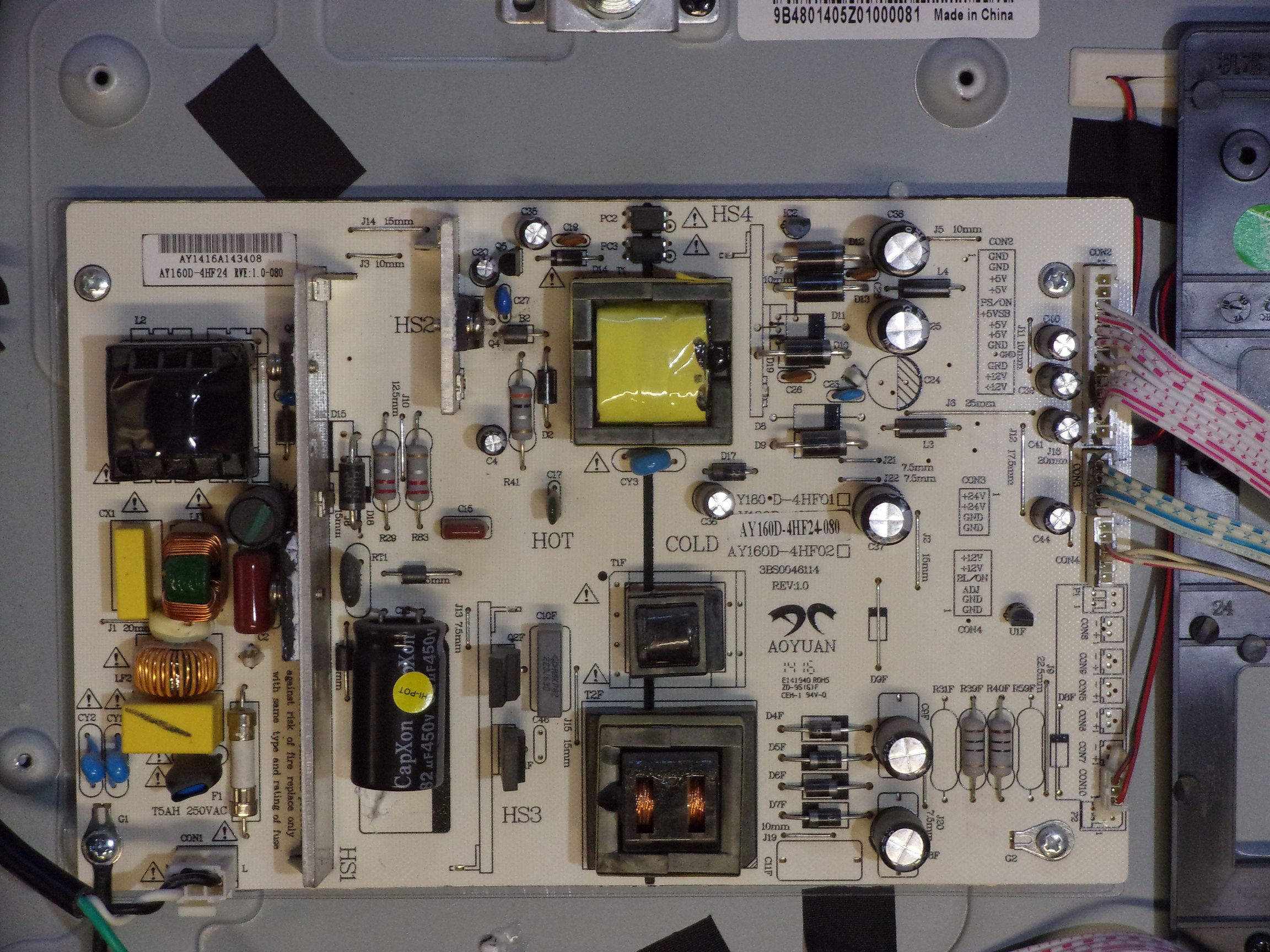

    Power on ½ the time just stays on red LED (off).
    Unplug - wait - plug in - powers on blue OK.
    When on, works perfect.
    While I have soldered many many times, and have
    testing tools - maybe I've gotten lazy in my old age.
    Looking online for Power Boards - AY160D-4HF24
    I see many similar - for X505 - AY160D-4HF32.
    Same basic board # - 3BS0046114.
    The screen size - I think - is only 1½" difference.
    Do you folks think the ~~4HF32 will work ?
    (AY160D-4HF24 hard to find - that's why looking at X505 bd)

    I would suspect one of the small electrolytic caps could be bad, (going by a ay160-4hf38 picture) I would replace C4, C20, C35. These are usually the ic's vcc and startup caps.

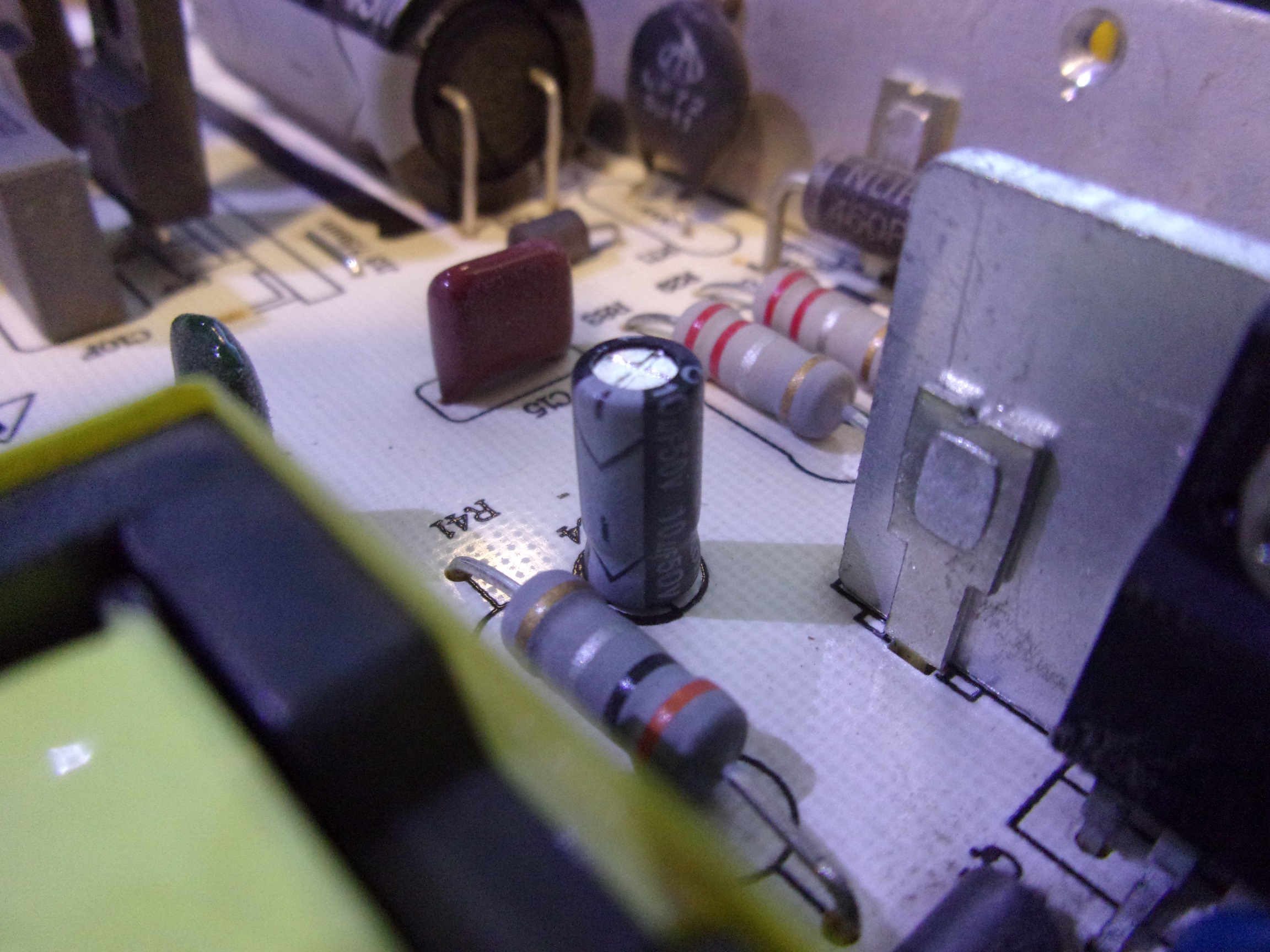

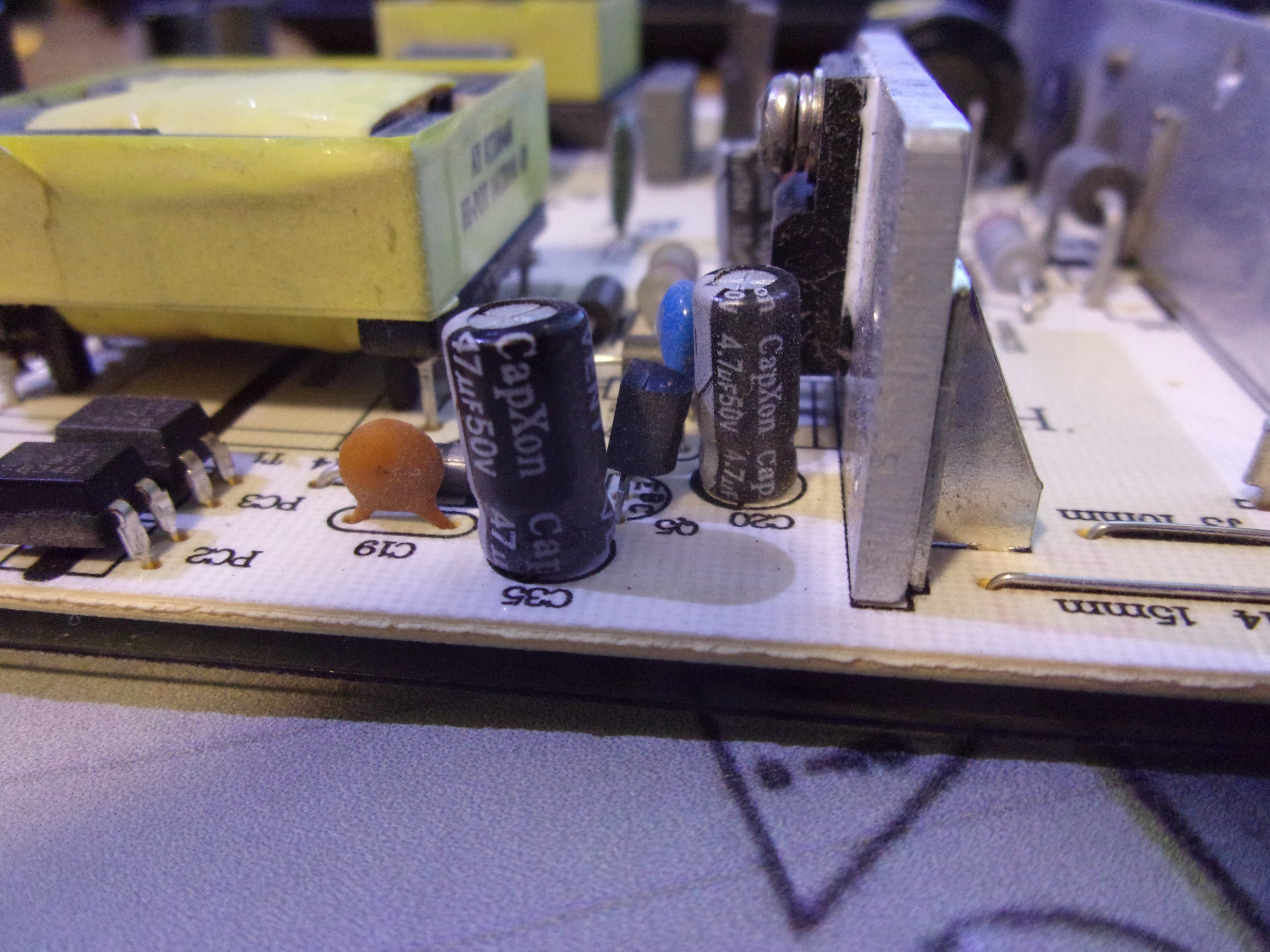

      Re: Intermittent power on - sceptre E485BV
      So, naturally, all 3 are different.
      Here's pic of board - and the 3 caps.
      SINCE I'm going to be replacing, are there
      others I might as well do while I'm at it ?
        Well, I changed those 3 caps R_J mentioned.
        No change. Back to original question :
        I have/need AY160D-4HF24 - would AY160D-4HF32
        (for X505) work ? They sure look exactly alike.
