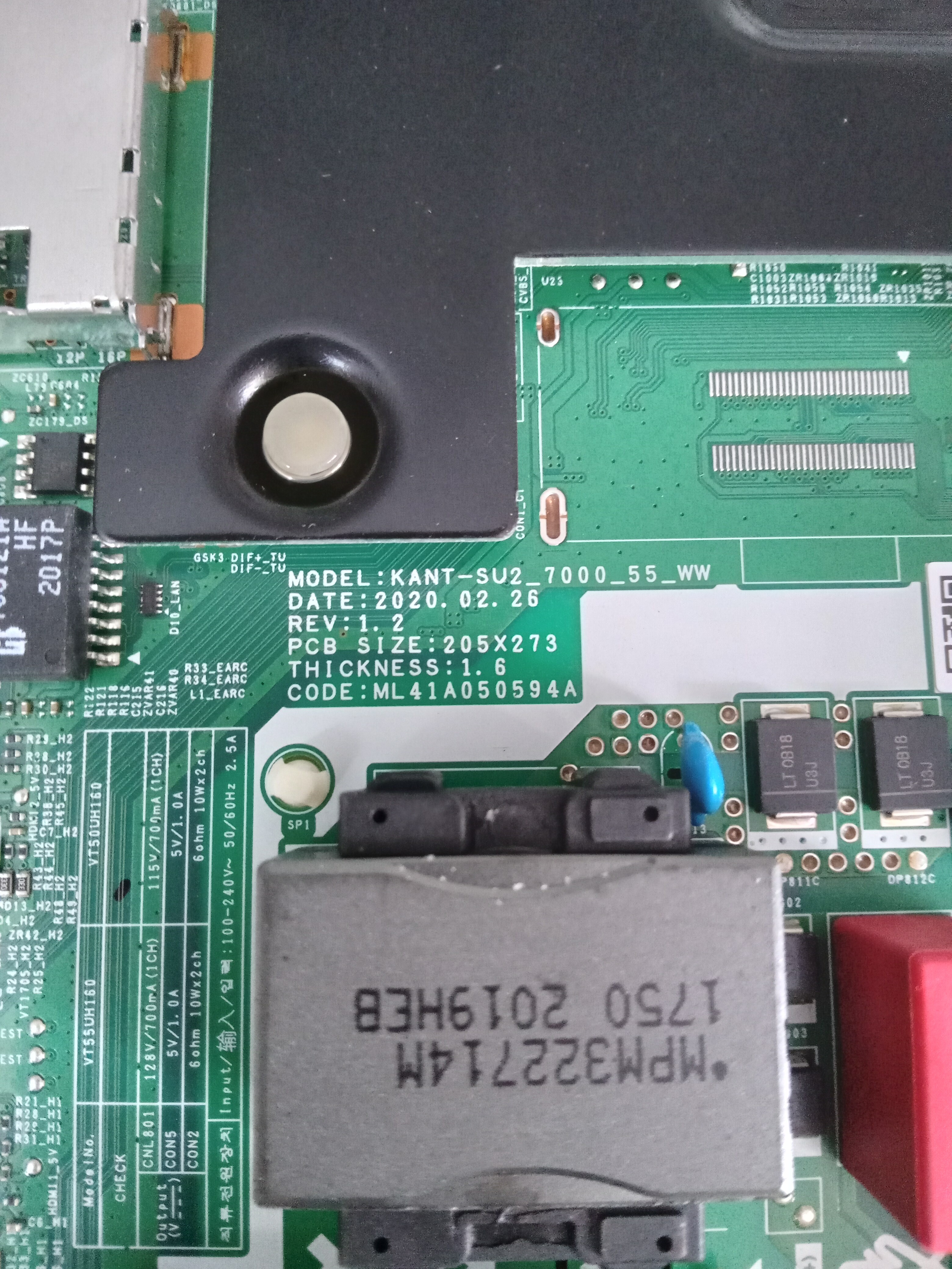

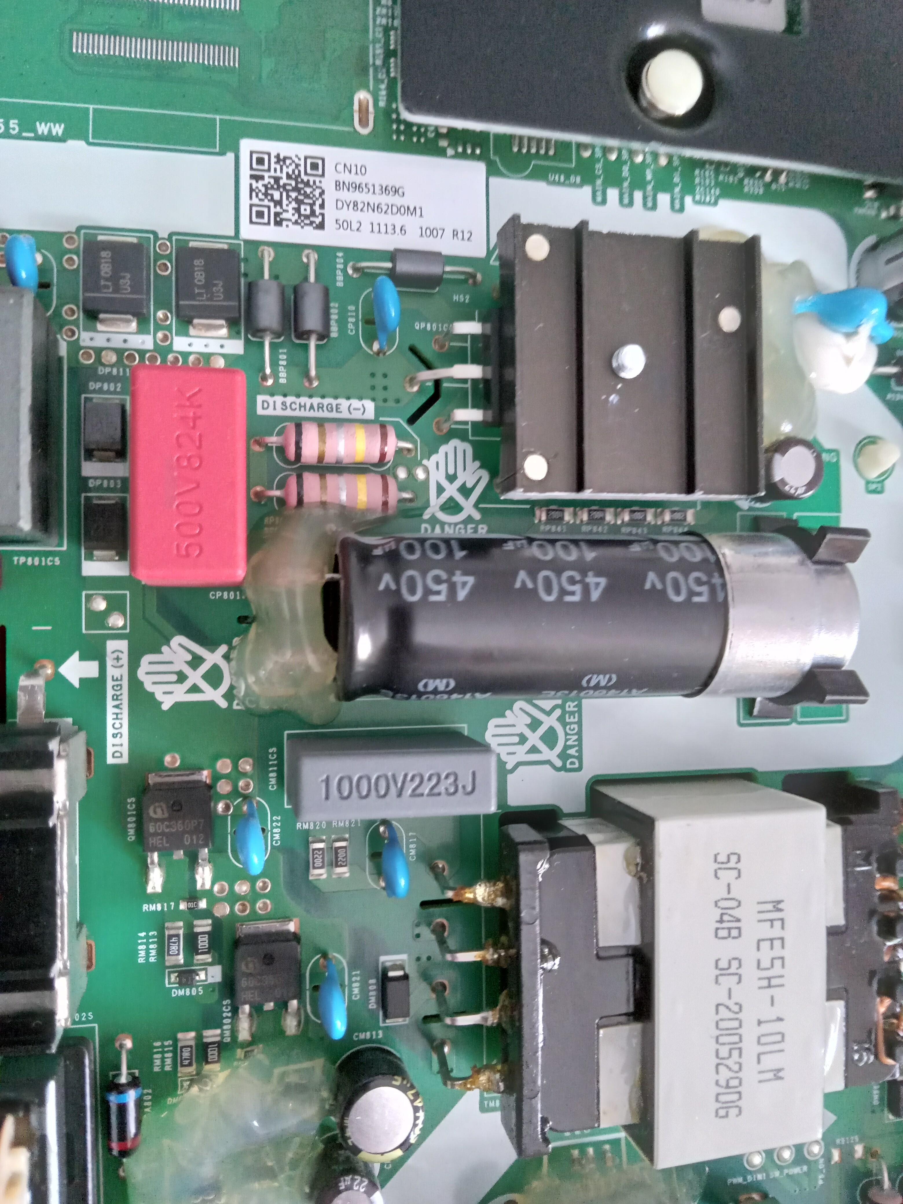

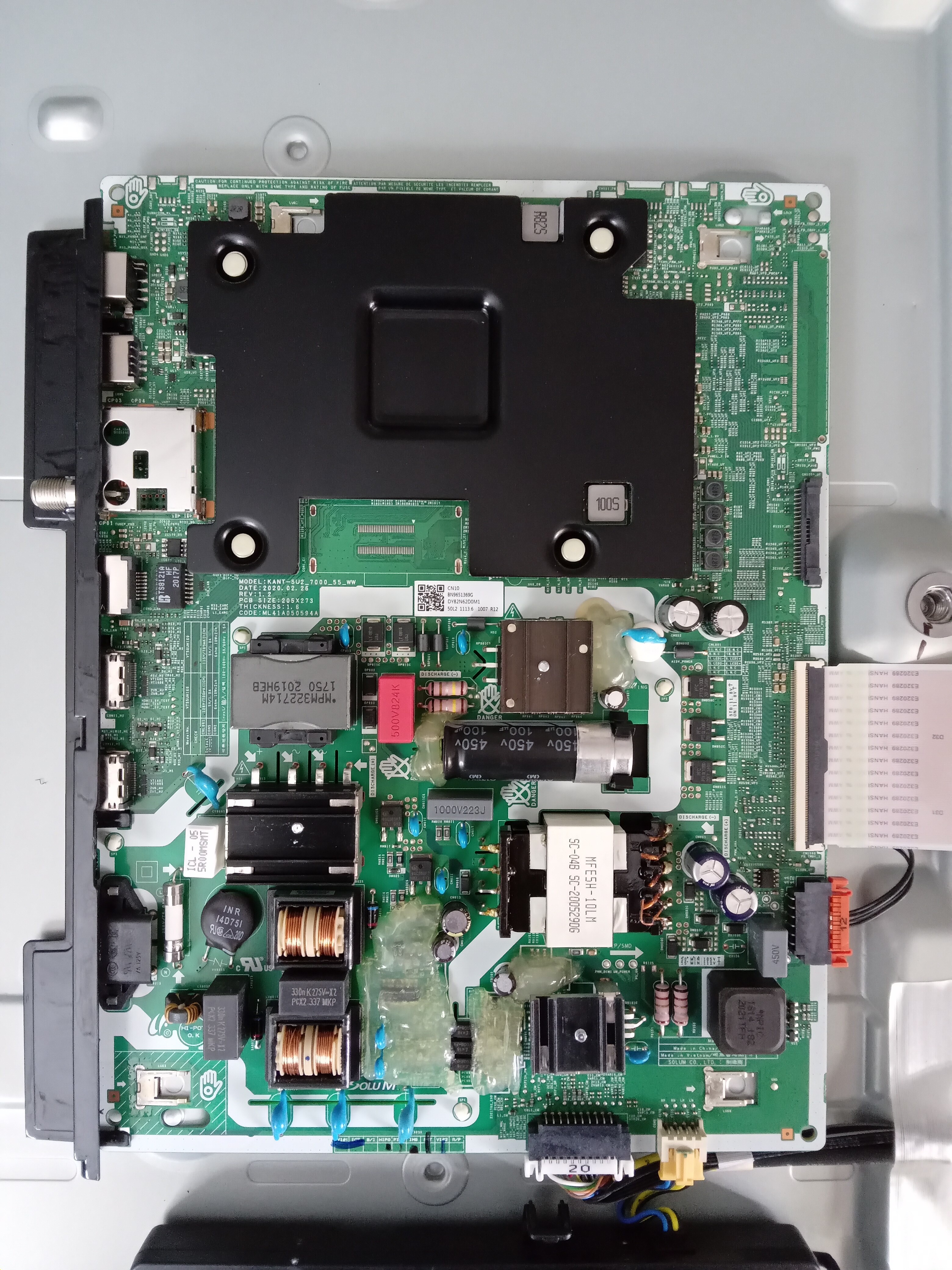

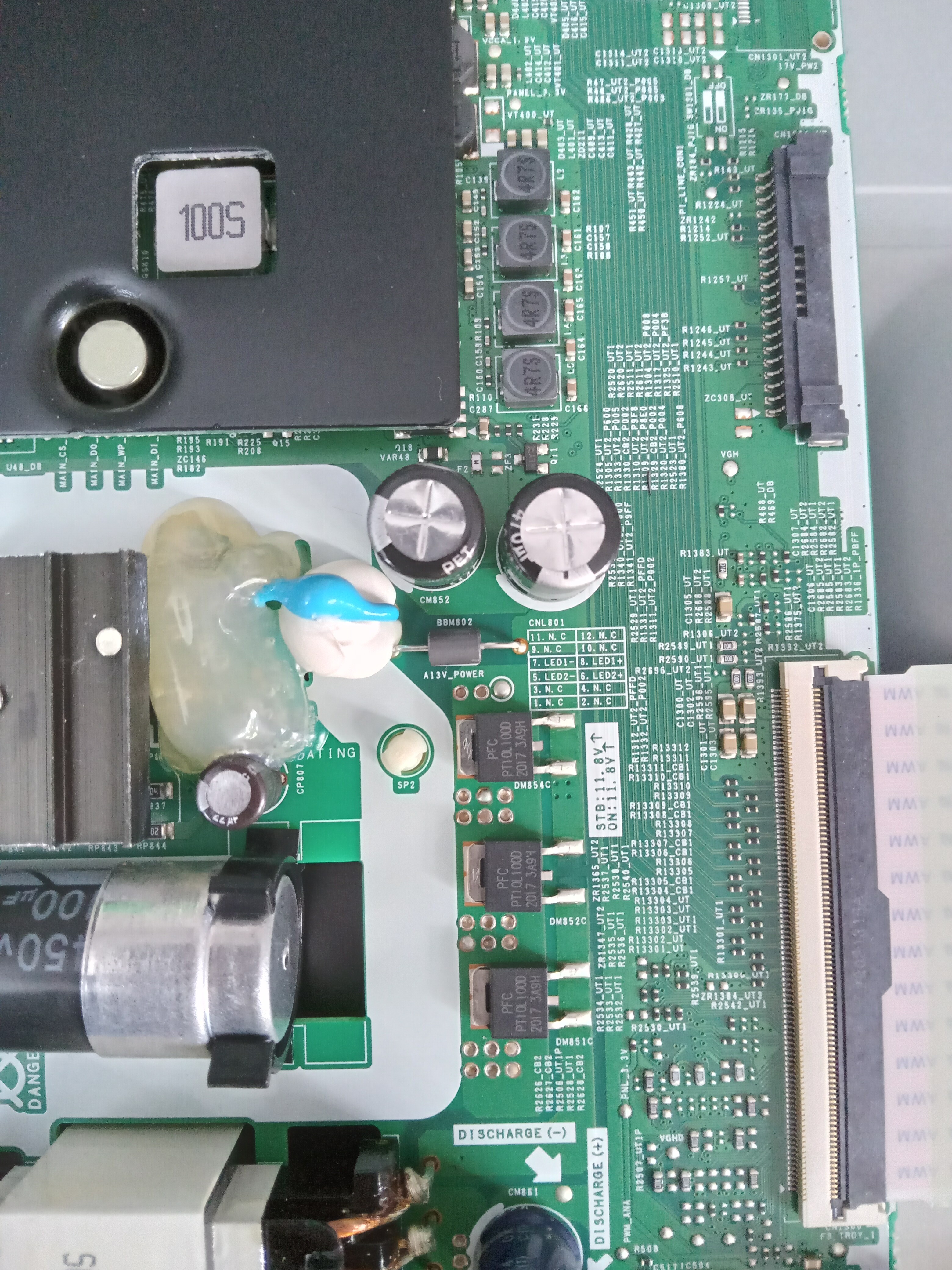

    Hi everyone, this model samsung tv works well until it randomly starts rebooting, it may do it within 5-10 mins after turning on or it may do it after a couple hours, sometimes it never does it, may work for days at a time.
    It has one the these AIO boards :
    I get 393dcv at the main cap see pic 2 and 12.9dcv at the stb test point as seen in pic 4 - this is with tv on and working.
    Any ideas or help is appreciated.
