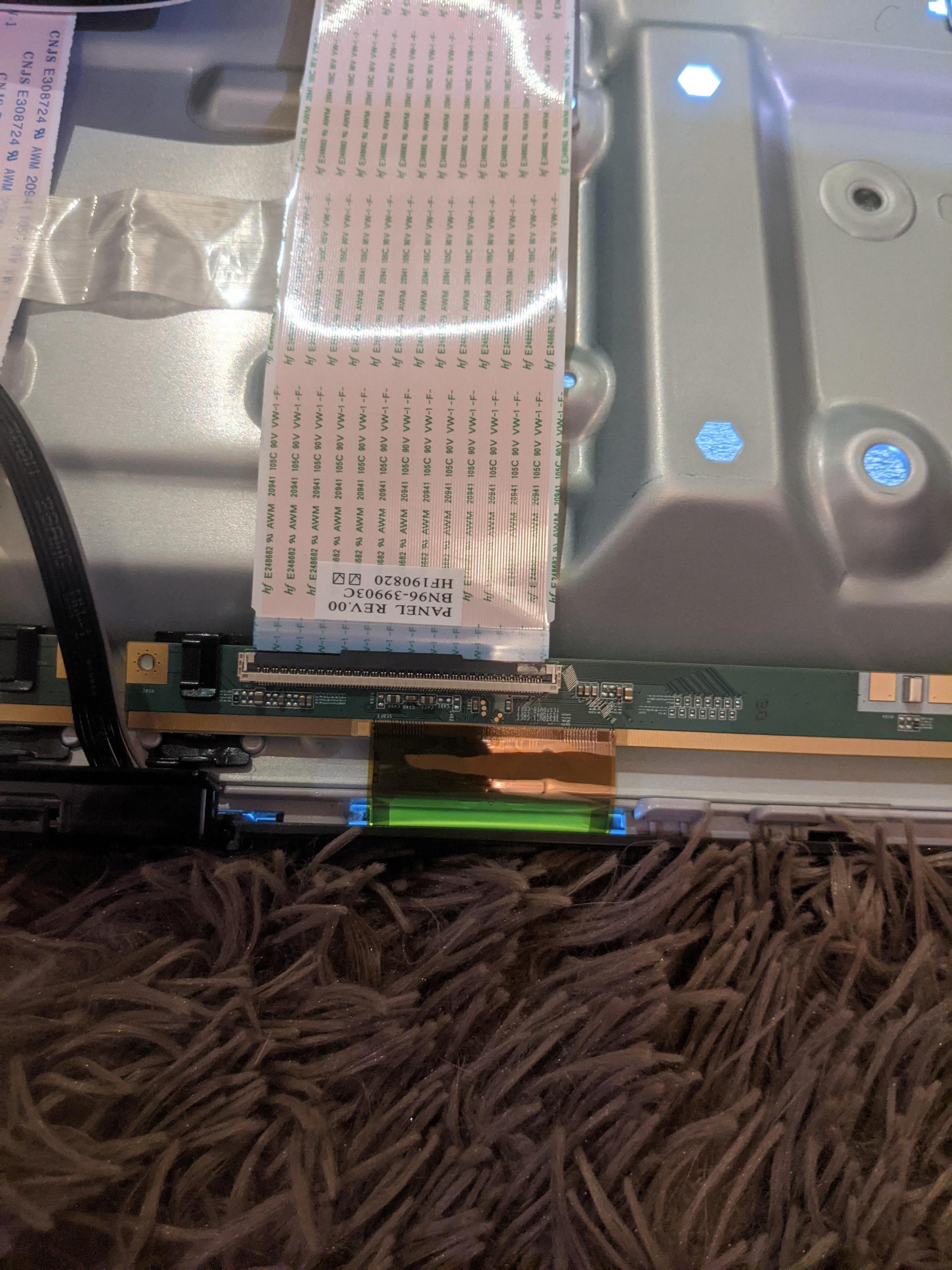

    Samsung UN70NU6070F power cycle.
    http://imgur.com/gallery/iqa5KiY
    Samsung UN70NU6070F

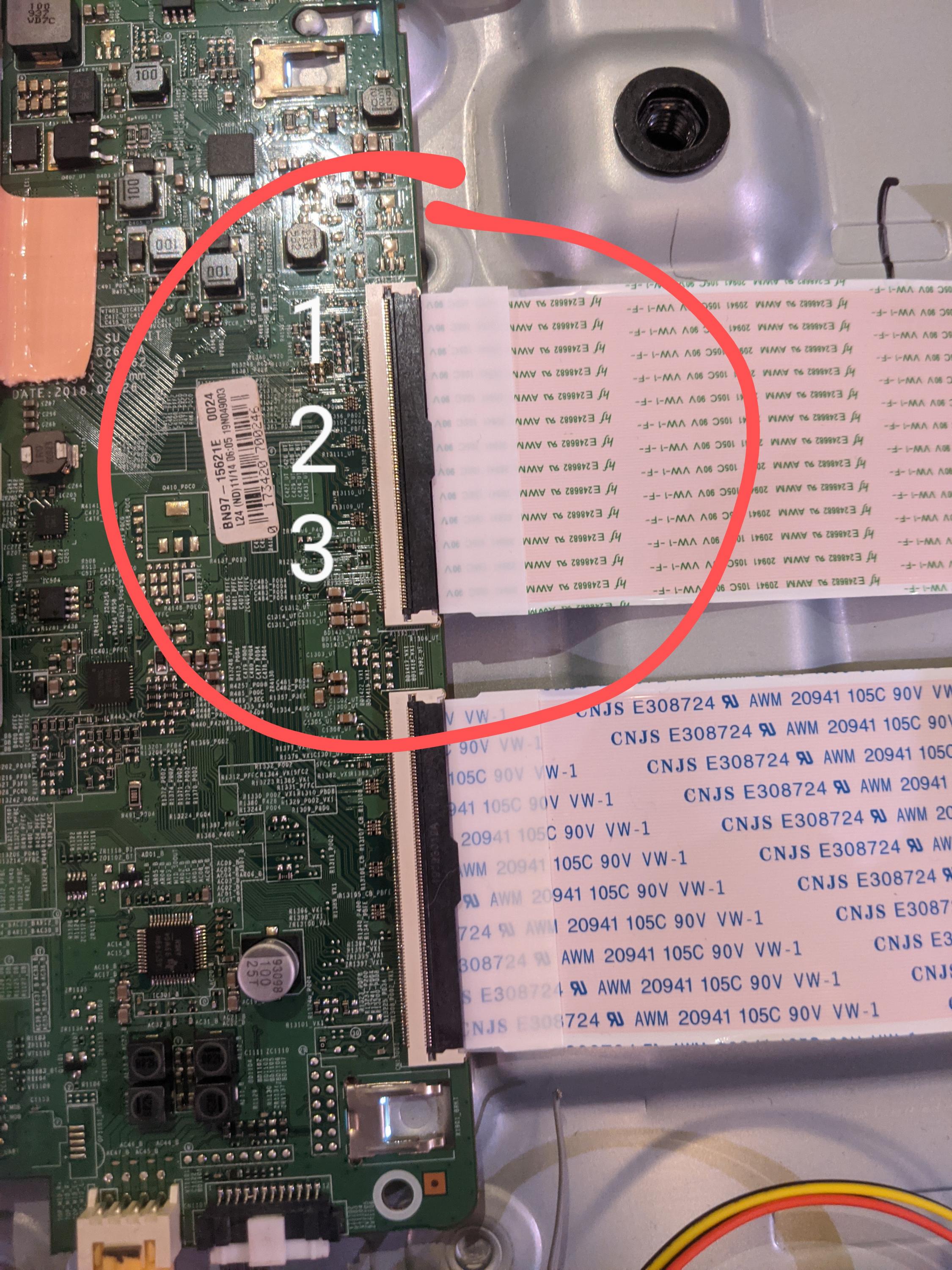

    Picked this tv up off marketplace for 50 Canadian coins.
    Old owners say it got darker and one day just died. If you plug it in it will power cycle non stop. I opened the tv up and if you unplug mb from power supply backlight will turn on and stay on. As soon as you plug in mb it will power cycle again.
    Next thing I tried was unplugging the long flat cable from bottom of tv. Doing this and waiting to plug back in will make it so that I can get a picture and sound.
    Next thing I tried was unplugging this long cable again and leaving unplugged. I was able to play audio with no picture.
    When it powers on it looks great, no weird lines or anything. If I can get it to stay on what a steal lol.
    What should I look for? Bad tcon board? Bad power supply? Bad mb? I'm more lost than ever

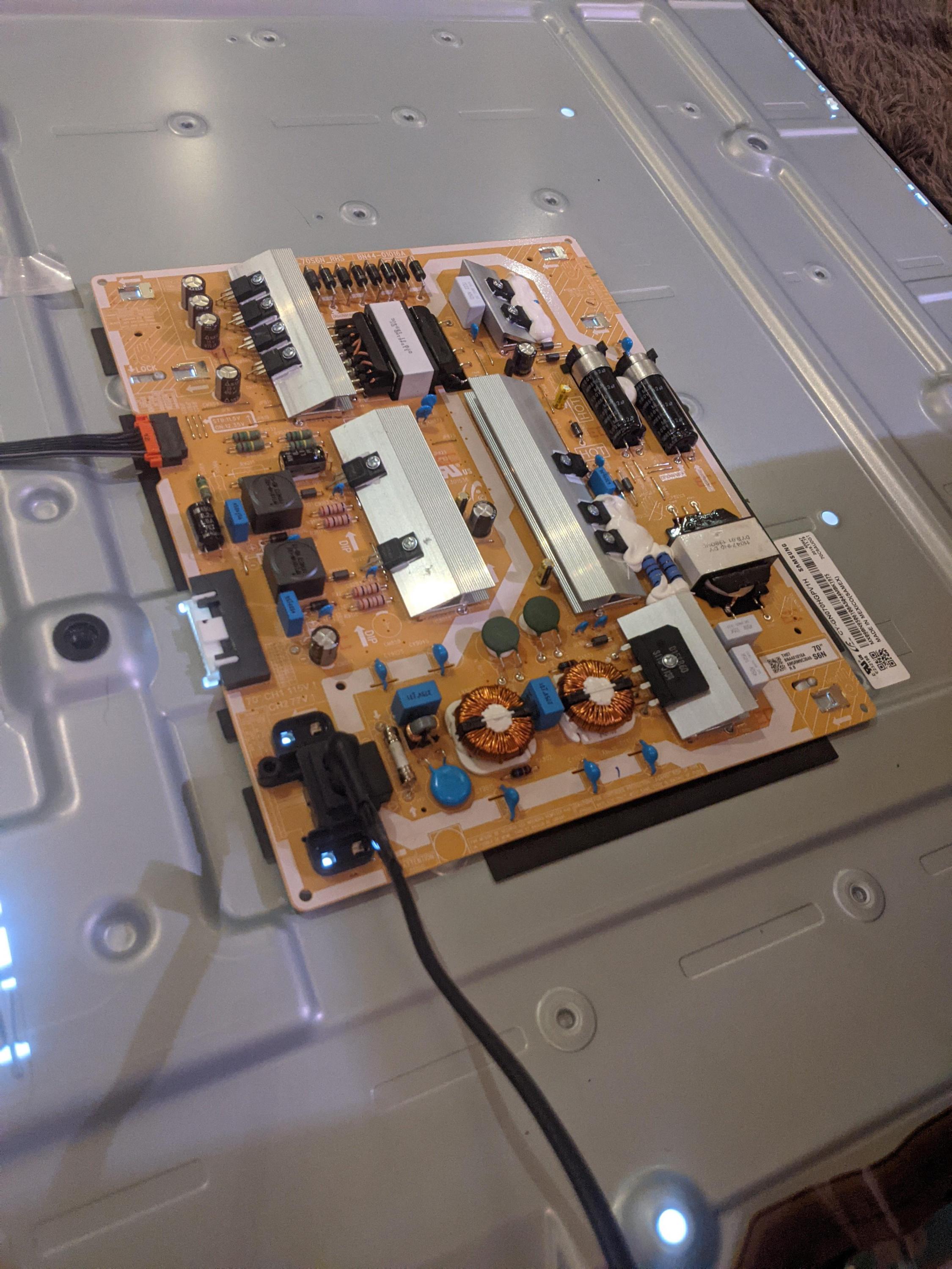

      Re: Samsung UN70NU6070F power cycle.
      Unplug the cable on the power supply to the main board and see if the backlights stay on when the tv is plugged in like that.
      If it does unplug tv and reconnect cable.
      This time undo the lvds cable going to the panel 1 at a time. And then both.
      Report results if the tv is still rebooting or stays on.
      Note the tv will show nothing when both lvds cables unplugged so watch the led light or the optical on the main board to see if it restarts.
      A lot of these NU series tv sets have bad leds. Usually it doesn’t cause the tv to reset though.
      If you have the Samsung logo visible when first powered on I would say the tcon is good.
      Could be panel fault or main board at that point

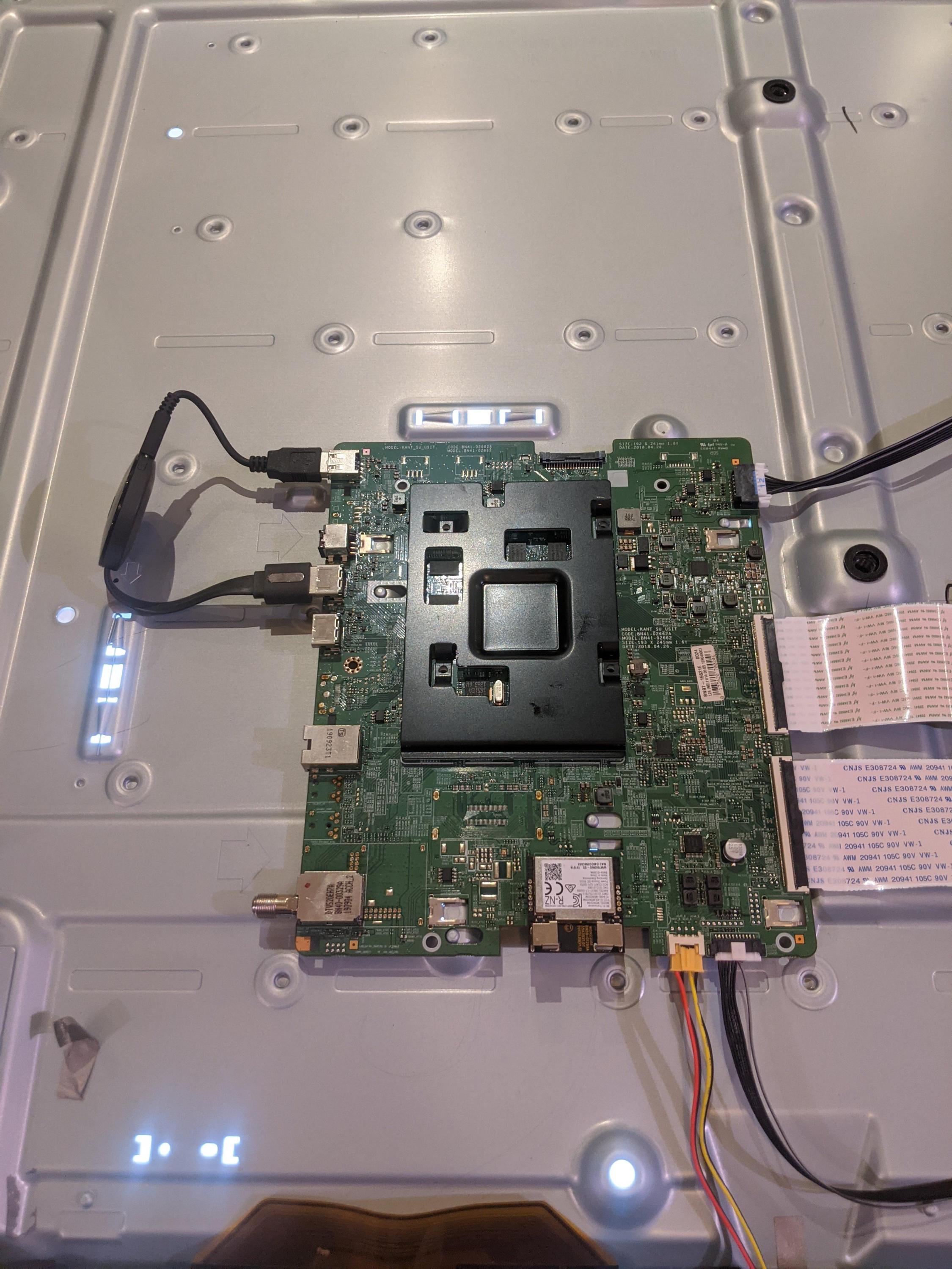

        A lot of these NU series tv sets have bad leds. Usually it doesn't cause the tv to reset though.

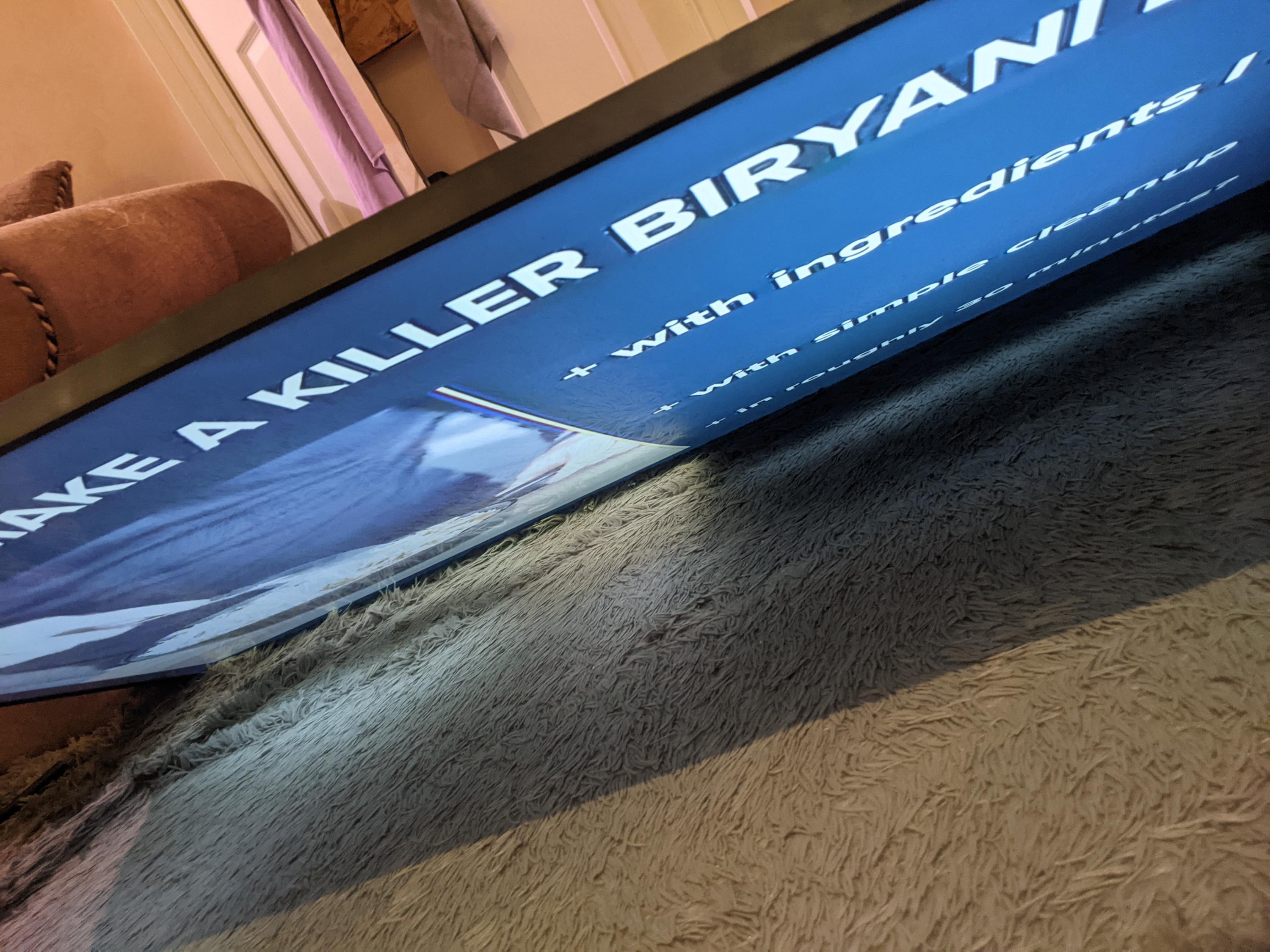

        If I unplug main board from power supply back lights stay on.
        If I unplug one or both of the lvds cables tv will boot and stay on
        If I plug the lvds cable back in while it's on tv will work perfectly. Until you turn it off or repower it. Then it will start power cycling if you try and turn it on again. I plugged in a Chromecast and was able to play an hour of video before I tried the power cycle.
        When on panel looks perfect.

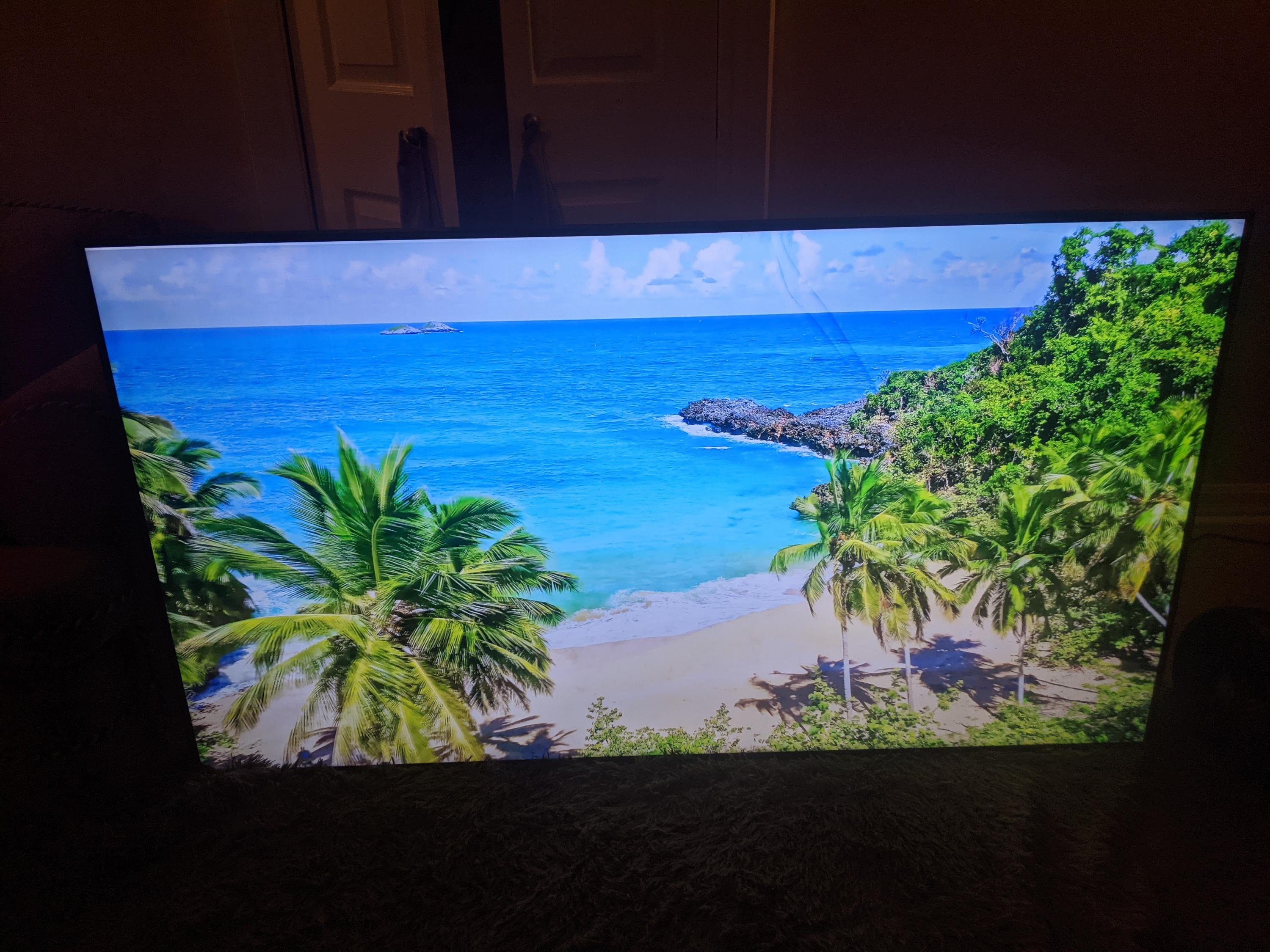

          Here's a pic of the screen on. Hard to get a good pic with the display facedown.

                Ok. That seems to narrow it down to the panel then. You can check the lcd board that the lvds cable connect to for bad smd capacitors.
                If nothing is shorted then only thing I can think is the panel is bad. Last resort is the tape method. Try taping off some pins and see if that works. YouTube it if your not sure to get an idea

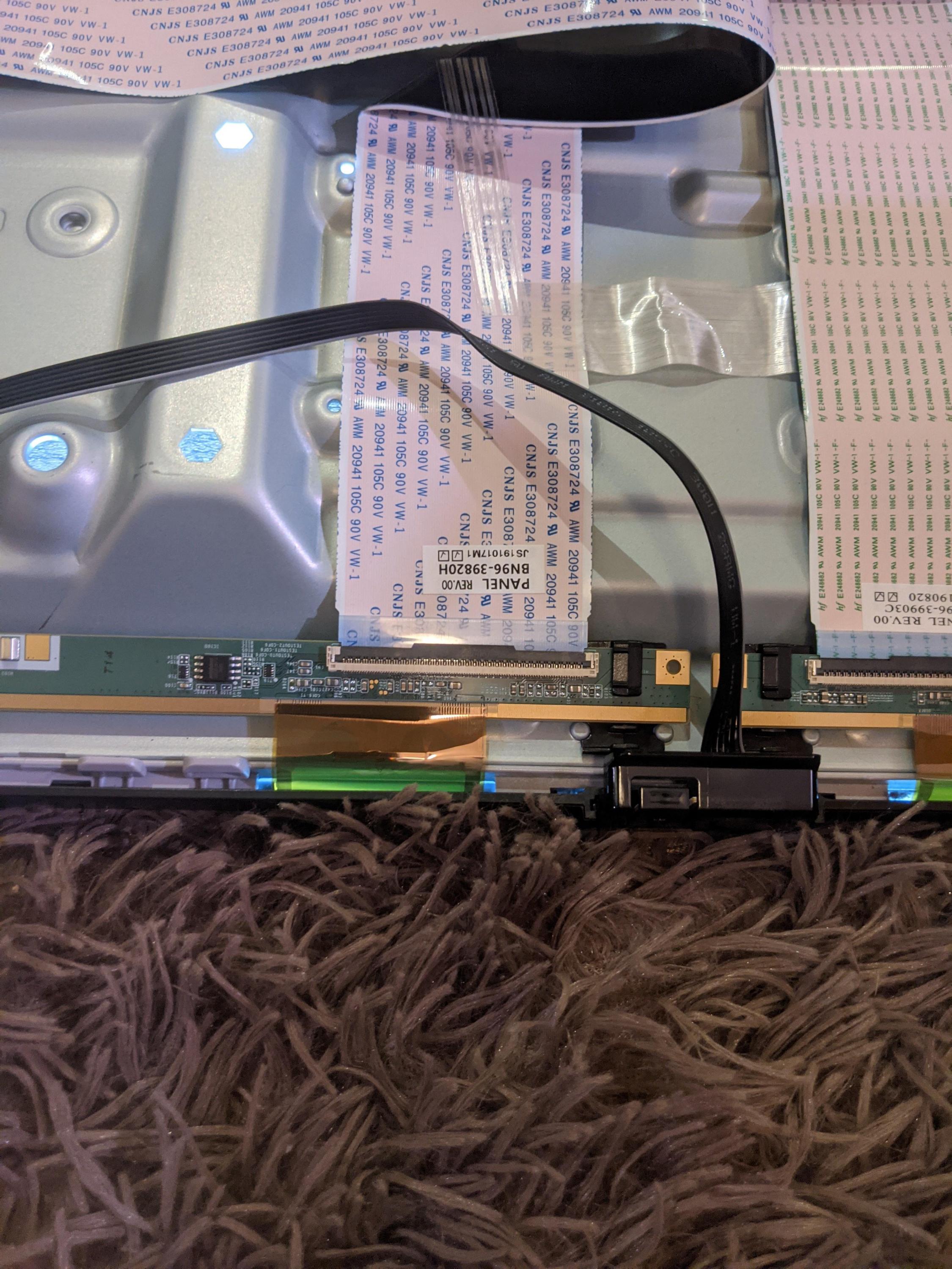

                      Unfortunately you cannot see anything with the screen. Just have to try taping off a few pins at a time and see. It’s a tedious trial and error kind of thing.
                      It’s kinda odd it worked fine after plugging in the cables when the tv is powered on. Usually if there is a short it would not work. It’s must bypass a check after startup or something.
                      • Neednos
                        • May 2021
                        • 12
                        • Quebec
                        Ya after its plugged back in it seems to work fine. So I should look for the pins labeled something like CLK cover them and trail and error uncover them one by one? I see on other videos they unplug one side of display and theyll get a half picture. For me it's nothing when I unplug either side and again when either side is plugged back in I get a full picture again.
                        Unfortunately you cannot see anything with the screen. Just have to try taping off a few pins at a time and see. It's a tedious trial and error kind of thing.
                        It's kinda odd it worked fine after plugging in the cables when the tv is powered on. Usually if there is a short it would not work. It's must bypass a check after startup or something.
                        • Storyteller12
                          • Jun 2020
                          • 624
                          Yes that’s pretty much how you go about it for the tape. I forgot this tv doesn’t have a separate tcon. It’s built into the main board I believe.
                          Not positive but that may be why you don’t see anything on half the screen with just one side plugged of the lvds plugged in.

                                Ok. I think I got the answer for you. Came across this today. I was right on about the tape method if it’s the name problem.
                                It’s the top lvds on the main board. If you pull it up and the pins are facing you, cover pin 15-24 or 25 starting from the left with tape. Black electrical is best but scotch works.
                                Plug it back in and should work if it’s the same problem.
                                Let me know if it works for you. If so enjoy your new TV.

                                  It's the top lvds on the main board. If you pull it up and the pins are facing you, cover pin 15-24 or 25 starting from the left with tape. Black electrical is best but scotch works.
                                  Plug it back in and should work if it's the same problem.

                                    Yes that’s the lvds cable. Unfortunately I believe it’s the panel not the main board. The panel is shorted on the inside somewhere

                                      Didn't mean to post the same thing twice..wanted to ask if this is repeated the same way on the other cable? If I might have to try this on both sides?
                                      What do these pins do? Are these the clock pins I was reading about

                                        Just the 1 cable. Not both
                                        And yes, your just blocking the signal with the tape
