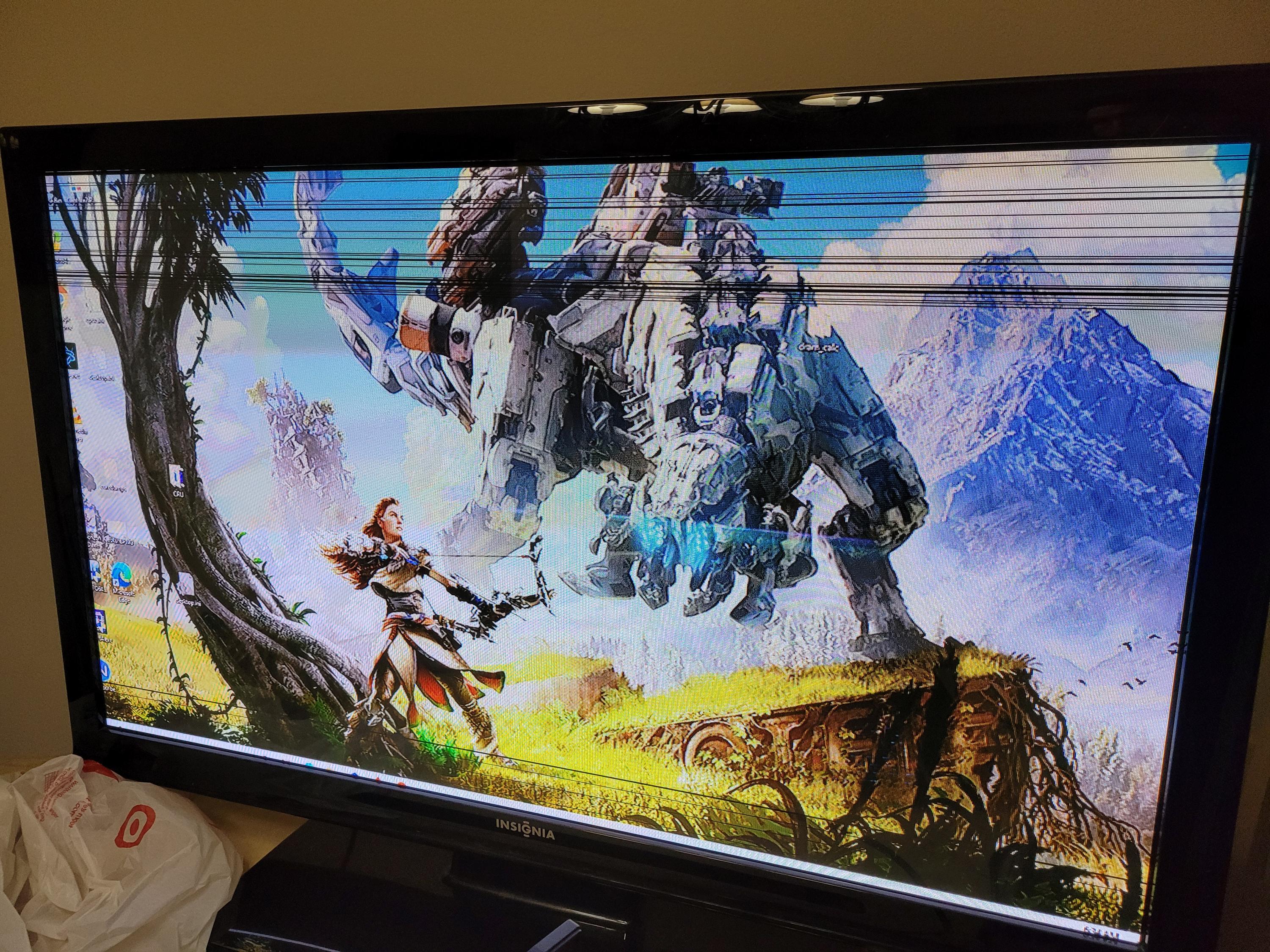

    Insignia plasma n2-42p650a11 black horizontal lines
    Hi I picked this up on the side of the road. It has black horizontal lines on the display. It's it repairable?
    I looked for bulging caps but didn't see any.

    Re: Insignia plasma n2-42p650a11 black horizontal lines
    I tried to reseat the connecters but it made no difference.

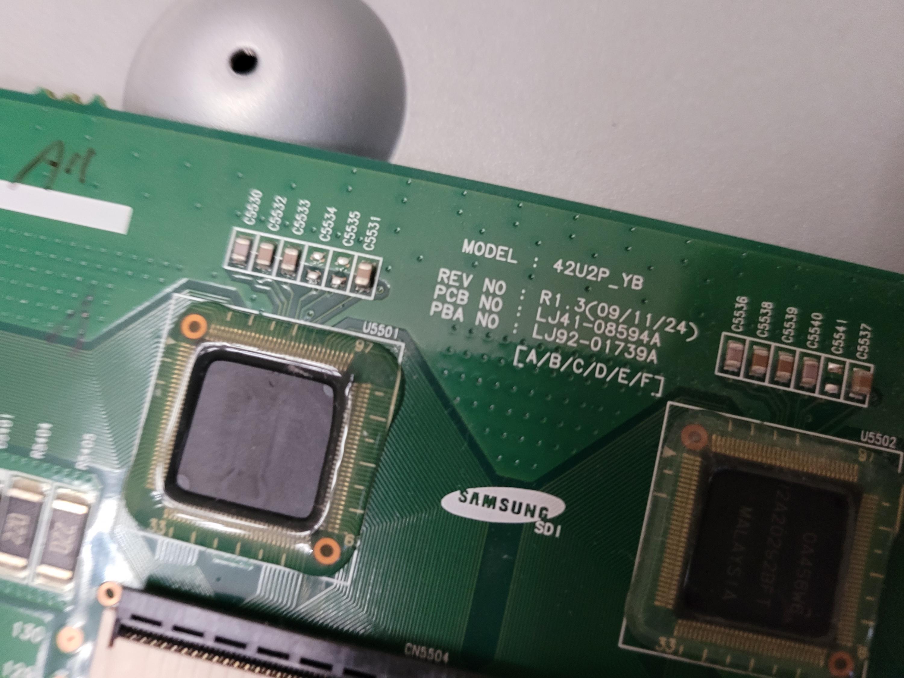

      Test the Y-buffer output pins to the panel, they cannot be open nor shorted, where there's these lines, if it's a buffer fault, they would be open, infinite resistance.
      Put multimeter in diode mode, the positive probe on the buffer's floating ground, negative on the output pins, should have a forward voltage of 0.7~1.2V.
        I went across all the pins and they all show around .739v.
          If there's .739V on the same pins as these horizontal lines, I say it's a panel problem.
                That's a Ybuffer problem. If you can get a working set cheap replace them. Or replace the buffer ic's responsible for those portions of the screen.
                  It certainly does look like a Y buffer problem. I would repeat the buffer testing.
                    Yeah my board looks just like that. I did that test a bunch of times and didn't get any shorts which seems strange.
