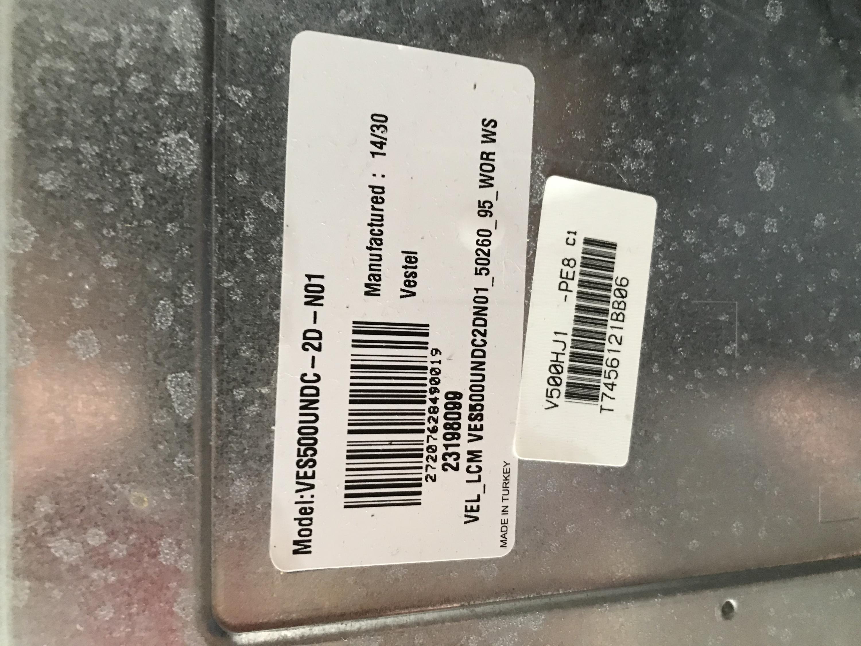

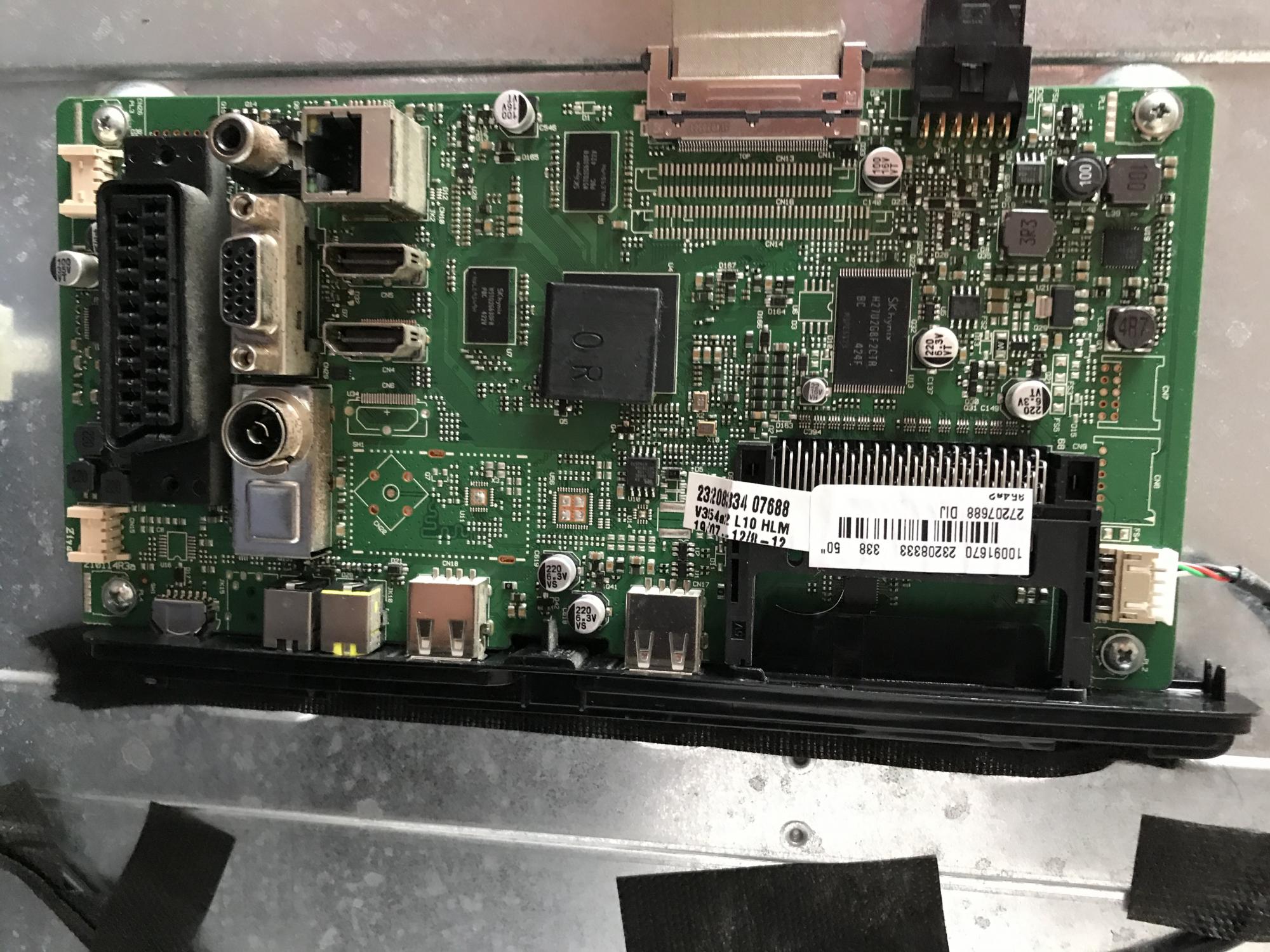

    I have purchased a faulty Hitachi TV from internet and I have now fixed it (backlight issue).
    However, it came without a remote control. The back label is missing, I don't know the model so I don't know what remote control needs.
    The seller has no clue or record of it.
    What I know so far is this:
    - it's a Hitachi
    - 49-50 inches screen
    - seems to be a smart TV (seller also said this)
    - I have attached some pictures with the inside
    Does anyone know how to find out what remote control I need for it please?
    Thank you,
    George

    It needs a hitachi(vestel RC5117 RC5118 ) remote control. Tv model is 50HYT62UH
    Or you can turn it on pressing the little joystick on the right of the scart connector.
