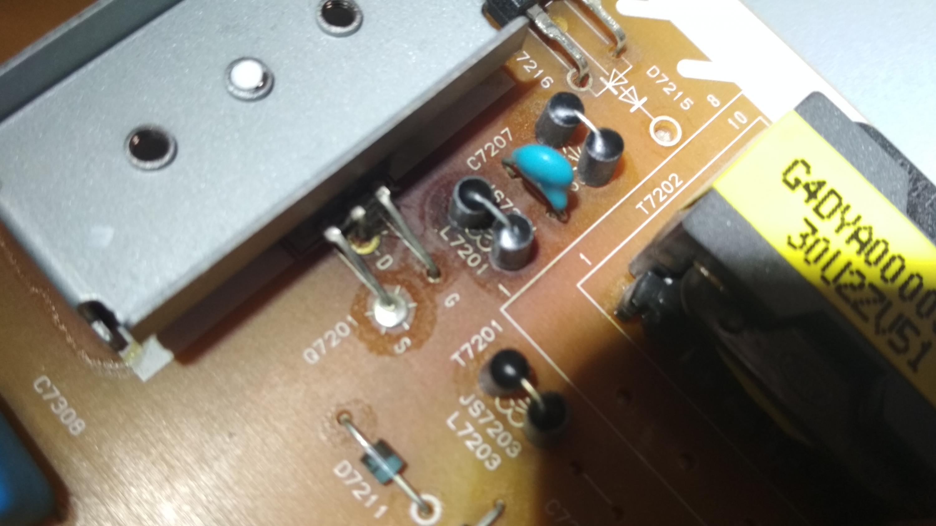

    So I inspected componencts, found nothing (like capacitors etc.) decided to replace edge LED then. After replacing LED TV started to work and can be switched on with no problem, but new LED started to flicker. (strip is on right side of TV). It flicker with higher intensity when there is more brigntess and colors/light on screen. After 2 hours of testing/running programs etc. TV again started to shutting down. Sometimes it lasted for hour sometimes after 5 min when more brigtness was adden.
    Then I buyed second LED strip to test if first one was bad. Again, flickering problem and I am not going to destroy second LED by testing TV for hours if it stops aaaand I found this great forum, searched for similiar problems and TV, but found nothing :/ so I created new topic. Here some photos and video of flickering. Thank you for help.

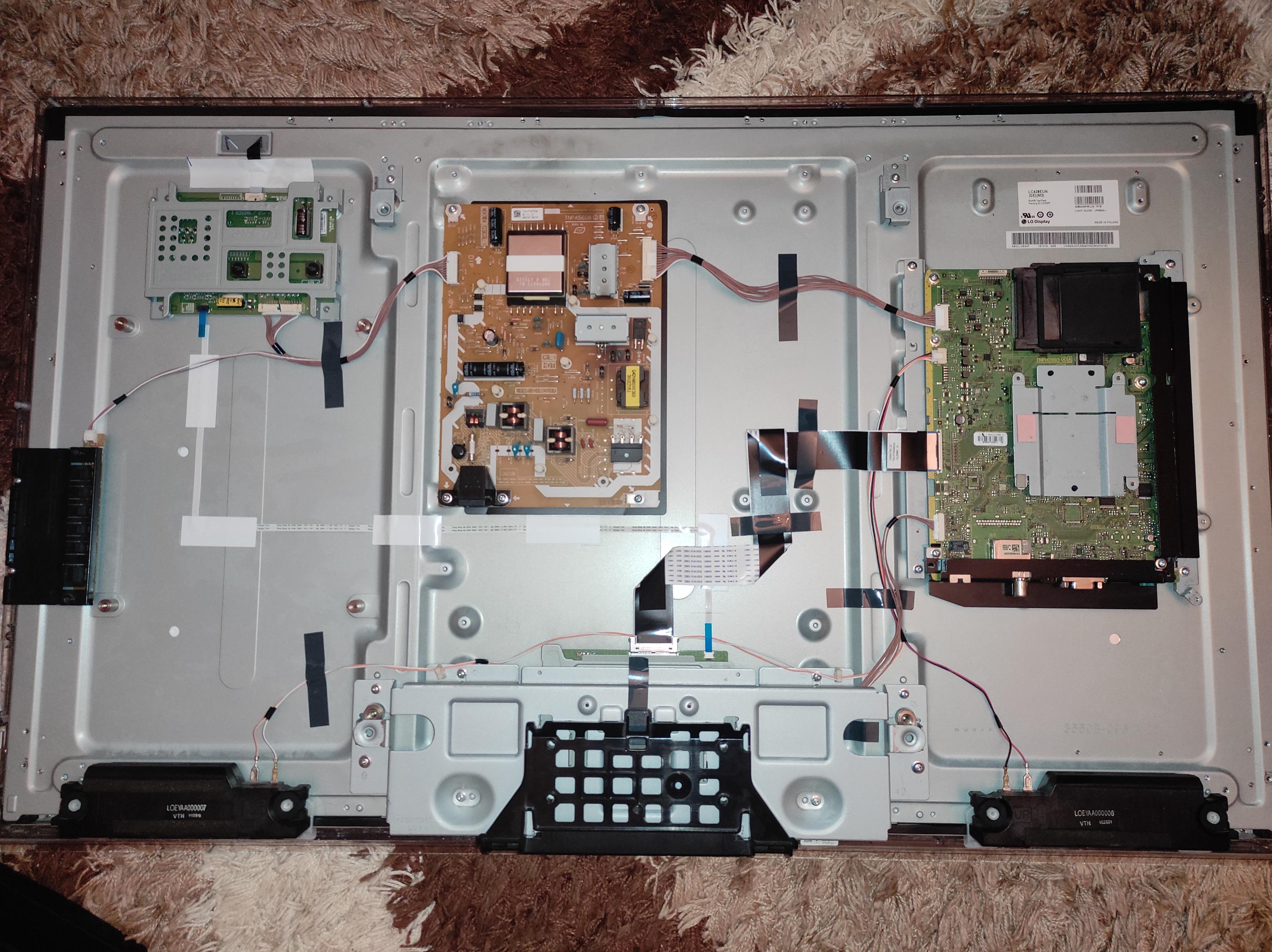

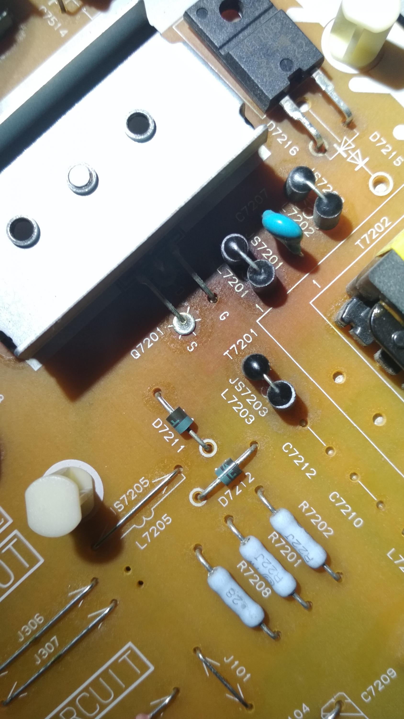

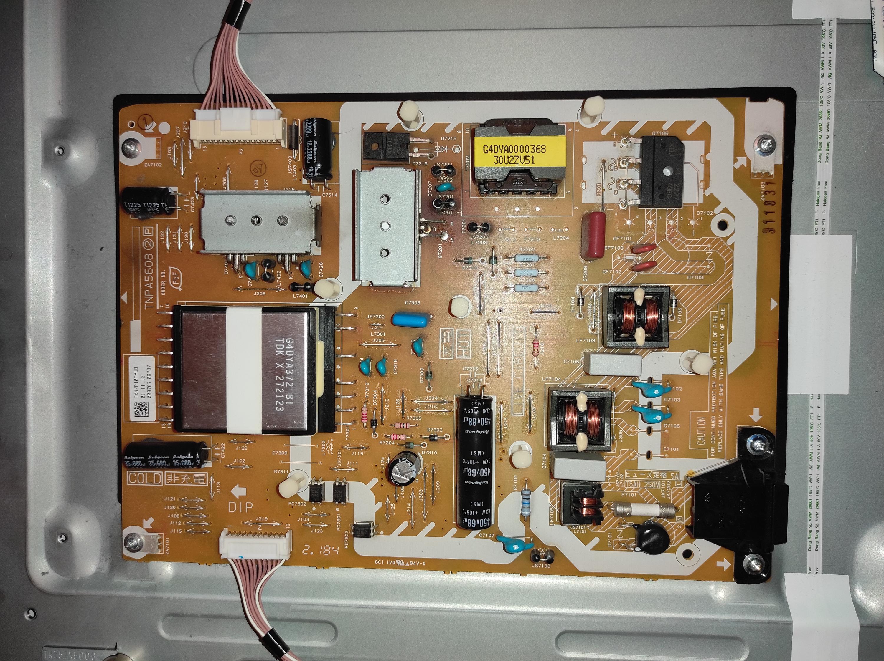

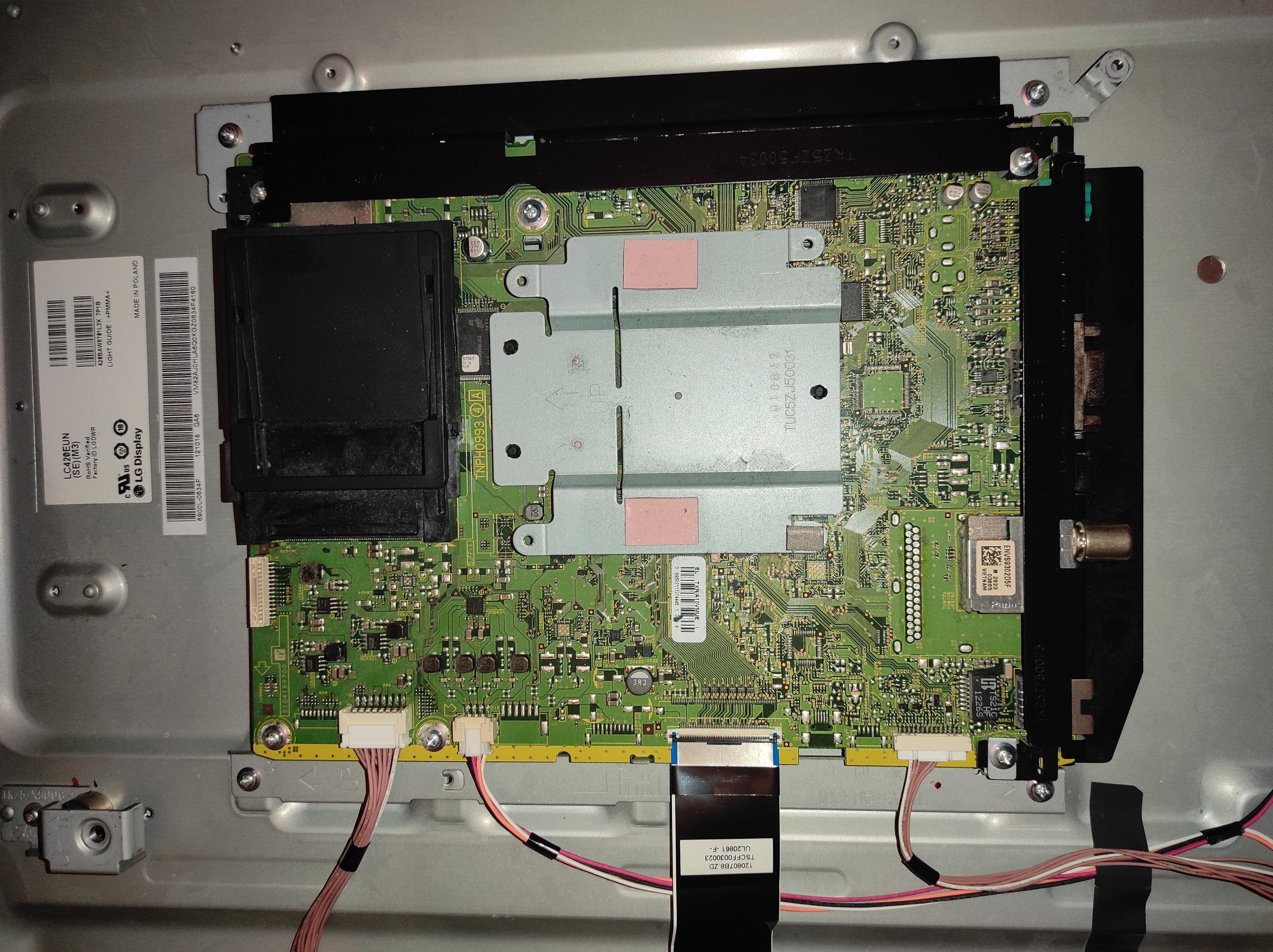

    Pictures of components:

        CAREFULLY check the voltage of C7213, check with tv on, meter set to VDC 600 one probe on each leg, what's the voltage and is it steady? Be CAREFUL this is the HOT/DEADLY side.
            When turned on first time it was from 384 jumping to 388-389, when i tryed second time it was 388 to 392 jumping, even with TV program ON.
            Inspected all parts, found nothing. Only around this one, its a little darker area.
