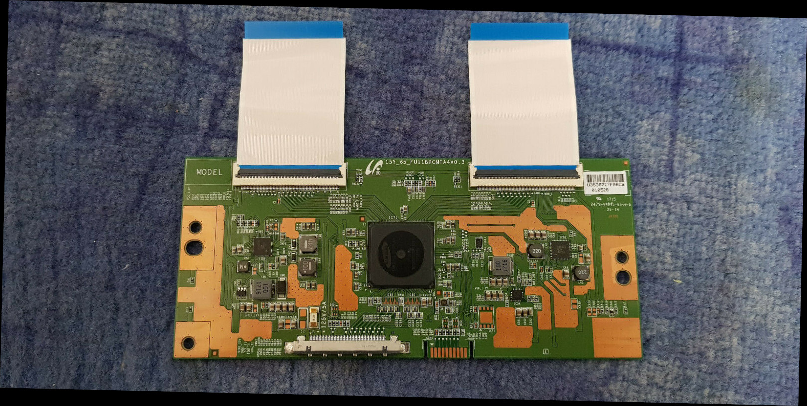

    I got a Philips 65PUS6503/12 with black screen. Mainboard boots up (i checked u.serv debug connector) and software seems to be good. Reacts to the remote etc.
    Backlight is on and is bouncing up and down a bit during boot so that seems normal.
    LCD panel is black, no image whatsoever.
    I checked fuse on TCON, good. 12V supply gets to the panel.
    Voltages on TCON:
    U_H, U_L L_L VONE VCS1 VRD VCST HAVDD AVDD all practically 0V.
    I ordered an identical TCON from a TV with a broken screen. This doesn't work as well. The TV with broken screen was so broken that absolutely no image could be seen, so i'm afraid that this TV was scrapped from the same problem and then the owner smashed it. idk. No returns on the TCON so i'm hosed. At least i have two TCON's that does the EXACT same thing here.
    It seems like RT6929 is responsible for 1.8V and 3.3V (which is there!), 8.5V (which is missing), 17V (also missing) whereas the RT6936 i'm not sure what voltages it's supposed to make - the VH and VL i guess?
    There's a testpoint from the main TCON thip (Samsung VTU61B2) called DCDC_EN that goes to the RT6936 and it only goes high (3.3V) when both flex cables is connected to the panel. No change in voltages, panel connected or not.
    Any ideas what to try next?

    first test the panel by disconnect one ribbon at time... and if there U ribbon on the panel edge boards do the same each at time.. to terminate panel didn't damaged.

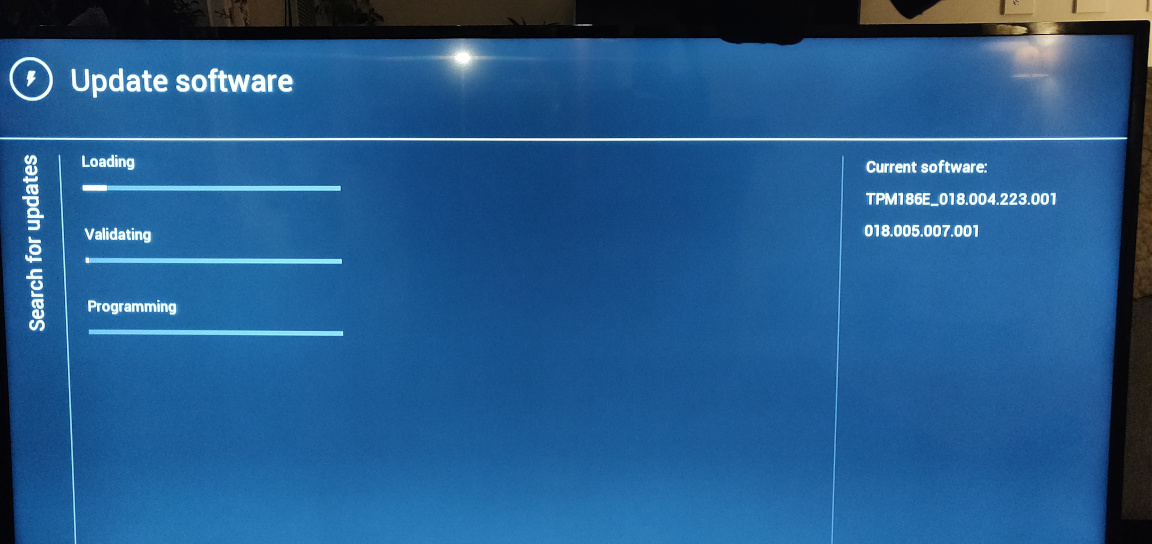

    then the second suspect for this TV chassis "TPM186E" the "Saphi" firmware. many time found issue it cut GPU signal. to do this need install firmware with .pkg format.
    here TPM186E_018.004.223.001 (Date published: 2019-11-05) upgrade_package.pkg format.

      As i mentioned i tried unplugging the ribbons for the panel, one at a time. Nothing changes. If both ribbons are not attached the DC/DC won't be enabled. I guess the TCON looks for the EEPROM on the panel boards.
      There is a U-shaped ribbon as well that i didn't touch. I will have a try disconnecting that.
      I don't think it's a firmware issue, but i will try a reflash anyway. It can't hurt to try.

        I tried downloading the upgrade_package.pkg and flash it onto the TV - twice even, no dice.
        I tried unplugging the u-shaped flex cables on both sides. I can confirm that if even one of them is unplugged the DCDC_EN signal is not asserted from the main TCON chip, so it wouldn't be able to generate a picture. Apparently it checks that all H/V drivers are present before trying to power up.
        I guess next thing is to hook up the scope to the LVDS lines and see if there is any hint of video being sent to the TCON at all.
        I don't know the default function of the TCON - what would it do if it's supplied with only power - no I2C or LVDS data. Will it normally generate the voltages for the panel or does it wait until there is valid data sent to it?

                        It printed a lot of dots in the debug interface while reading from USB to RAM and then started to flash in hex 40000 blocks. Took a couple of minutes. After that it rebooted.

                              Well no one will believe me now, but after seeing that OSD image for a short while i sat for a long time, pressing source/ok and the TV clearly reacted. One of a sudden i got image again, and it stayed on!
                              After getting image it became clear that the previous owner had disabled the speakers, so that's why it was silent.
                              I did a factory reset and it pulled an even newer firmware down from Philips' website which it flashed.
                              The TV seems to be working properly, but i really don't like it working out of nowhere - this could correspond with BGA issue - i would rather not reball the BGA if i don't need to.
                              Or could this be software corruption that "fixed" itself after the reflash? I don't really believe it ...

                                my post #2 , you need to believe its firmware..the most stable firmware with out any issue the one i linked to you.. so would be good if you stay at it and block the update,

                                  Oh i didn'get the point about the firmware you linked was more stable. I will downgrade it again then.

                                    if you are going to downgrade. dont forget to make hard reset from service menu. so you will get clean system.
