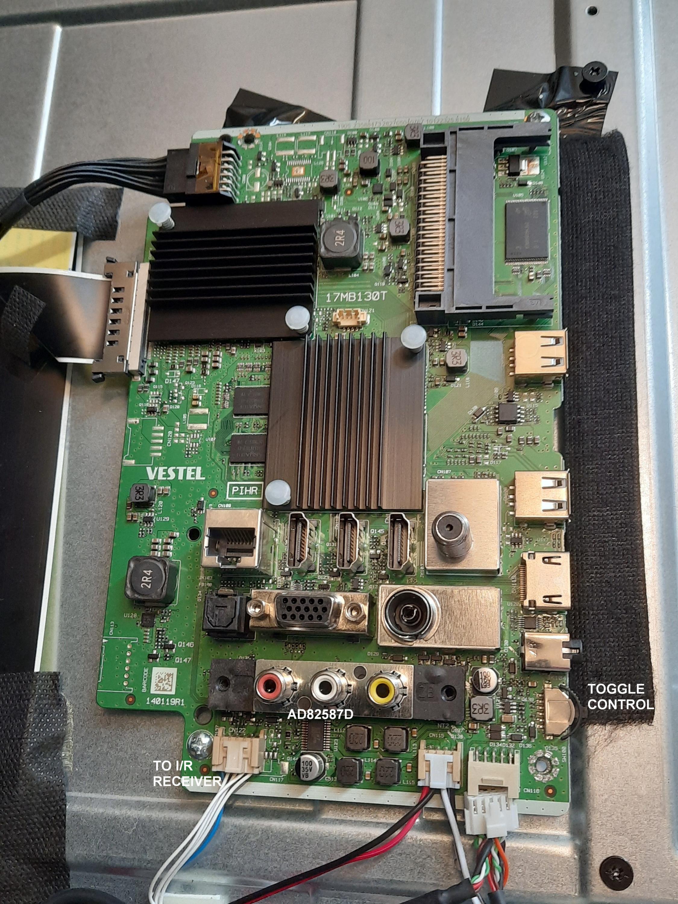

    Volume keeps being pulled to zero .

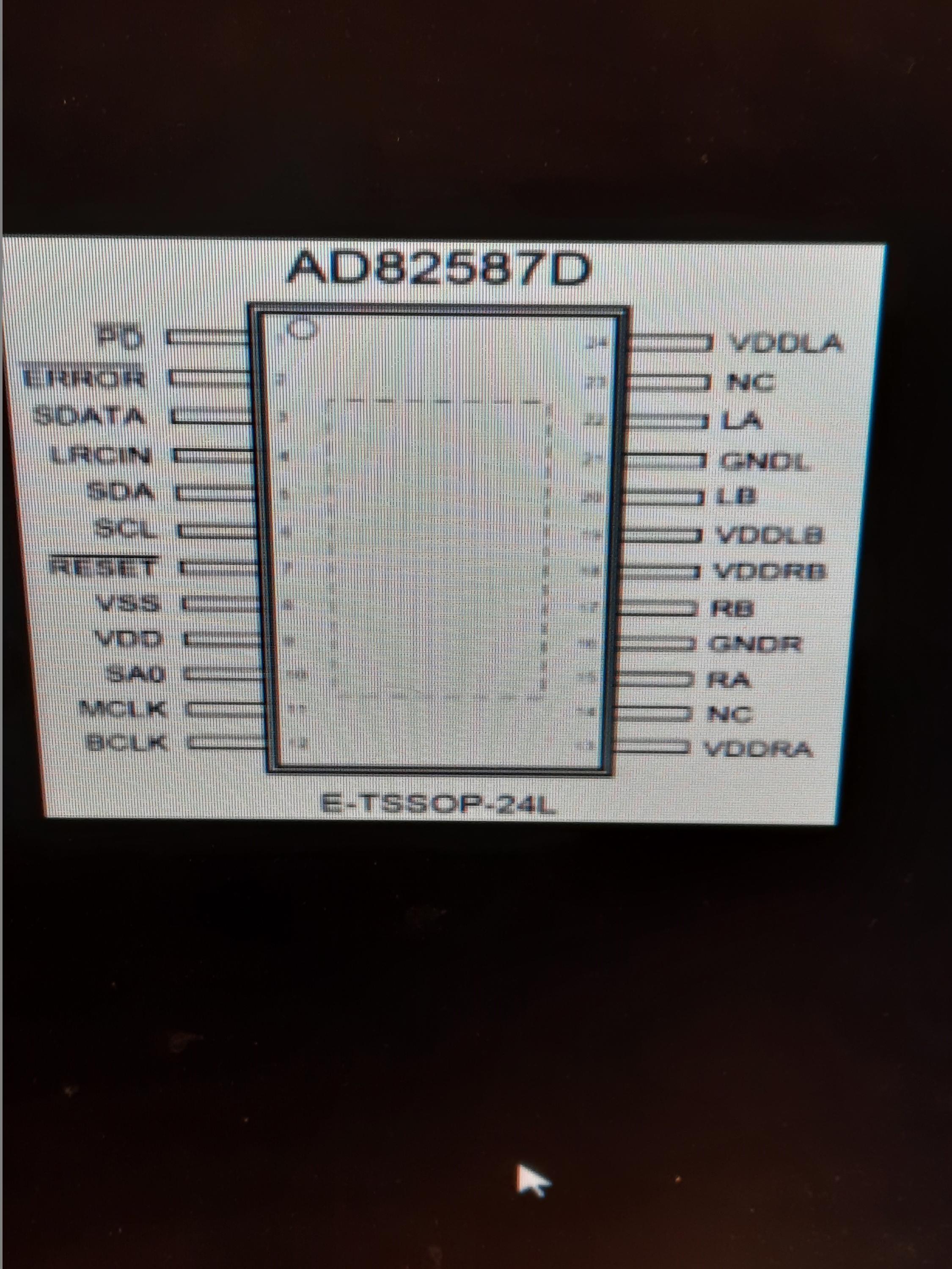

    Removed toggle control & audio chip ( AD82587D ) , which is IC2 BUS controlled , but no change .
    Also disconnected I/R Receiver .
    Measured DC voltage on all pads where the audio chip lives ( see picture )
    Only ones that differ from measurements on a working board , are pins 15 ( RA ) , 17 ( RB ) , 20 ( LB ) & 22 ( LA )
    All at zero volts on faulty board , but that may be due to chip removed .

    Re: 17MB130T , Vestel main board audio issue.Schematic & advice please
    Check components above and around the QR code as the place to the left is where the external button socket goes maybe be something there

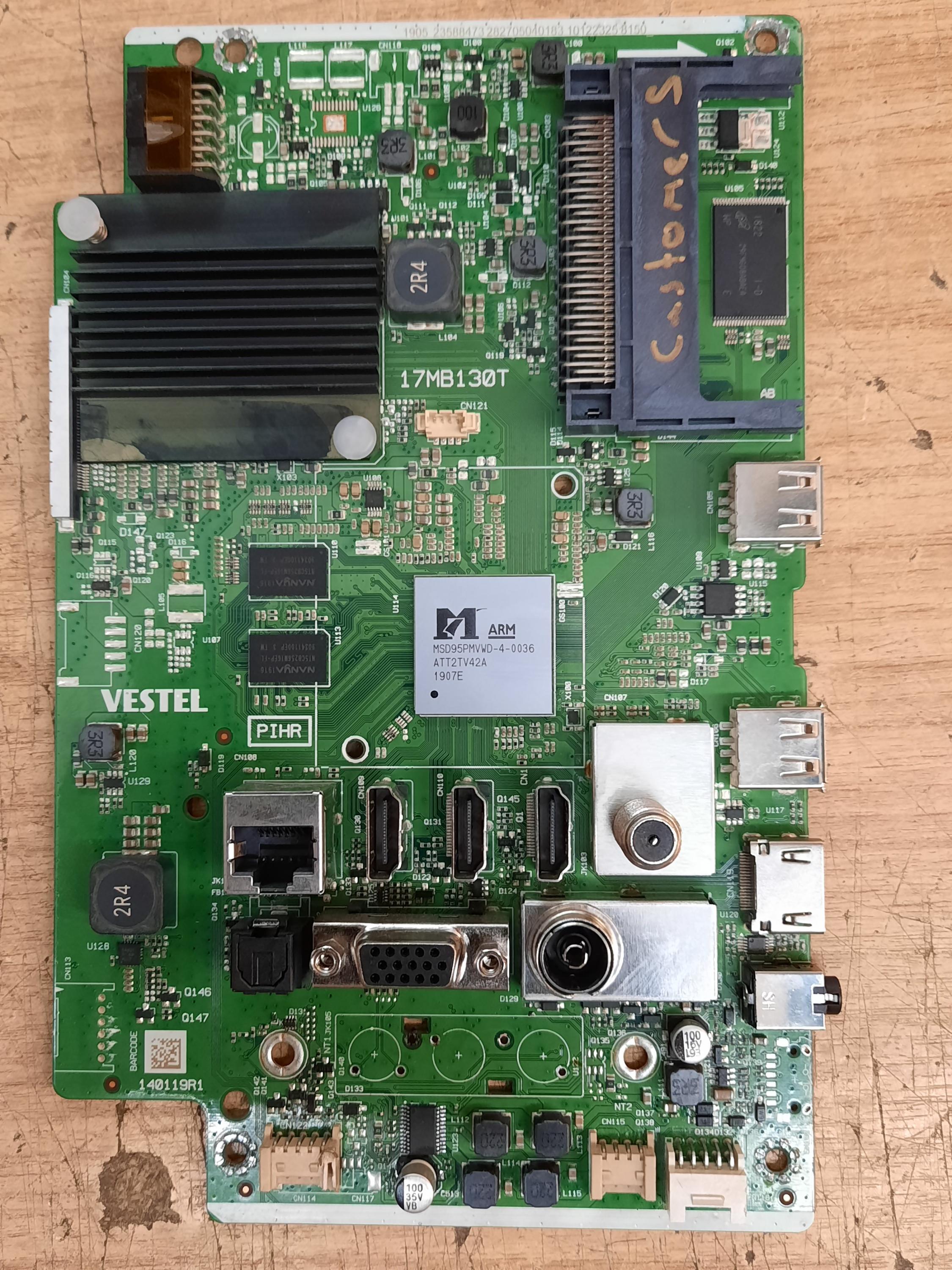

      Also forgot to mention that the silicon type heat sink pads under the PCB had leaked out slightly .
      Washed the board down using IPA solvent , but there's is a possibility that the main CPU could have been damaged by the leak .
      Hope not , as it would be game over , & would need to replace SSB .
        Hi.
        remove r463 3V3 keyboard supply. if still volume goes 0 cpu is faulty.
          Hello & thanks for reply. Carried out test , but fault persists .
          Suspect the ARM manufactured CPU , most likely damaged by leakage .
          Swapped out the board & all working , on test .
