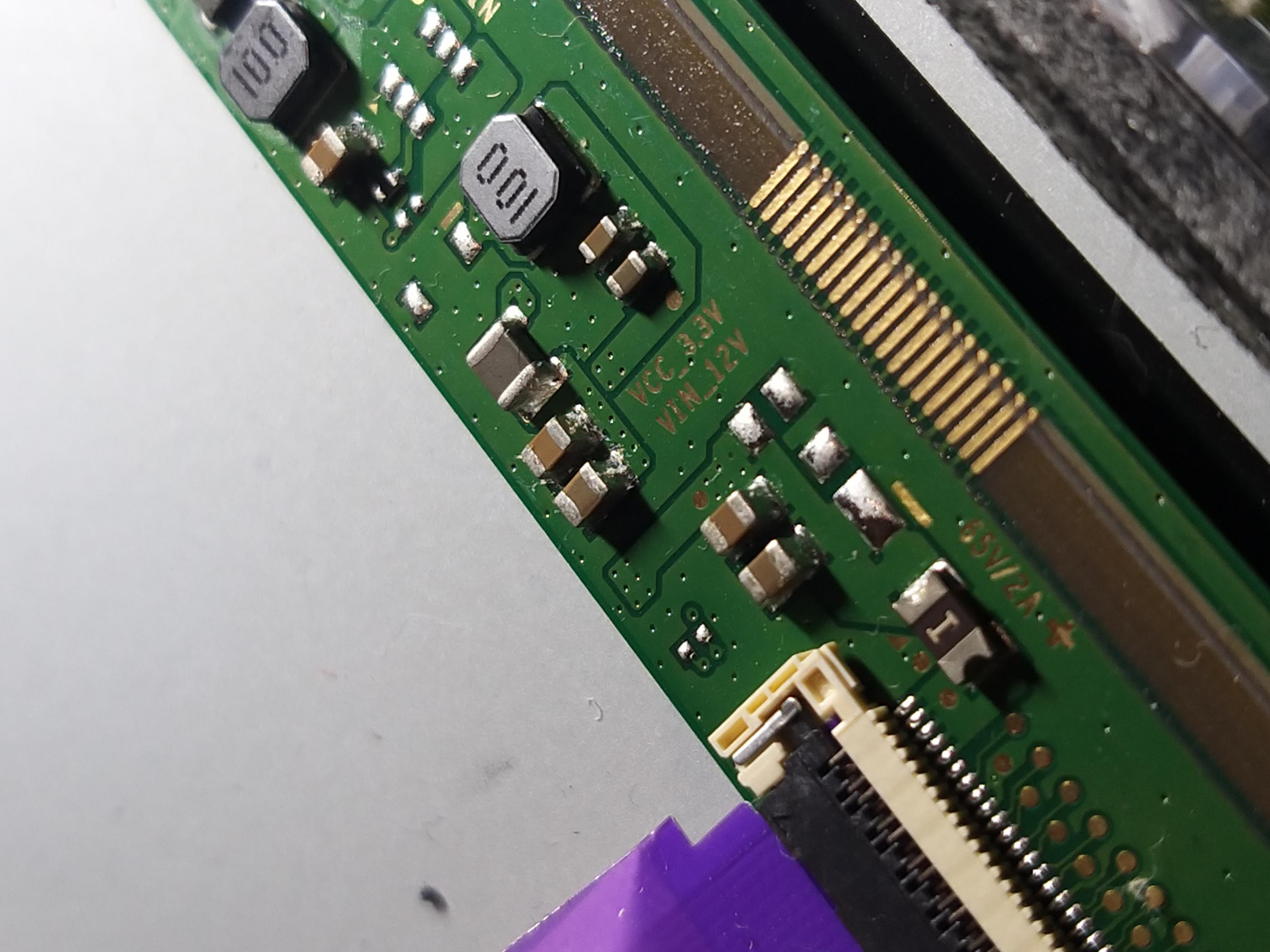

        Originally posted by vikivng
        It seems this was the only capacitor of this size on the board.
        Is it a matter of testing other caps to see if it works since I have no reference point?
        There is a capacitor at the bottom of your photo in post #15 that looks the same size.

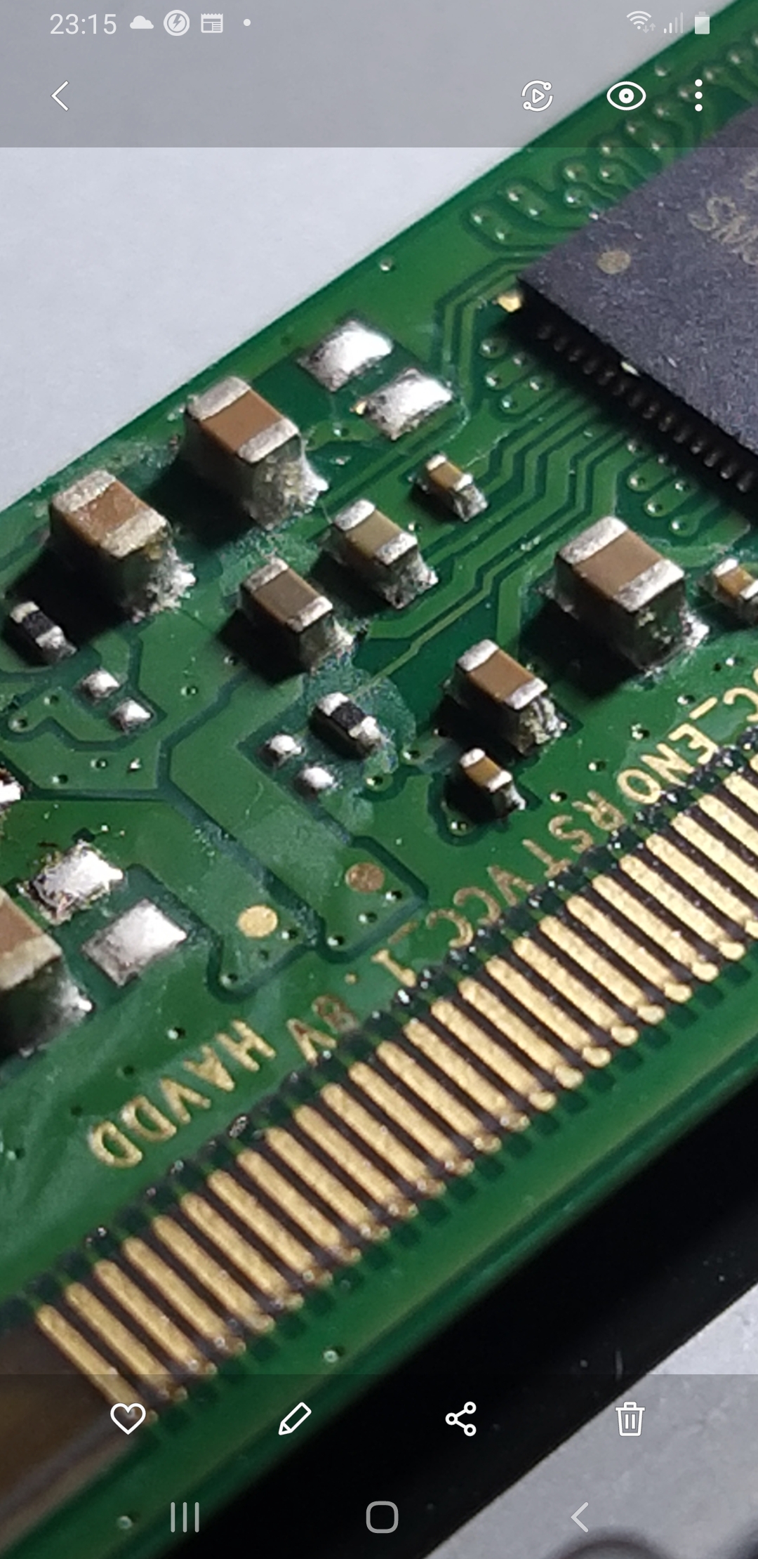

          Can you check if one of the pads that the shorted capacitor was connected to is connected to chassis (ground).
          If it is then as a quick test I would solder a 10uF capacitor across the pads with the negative of the capacitor going to the grounded pad and check the voltage across it on powering up.
              Hi, no connection between either pad and tv chassis.

                Re: SONY BRAVIA 40WE663 odd problem
                Thnx for replying.
                this cap is testing short. I am assuming this should not be showing as such.?
                Could this be the issue.?
                Also getting 00v at both legs of that cap when power is on.
                Looks like the culprit.?
                looks more like a inductor to me and not a capacitor

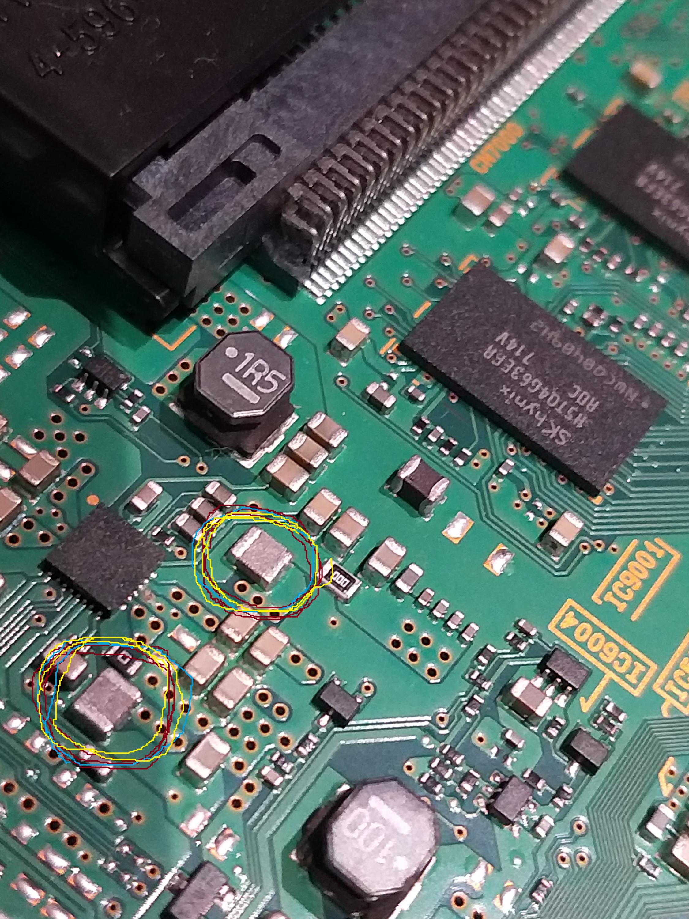

                  If those caps on the mainboard are testing short with NO other boards hooked up to it, remove one and test it and also test the other one while still on the board, you need to track down this short.
                    here is a pic of the caps on the mainboard that test short albeit in circuit.

                          #32
                          Ok just tested again the 3 on the mainboard and they do all test as short so Im guessing they must be inductors.

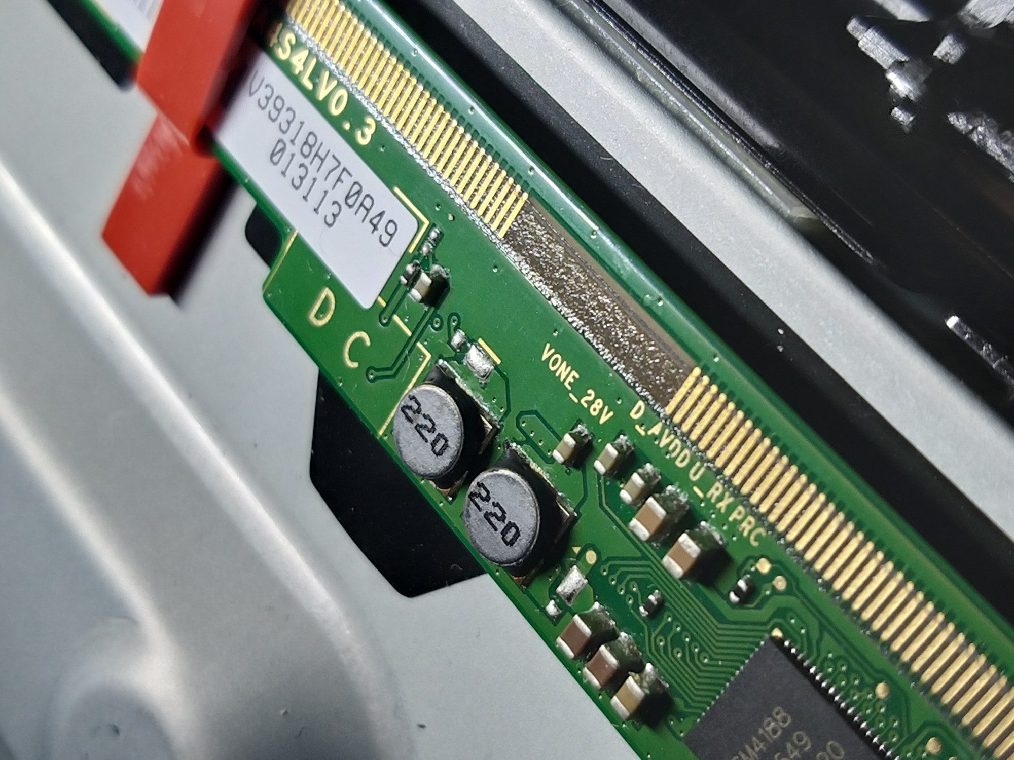

                                        OK GUYS THNX,,
                                        have been out all day but have watching all the videos I can..I understand a bit more now.
                                        One thing I have to ask is pinpointing the various points relevant to the V labels.
                                        Is there a general rule.
                                        In the photo with the VONE LABEL do I test the small capacitor ? Or is it anywhere on that large track the label sits on.?
                                          VONE eg.
