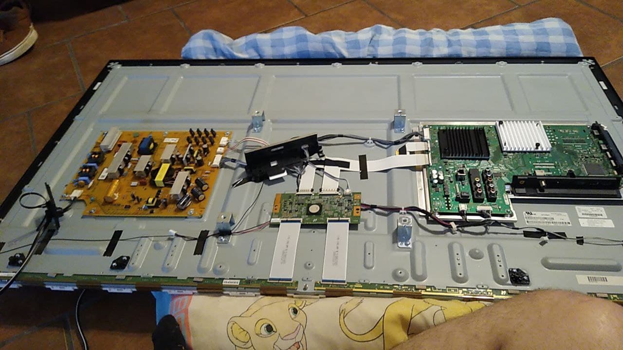

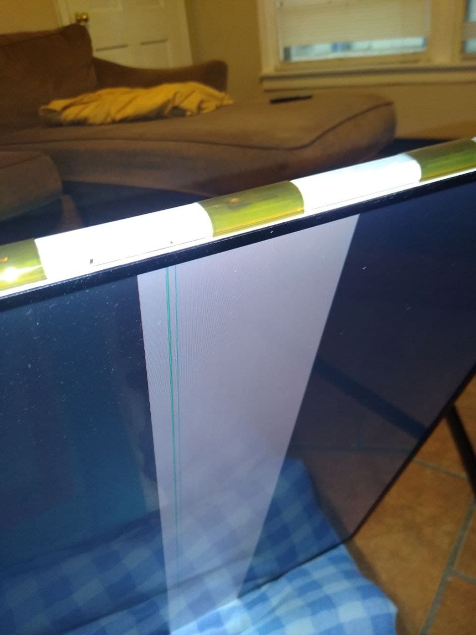

Hot tab bond, vertical white bar.
  • RainStorm
    • Mar 2019
    • 9
    I have a sony XBR TV I just picked up that has a tab bond that gets extremely hot in the middle of the cable, where some rectangular piece is. Pressing on the tab bond does nothing except for make a few extra colored vertical bars show on the screen.
    Could the TCON cause this? How can I repair the set?
    See second photo for tab/screen display.
  • R_J
    • Jun 2012
    • 9625
    Re: Hot tab bond, vertical white bar.
    That "rectangular piece" is the driver ic, which is defective, and is part of the panel.
