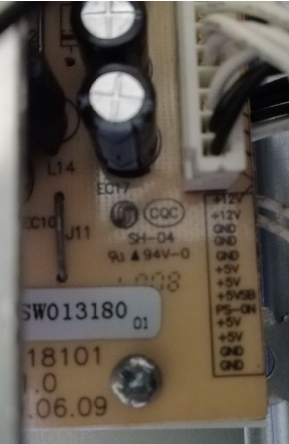

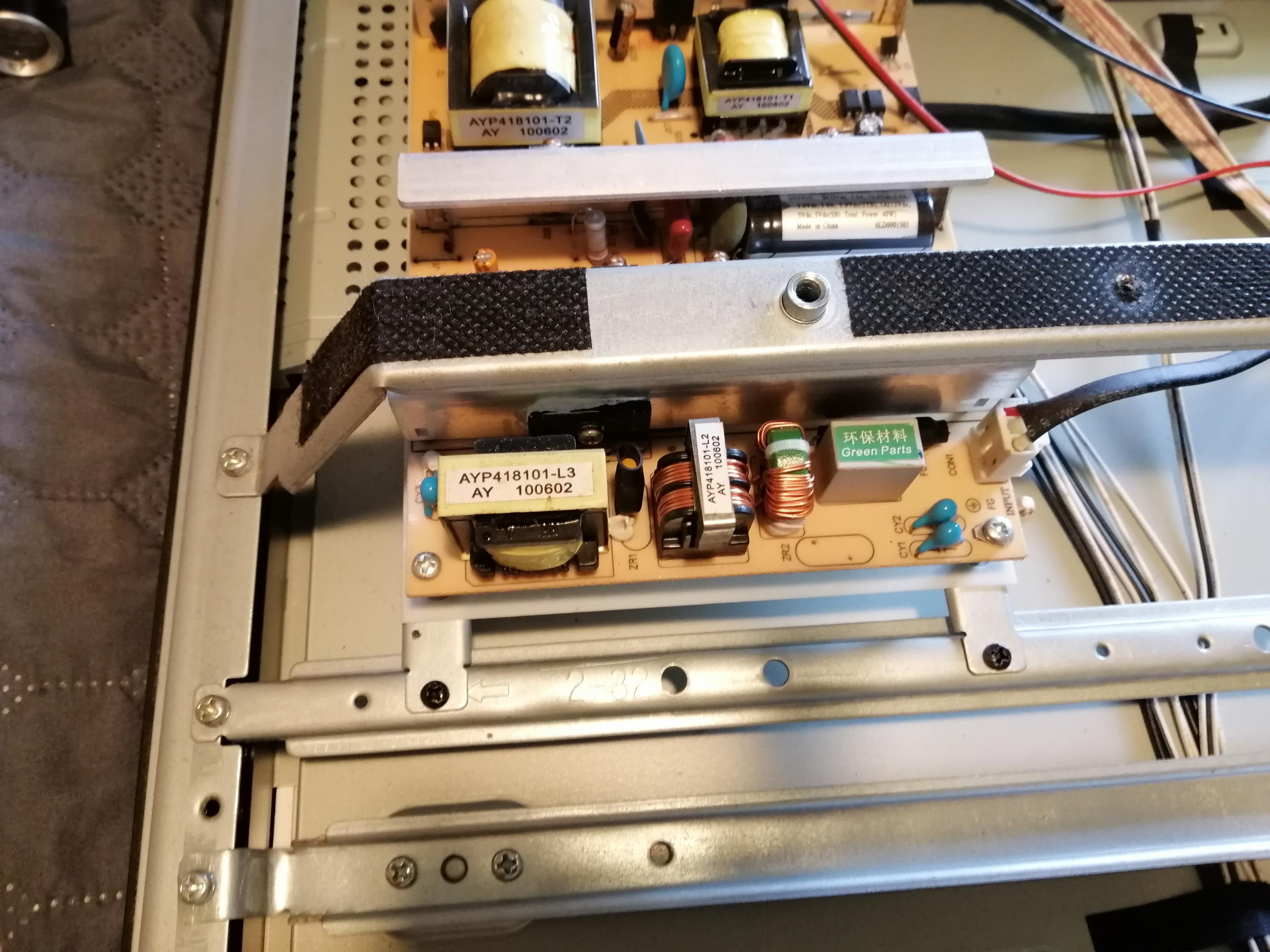

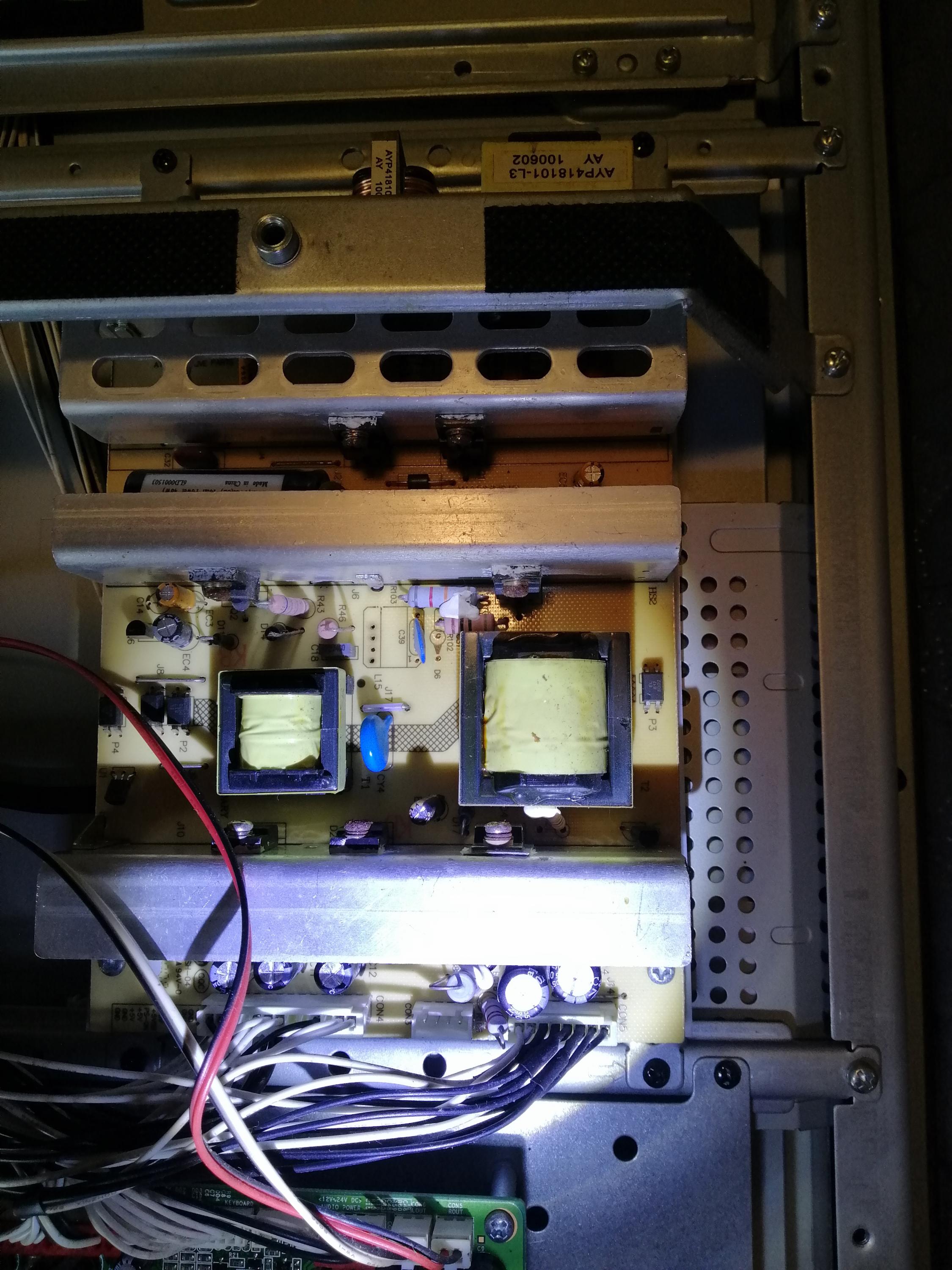

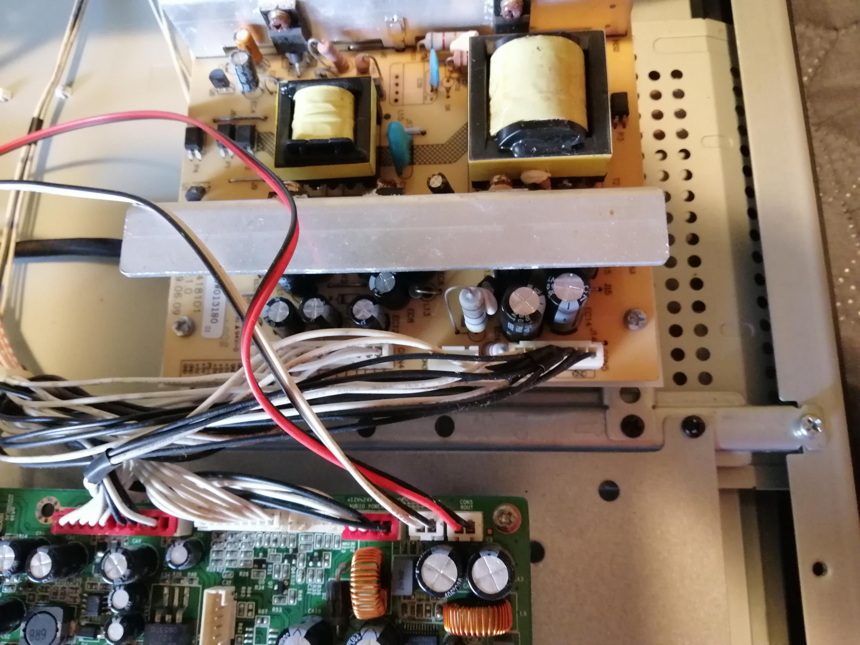

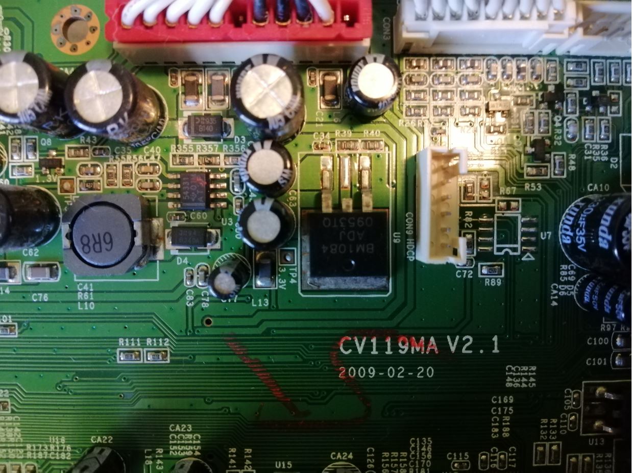

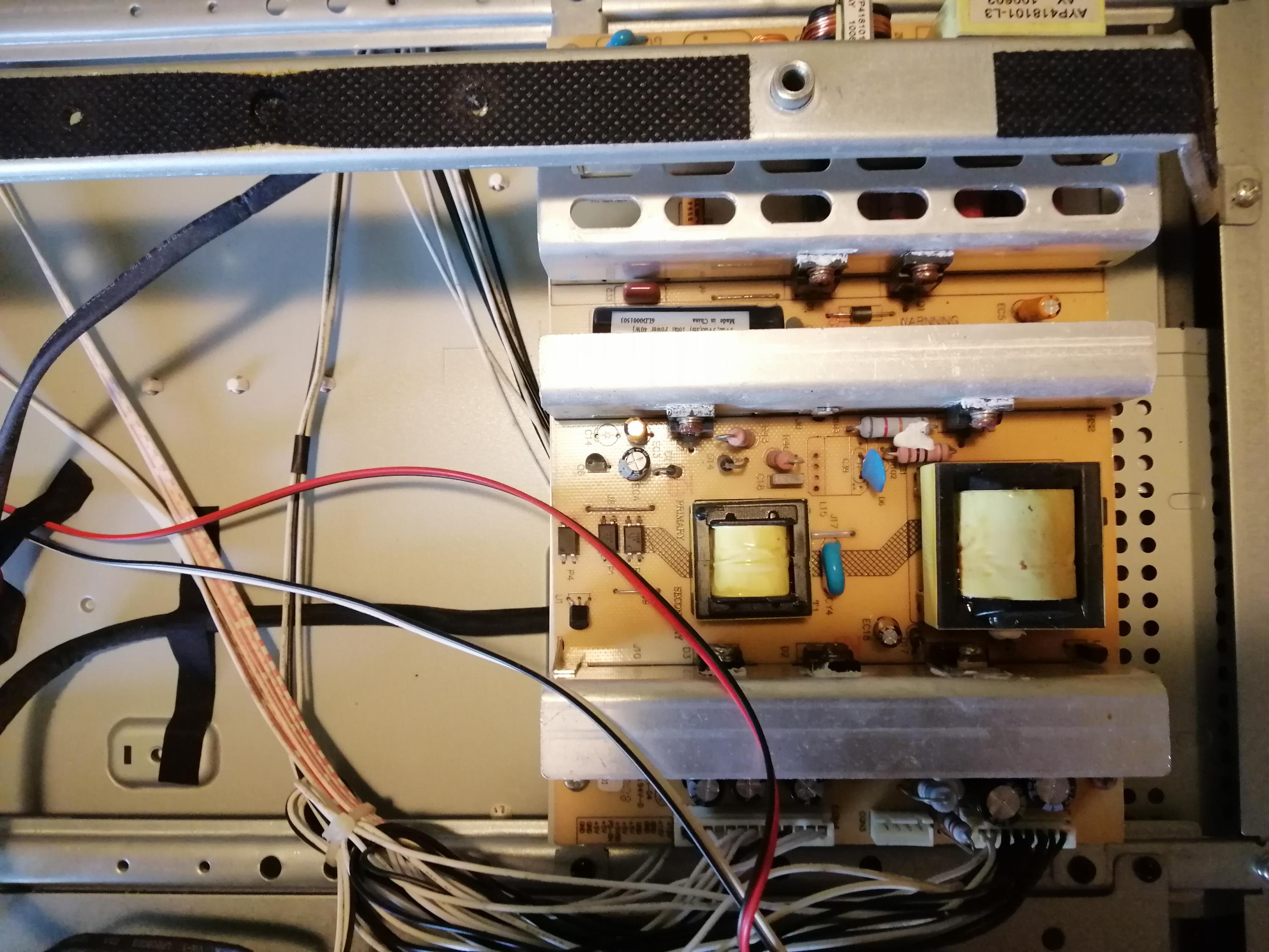

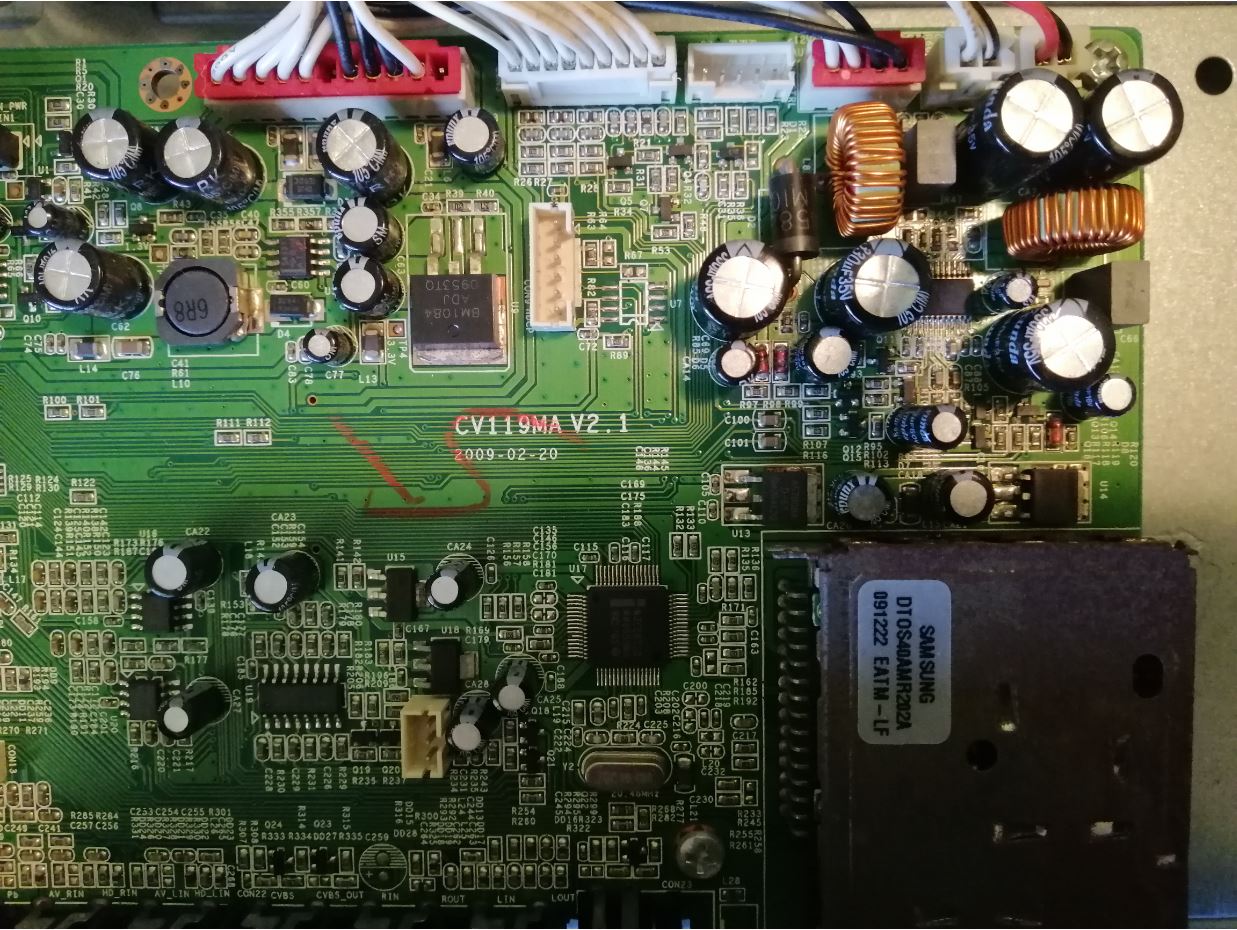

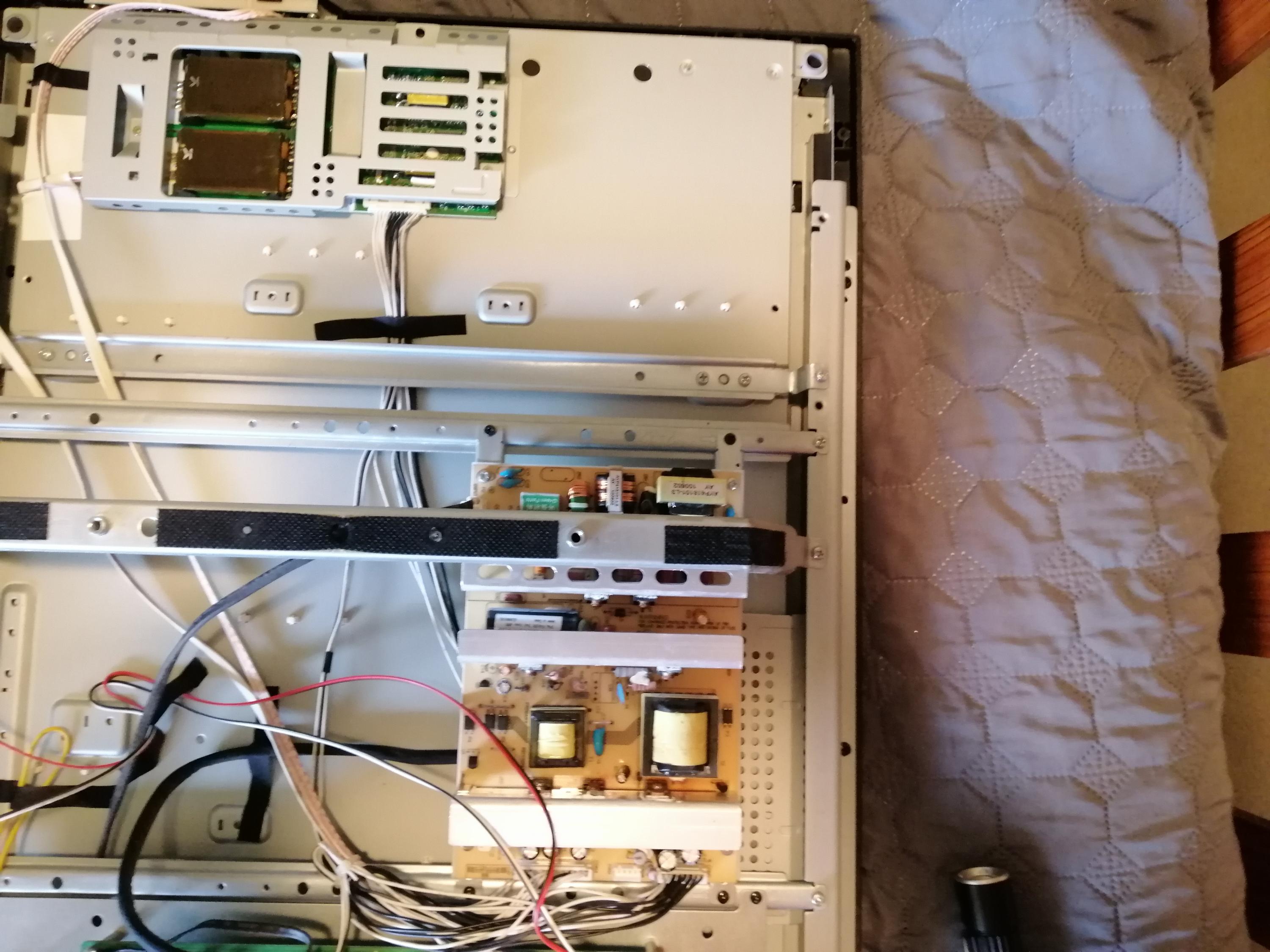

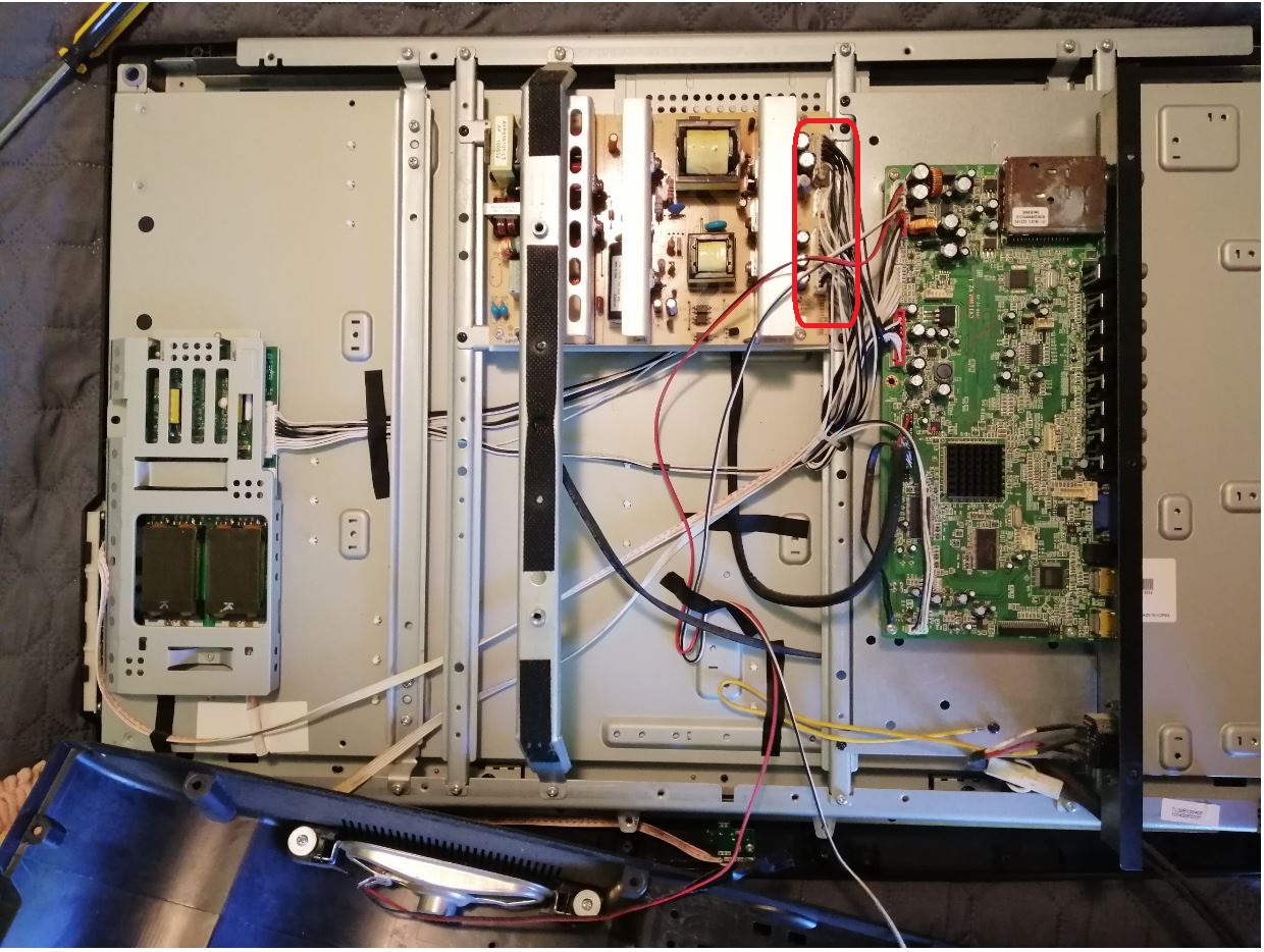

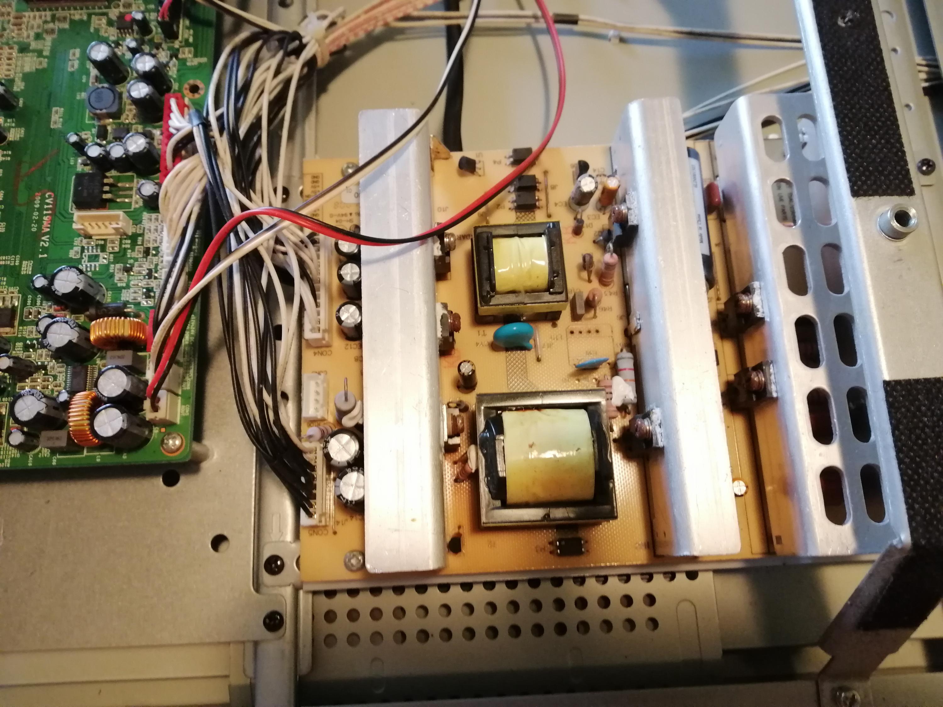

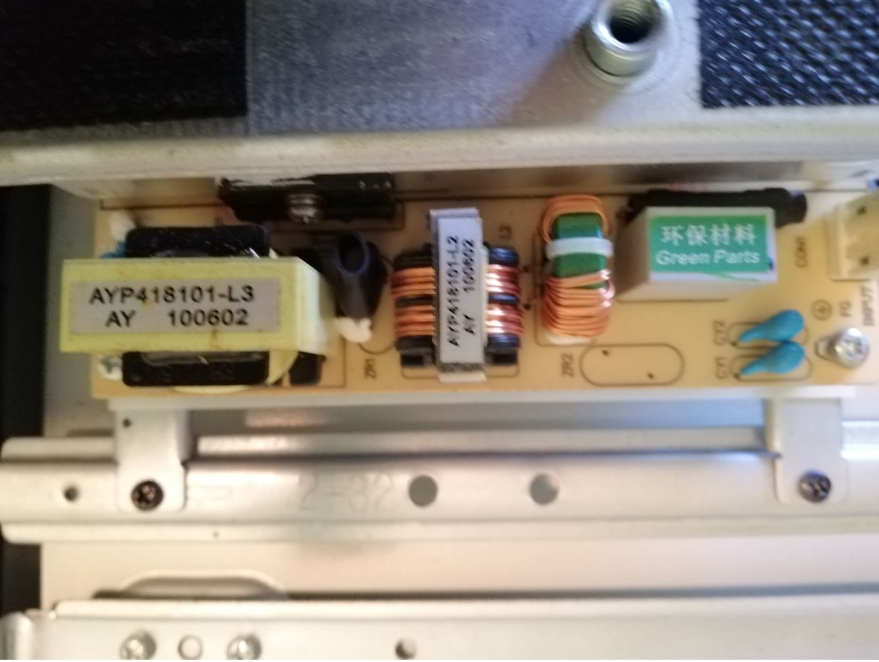

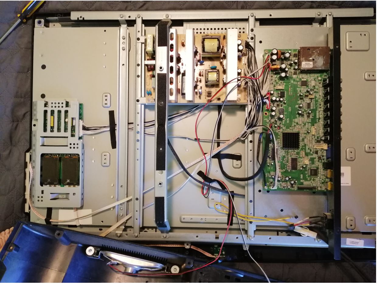

              I have removed the back panel, and here are some shots of the inside.
              I cannot see any damage, and am hoping you may be able to identify some parts from these photos, as well as some checking I could do?
              Many thanks as usual, and I shall watch the video as instructed.
              Thanks.

                Re: Nutec LCD 3201 (NUE 3201)
                See the legend of voltages in picture #7, do the test in post #5 on the connector right there and report the voltages both in standby and when you turn it on, if it doesn't power on then just report the voltages it has in standby.

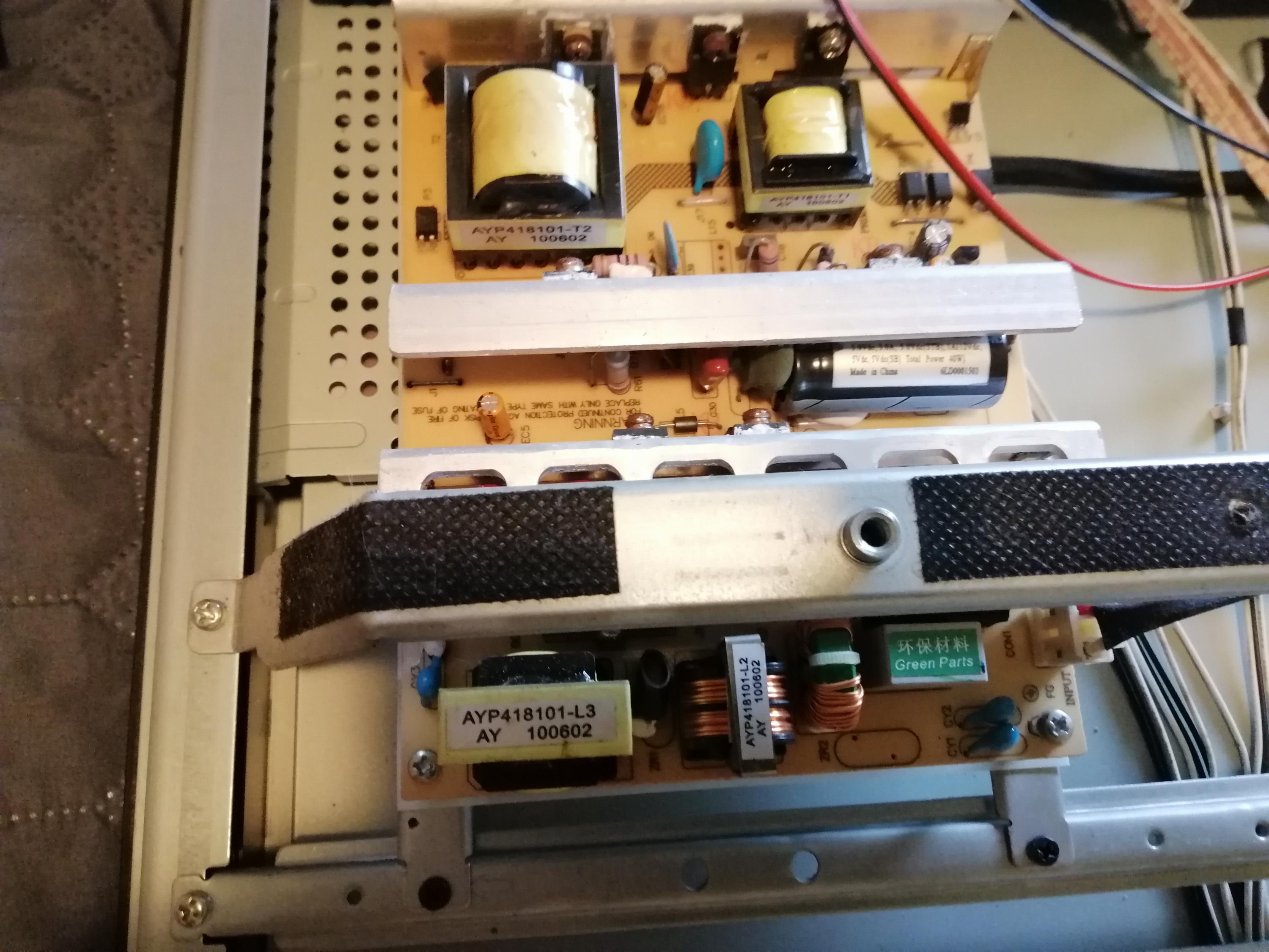

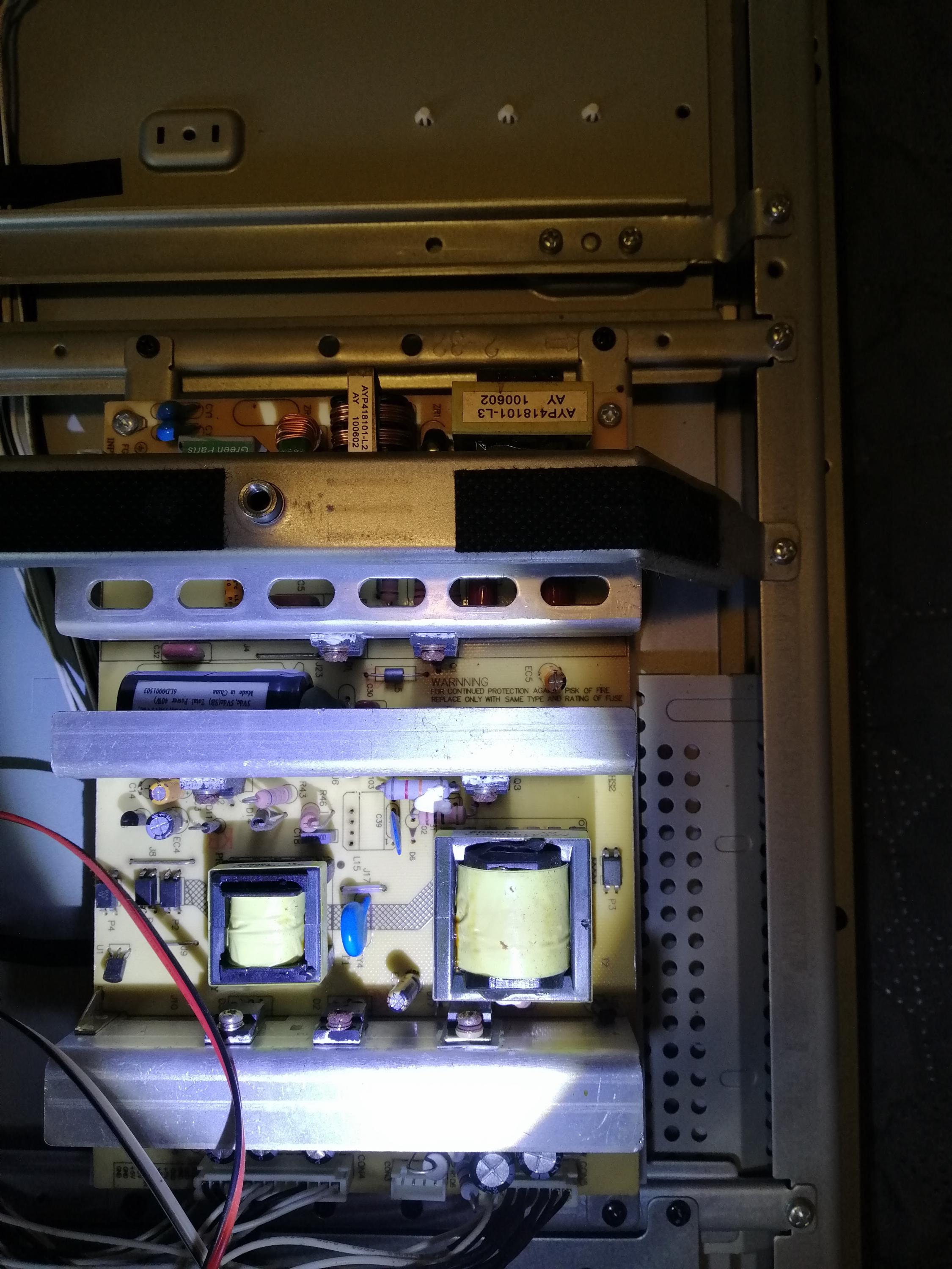

                  Can you post a full photo of your power supply board. I see there's an inverter board so perhaps a photo of the connection back on the power supply would be useful.
                  Edit
                  It looks like the upper connectors are the 24V supply to the inverter board. Have you checked you have 24V?

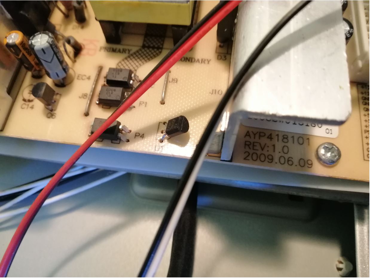

                    I have not tested the voltages yet...some photo's of the p/s
