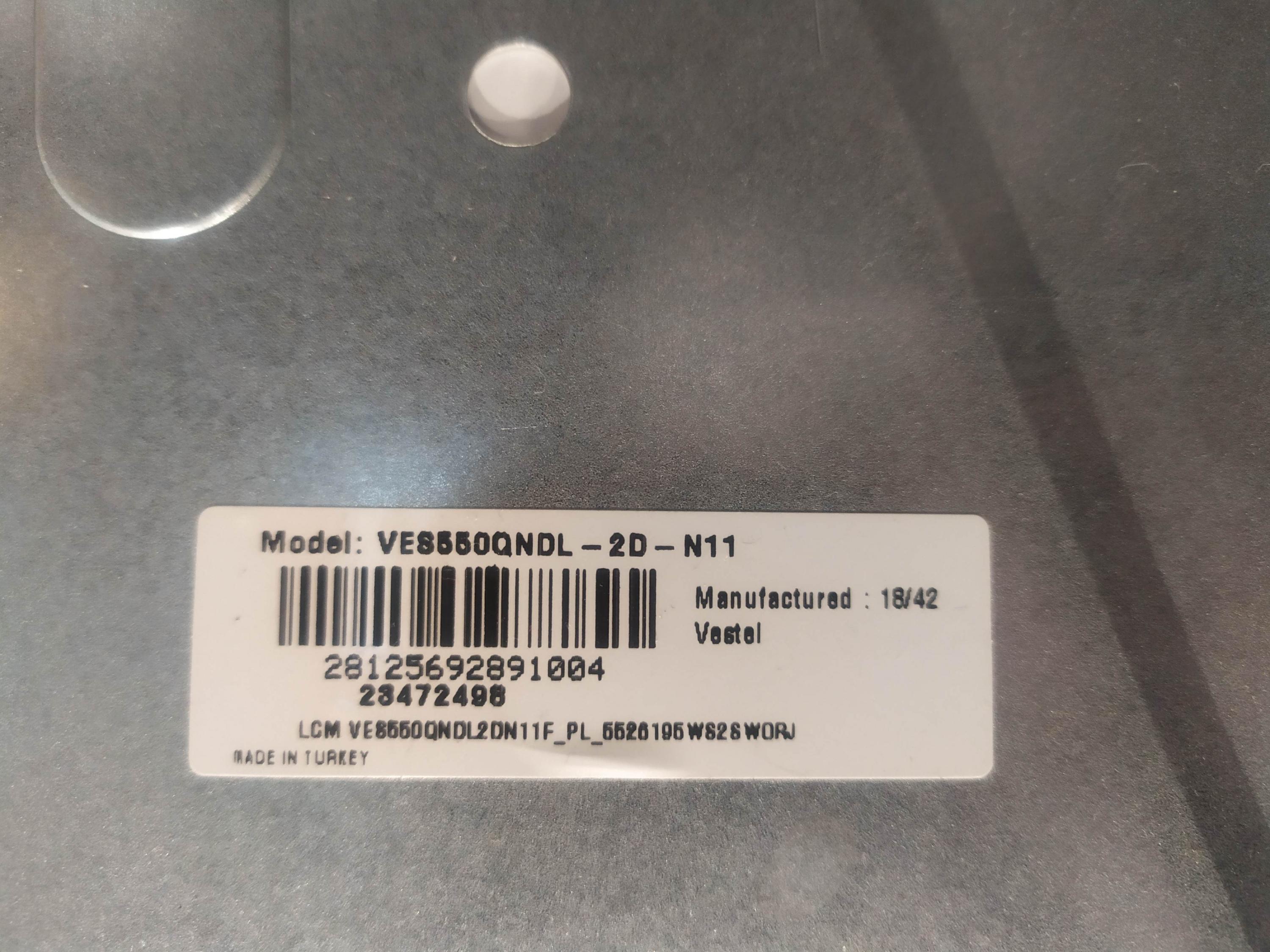

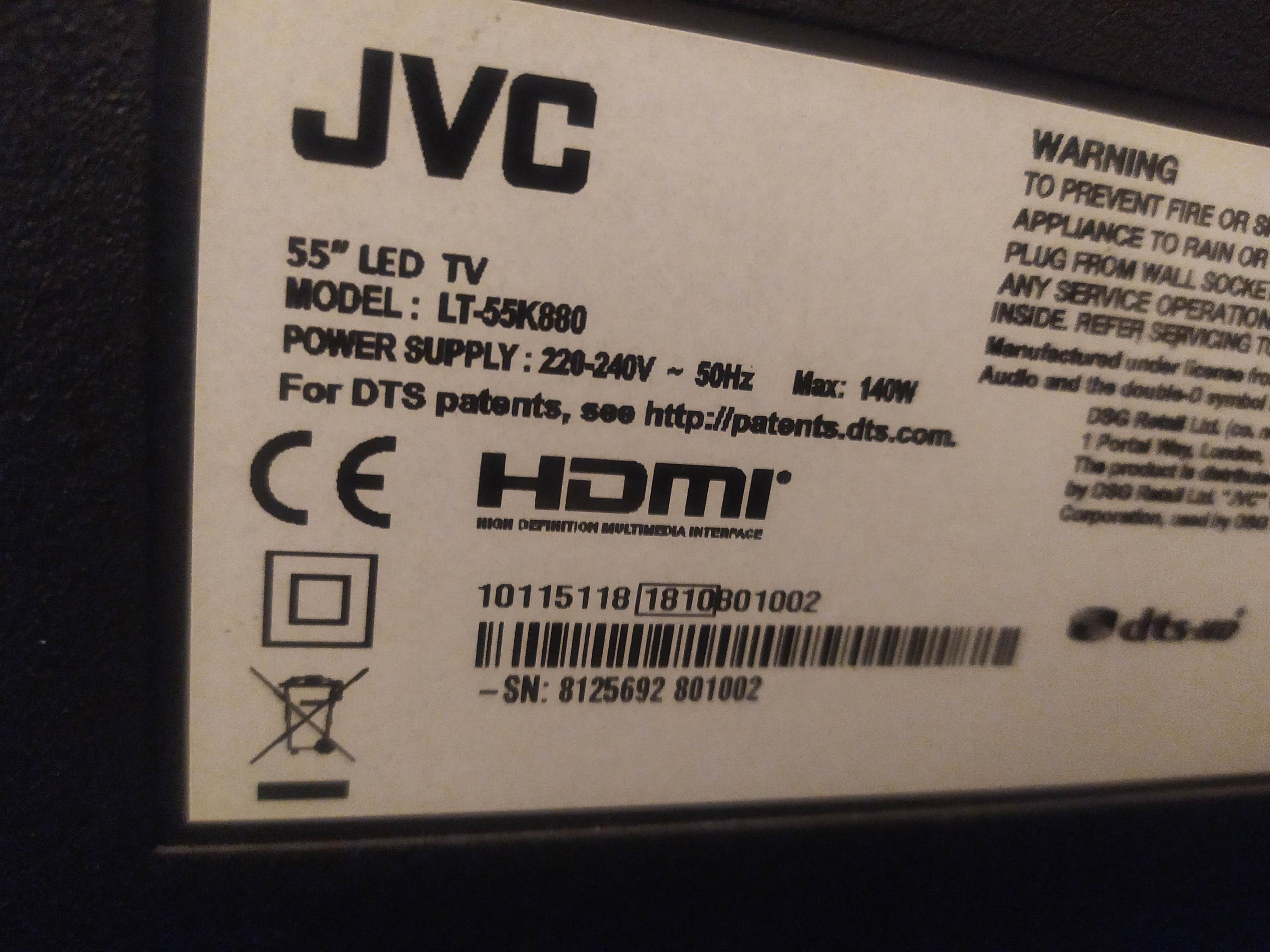

    Hello to everybody
    I own a JVC LT-55K880 mady by Vestel, which recently started crashing exactly after boot logo (stucks at a specific channel and no button responds anymore).
    The main board is 17MB130S and the panel is VES550QNDL-2D-N11.
    Unfortunately I can't find any appropriate firmware to flash it.
    The only compatible dump I found was at this forum, in which I could't register (maybe) because of server fault.
    Could you please help me either with providing a working firmware or with access to the amwajsat forum so I can download the files?
    Your help will be much appreciated once again.
    Thank you in advance
    Stavros
