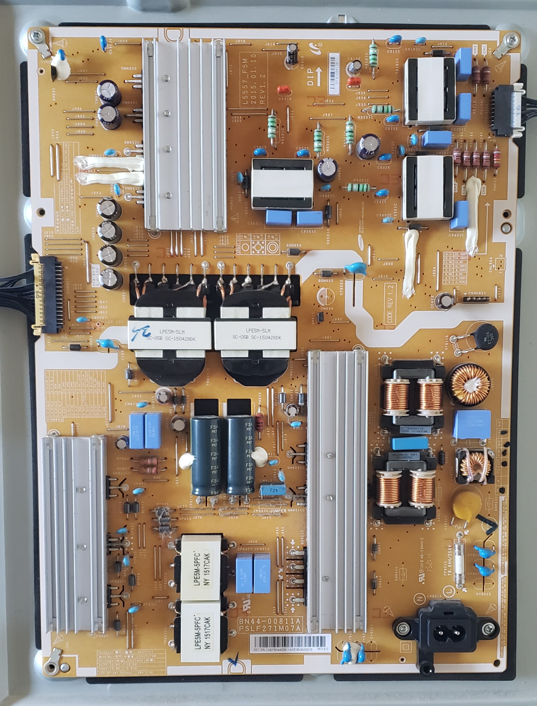

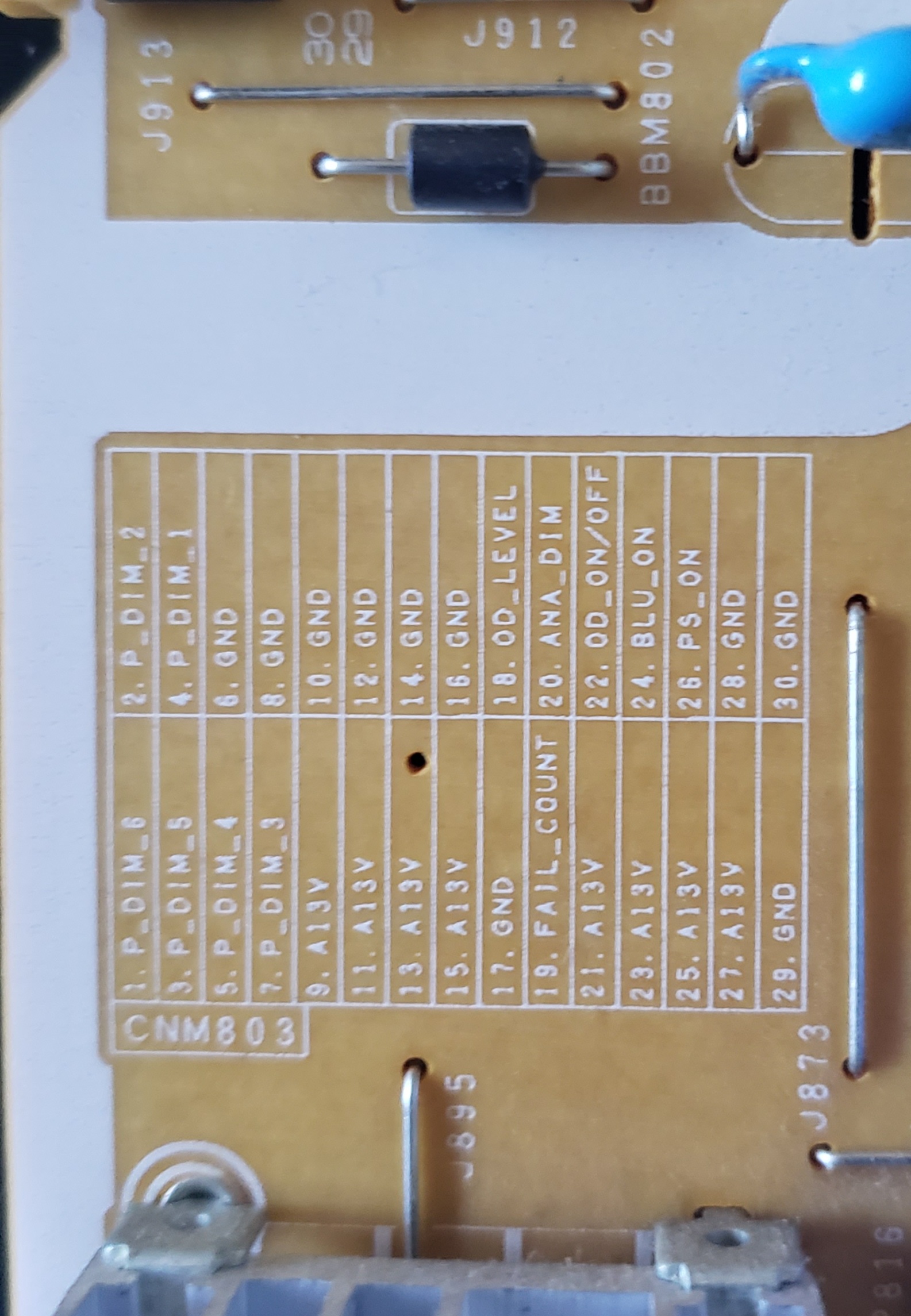

    I have got a 55 inch Samsung curved tv, it doesn't power on. There is no backlight, audio or video. I could see backlight on if mainboard is disconnected from smps board. I suspect the main board is culprit. Below are the readings I get on board -
    Stand by voltage 13V
    PS ON 4.5V
    BLU ON 3V
    OD ON/OFF 3.6V
    ANA DIM 3.3V
    OD Level 3.6V
    Also the voltage on main caps is jumping from 391V to 168V continuously.
    Re: Samsung UN55JU7500F

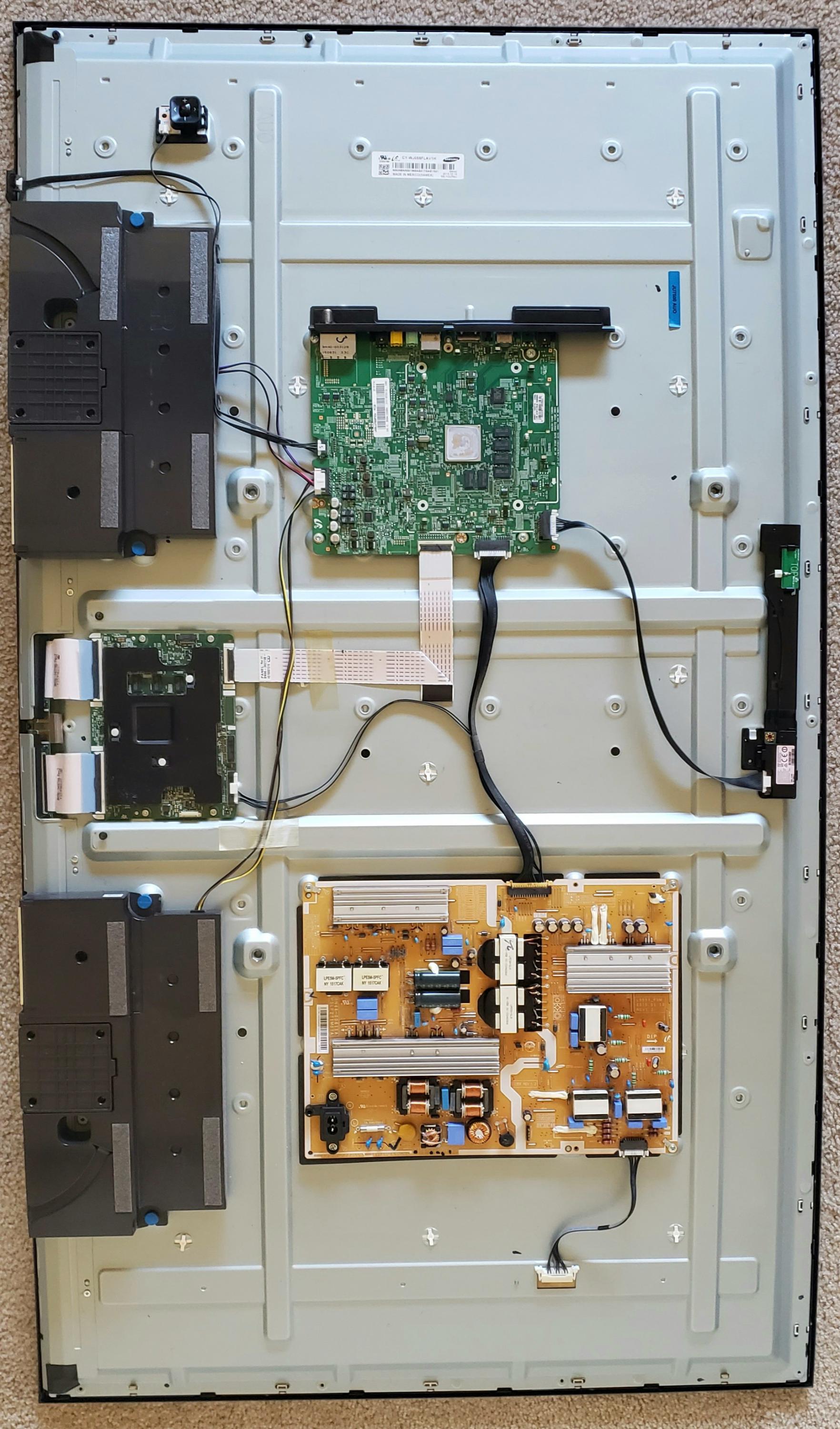

    1) So if you run the power supply board by itself, does the PFC Boosted Voltage stay at 390VDC?
    2) If all boards are connected. When TV is turned on, does the PSON stay at 4.5V or it jumps up and down?
    3) Can we see the pictures of the whole backside of the TV showing all boards?
      Hi Budm,
      Thanks for reply. Pfc voltage stays 391v if main board is disconnected. PS on is jumping between 3.3V to 0.09V when are boards are in place. I'll attach photo of the entire back of the tv.
        Back side of the tv with all boards connected. I have removed the heat sink on main board. It also has a one connect box separately.

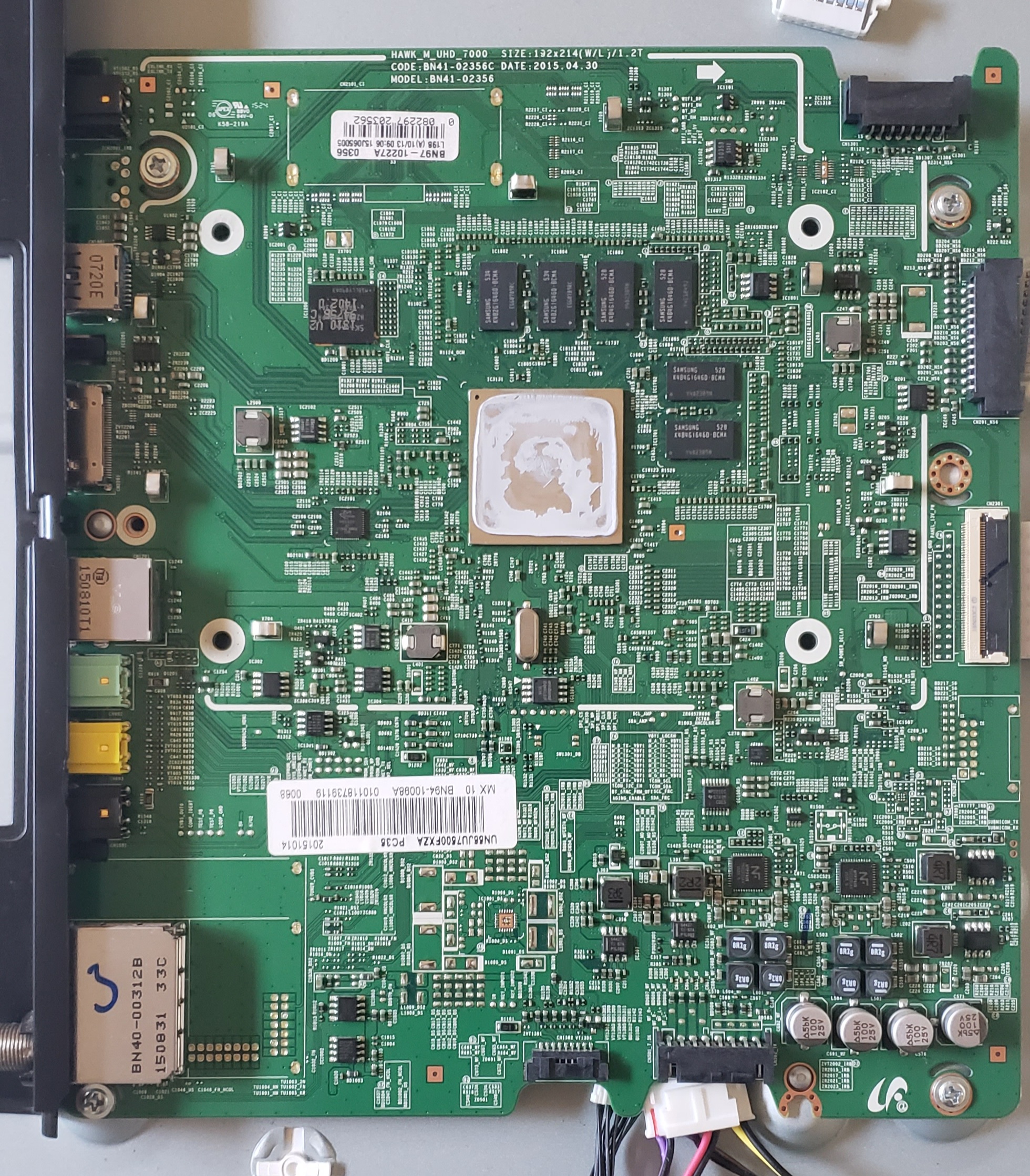

              If the standby voltages are stable and PS-ON signal is stable, main board is suspect if TV doesn't turn on.
                While main board is disconnected, shorting PS_ON pin with GND makes the backlight to turn off and pfc voltage goes down to 168V also other voltages drops. Does that indicates something wrong with PS?
                • neilc6
                  • Nov 2015
                  • 1550
                  PS_ON is active high with a pull up resistor. Shorting it turns it off.
                    So if it turns off then I should be getting 0v on 13v pin however it just drops to 9.2V. Also there would be some buzzing noise when I short PS-ON pin. Not sure if its really mainboard or ps itself. Could someone help to diagnose mainboard as well.
                    • neilc6
                      • Nov 2015
                      • 1550
                      I believe 9.2V is the standby voltage and gets boosted to 13V when turned on. Power supply is behaving as expected.

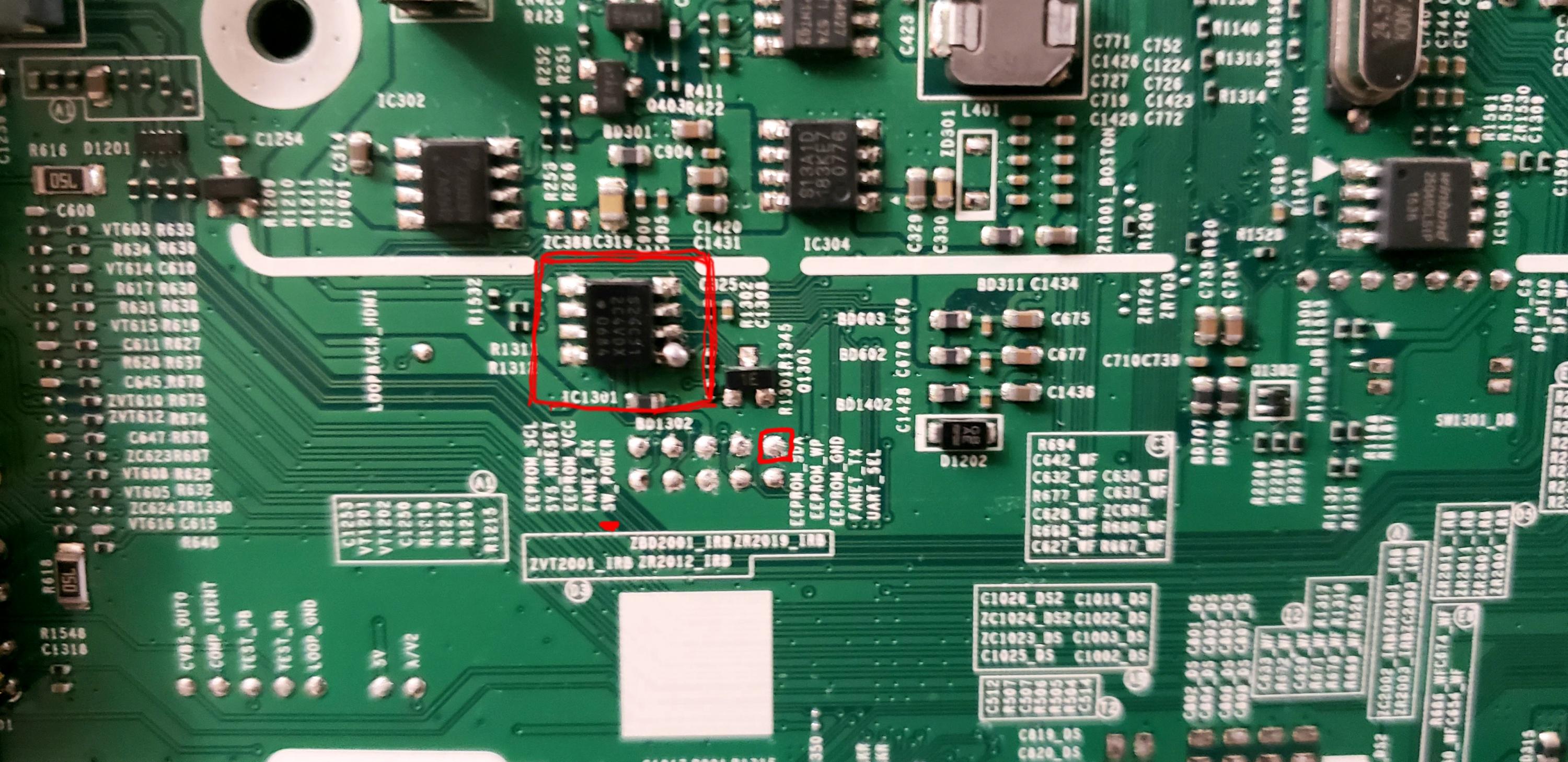

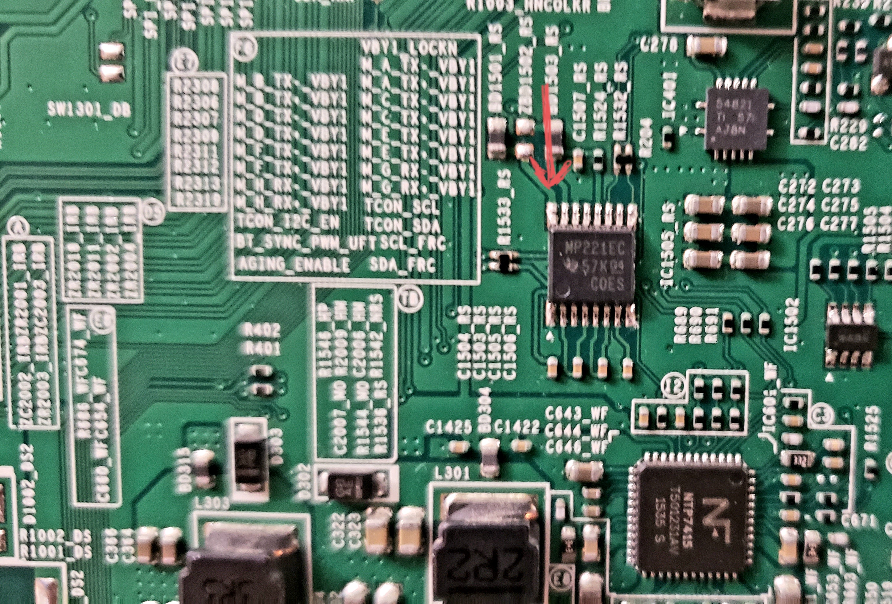

                        Posting more findings -
                        1. Getting fluctuating voltage from 0.6V to 3.6V on SW_POWER test point near IC 301 which I believe is an eeprom (part number S24C51) hence the VCC of IC is also fluctuating. However if I remove PS_ON pin on the connector keeping other pins connected, voltage is stable 3.6V to eeprom vcc.
                        2. Also found the PIN#10 of IC1505_RS (part number MP221EC) connected to PS_ON pin on the connector, which is also fluctuating.
                        Can someone help to figure out or isolate the issue on the main board? I'm not able to find the mainboard replacement on shopjimmy or ebay, also whatever is available is very costly above 100 bucks.
                          It looks like two of those IC legs (5 & 6) are soldered together. (S24C51.jpg (1 of 2))
                          • anupkg1985
                            • Sep 2020
                            • 180
                            No its not, I was trying to reset it using shorting sda pin to GND however no luck. But those two pins are not shorted together.
