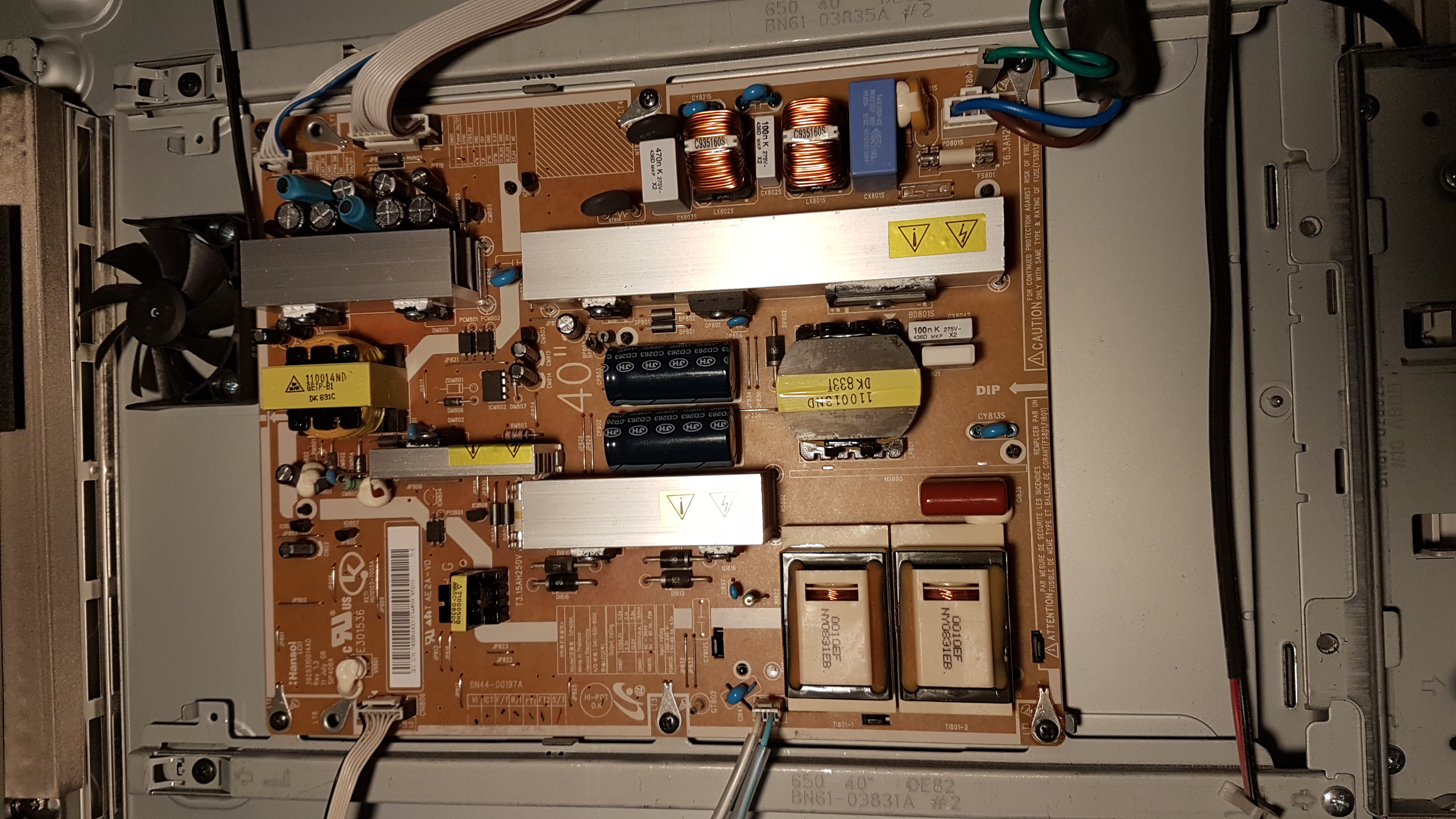

    I have a Samsung LE40A676 with the same phenomena as these posts:
    https://www.badcaps.net/forum/showthread.php?t=73891
    https://www.badcaps.net/forum/showthread.php?t=45913
    Blinking red LED and several minutes to start up.
    I have checked the PSU board and there's no visibly bad caps. I have also measured all caps on the PSU board an they all seem to be Ok, just to be shure.
    Does any one know if there's a "bad C102" or similar on this main/video board to replace, as the talk about in the linked threads above?
    I can't see any caps that looks bad or anything else that not looks as it should.

    Re: Samsung LE40A676 takes several minutes to start
    Start with testing the voltages at the connector on the powerboard the one with the cable that goes from powerboard to mainboard on powerboard side, with EVERYTHING hooked up, you measure them with your mutimeter, set meter to 20 vdc then report them, put neg probe on chassis metal ground, pos probe on pin of connector, measure in standby take note, leave probes where they are then power on tv and again take note of voltages, report them here, example pin 1-ps-on-0 volts standby-power on-3.3 volts. This is how we see what voltages you do or don't have.
        Check all the diodes on the powerboard.
          Yes, all diods checked and they are all Ok.

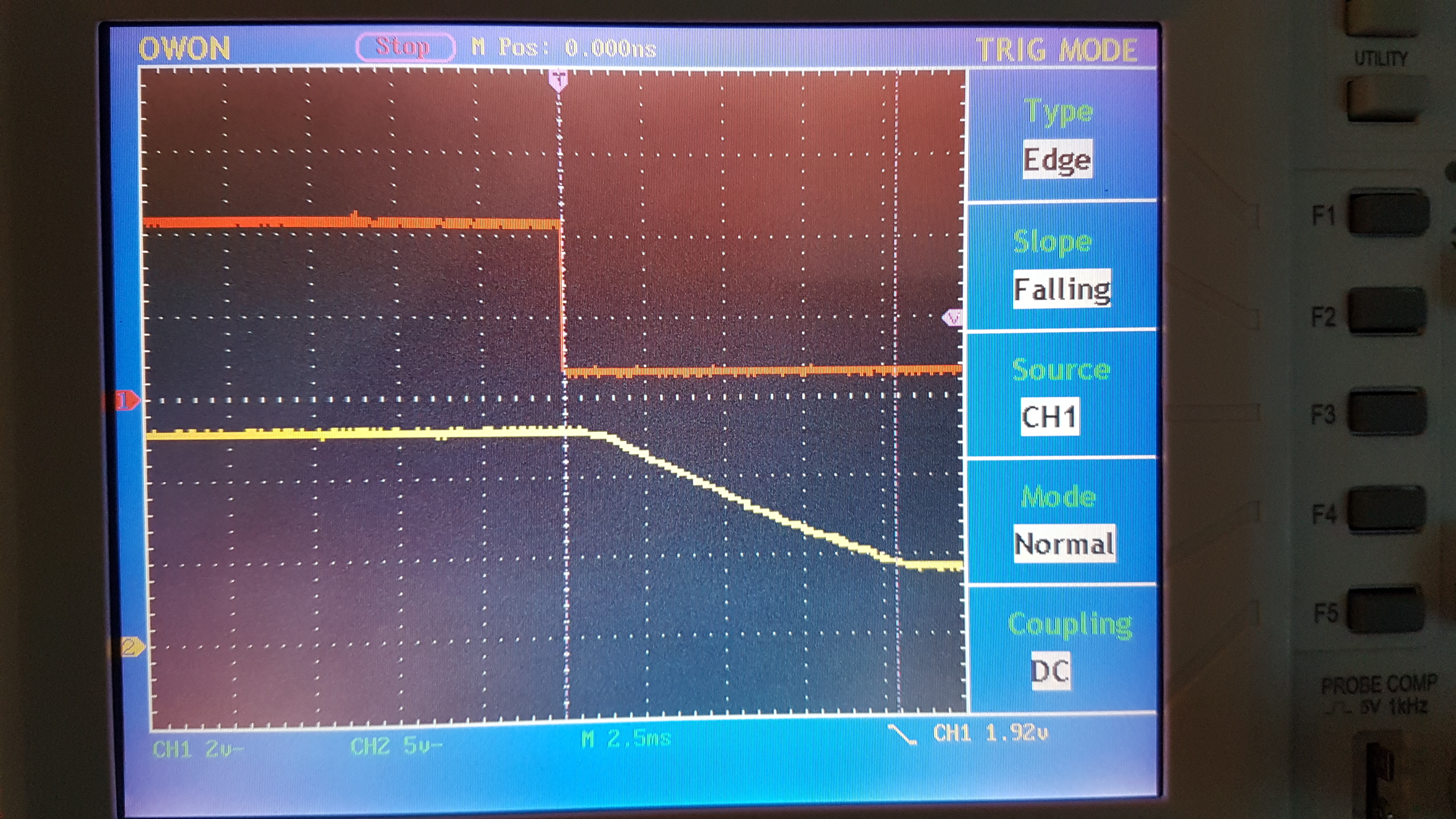

          Since all voltages from the PSU board seems to be Ok and the power is shut of from the mainboard, I would guess the problem is on the main board?
          The attached image shows the red power on signal (pin 1) and the yellow is the 13V output (pin 7) from the PSU board.
          Here we can see that the power-signal goes low befor the 13V starts to drop.

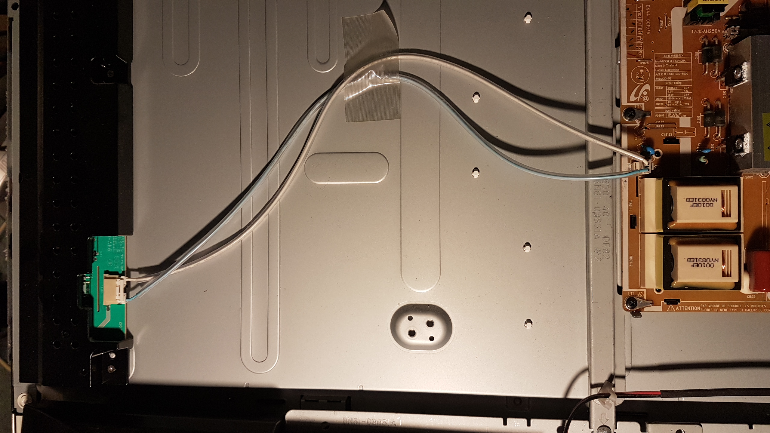

                  Ok, but haven't we already found that the backlight doesn't work/light up?
                  When the PSU starts for 15s, there is no power on the backlight connector witch I guess it should have?
                  Or is the backlight power controlled separately?
                  (I guess the image shows the backlight cable/connector, right?)
                    The voltage on THAT connector is likely around 3~5KV at 60khz, what are you using to try and measure it? That connector feeds a distribution board and the ccfl's, If there is a problem ie: bad connection, bad transformer, bad ccfl etc. the backlight will detect the error and will shut down.
                            Slightly unplug the connector going to the HV distribution board (leave the plug in the connector but allow about 1/8" of distance between the contacts) and see if you get some arcing when first turned on. That will tell you if the high voltage section on the power supply is working
                            I would also remove the black shield from the inverter dis. board and inspect the connections and transformers for each ccfl. You can leave the plastic off but reinstall the ground screws.

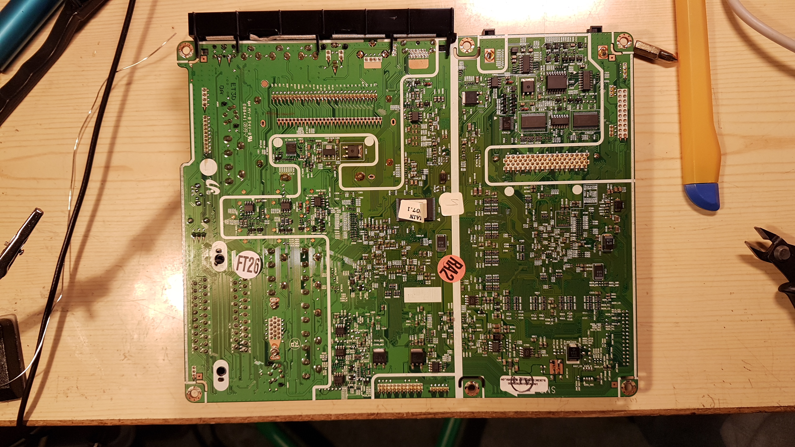

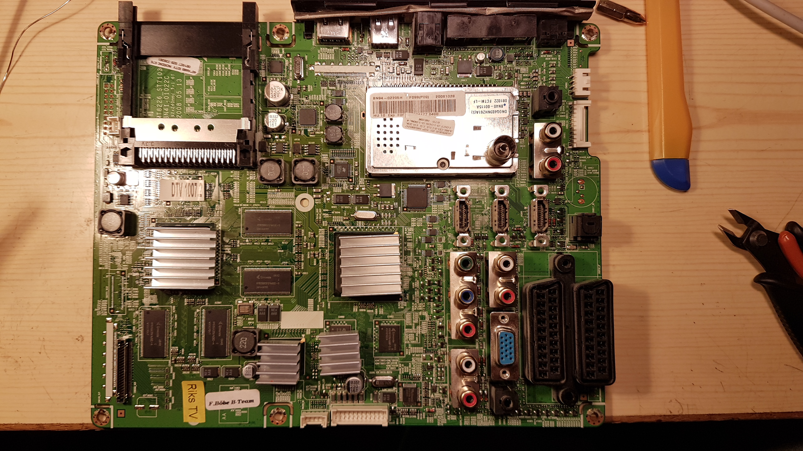

                                    The inverter on/off signal comes from the main board so you could force the power supply on to prove the fault is on the main board
                                    Try using a heat gun to heat areas of the main board to see if it will turn on sooner.
                                      As RJ says there appears to be an issue with Inverter On signal from the mainboard to the power supply.
