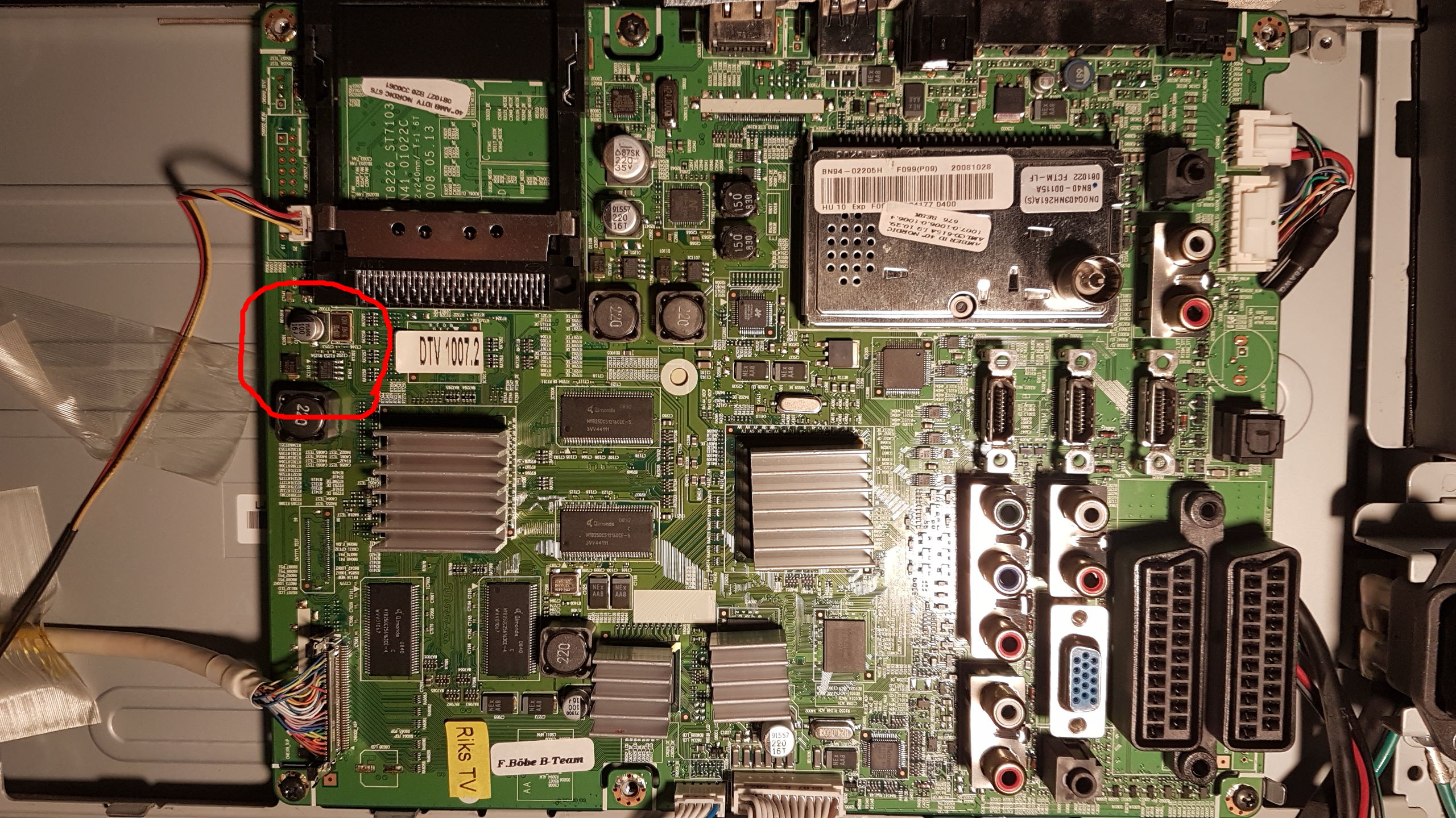

    Thanks for your advices! I went for the easiest test first, which was just to heat up the main board a bit, using a hair dryer, and then try to start the TV.
    That was a success!
    After heating up the main board a bit, the TV started up immediately!
    Does this brings us back to find the "bad C102" on the main board, or do we suspect something else?

            By heating the marked area I could make the TV start in a few seconds.
            Now I can focus on finding the defective component.
            Hope I'll be back soon!

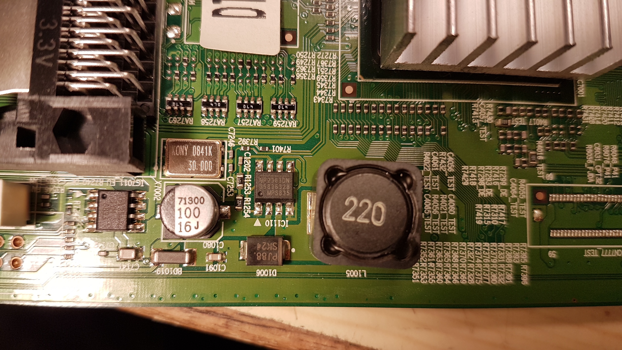

              Since that area that you heat up has lytics cap (100uF 16VDC), you can try replacing that Cap (LOW ESR type).
              Also, what is the designator and what is printed on that black rectangular component to the left of the IC1110?
              • Chrille
                Chrille
                • Feb 2021
                • 21
                • Sweden
                Re: Samsung LE40A676 takes several minutes to start
                The 100uF cap seems to be Ok but there is a MP2363DN (IC1110) that I've read from other threads that can be faulty...
                At the moment everything points at IC1110. I took my Hot air soldering station and tried to focus the heat on IC1110 only, and when I did that, the TV started.
                I can't say by 100% because some air may affec surounding components but there's a big chans that that's the component to replace!
                Then I just have to find a place from where I can buy it...

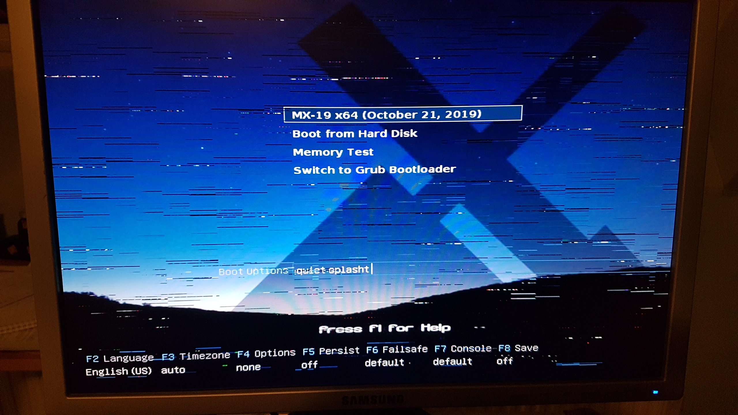

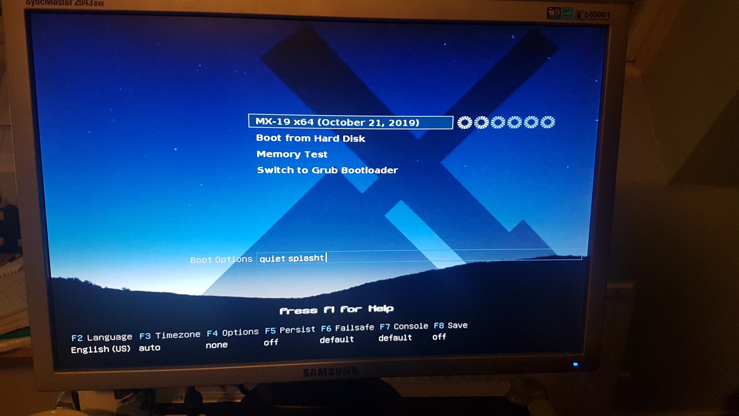

                              Recently I "fixed" a defective graphic card just by heating it in the owen 15 min in 125 deg C.
                              I know, I didn't repair the card, but I made it work. Don't know for how long, but it's still working after a week. The two images shows before and after. This was NOT a fix for bad solderings and I'm not going to talk more about that here, but the temperature prove my words.
