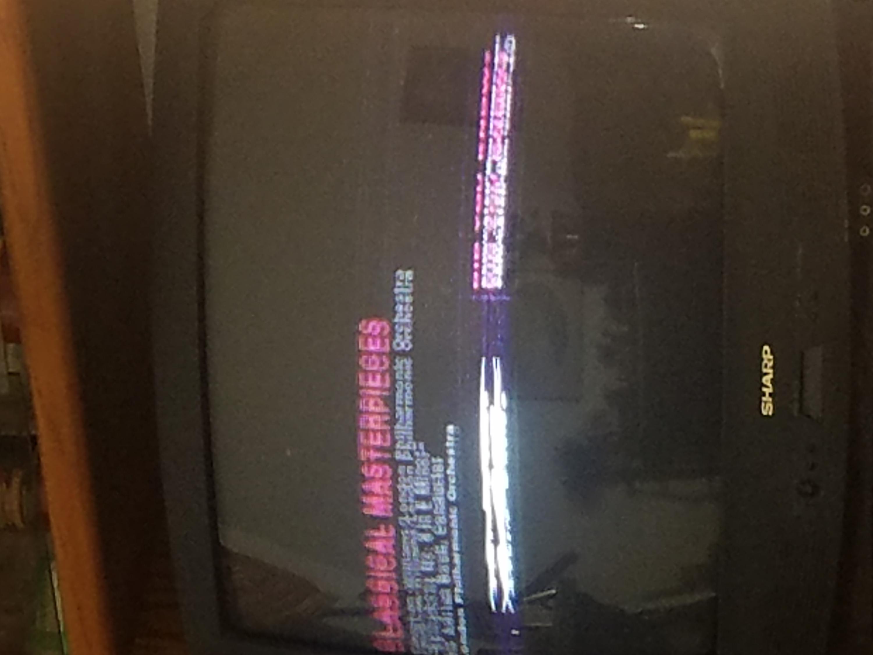

    So there's an old TV in the living room. The picture starts out fine for a few minutes then does what's in the pic. Sometimes it'll go back to working fine or stays like that until it's turned off. The sound works fine so I just use it for the music channels. Is it connection issue or something inside?

    If the fault is intermittent, check the connections on the vertical output ic and in the vertical output section.
    This is a Sharp not a Sony
    How about a model number? and when you take the back off, provide some pictures of the chassis.

      Haha, and it says Sharp in the pic too. See, what happened was..
      The sticker fell off in the back with the model number and all that but from doing some research it appears to be 25j-s100. I'll take the back off and take the pics tomorrow.

        There is likely a model/chassis sticker inside somewhere. If this is the model (or 25k-s100) the vertical output ic is IC501 mounted to a heatsink near the center of the board

          If 25j-s100 , resolder ic501 ( TA8403K )( remove old solder / clean / resolder )
          For good measure also replace c508 35v 100uf & c510 35v 1000uf

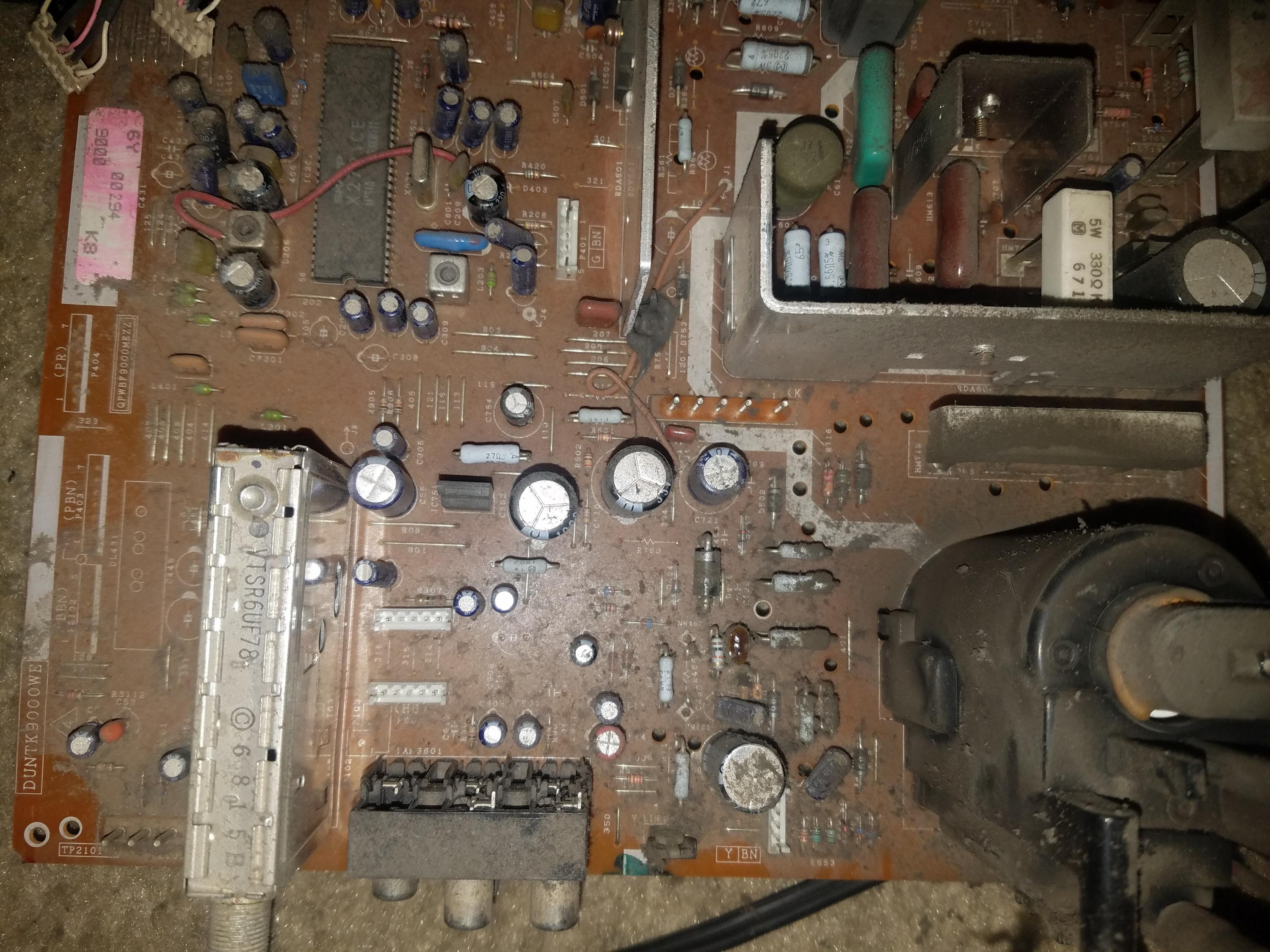

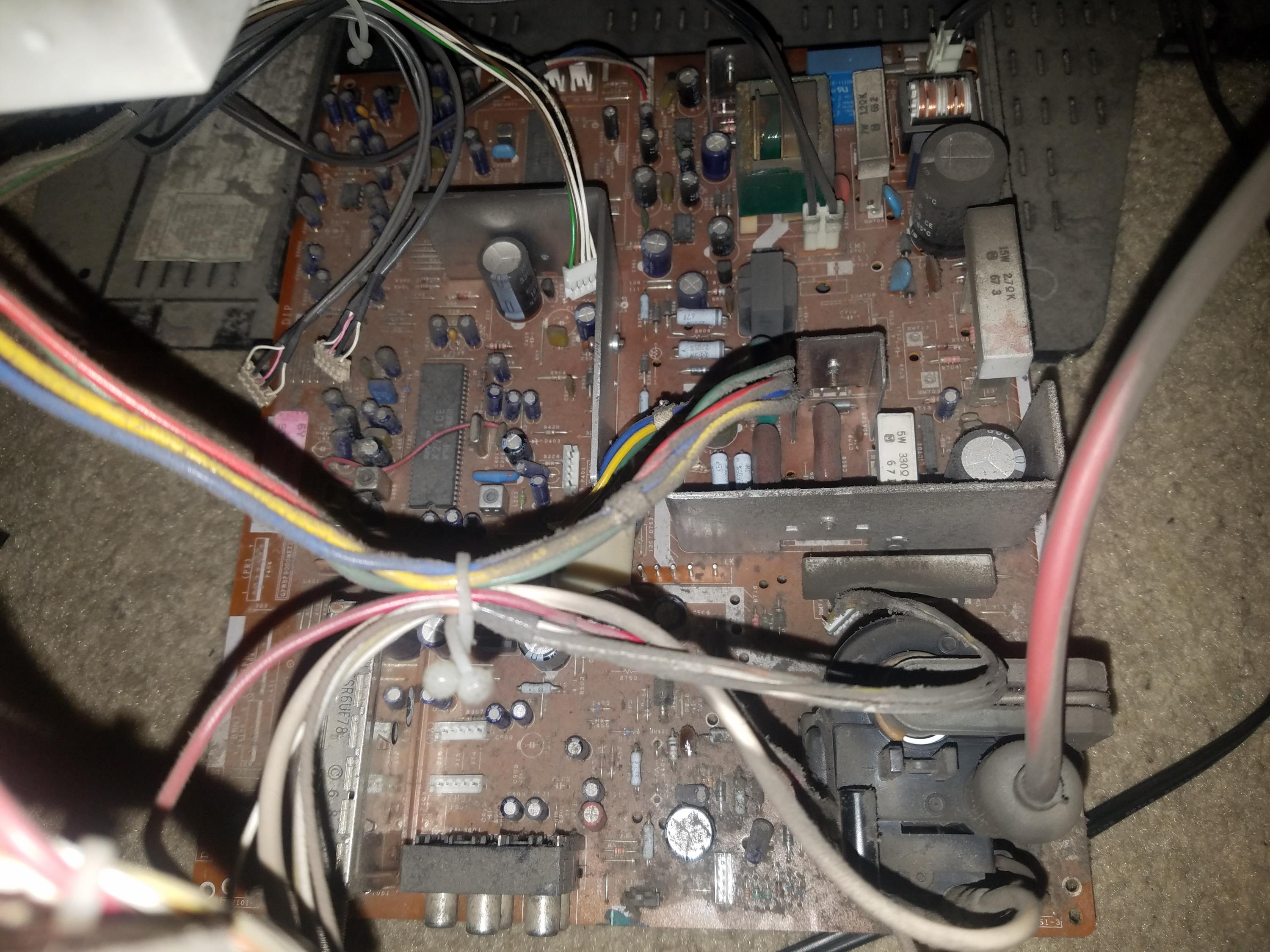

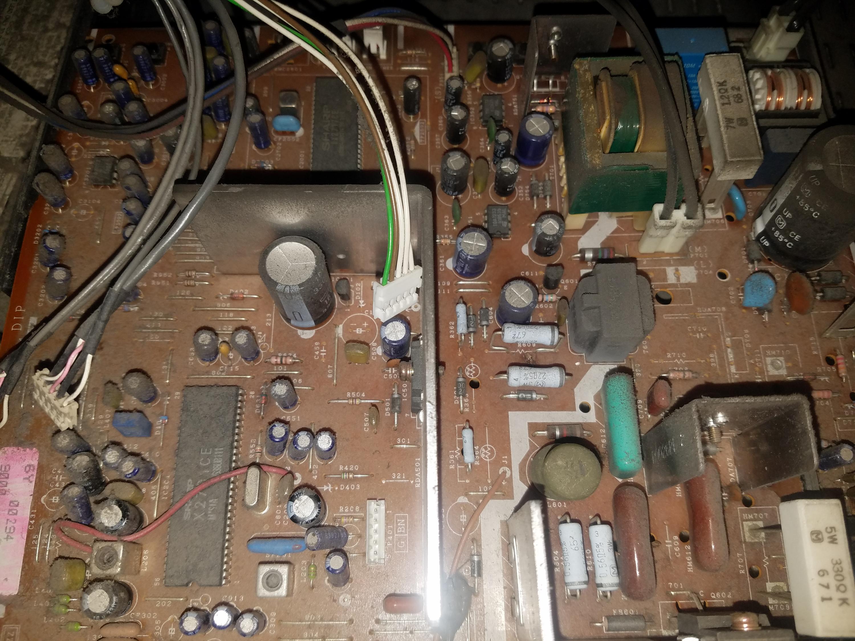

            Finally got the back off.
            I took it to my room and hooked it up to a different coaxial cable and it seemed to work when I moved the cable to a certain position but the tuner is fine. Dont think its the cable cause it works on the other TV.

                  If you want it fixed, do what we suggested and solder the vertical output ic.
