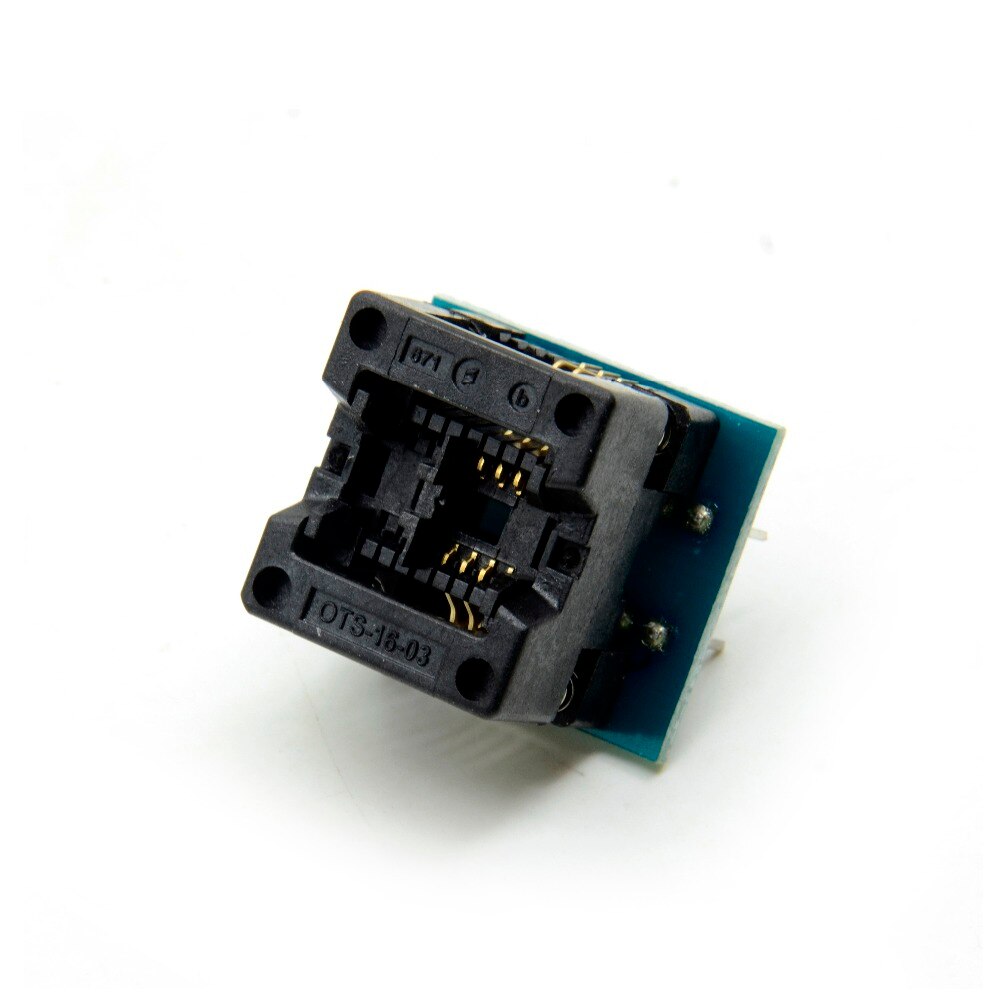

        Re: CH341A programmer
        I use ZIF socket adaptors for these ic's Something like these
