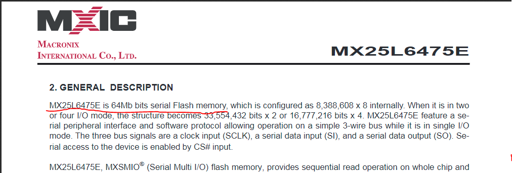

    i have ch341a programmer. iam trying to program MX25L6475EM2I-10G chip with 16mb file, bu the programmer software(v1.18) says ''FILE LENGHT, BEYOND RANGE OR IT WILL BE IGNORED''. What should i do? Thanks!

                      To write a 16Mb file, you must have SPI Flash 25x(128) and your flash is only 8Mb wide.

                        MX25L6475EM2I-10G
                        how did you know its size?

                          64 Mb bits = 8 Megabyte (Mb).

                            Now the situation is clear. So i need MX25L12872FM2I-10G than? Thanks to all!

                              Yes, you can use any for 128, MX25L12835FM2I-10G...

                                or you can flash the 8MB bios version
