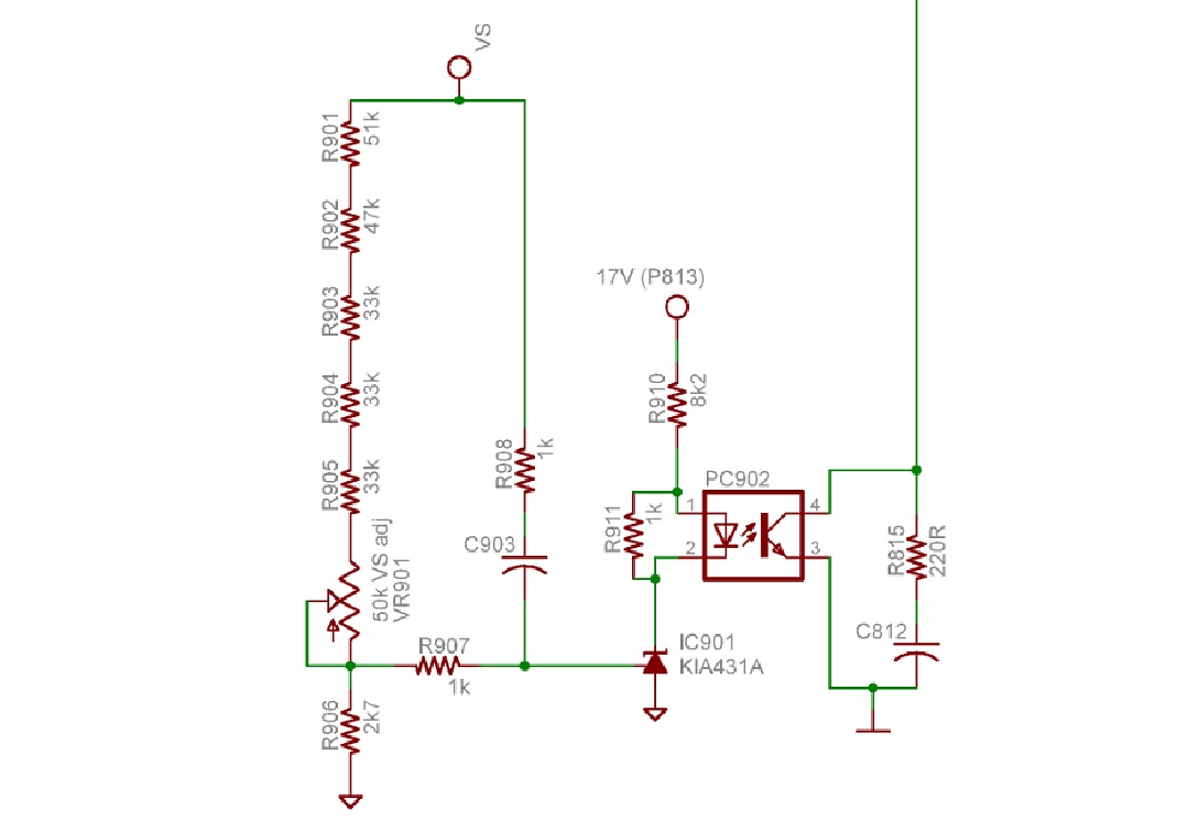

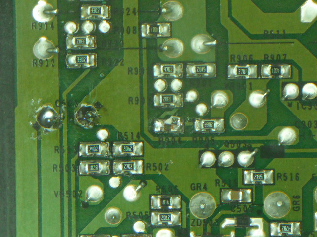

    Hello All reading this post. Once again I will try to explain my misfortune. I am trying to repair an LG EAY62171101 plasma power supply board. I almost have it working, however on the foil side of the board it seems that R904 is damaged so I have taken a closeup image of that area on the board. They say a picture is worth a thousand words so please view it and let me know if anyone out there can get back with me on the value of R904.
  • R_J
    • Jun 2012
    • 9625
    Re: LG EAY62171101 Plasma Power Supply
    It will be the same as R905 (33kΩ)

      Thanks for the information. How did you get a schematic for this power supply? I can't find it anywhere and LG is useless on divulging technical information. Checked and not even Sam's Photofact doesn't have it.
      • R_J
        • Jun 2012
        • 9625
        The circuit is common and is from a different board.

          I have ordered 33kΩ resistors from Digikey. It looks as the physical size is 1/8 watt based on metric size 3mm by 1.6mm. Getting excited to get this TV working have spent a few hours checking capacitors and voltage levels. I did substitute a pot for 32kΩ and the set did power on, but no plasma ionization. I have the Sencore LC103 LCR analyzer and it tests components both in and out of circuit. I have another 50" plasma with the front tinted glass broken, but the tube seems intact. From what I've read a plasma screen will work even if it's cracked because the cells are separate just like a chain of neon bulbs. I won't know until I get that power supply back on line again. It's an older model EAY60713401.
