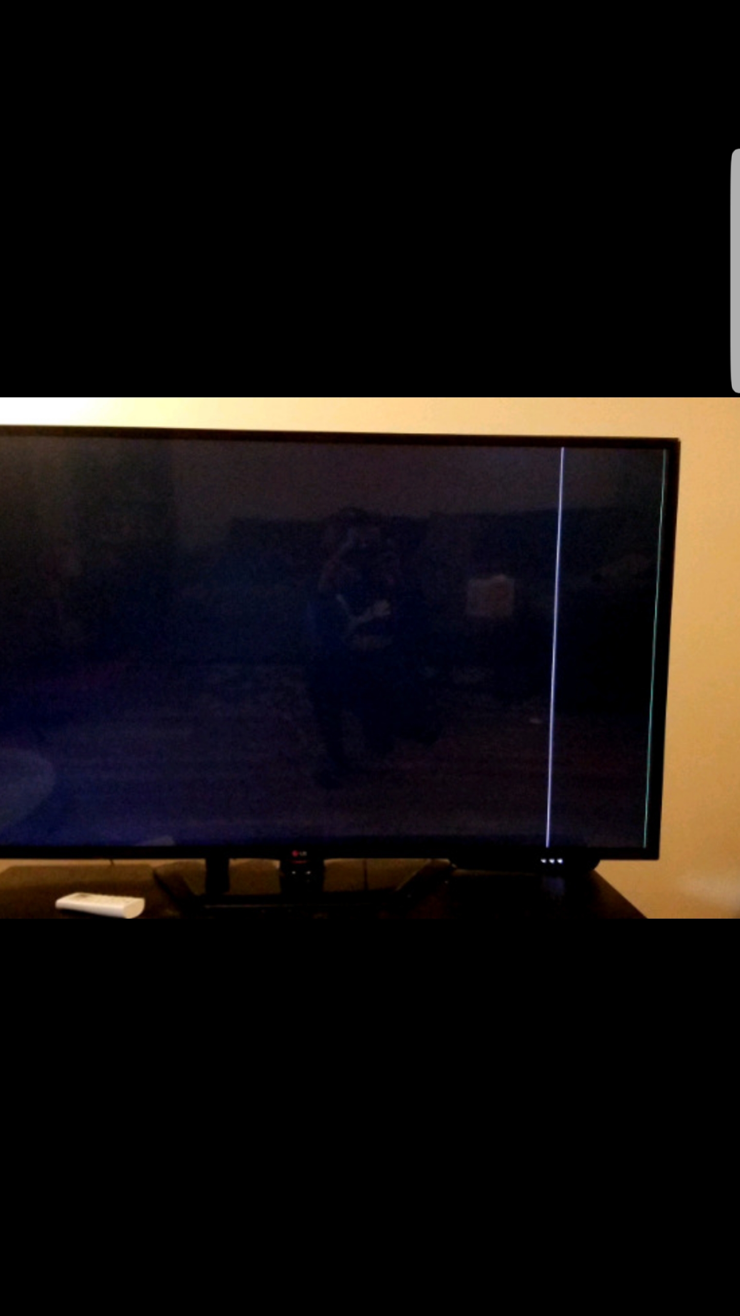

    hello i see theres a tv for sale in my area 60pn6500 with a line like this. is this a easy fix?

    Most of the times it's related to cof bonding issue on the panel, which needs special tools. If it's not related to cof then could be t-con or the ribbons connecting to panel from t-con. But if it's cof related then difficult to fix.
