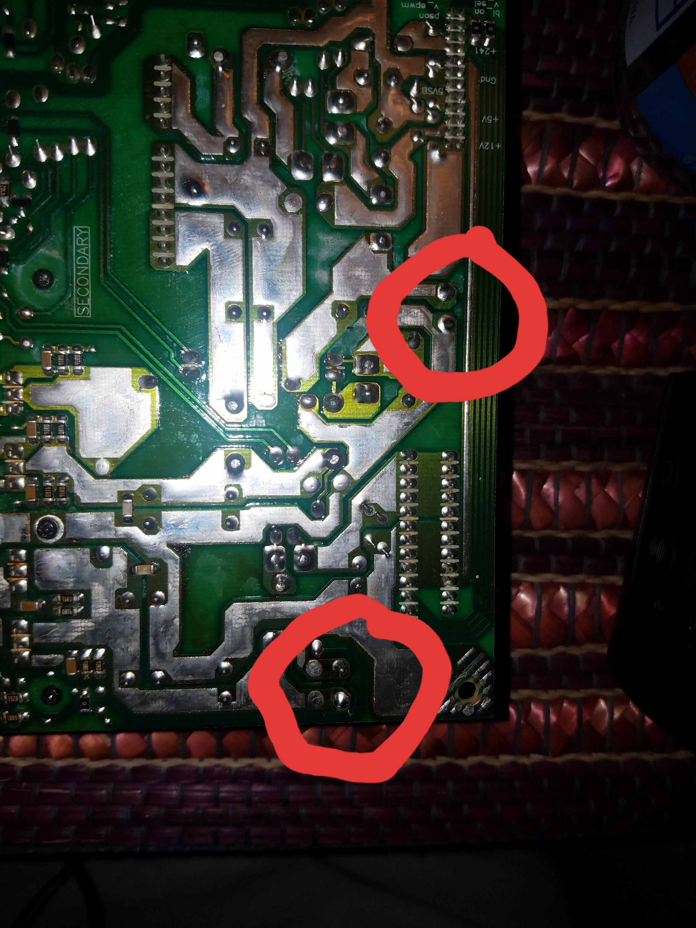

    Hello, new DIY here.
    My Westinghouse TV I've had for 15 years recently went out. First it wouldn't turn on, only the orange light. I would do the usual unplug for 30 seconds then it would work. About a month ago it stopped working completely. No orange light, nothing. Normally I would just buy a new TV but I want to learn how to fix it rather than just buy another one. Doing research it seems it's most likely bad caps, hence what led me here. I have all the equipment to do it. My question is, what caps do I buy for it?

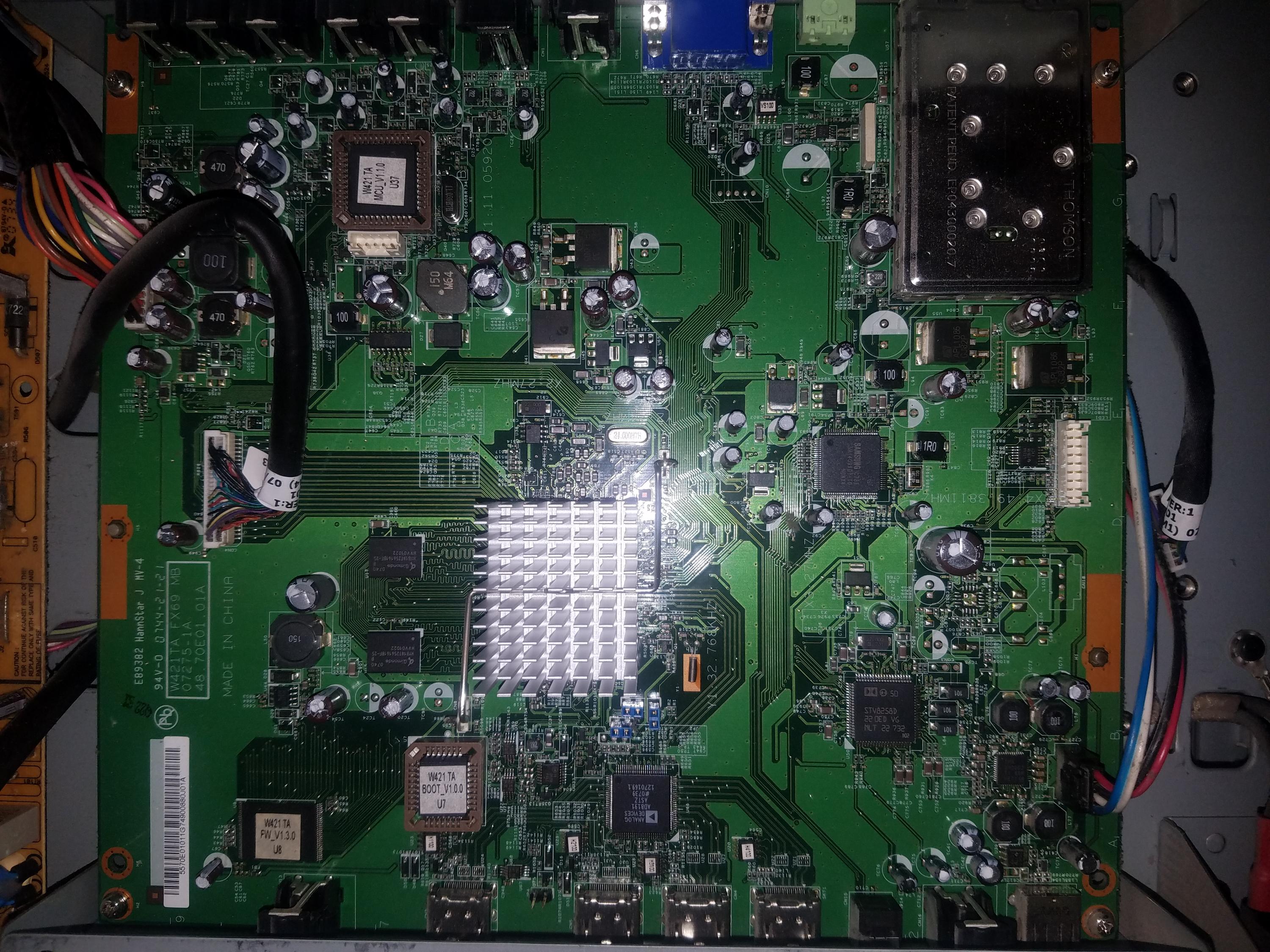

            Yeah, I finally got around to opening the TV and looking at it. I didn't notice any caps that were bulged or leaking. But from doing some research that doesn't mean one isn't still bad.
            I'm trying to post a pic. How do you embed pics on this site? Edit:Never mind I got it, I think.
            • dick_barton
              • Aug 2015
              • 6642
              • Wales
              Re: Westinghouse Tx-42f430s
              The board shown is your mainboard. Can you post a photo of your power supply.

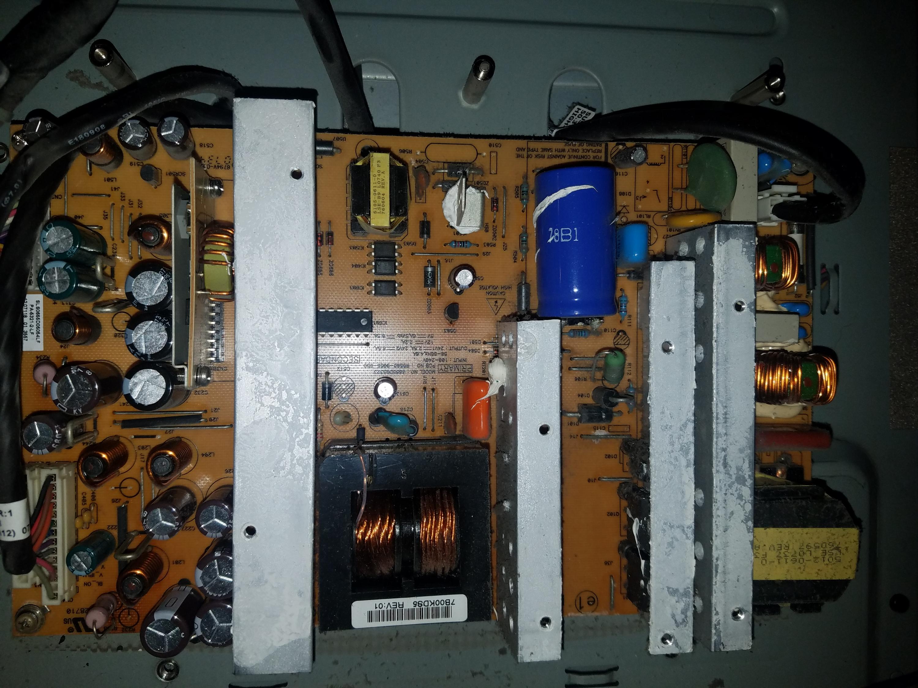

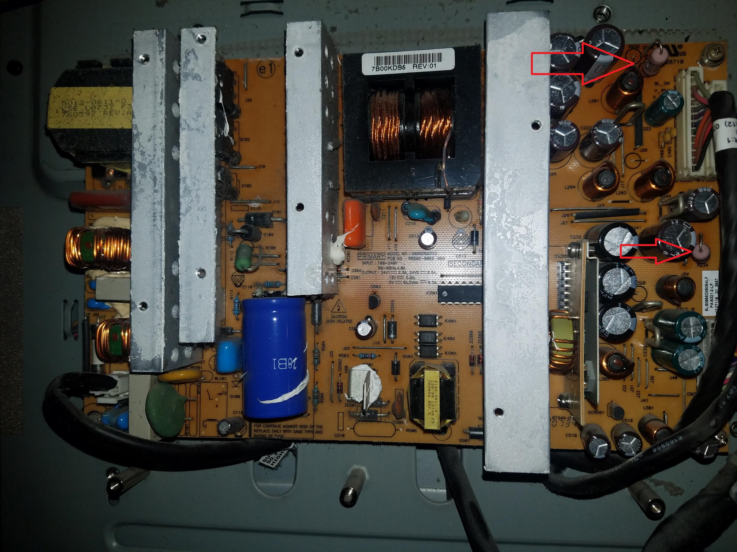

                  The power supply says it supplies two 24V supplies at different current rating, 12V , 5V and 5v Stby
                  Are any of them missing. The coils near the white connector may have aged solder joints or may have cracked joints so would be worth looking at the underside of the power supply for any solder joints requiring attention.
                  The two resistors look as though they have been running hot and I would check the solder joints of each of them.

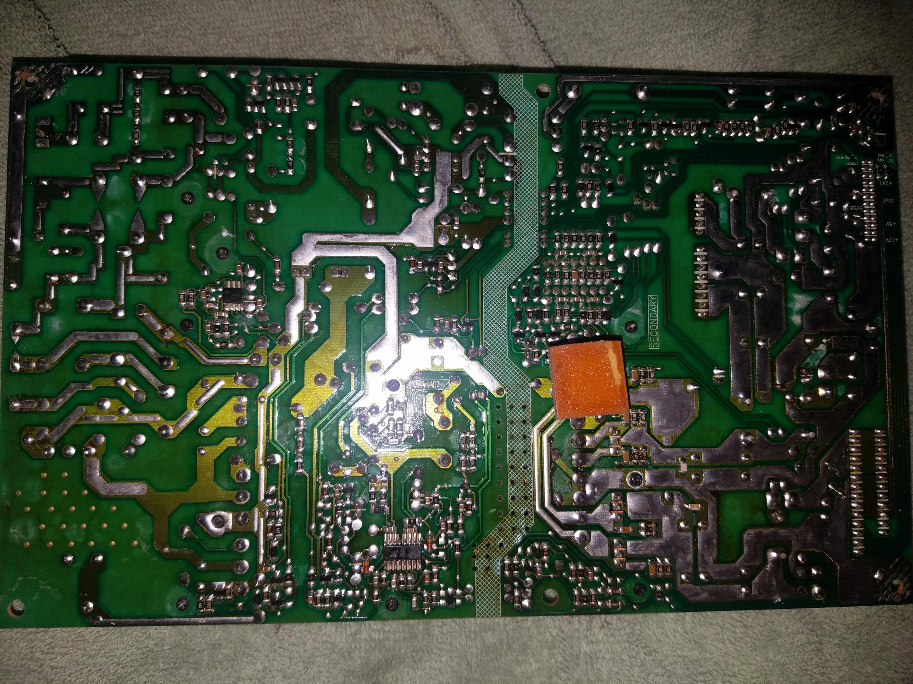

                    Here's the whole underside and then the 2 in particular.
                    I didn't notice anything missing but then again I wouldn't know what would need to be there, I'll have to look up a pic. There wasn't anything that had fallen off when I take the cover off.

                      So I replaced the 470uf 16V cap and now the orange light comes on but the TV still isn't turning on.

                        test the voltages at the connector on the powerboard with EVERYTHING hooked up, it's the connector that the cable from powerboard to mainboard hooks into, most times there's a legend/map nearby, (your expected voltages are right beside the connector) that gives the expected voltages, you measure them with your mutimeter, set meter to 20 vdc then report them, put neg probe on chassis metal ground, pos probe on pin of connector, measure in standby take note, leave probes where they are then power on tv and again take note of voltages, report them here, example pin 1-ps-on-0 volts standby-power on-3.3 volts.

                          Its reading 24V in standby, dont know how, and it won't power on, just stays in standby (Orange light). Before it wasn't even going in standby until I changed the 470uf 16V cap.

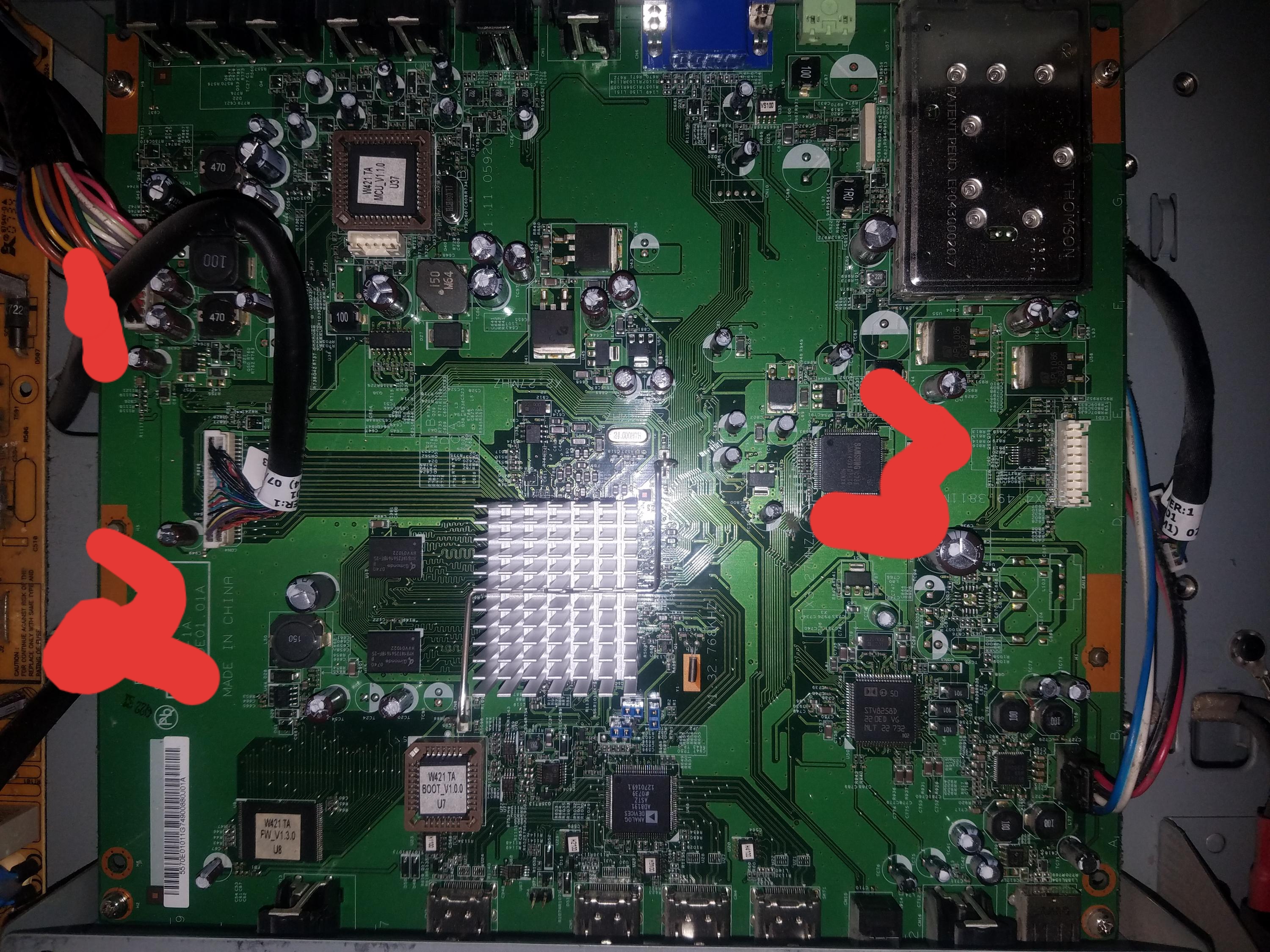

                                Now that pin is reading at 5V.
                                1 is reading 5V. This is the one that connects to the power board.
                                2 is reading .25V then 1.45V that can't be right.
                                3 is reading 4.65V
                                • nomoresonys
                                  • Jan 2013
                                  • 12097
                                  • U.S.
                                  You are on the mainboard there, this is an example of simple voltage testing on powerboard and usually where to start troubleshooting: https://www.youtube.com/watch?v=4v8DcqCNG4A

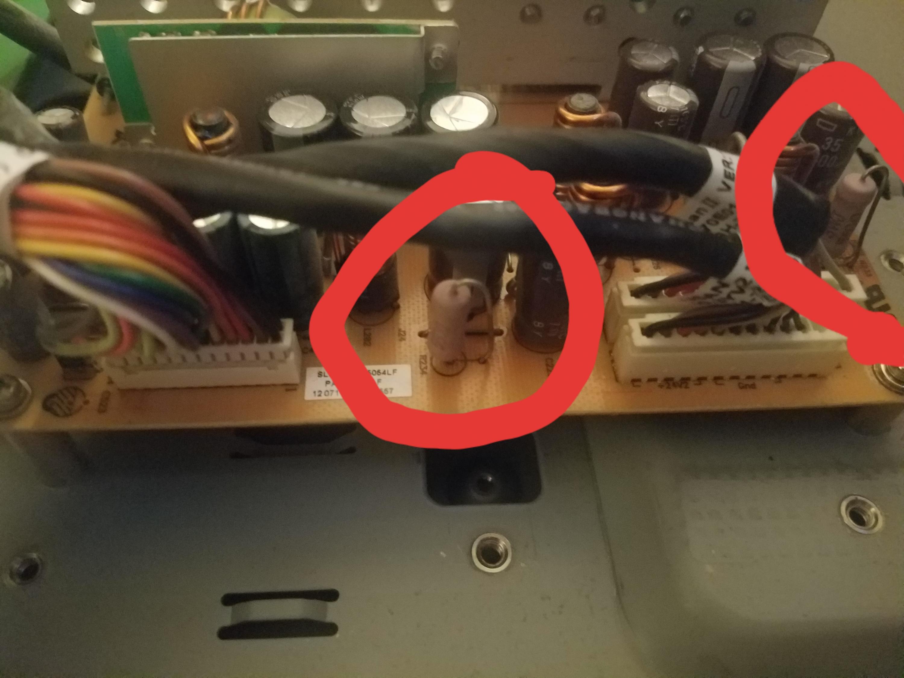

                                    When I do it that way I don't get a reading. When I do it where the wires are they read 24V. Maybe because they are set up differently? His were on the horizontal and mine are vertical. Or does that not matter?
                                    I did notice these were hot. Like a previous poster mentioned.
                                    • nomoresonys
                                      • Jan 2013
                                      • 12097
                                      • U.S.
                                      They're resistors, can be tested with multimeter, check youtube if unsure how to test.
                                      • CapsDude
                                        • Jan 2021
                                        • 50
                                        They're rated at 560 ohms and both are testing between 450 and 470.
