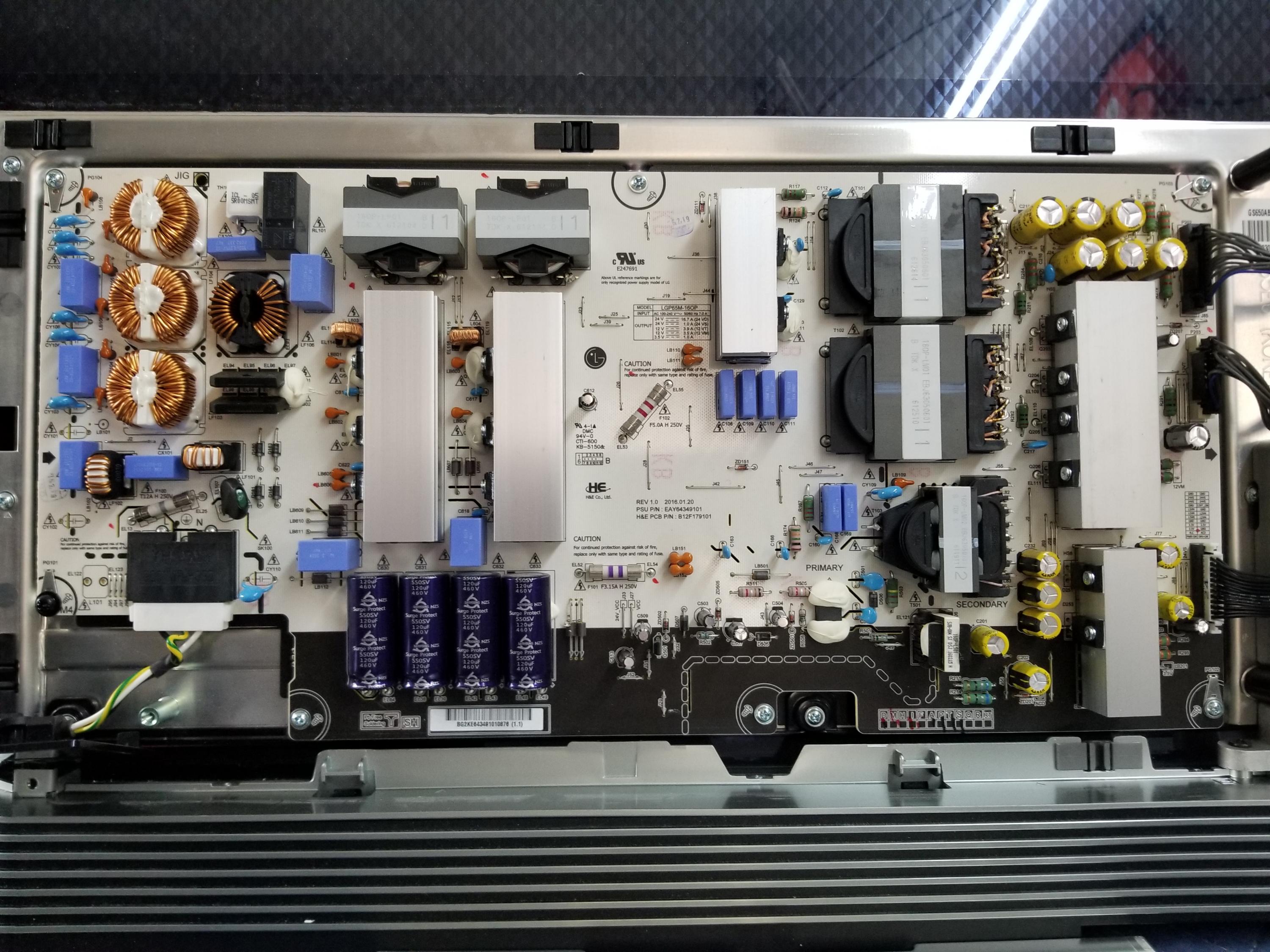

          Re: Lg oled65e6p-u.buswljr
          please upload focused high resolution photos on whole the backs and others for power board and the T-con
          • rplewis
            • Sep 2015
            • 82
            Just added the photos. Thanks
              okay,
              however i cant read the labels on the power boards sockets, but you should have one sockets go from power boards to T-CON which it feeds only 24V .. this socket disconnect it from T-con side... turn on the tv. give time to let it boot... just keep your eyes on the audio optical out put socket if the led indicator turn red and remain red ( this mean the tv working )

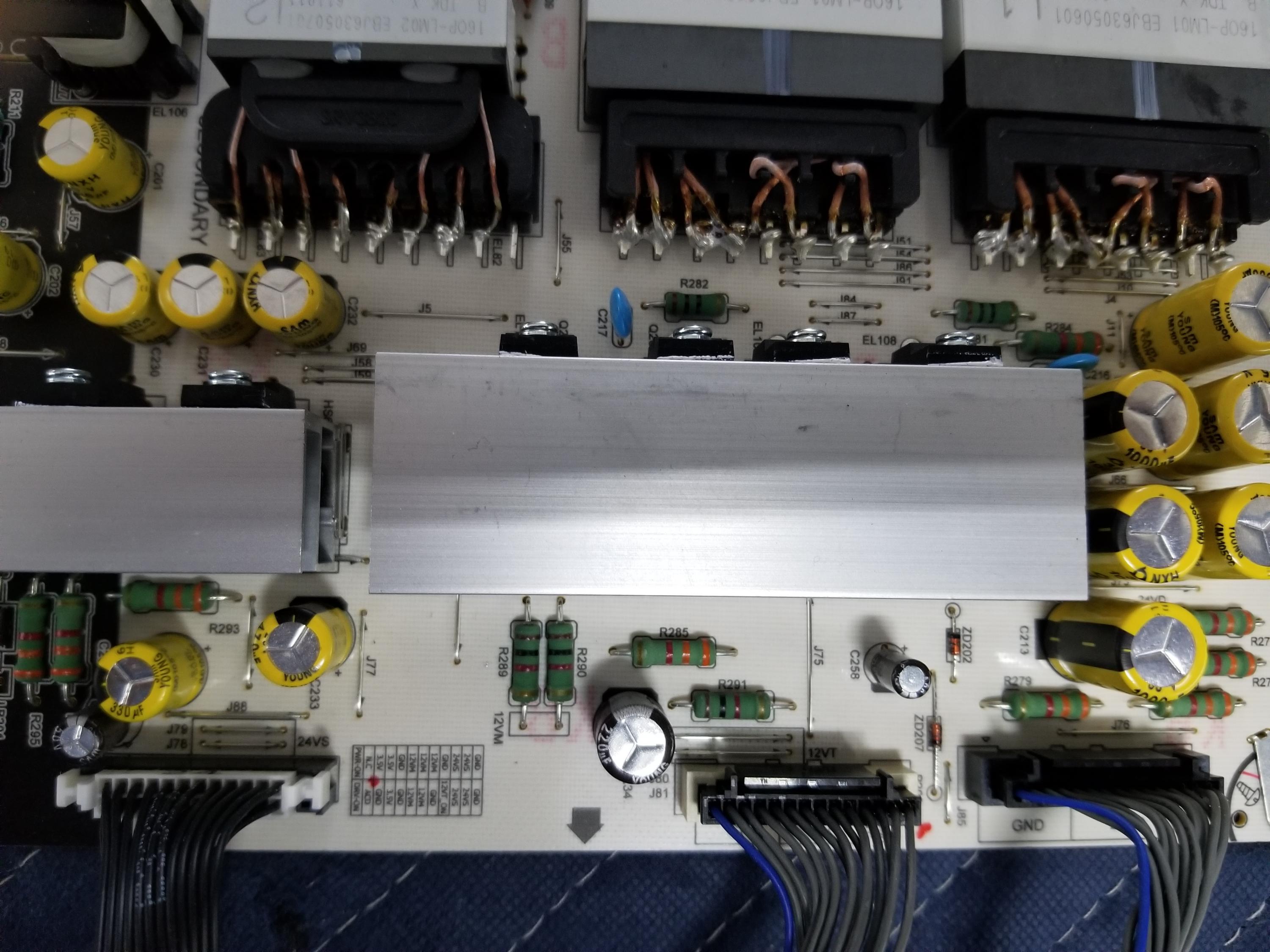

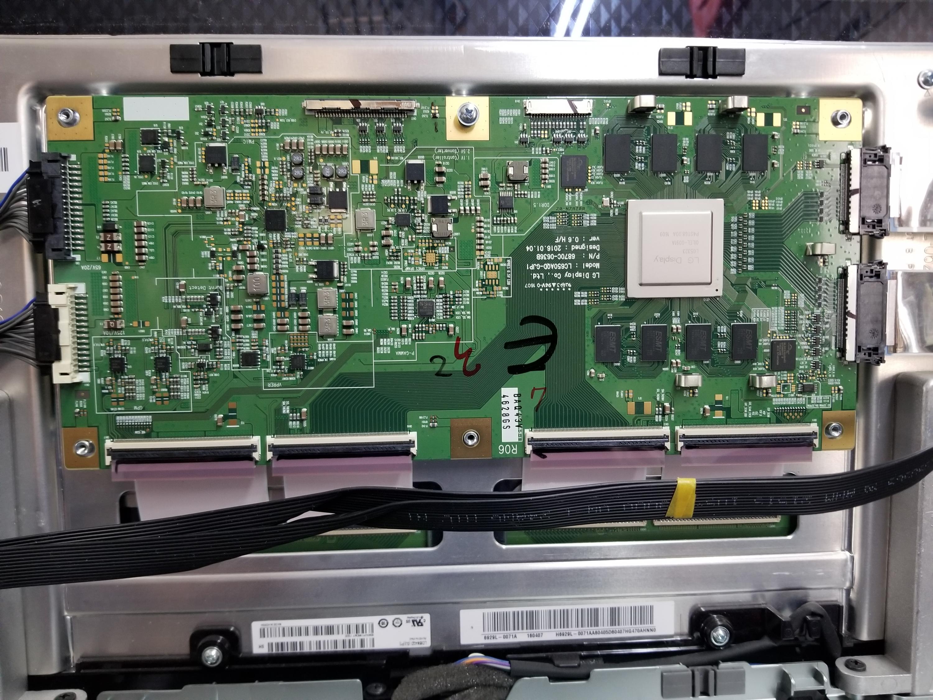

                Hey Diah.. Found the T-Con board. You think I should order all three boards or could it be the panel? Hate to just replace boards without diagnosing the problem, but only found one T-Con board. I just don't know why the power supply quit giving the voltage output once I unhooked the ribbon cables from the T-Con board to the panel.
                • rplewis
                  • Sep 2015
                  • 82
                  Attached is a closeup of power supply. Unplugged the 24 volt cable going to T-Con board. TV would not come on. Only have the red led on the front. Also only have the 3.5 volts on the PS socket.
                    1- you need first to test the power boards as stand alone to see if it work.
                    a- disconnect ( all 3 sockets )the main boards socket from power boards & the other sockets which they go to the T-CON
                    b- disconnect the 2 LVDS cable between main boards and T-CON ( unplug them from T-CON side )
                    2- on the sockets of power boards which it goes to main boards.. make bridge between
                    a- 3.5V & PWR-ON ( you should have 12V & 24V on the same socket )
                    b- 3.5V & DRV-ON ( you should have 12V on T-con socket & 24V on the other T-CON socket)
                    if you confirmed you have 12V and 24V on the sockets which they goes to T-CON then connect them back to the T-CON ( remember main boards should remain out from the circuit ) and turn on the set... let see what yours panel will display color pattern
                      Just made the jumpers from 3.5V & PWR-ON and 3.5V & DRV-ON. I do have 12V & 24V on the same socket and have 24V on the T-CON socket, but do not have the 12V on other T-con socket.
                      I thought I had all voltages when I tested it before I disconnected the panel cables from the very beginning of diagnosing this TV a couple of weeks ago.
                      I didn't connect the sockets back up to the T-con board and turn TV on. Wasn't sure if I should, being I didn't have the 12 volts.
                        so we do know no T-con 12V on power boards..
                        you have on the power boards 3 fuses at the hot area 2 am sure now okay.. but the one which go to 12V t-con it may be open now. so check all fuses

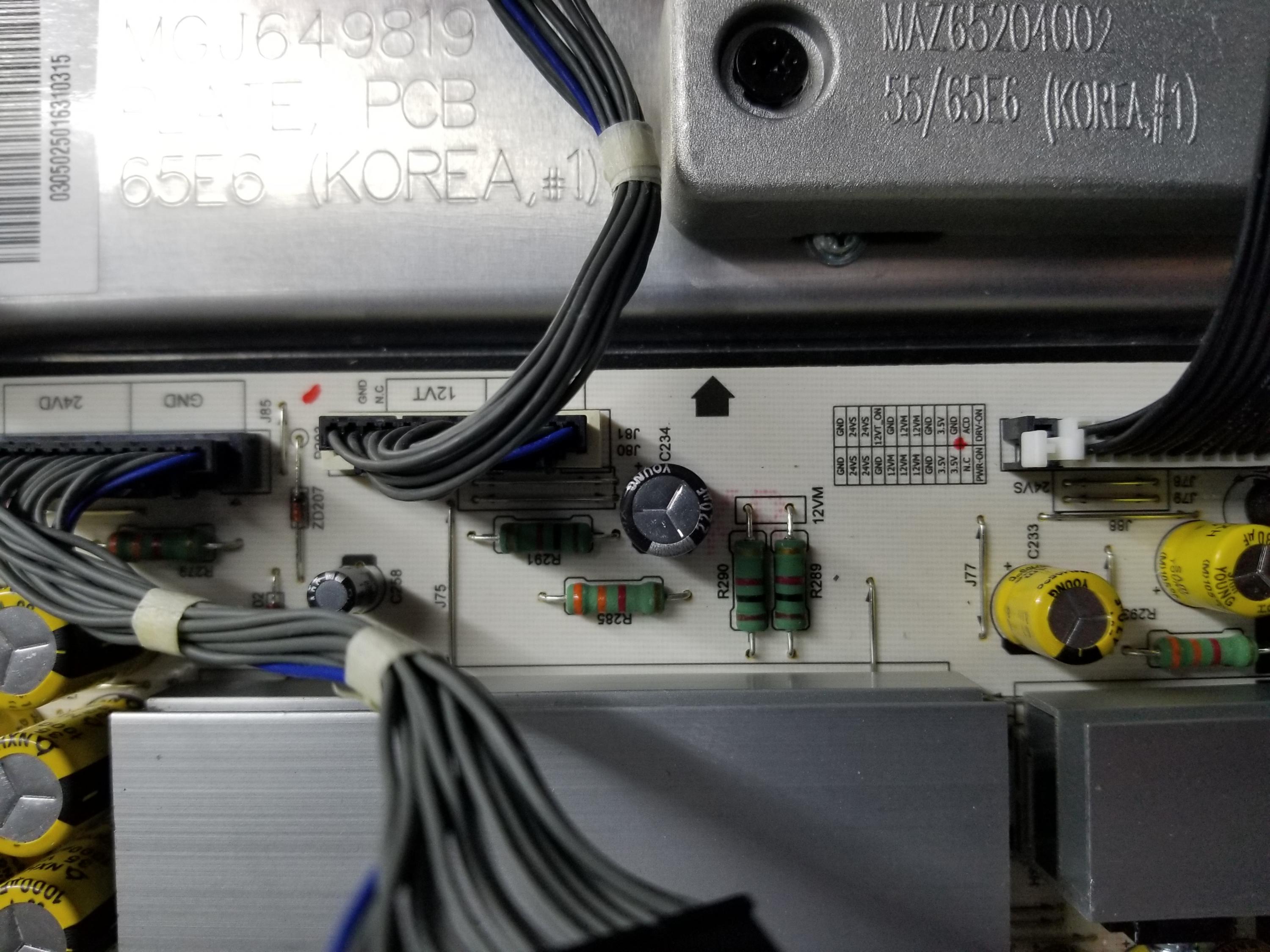

                                  take out the power boards out side the set and inspect the down side soldering on socket or on the big transformer... it sounds you have open joint soldering
                                  • rplewis
                                    • Sep 2015
                                    • 82
                                    Not seeing any problems on either side of power board.
                                    • Diah
                                      • Feb 2013
                                      • 6498
                                      follow the line back on the 12V T-con socket until the SMPS . need to test then if they are OPEN
                                      post please close photo on the socket 12V from down side and the top
                                      • rplewis
                                        • Sep 2015
                                        • 82
                                        Attached are closeup photos. Not getting any voltages to socket
