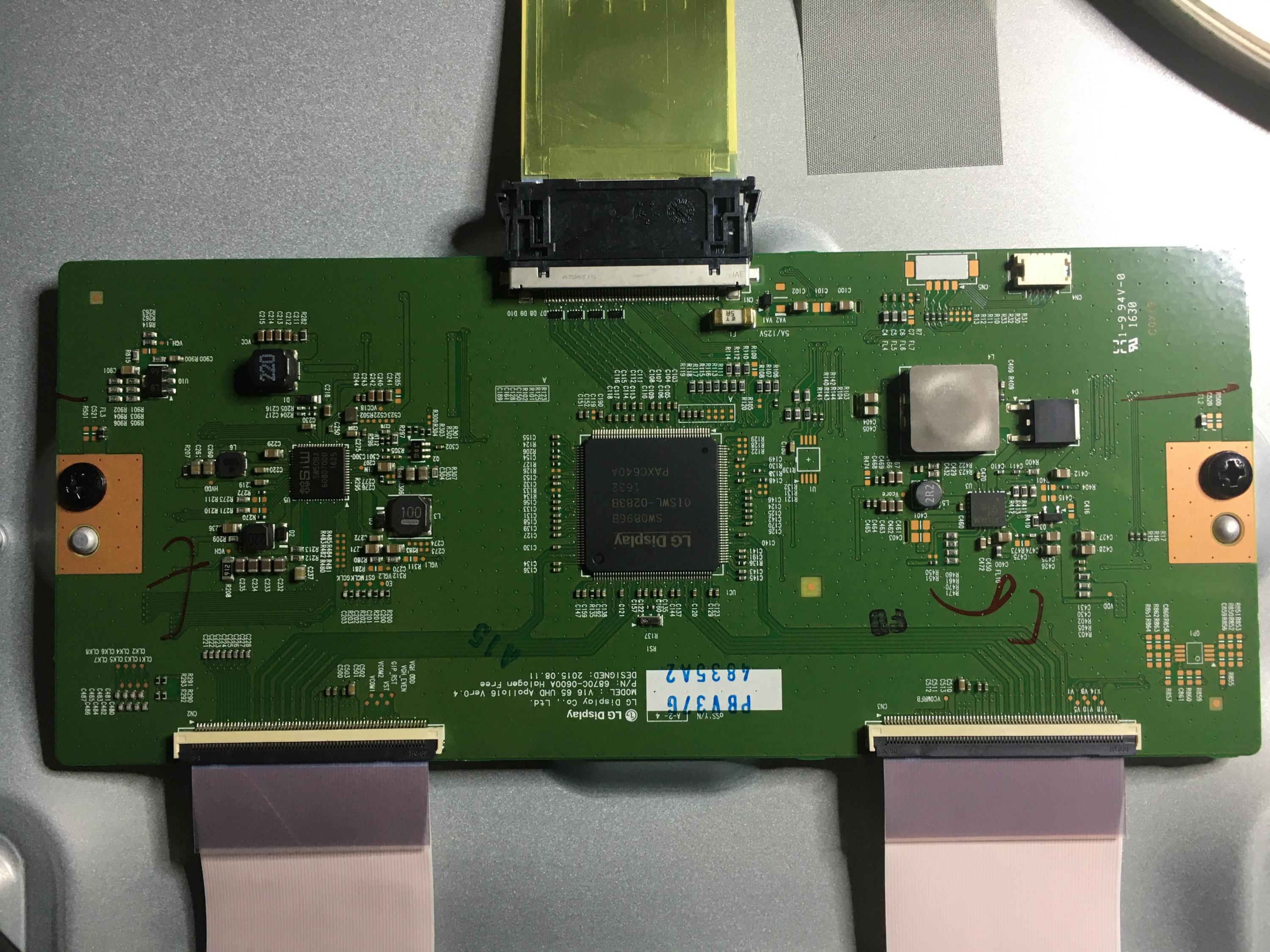

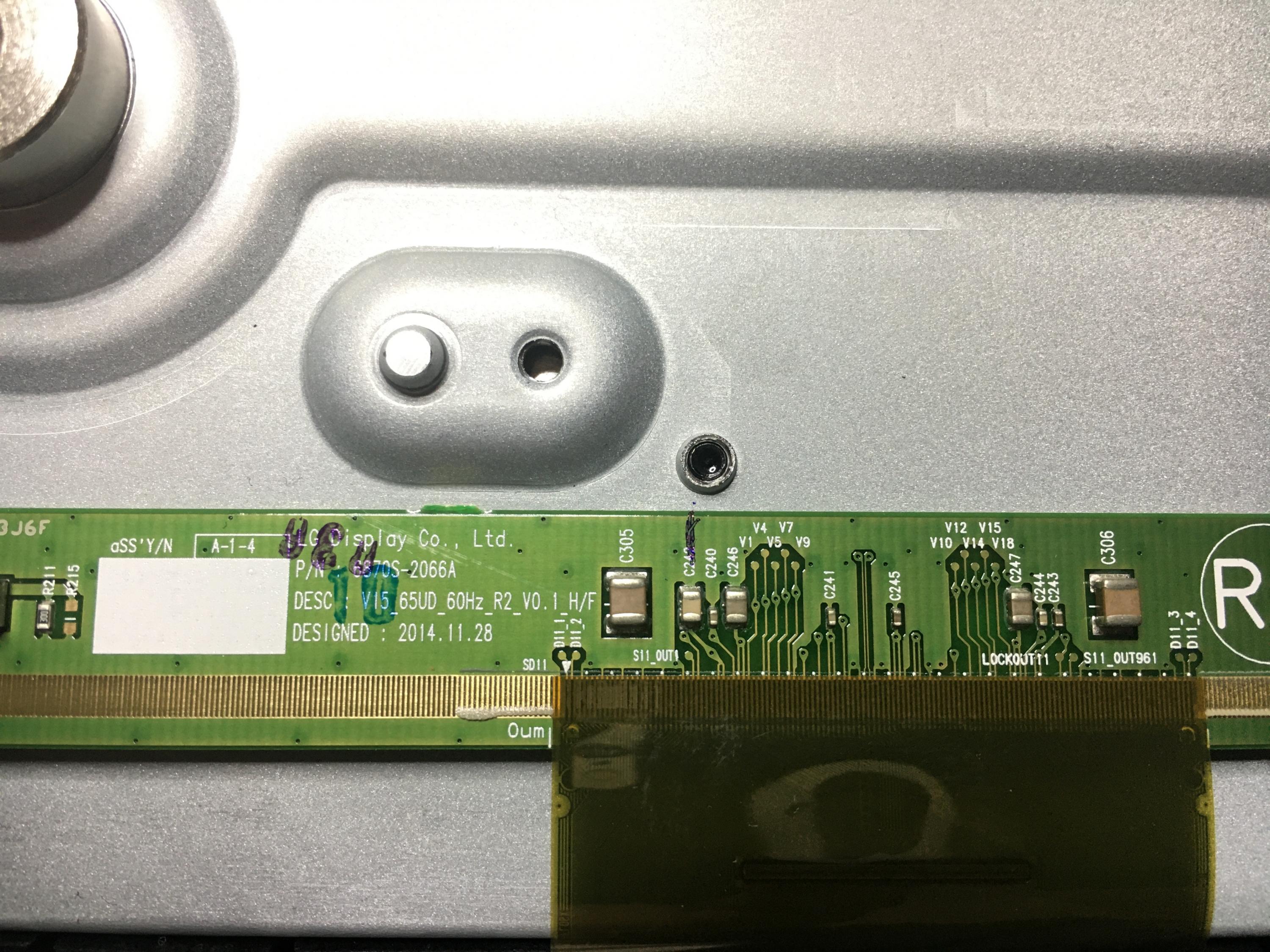

    65UH6030 Backlight No Picture has function
    I have a 65UH6030. There's no picture but the backlight turns on. T-Con has 13V. The first picture is the Panel Driver R2, I marked with a pen that was short, but when I removed the capacitor, the line is short which means the capacitor was good so I placed it back.

    Re: 65UH6030 Backlight No Picture has function
    did you try disconnect one ribbon cable at time.. to see if half screen turn on white.. also did you saw on the panel edge boards you have on each side U ribbon cable.. if you have then try the disconnection of ribbon start at one at time of those U ribbon cable.
      I did, the right side is WHITE, but the left side shows up no picture. I've already had the T-Con replaced.
