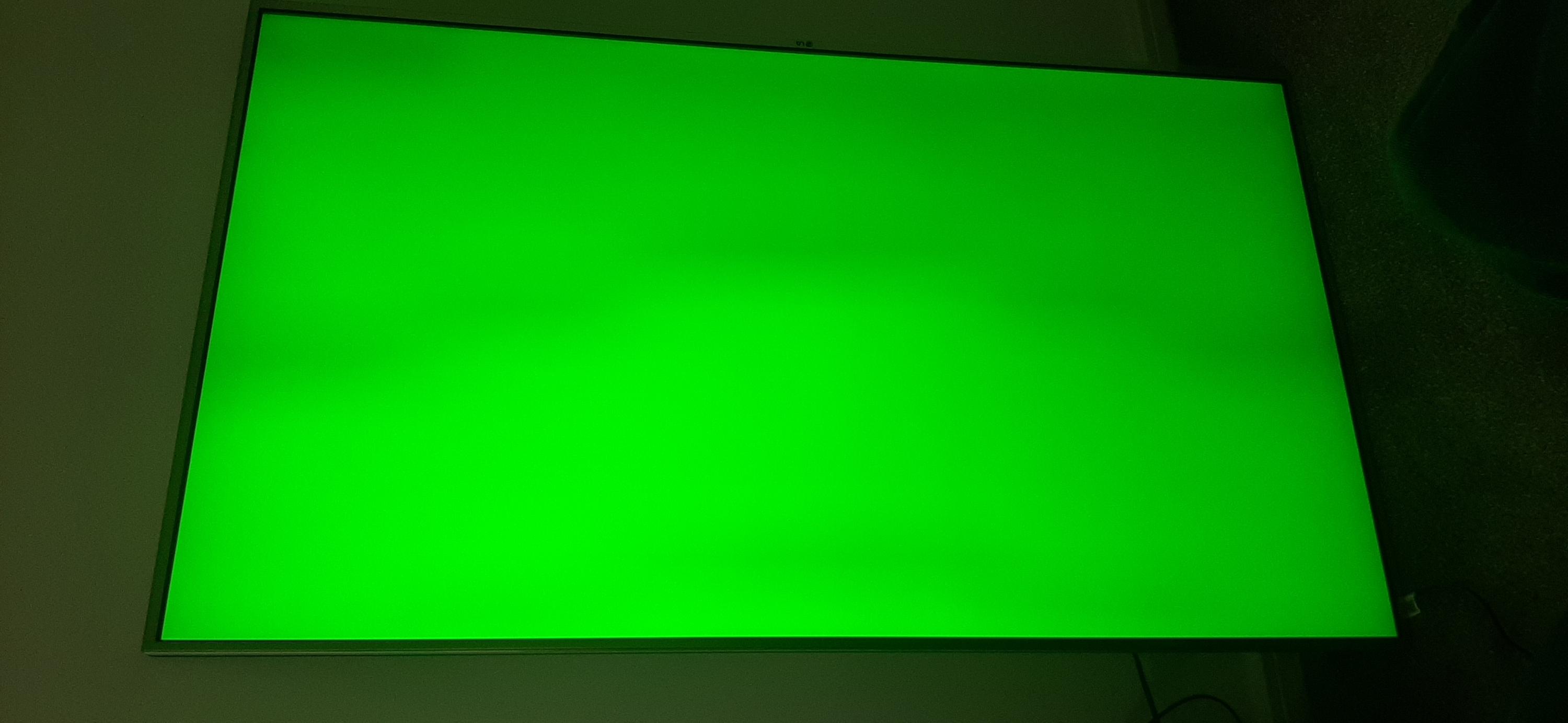

    LG 55uh770v screen just colour cycling
    Screen is just cycling though colours no picture just full red then green then blue etc

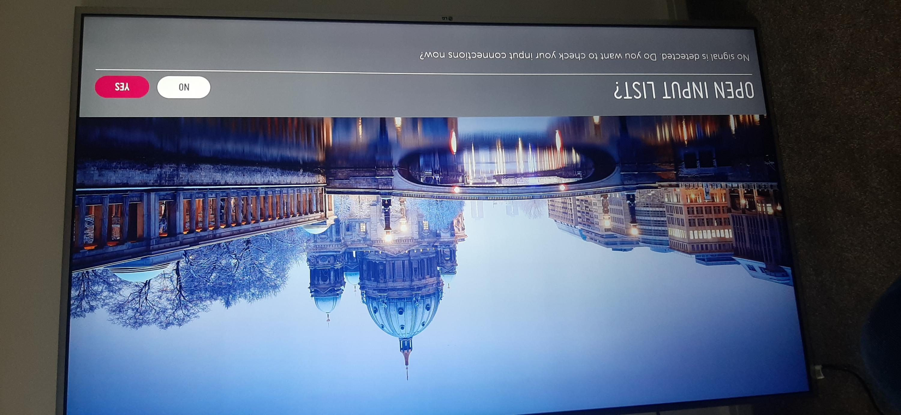

    Re: LG 55uh770v screen just colour cycling
    See attached
      Do a search through the forum for cycling. I'm sure it's something to do with the EEPROM. Have you tried to do a firmware update.
        I'll give it a go any idea how to get into the service menu on this I've tried a few. Going to try a full factory reset
          Do a web search and see what you can find.
          You can try these
          https://www.wikihow.com/Display-the-...Menu-in-LG-TVs
          https://factory-reset.com/wiki/LG_Service_Menu
