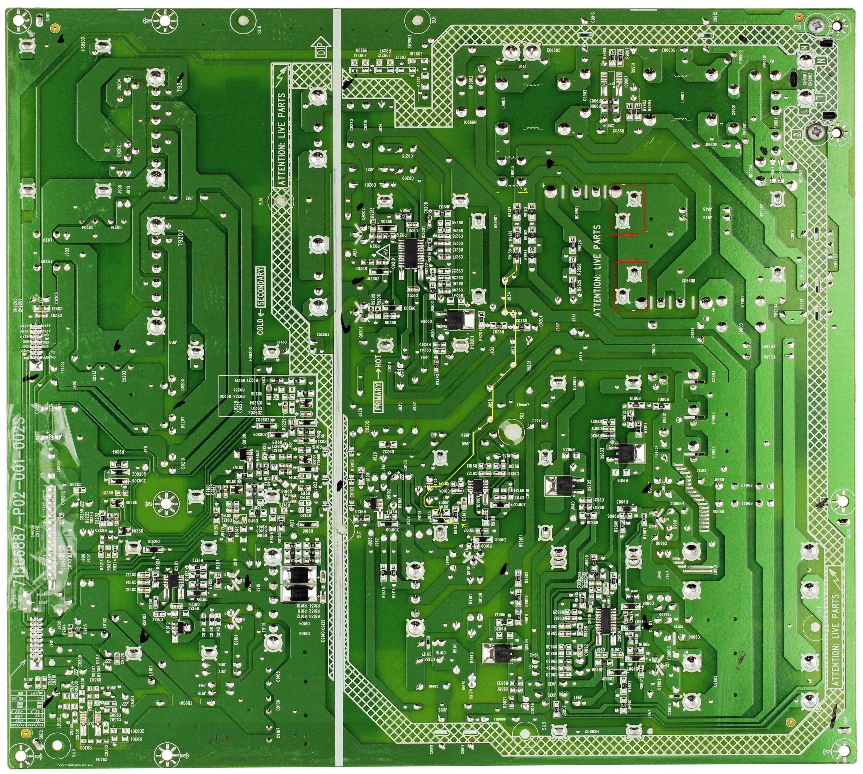

          Turn the board so you can read ATTENTION: LIVE PARTS and J958 is below LIVE PARTS. (Top View) I point it out because sometimes people can't locate the jumper wires.
          If you have 0 volts on J958, then check the voltage on R9137 (the end connected to L9903) You should read some dc voltage between Hot ground and R9137

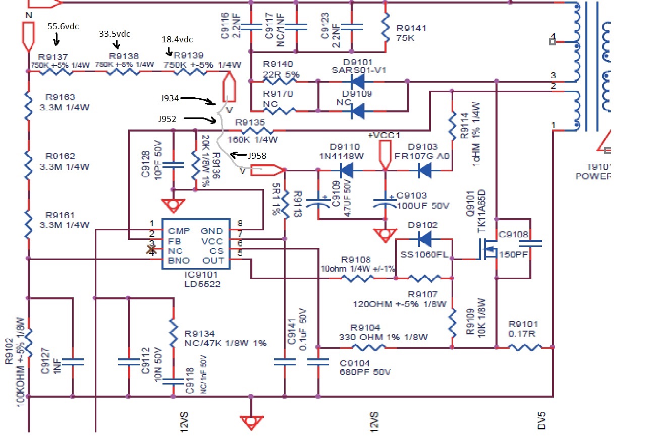

            R9137 = 55.6 DCV

              ok, check at the next resistor in the string, R9138, then R9139, this voltage should be around 15vdc at R9139, this is the vcc start voltage for the ic9101. The voltage should drop after each resistor

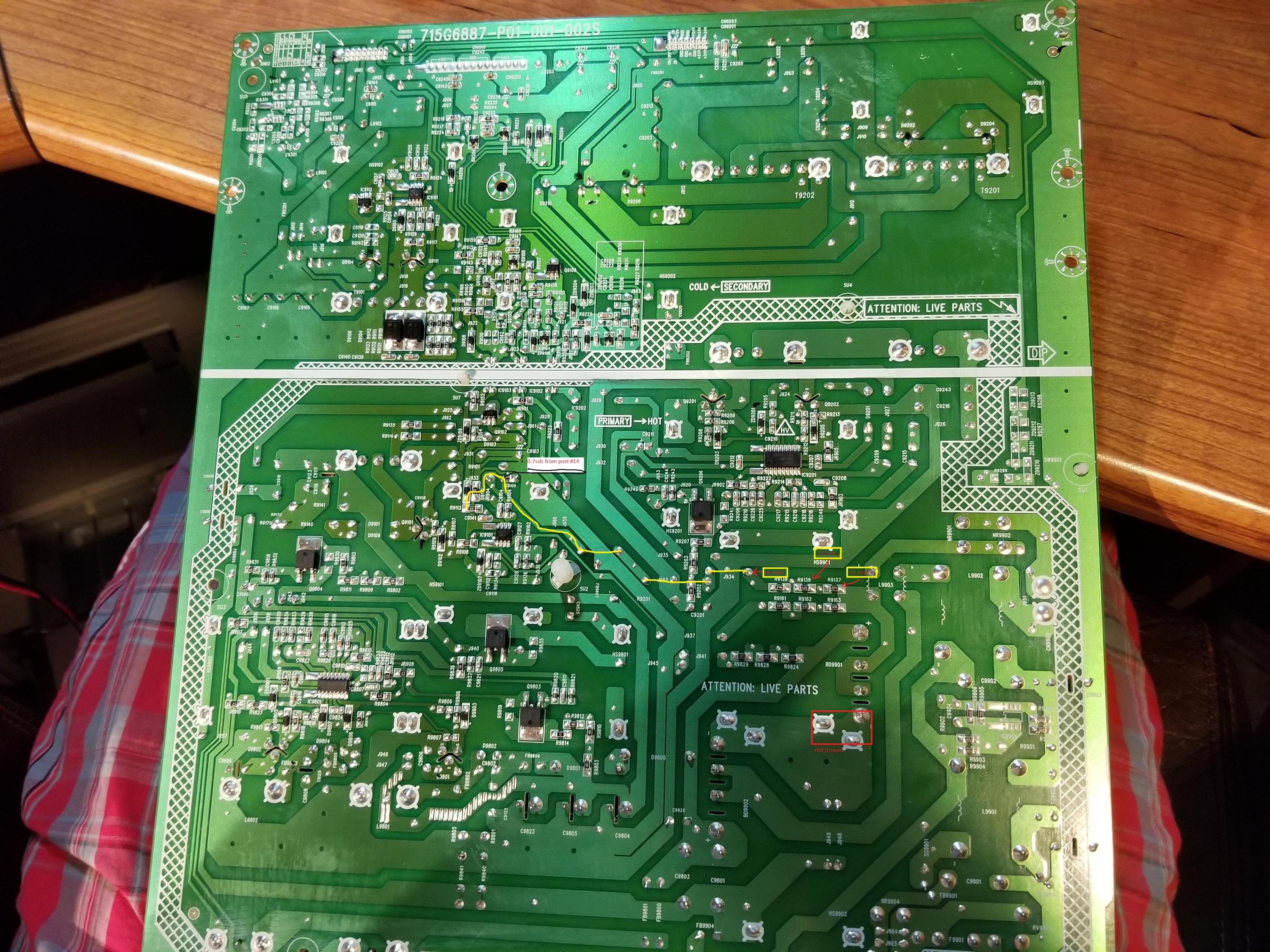

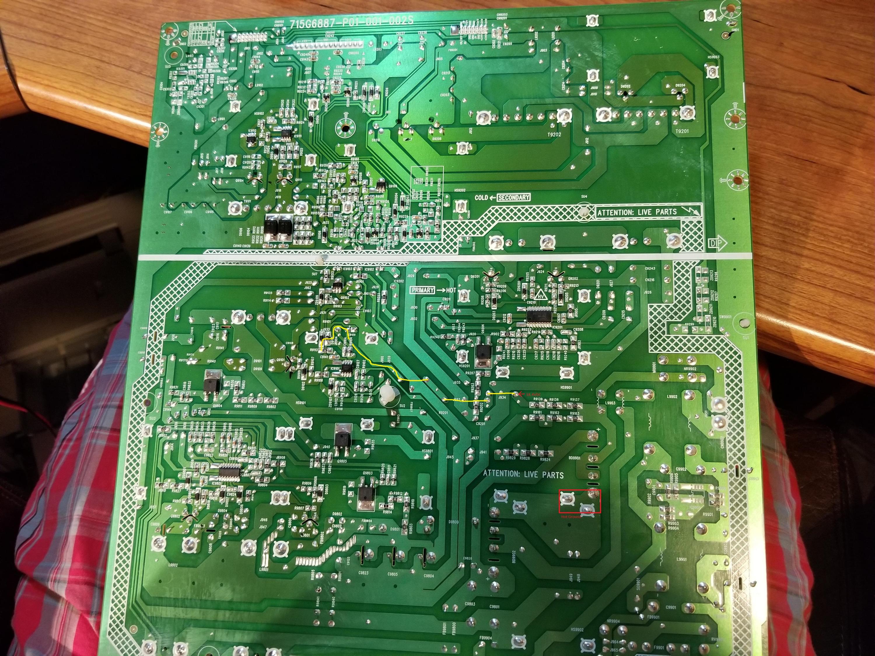

                That board looks a little different maybe.... I posted pics of mine in this thread... I could be wrong though. I did find a suitable ground & J958 anyway so I think we're good.

                  R9138 = 33.5
                  r9139 = 18.4

                    The board should be the same, If you have 18.4v on R9139, then you should have it on J934, J952, J958, C9109+ and R9113

                      j934 = 00.0
                      j952 = 164.1
                      j958 = 00.0
                      c9109 = 00.0
                      r9113 = 00.0
                      all measured with hs9901 as ground

                          Your meter probes can't be getting a good connection, there is no way you can have 164v on J952 and 0 on J934. Look at the board, J952 connects to J934 and J934 connects to R9139 which you said had 18.4v ???
                          Resolder all those jumper wires, maybe that's where the problem is.

                                I drew out the path on YOUR board, If you take a piece of wire and measure 0 volts on each end and 164 volts in the middle, where would that voltage come from? it can't be there so something was measured wrong. use your meter to check for a short circuit that's what it is for.

                                If you look back over the posts you give different voltages for the same point, I can't help if I get wrong information. You need to look at the schematic so you can understand the circuit.
                                Also if you measured the voltage correctly, you can see the voltage readings drop from one resistor to the next, this is correct and also indicates there is a current flow through the string of resistors. But you need to provide the voltage on each end of the resistor otherwise I don't know where the voltage was taken
