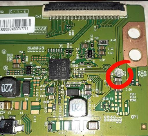

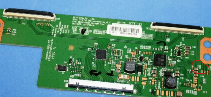

        Re: Toshiba 43L3753DB Screen Issues - FIXED!
        OK, so I got in touch with Toshiba UK, who, after a few weeks, sent me an email link for the Firmware to download.
        I installed the firmware, but the result was the same.
        I started looking at the T-Con board, inspired by a You Tube video, where the guy had isolated one of the clock signals that synchronises the timing for the pixels on the LCD.
        When I inspected the T-Con closely, there was some unusual damage to the PCB (see Old T-Con picture).
        I looked on an auction site, and found a visually identical T-Con (going by the label), which the seller had quoted as being from a 32" TV, with part number 43 6817L - 3806DJEBN9AZ069, and the part number label on mine was 43 6871L - 3806BGKBDDV7747 (from a 43" TV).
        I decided to take a chance for £0.99p delivered.
        Long story short, it works perfectly!!!!
        I would surmise that the part number that matters is actually 43 6871L , with the remaining letters and numbers being a serial number of the individual PCB. The part number that is silk printed in white, on both PCB's is 6870C-0532A and the design date is identical 2014/03/19.
        Hope this helps someone.
          Lucky, i would have bet panel.. the old tcon is fixable i think, search for a stand alone little power mosfet, that is maybe faulty.. maybe q1 or q2..

                            By the way, I've seen that kind of damage before. Somebody used too long of a screw/bolt securing the stand to the TV or the TV to the wall!

                              Sorry, i've understood now, the fault was the screw hole on pcb right? So there was no metal shield?

                                I don't know about his case, but I've seen them go right through the shield. It's one of the first things I look for because it's so easy to spot.
