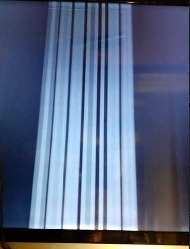

    I have a Toshiba 43L3753DB.
    When turned on, the Toshiba Logo is distorted and unreadable, but once the TV is booted, pressing the "Menu" button gives a visible menu, but if you try to select any menu, the screen becomes unreadable. The No signal message is readable and so is the info bar at the bottom of the screen, it just seems that as soon as there is a requirement to provide an image across the entire screen, it becomes unusable.

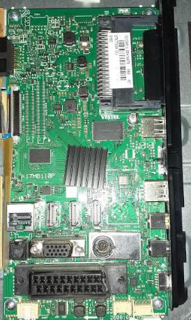

    Mainboard is 17MB110P.
    I have PSU and Main board from A Toshiba 32L3753DB. The PSU has a smaller transistor in the HOT section, so probably cannot be used even as a test. The Main board is set up for a 32" screen, so can this be set to work for a 43" screen by flashing the firmware?

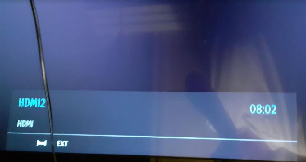

      Re: Toshiba 43L3753DB Screen Issue
      Dear Budm
      Here are the requested pictures:
      Splash Screen (Bad) This is what should be the TOSHIBA Splash screen at boot up

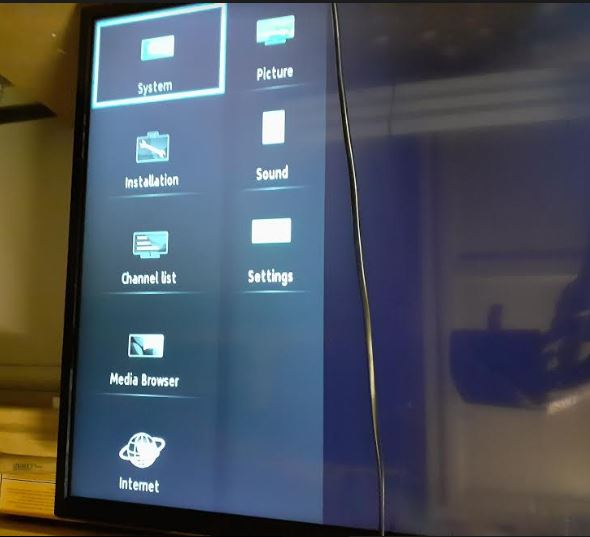

      Menu (good) this is the initial display of the menu, which is correct, but when you select a menu item, the display goes (bad) with just lines.

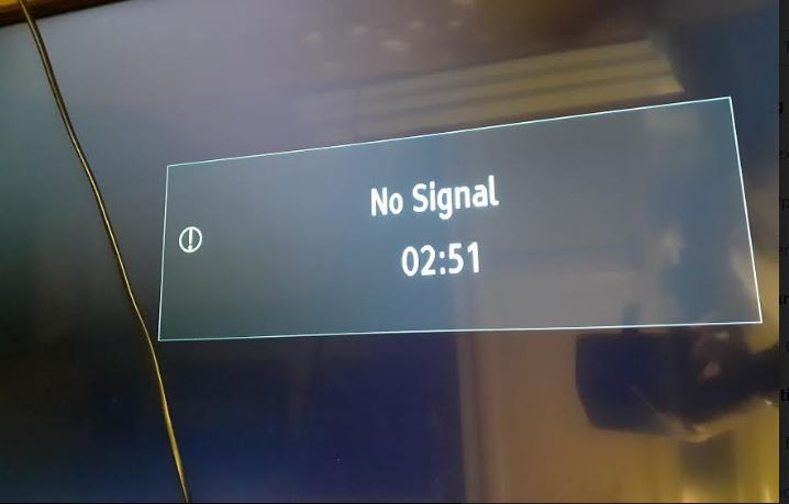

      The info bar displays "correctly", as does the "No signal" box.

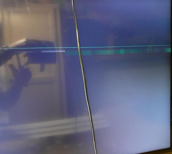

      When selecting "source", the display does not show the sources list, you just get lines.
      The PSU is squealing quietly, at all times (but I have a similar Polaroid TV that does the same, with no ill effects) but when the screen fault shows, the PSU starts ticking.

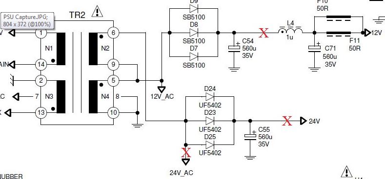

      Should the voltage at the Cathode of D23,24 & 25 be 37V? The schematics I have seen show it as 24V DC.

      • Diah
        • Feb 2013
        • 6397
        you can use the main boards from 32 screen... dont use the PSU its not fit with yours

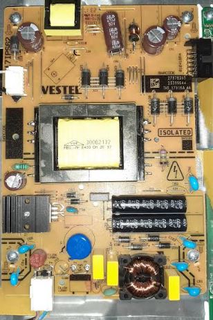

            • Russ17
              • Mar 2018
              • 125
              Hi Diah,
              I will try the Mainboard. Would it work if the serial number and screen size did not get modified in Service menu>
              I have attached a picture showing where I measured 37V, which according to the schematics, should be 24V.
              Thanks for the information.
              Regards
              Russ

                • Diah
                  • Feb 2013
                  • 6397
                  Originally posted by Russ17
                  Hi Diah,
                  Regards
                  Russ
                  you need to measure DC + & - direct on the 470uf 50V cap. this is for back light.. so the 12V feed the main boards are correct you can try yours main boards..

                    I measured the voltages with respect to the metal chassis of the TV, which is effectively connected to 0V on the PCB (and - of C55), via the screws which secure the PSU to the chassis (I always measure voltage on the isolated side of the PSU like this).
                    Using this method, the 12V is correct, so I will need to establish why the 24V is so high.
                    I guess if one of the three diodes (D23/24/25) is faulty, it could cause an increased voltage.
                        Please provide Hi-res pictures of the whole top and bottom side of the power supply board, right now I cannot read any prints on the board.
                        BTW, what the P/N of the power supply PCB? 17IP???
                        Also upload the schematic you are using, one thing about VESTEL schematic for the power supply board, the Voltages and the component value will not match your PCBA, the schematic is the Master schematic for making Blank PCB, then the PCB will be stuffed to make many PCBA's for the needed TV model that may require difference Voltages than what being shown on the schematic, you can see that not all components are installed on your PCBA. Look at the filter cap connected to the Cathode of the D23/24/25, is that cap rated at 560uF 35VDC?
                        Also: https://www.badcaps.net/forum/attach...9&d=1605896639
                        You have bad screen if those lines stay like that and not change. Do they?
                          OK, I now see the PCB is 17IPS62 and the PCBA is 27878395.

                              At this point I will not worry about the 37V power supply, the 37V is the feeding Voltage to the Boost converter circuit to drive the LED strings which are working at this point. That is strange white vertical block shown in your picture. Lines like that usually due to bad panel (https://www.badcaps.net/forum/attach...9&d=1605896639).
                                if bad panel . the displaying picture will remain bad over any kind of signal. its Main boards / Firmware (MFC issue)

                                        BTW: can you write yours Main boards label over here 17MB...?
                                        Okay yours 17MB110P
