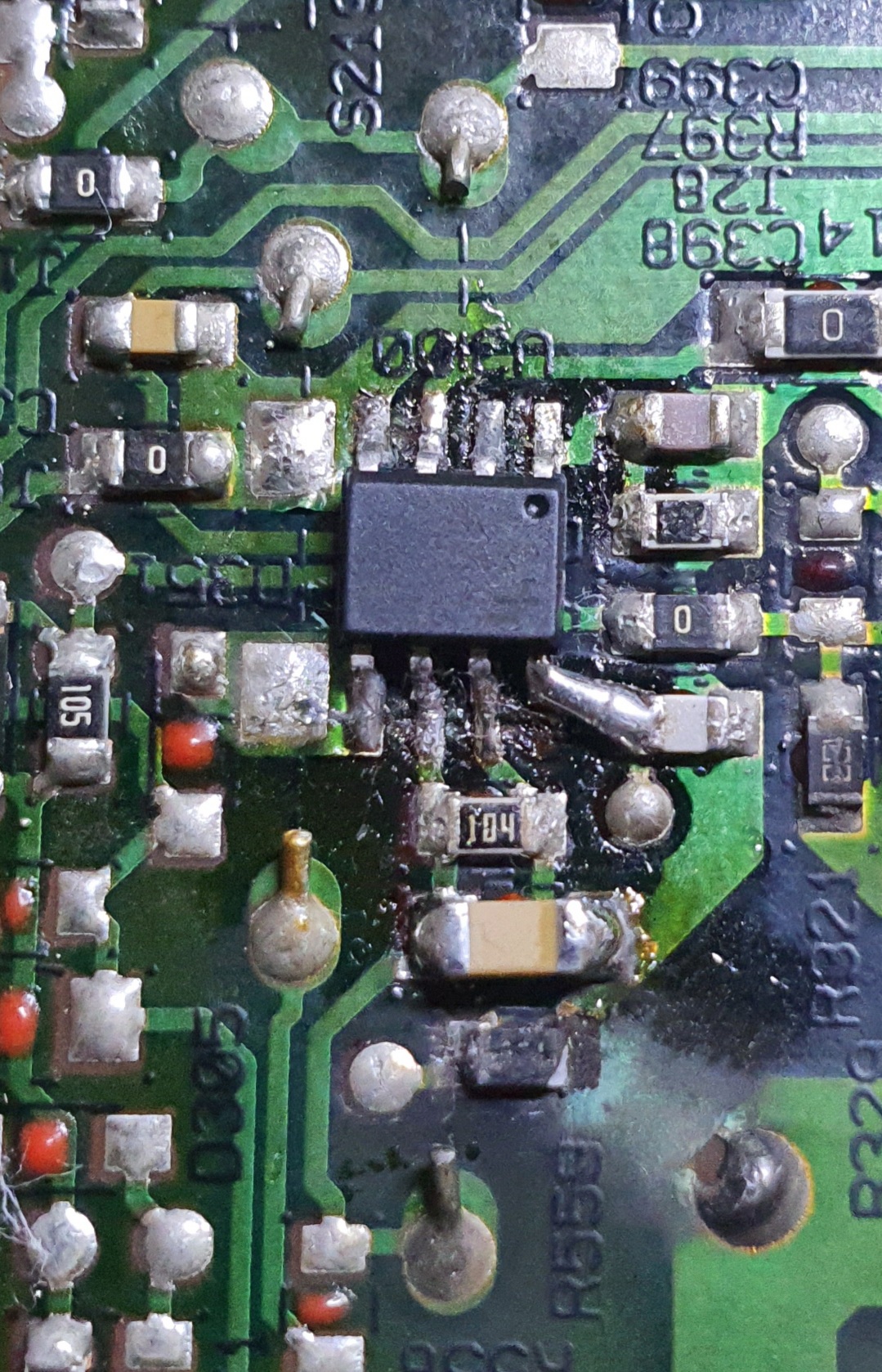

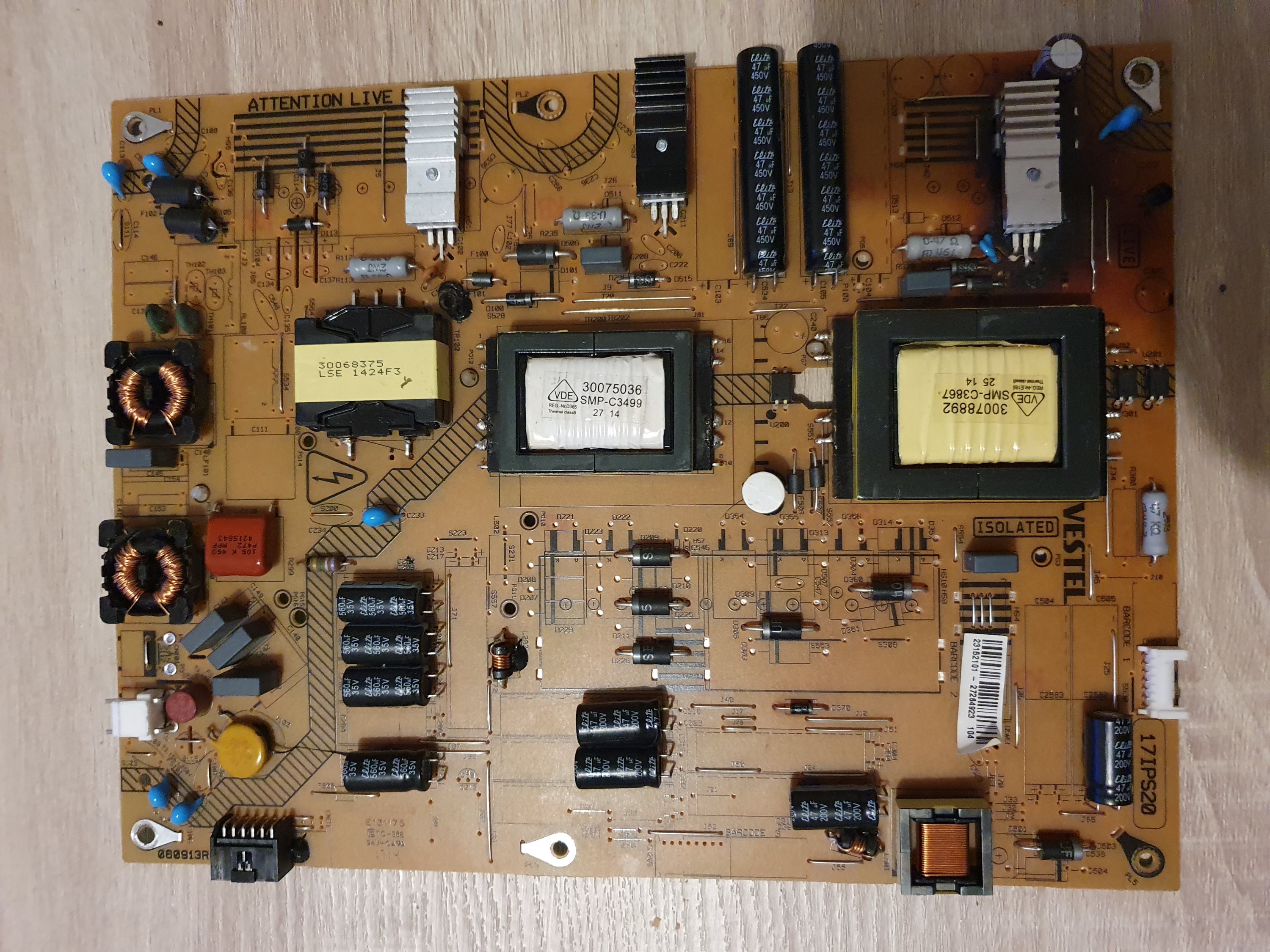

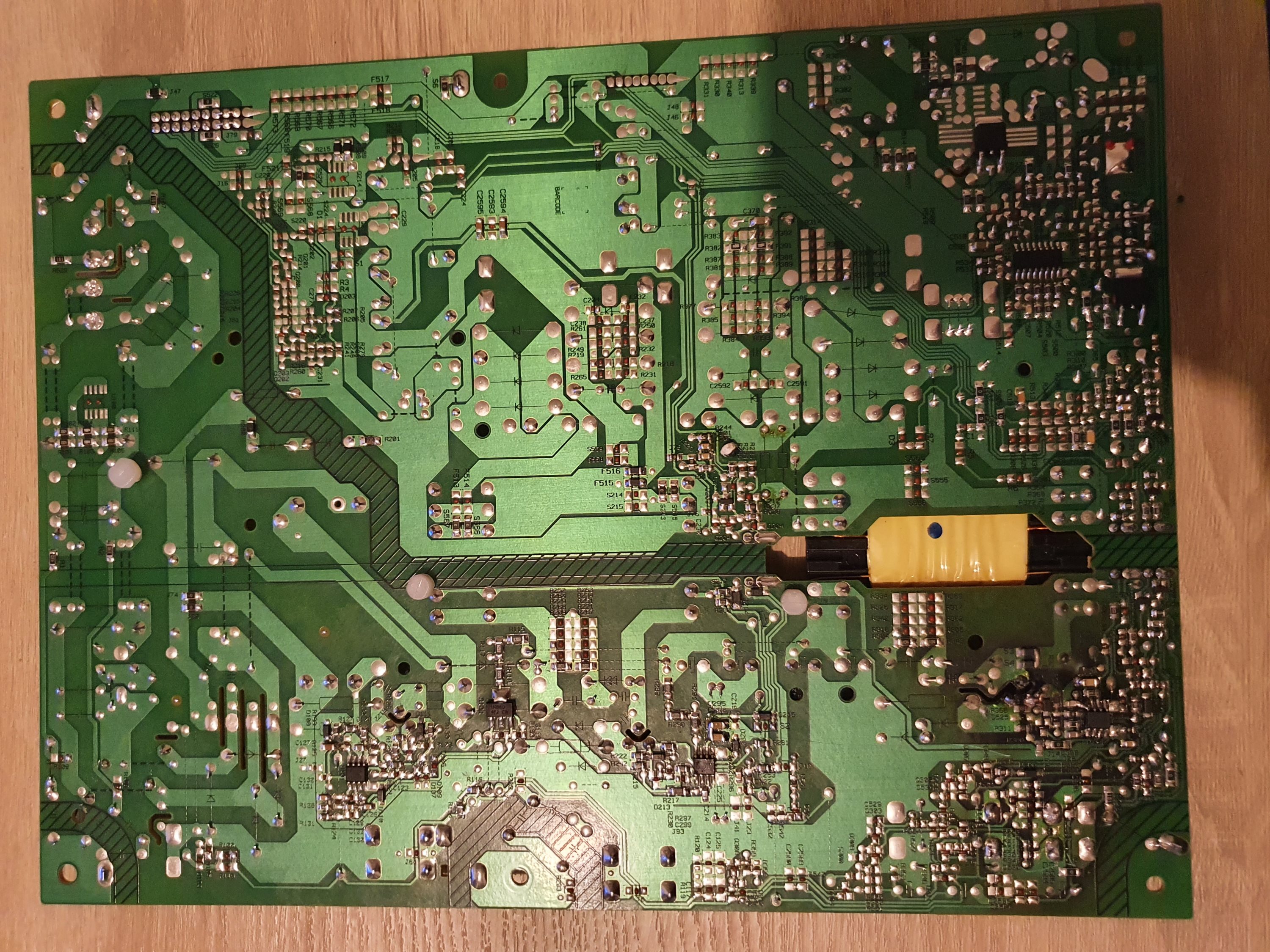

    My Vestel television has stopped working.
    After first diagnosys, the power board 17IPS20 R6 don't work (no 12V on output).
    I have replaced :
    • U300 FAN6300 -> completely blown up
    • Q301 MOSFET FQPF8N60C
    • C387 1uF Capacitor -> shorted
    • C295 & C296 1uF capacitor -> to be sure
    But with my multimeter, there is conductivity between VCC and GND on U300 and U202. I don't know why. Maybe a diode but i can't test these because of the short.
    Can you help me to find the cause of the shortage ? have you any ideas ?
    I attach schema of the board + pictures
    Thanks for help

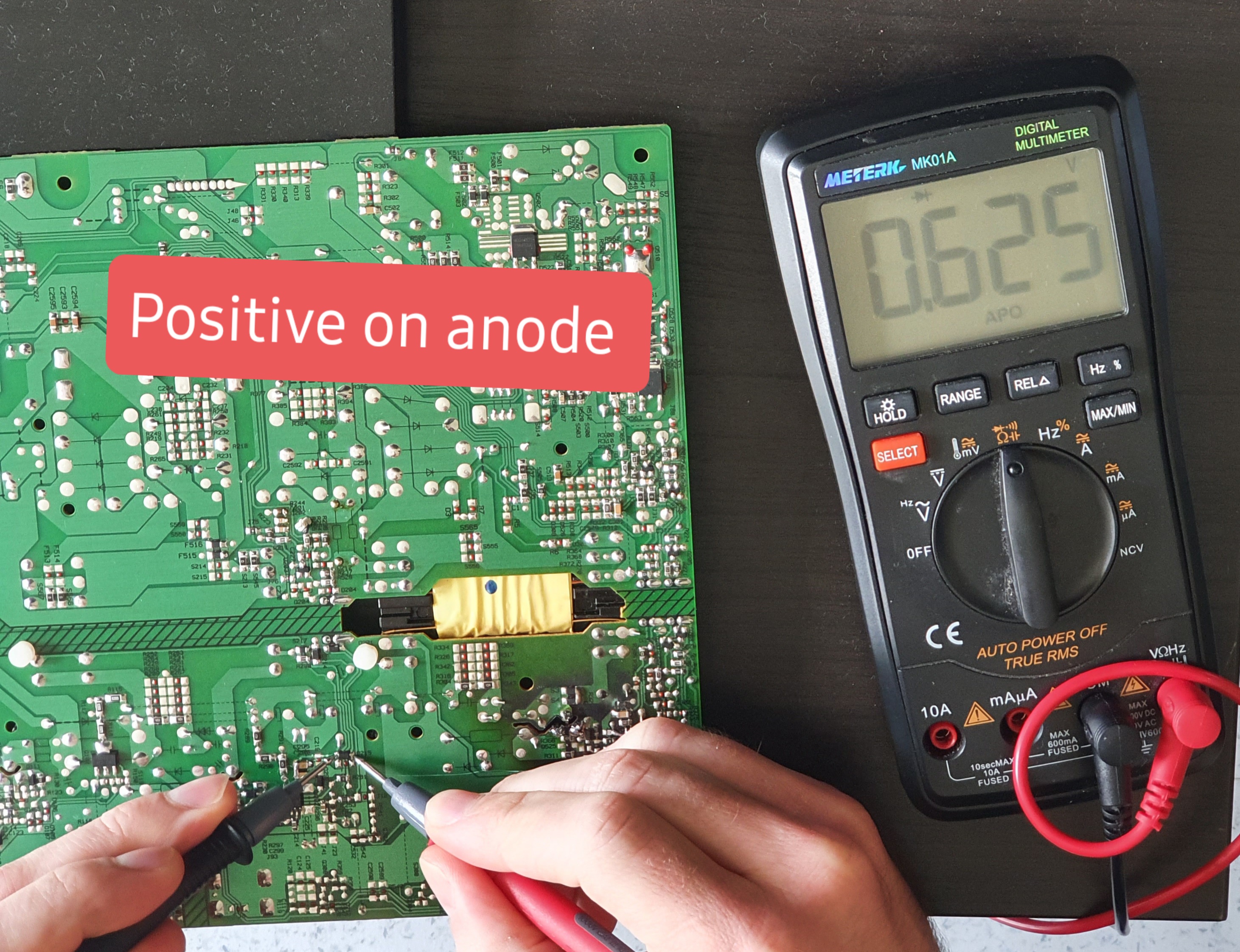

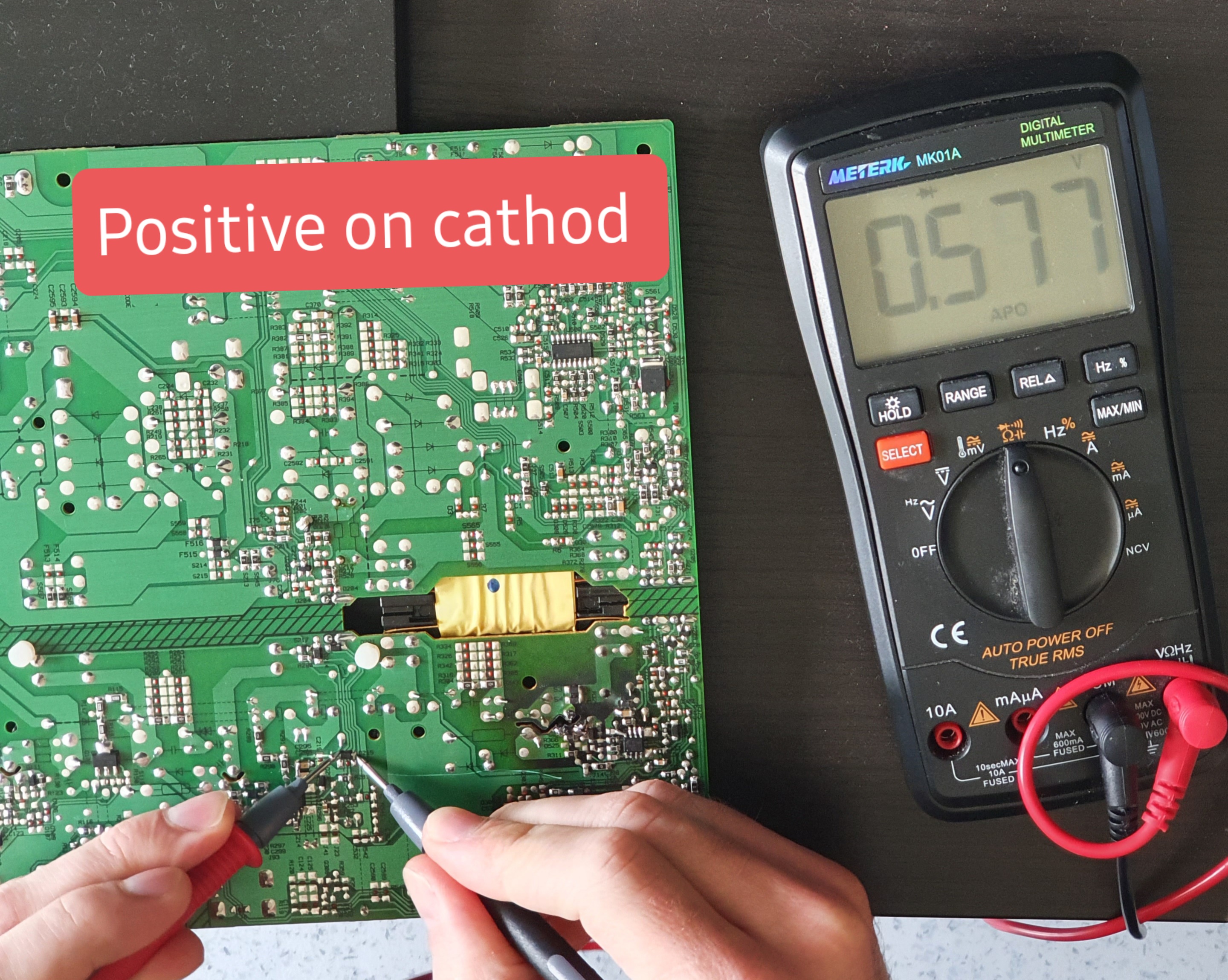

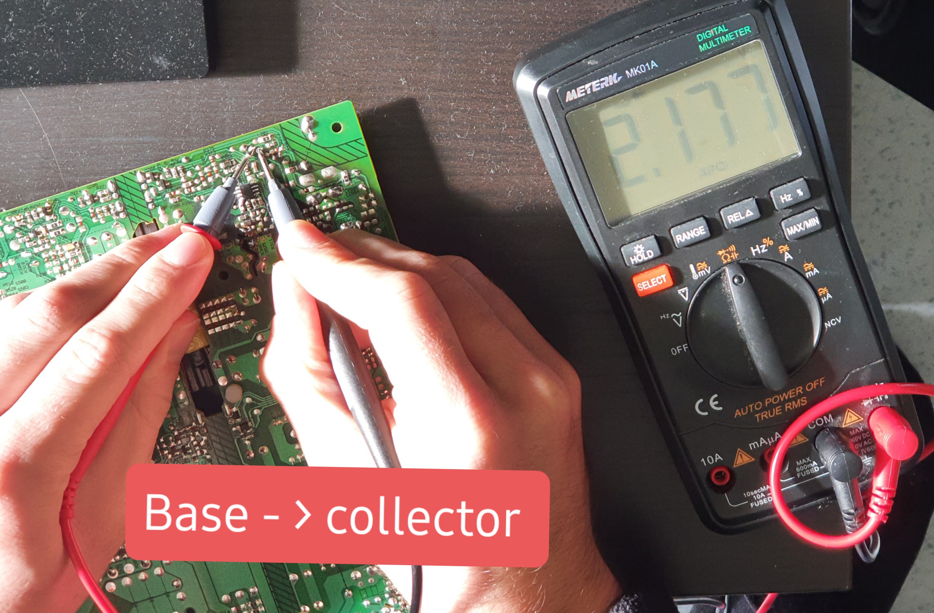

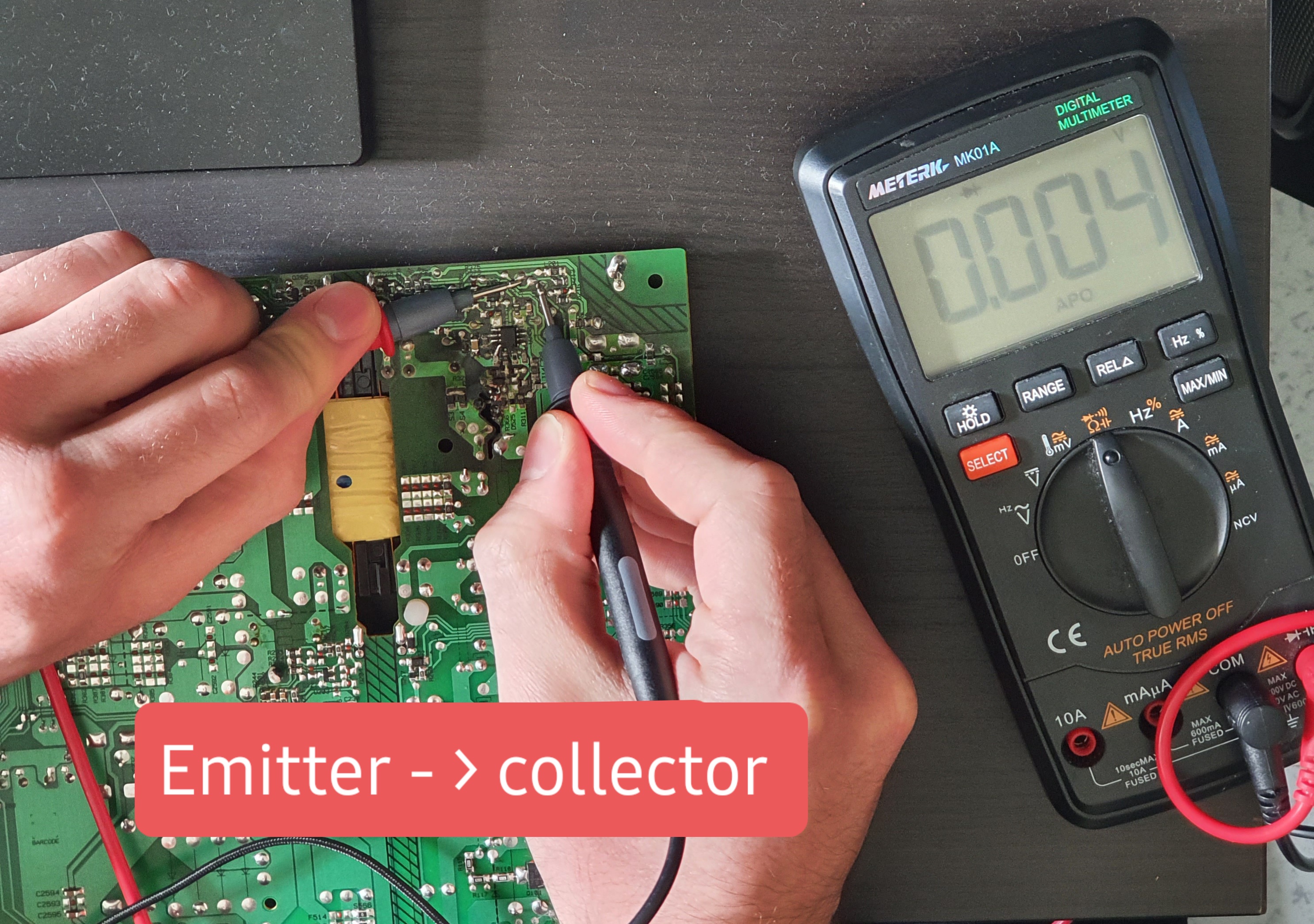

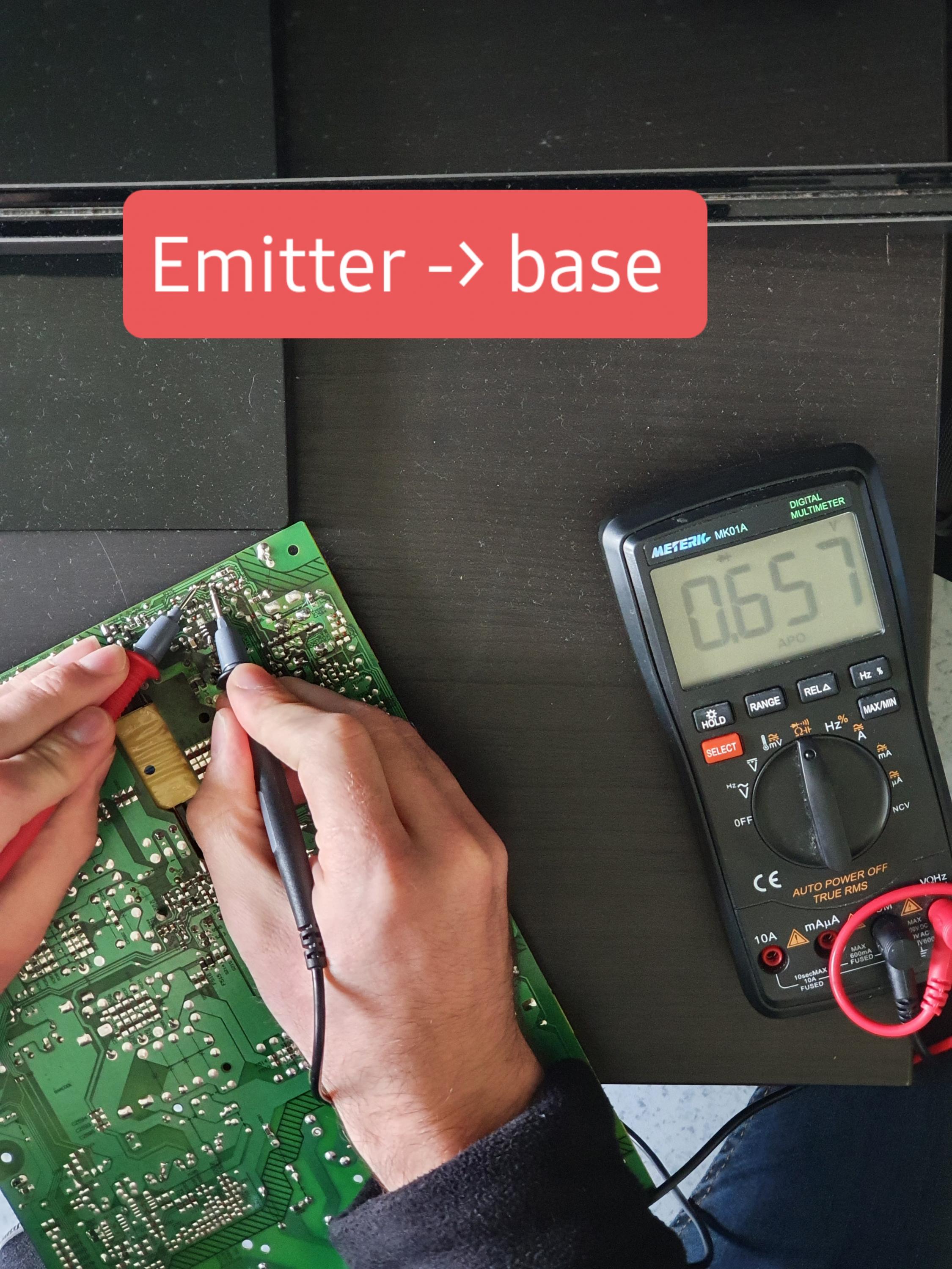

          Re: Bad Vestel 17IPS20 : shortage, need help
          Can you check D214, D215 and Q216
          • worlor
            • Oct 2020
            • 28
            • France

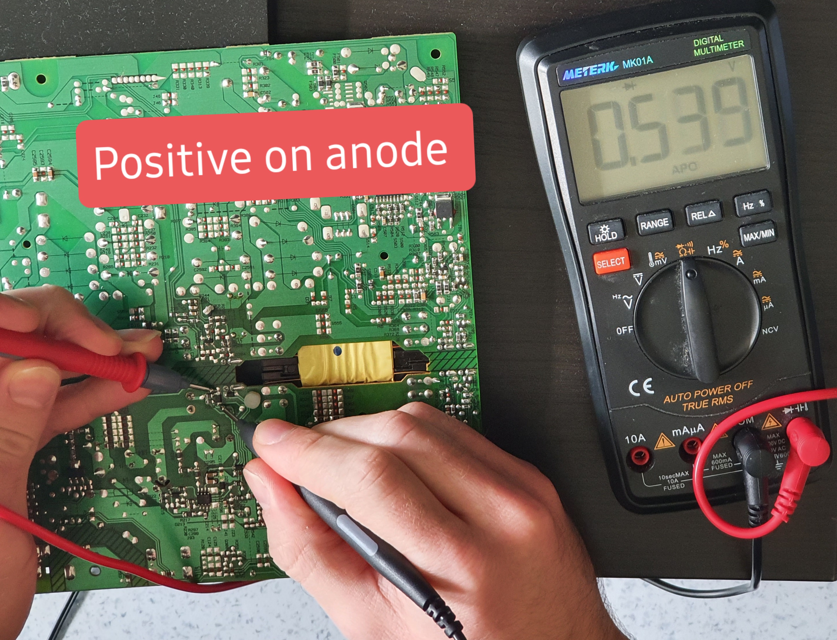

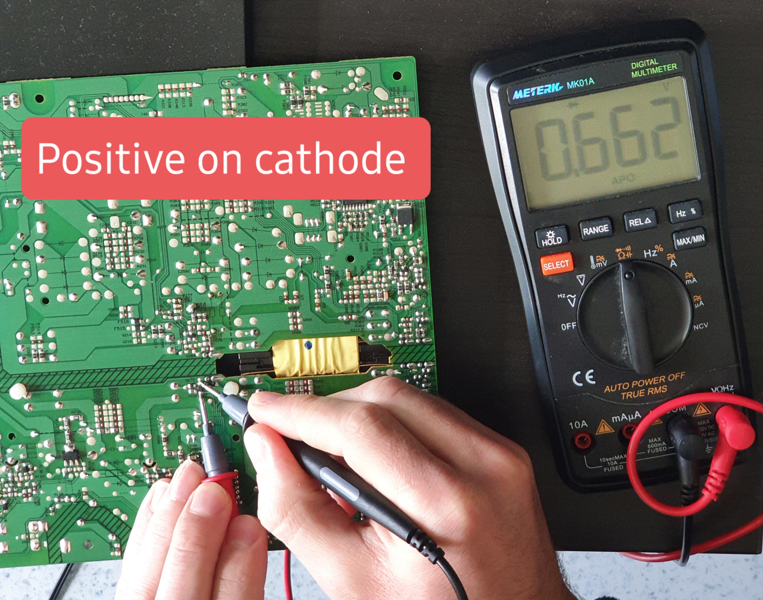

            Sure, the mesure shows that diodes are passing in both way but is this behavior can be caused by the short ?
            Thanks for help
            • dick_barton
              • Aug 2015
              • 6643
              • Wales

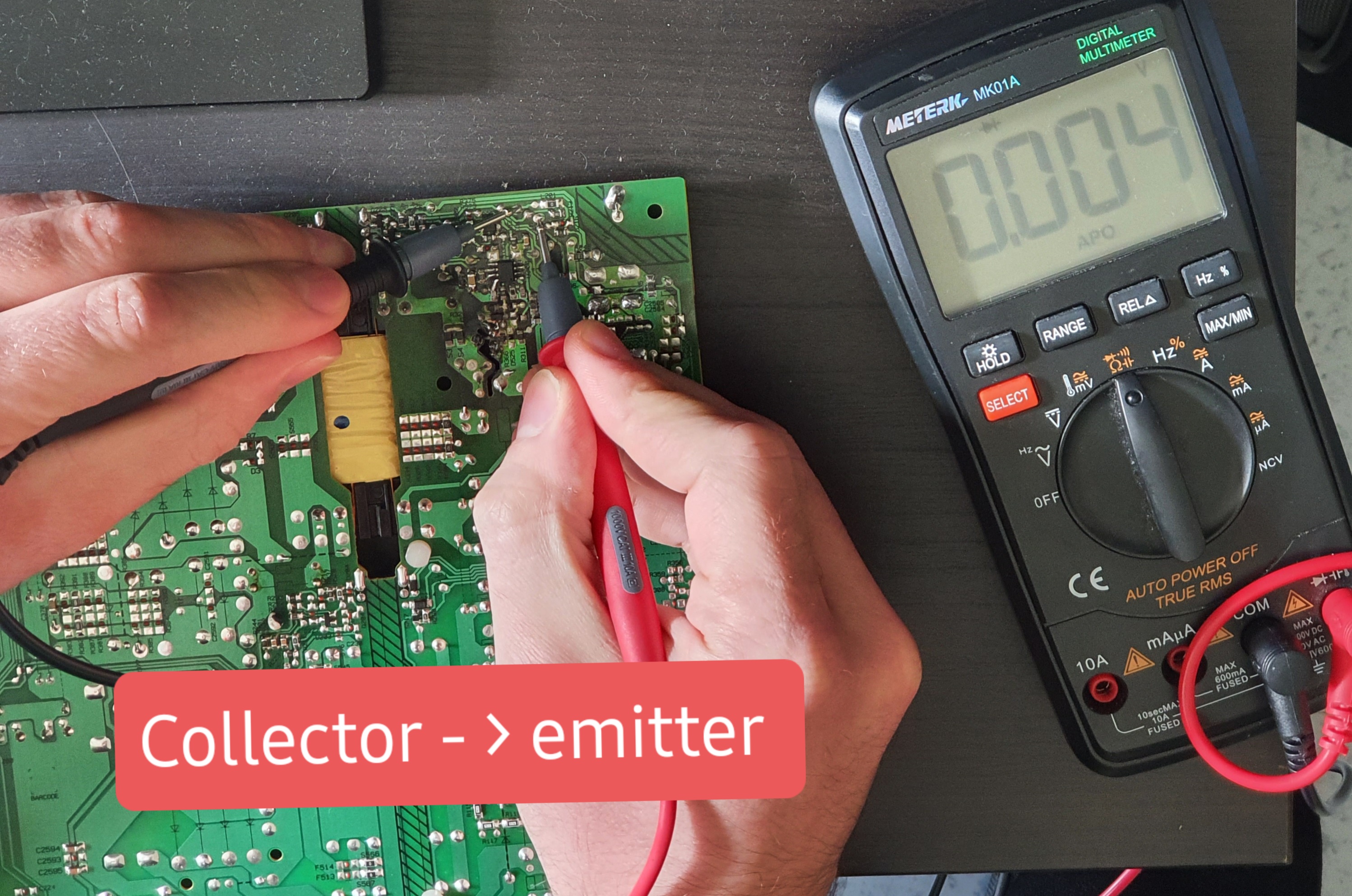

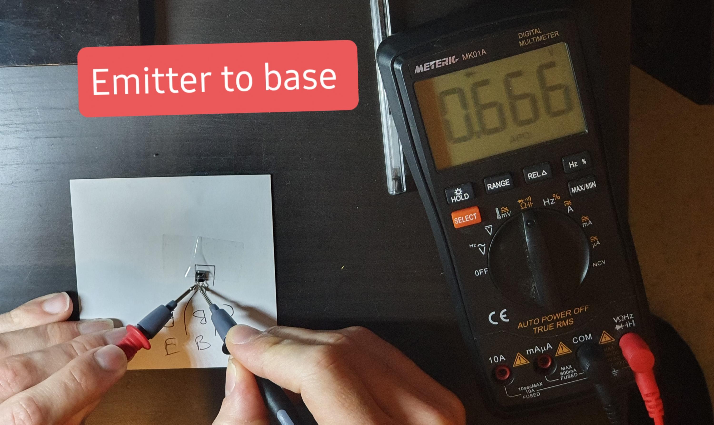

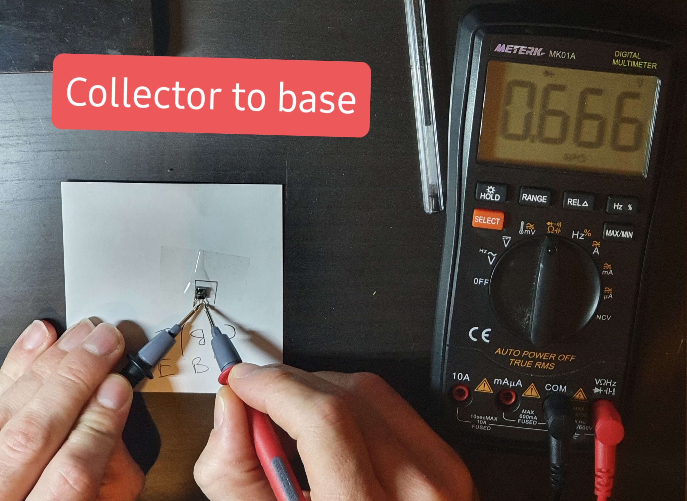

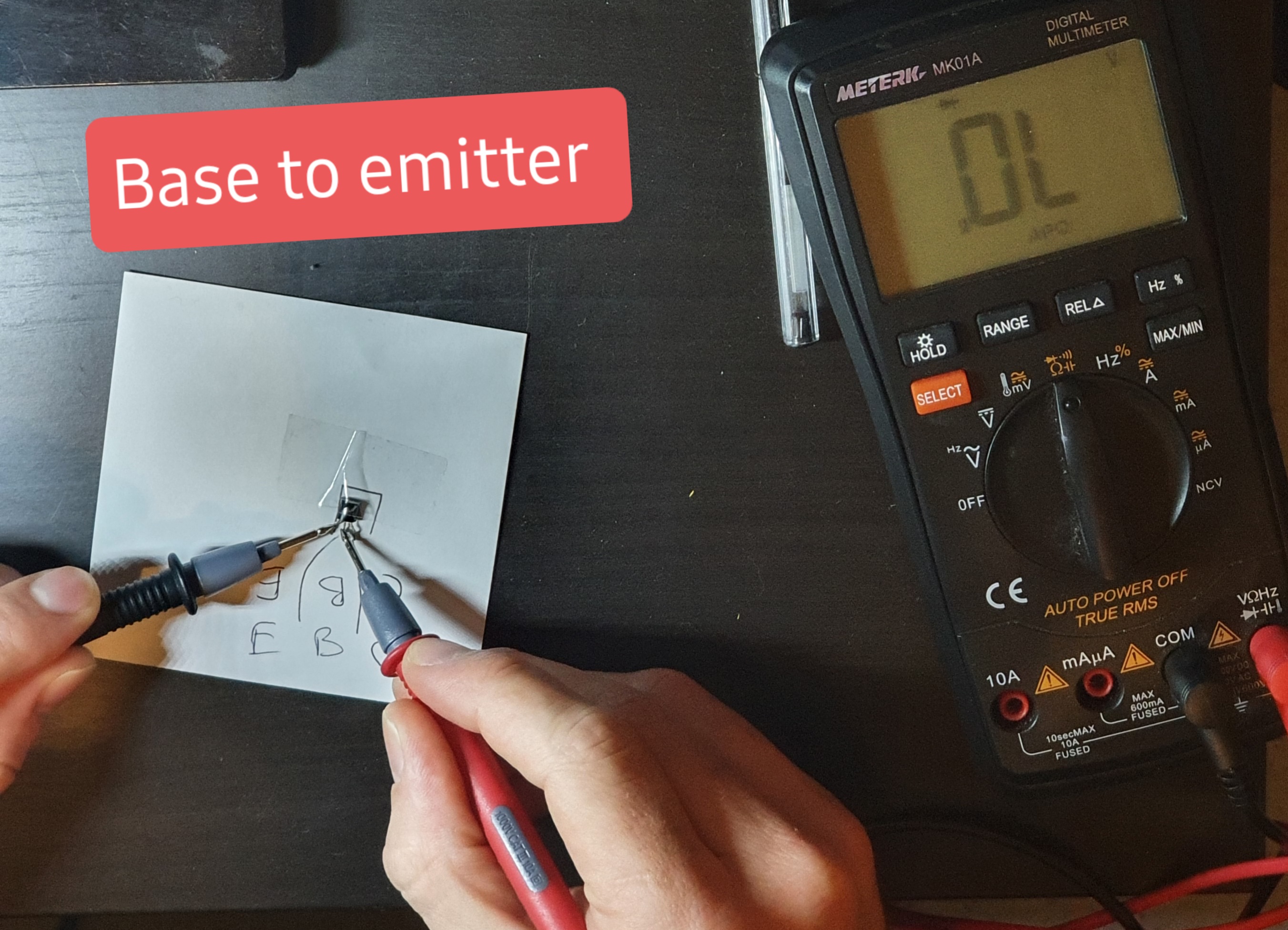

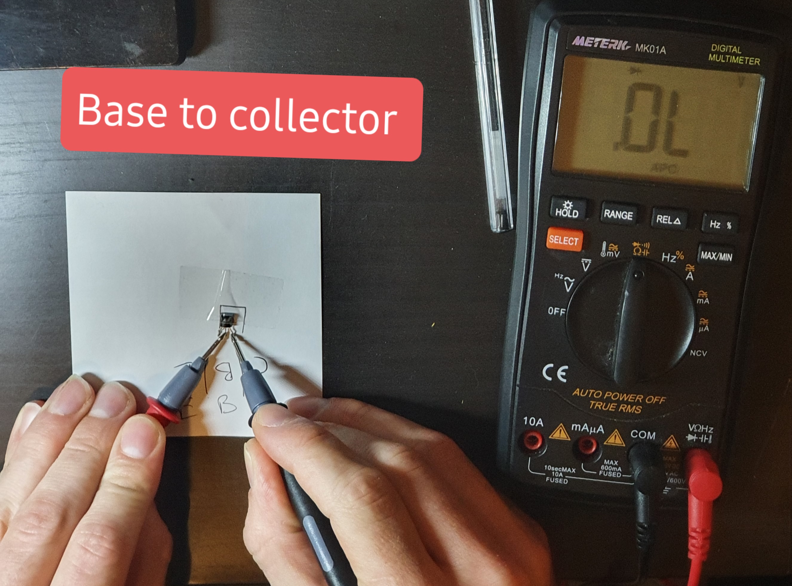

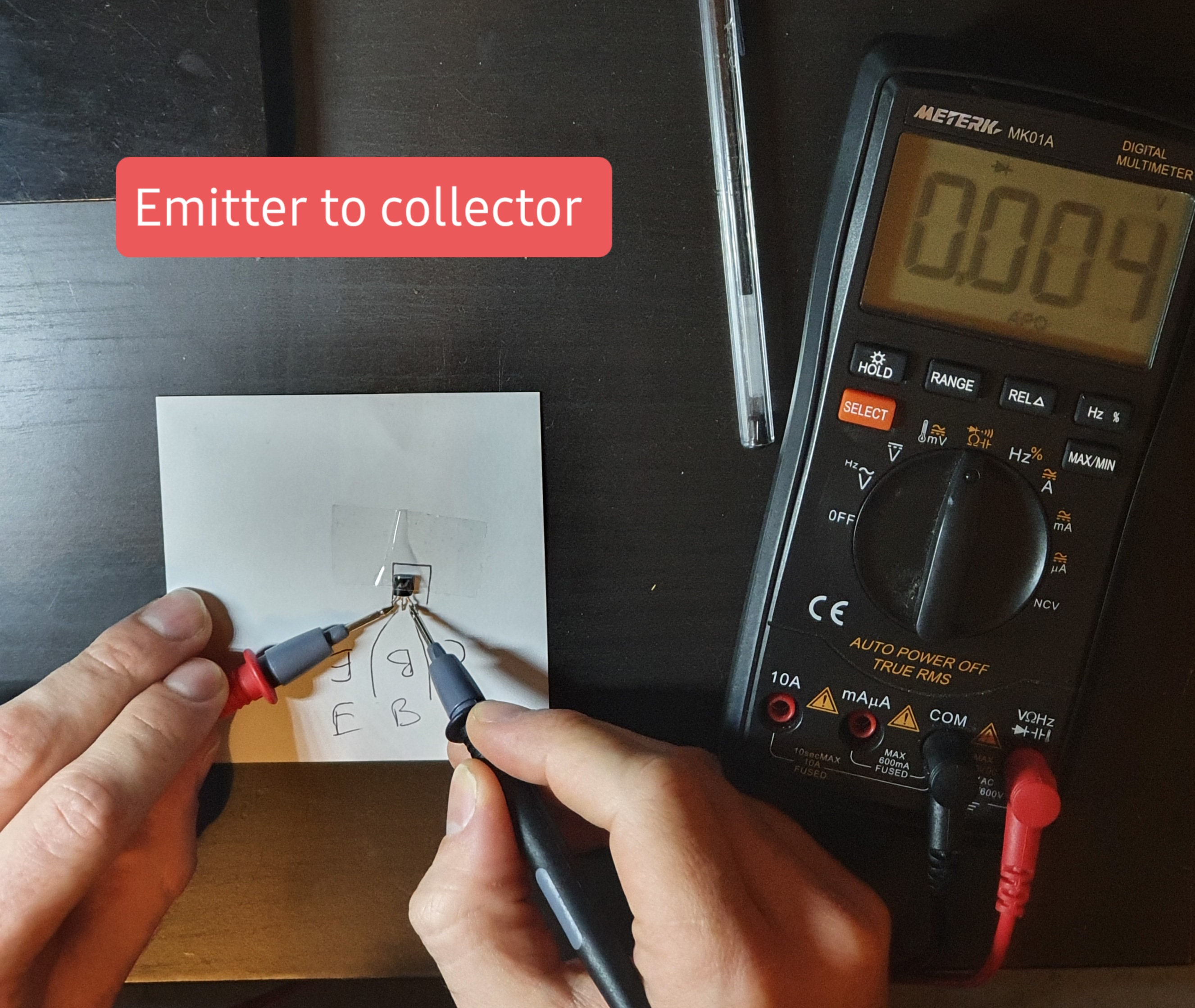

              Emitter / collector appears to be short circuited. You would need to lift the transistor to confirm there is no short circuit across the emitter /collector circuit pads.
              • worlor
                • Oct 2020
                • 28
                • France

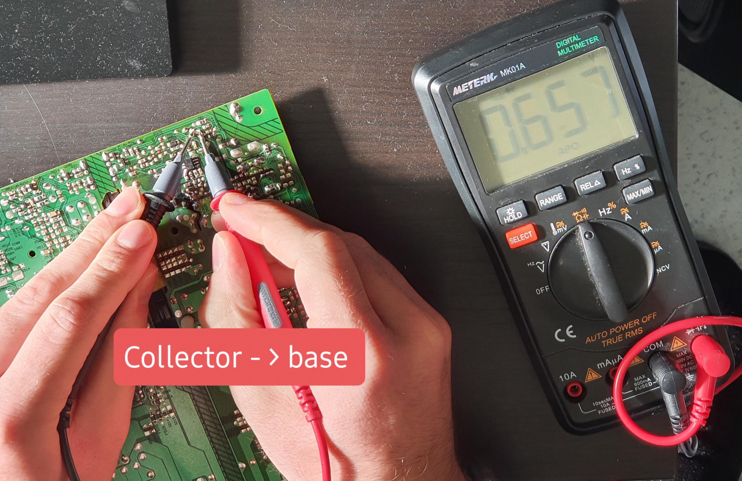

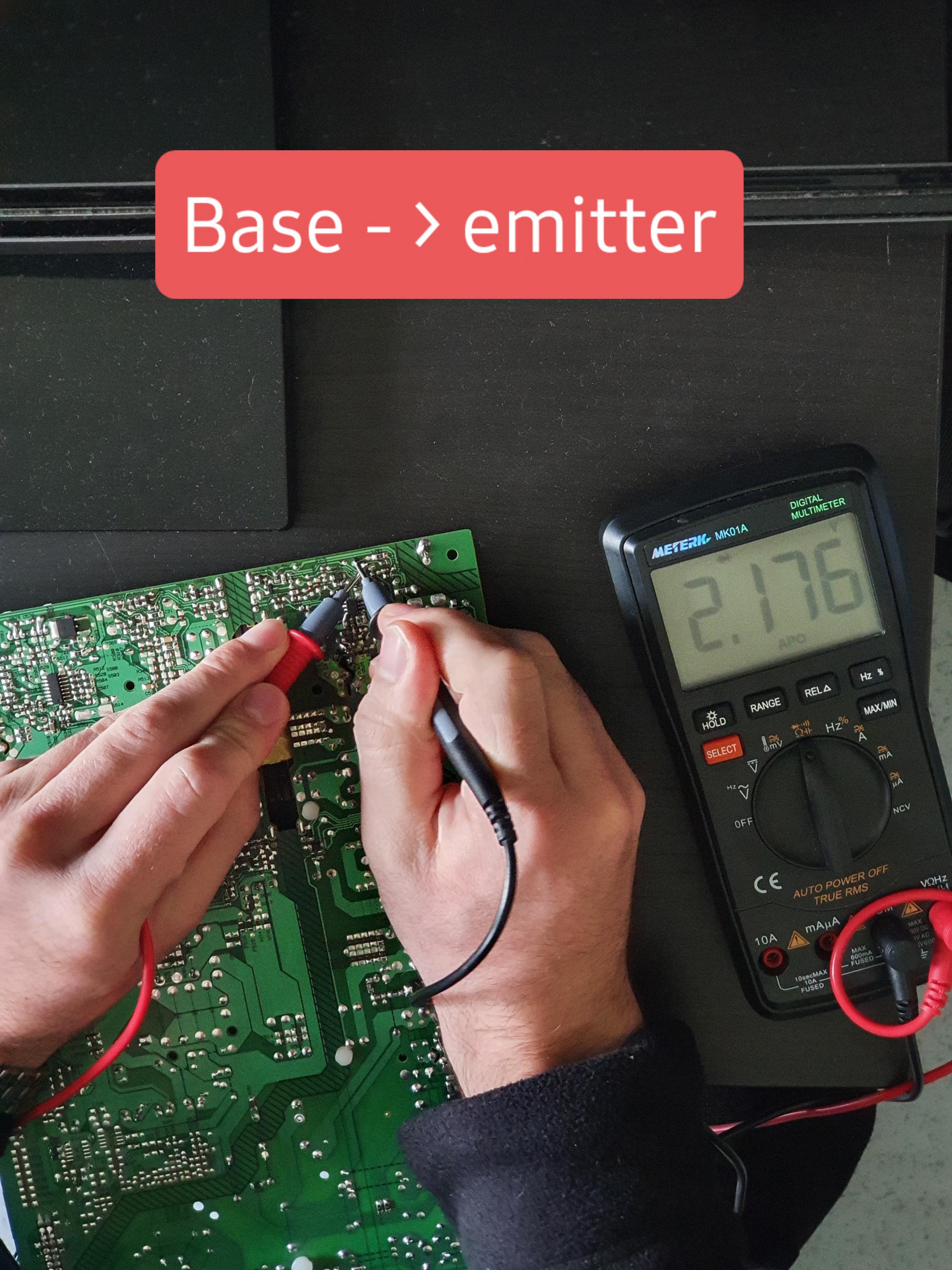

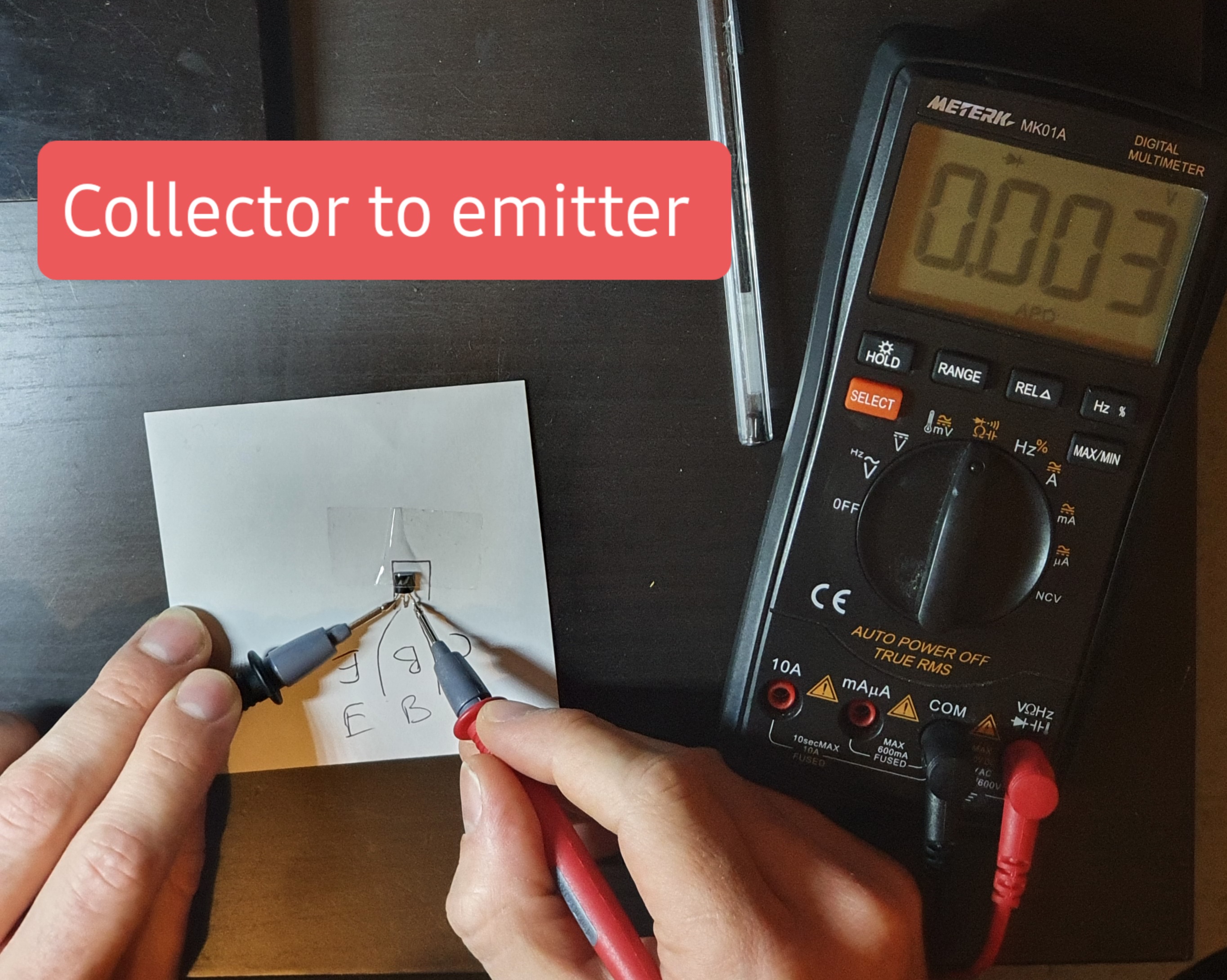

                Ok after desolding and test, it seems the transistor is OK
                see pictures
                      Originally posted by worlor
                      Ah okay, thanks for the explanations !
                      Do you have any clues on why my card don't work ?
                      I need to look at the pictures of your board and the schematic first before I can give you the test points to test.
                      Also look at the results of your post #8 again.
                        see pictures
                        Since when should a transistor have a short circuit between the emitter and collector??? I don't understand how you could think its ok!
                        I would suggest you read up on how to test transistors as your diagnosis is floored with regards to the transistor.
                        • dick_barton
                          • Aug 2015
                          • 6643
                          • Wales
                          see pictures
                          Emitter / Collector is short circuited.
                            If Q301 was shorted, it should have opened R320 (which is usually a low ohm resistor) if R320 did open, it supplied full PFC voltage to U300 via R311 (likely open now as well) which blew up u300. If the shorted transistor is Q216, this would have shorted due to a short on the VCC line, so U202 could also be bad.
                              Thanks for help, I have ordered a new BC327 for replacement.
                              I have re-checked D214 and D215 whitout the transistor and they are OK (OL in blocking, 0.5V in passing for D214, 0.6V for D215)
                              Is there a way to check U202 is good ?

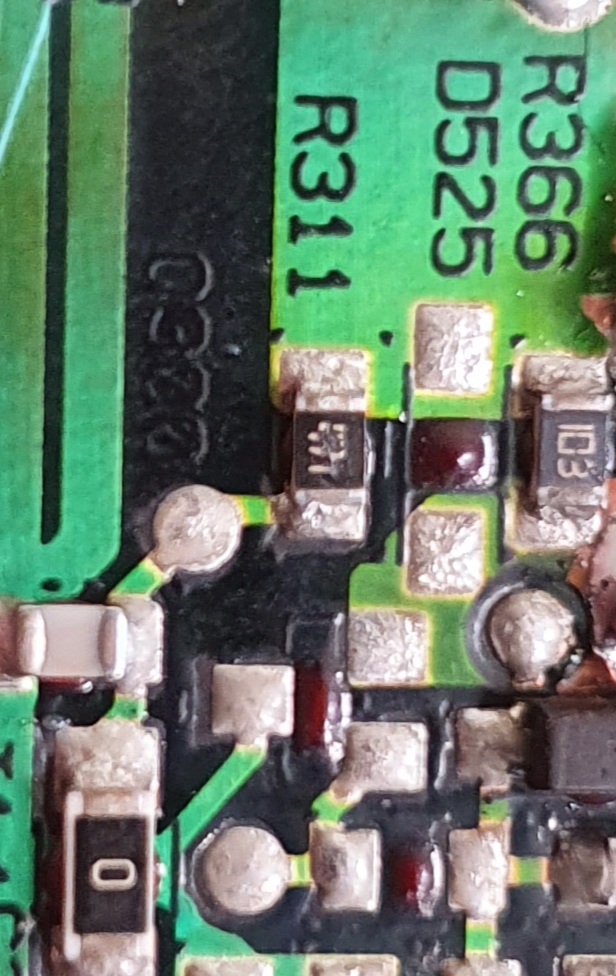

                                • worlor
                                  • Oct 2020
                                  • 28
                                  • France
                                  For R311, i measured 48 Mohm, I think it's dead too.
                                  But I can't see the value on it :/
                                  It seems it's a 470 ohm, do you think it's correct ?
                                    R311 seems to show 471 (470Ω) If R320 has a chunk missing it is likely open and if there are any diodes across it (D512,D513) they are likely shorted.
                                        17IPS20 Power Board Presentation : https://yadi.sk/i/FUHv-yP4doTRvw
