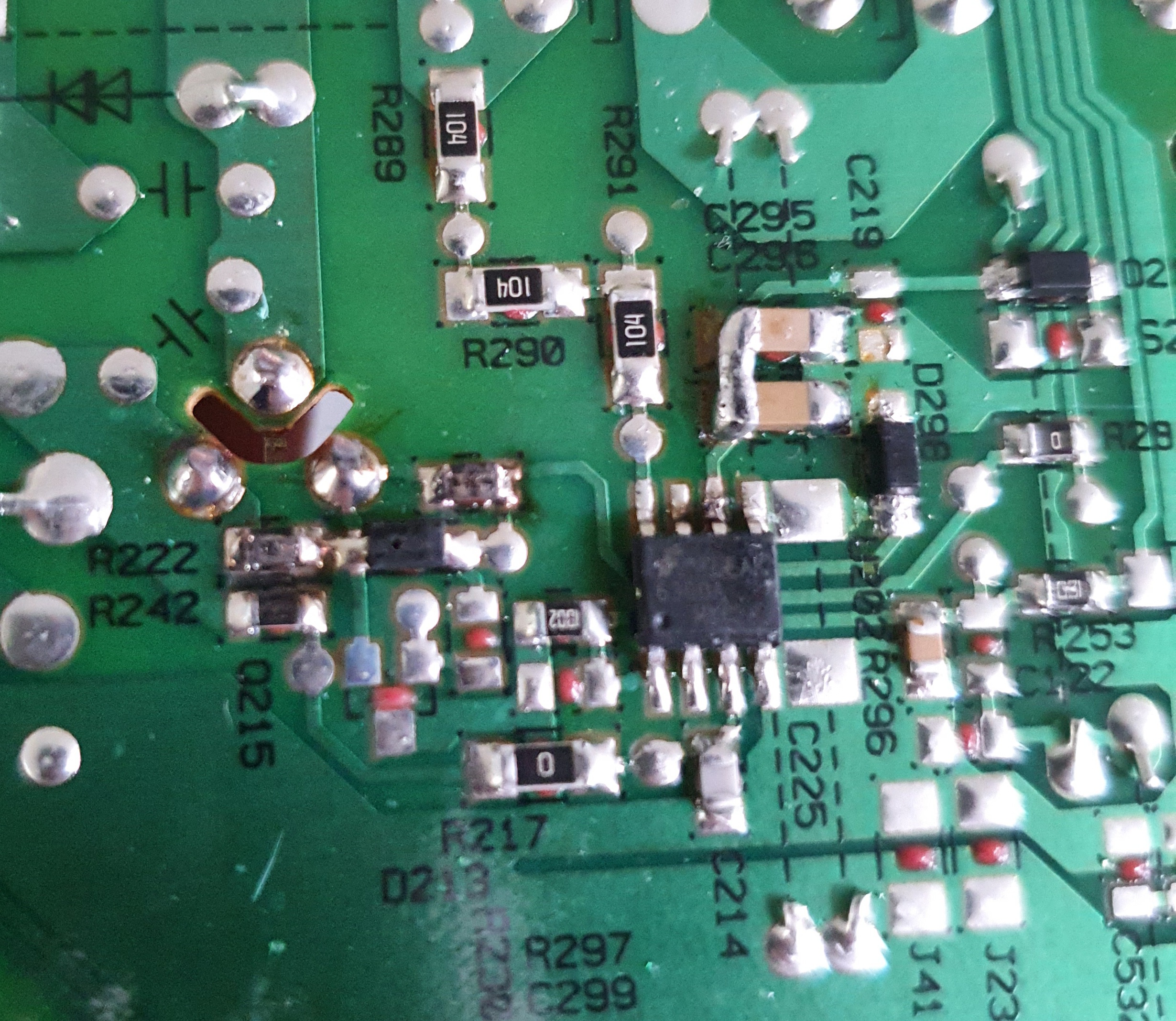

    Some bad news today
    I have replaced Q216, Q211, R320 and I tried to measure voltage on VDD on U202 but I have short-circuited with pin 7 and it burnt 3 resistance and 1 diode.
    I can replace these but how can I know what impedence should i use ? I can't see the number on the burnt resistance (see picture)
    Any ideas ?

      Re: Bad Vestel 17IPS20 : shortage, need help
      I suggest you get the schematic for your main board and check the parts on it with yours and the values.
        I have the schematics, I have posted it on first post. But the schematics haven't the same values than on board :/
          I don't see you getting the values here I would suggest getting a replacement psu unless you took pictures with your camera of the parts before you damaged them.
