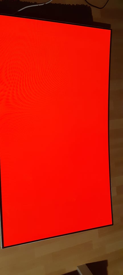

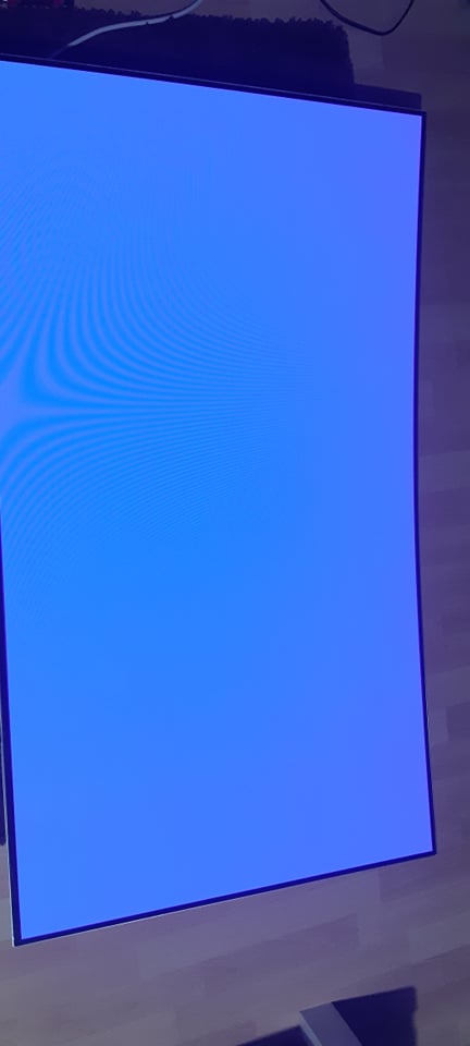

      • dominik0801
        • Feb 2018
        • 98
        • Hungary
        Re: LG 55EG910V OLED TV clicking
        Here are some of the TCON test pattern colors however, so you can see, that the screen and TCON seems to be perfect. Also, since it turns on to play this little test pattern, it means that the PSU should be fine, am I right?

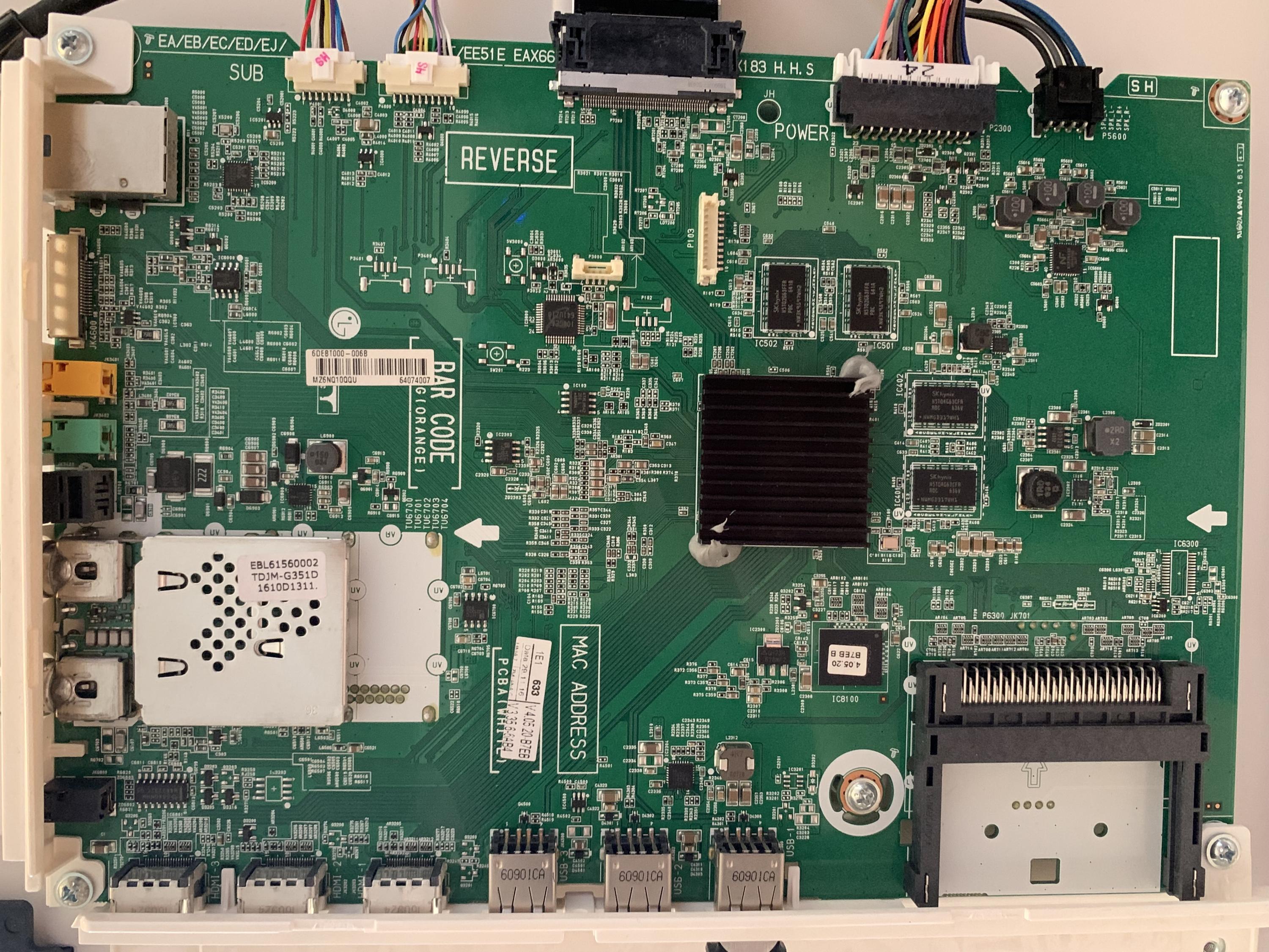

                          upload clear focused high resolution photo of your mainboards. check if you can see micro switch on it MICOM reset. if it exist need to press it keep press and plug it in to reset micom chip
                          also if it response to RC on off. try send within service RC IN_STOP followed with code 0 4 1 3 to make hard reset.

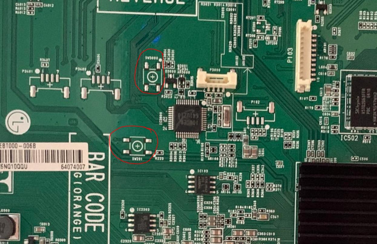

                            • lotas
                              • Jan 2016
                              • 4905
                              • Russia
                              Originally posted by SaiBot187
                              I tried IN_STOP followed by 0413 with LG service remote app on a samsung S6 but TV does nothing. On MB i cant find any switches. Is there anoter way to reset MICOM? Do you think i should try resolder MB or is it useless?
                              Here are two pads for buttons that are not on the board.
                              You need to know exactly which one is responsible for the reset.
                              • SaiBot187
                                • Mar 2022
                                • 17
                                • Deutschland
                                Okay and the reset only press in standby or while i switch tv on?
                                • Diah
                                  • Feb 2013
                                  • 6613
                                  SW3000 are micom reset.. but yours MB design ignore this function as you have only 1 LVDS not double.
                                  disconnect this LVDS and turn on see the optical if it come on... you can plug USB or mouse to see if the mouse IR LED turn red. we need toknow if the 5V exsisit or not
