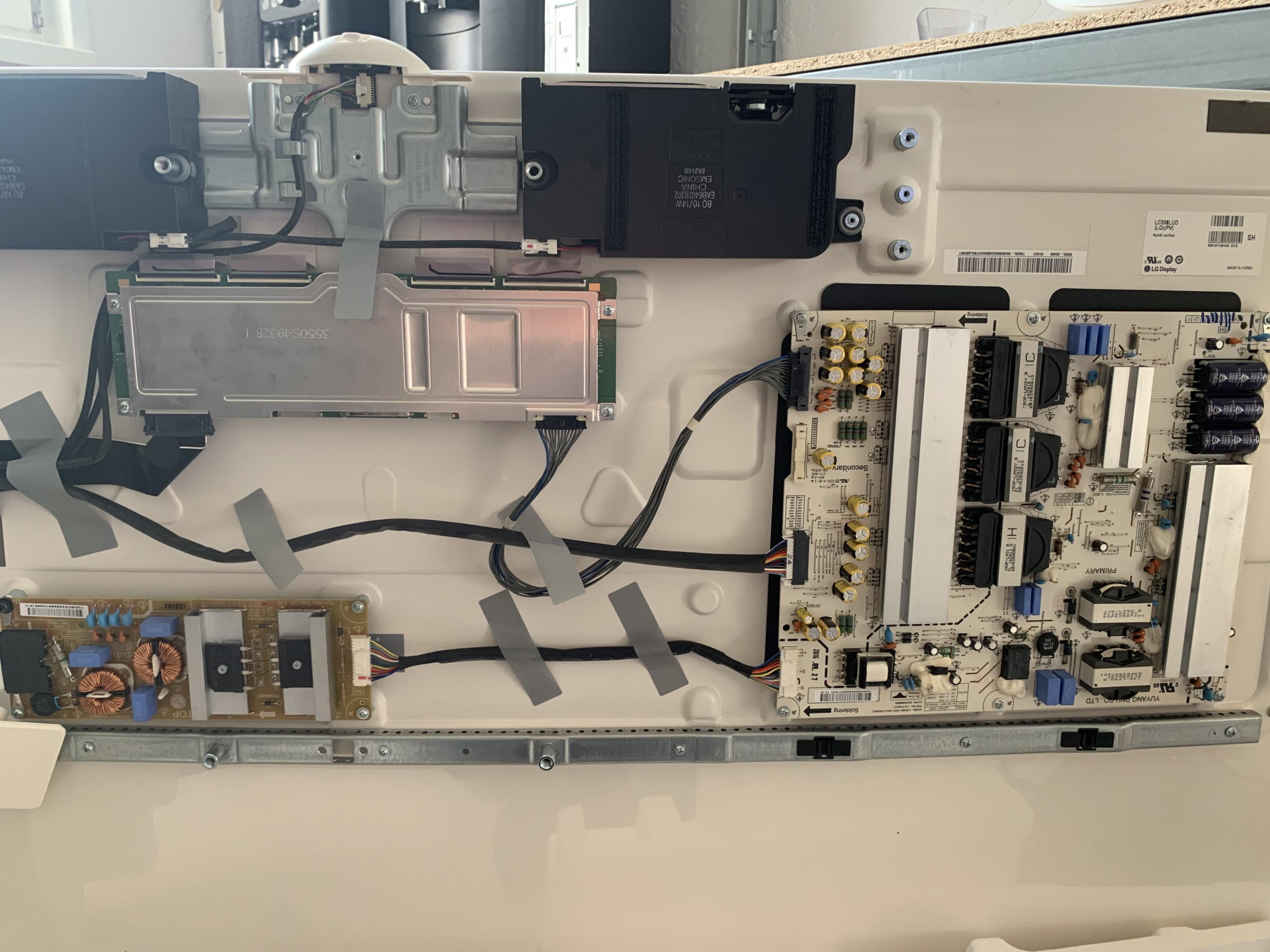

        I plugged in a cable mouse but only a short on/off of red light, every time i plug it in

            Re: LG 55EG910V OLED TV clicking
            did you disconnect the LVDS cable at this test ?????? if no then you need to do it..
            also plug out the socket of WLAN and speaker from MB
              Yes, i disconnected wifi,speaker and LVDS. plug in cable usb mouse but exact same behavior... 2 times relais clicks on/off and at 3rd time it stays on

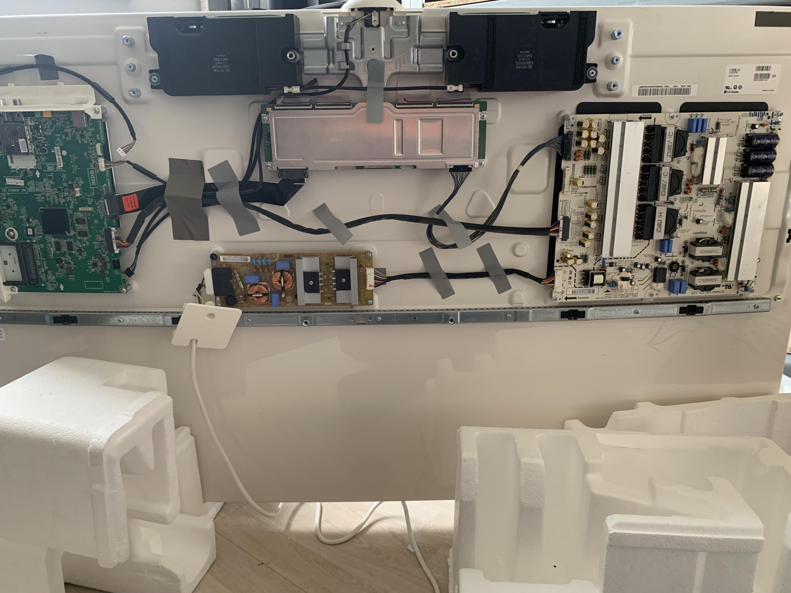

                ... hold down
                PCB relay click on and then off and then ON ?? show please yours PCB and the T-CON wiring

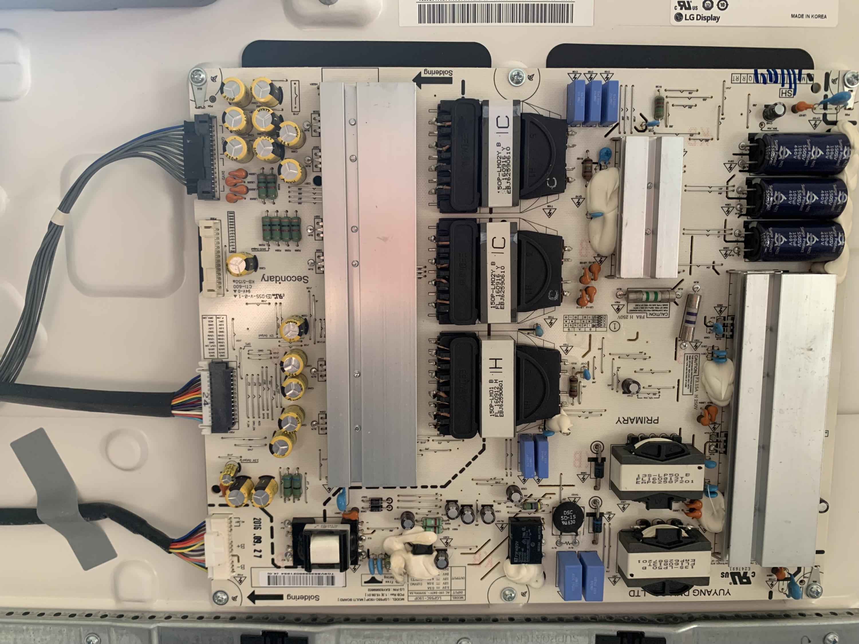

                  Yes, the power board relais clicks on/off/on/off/on and then stays on with all voltages but drv_on
                    alle connector LVDS cable bring them as they schould only the the socket at the PCB 24V which go to T-CON driver boards disconnected it from PCB side... turn on and check the relay click and the optical ... mouse etc. ( screen of course will be black )

                      #30
                      exact the same... relais click, no optical, no mouse

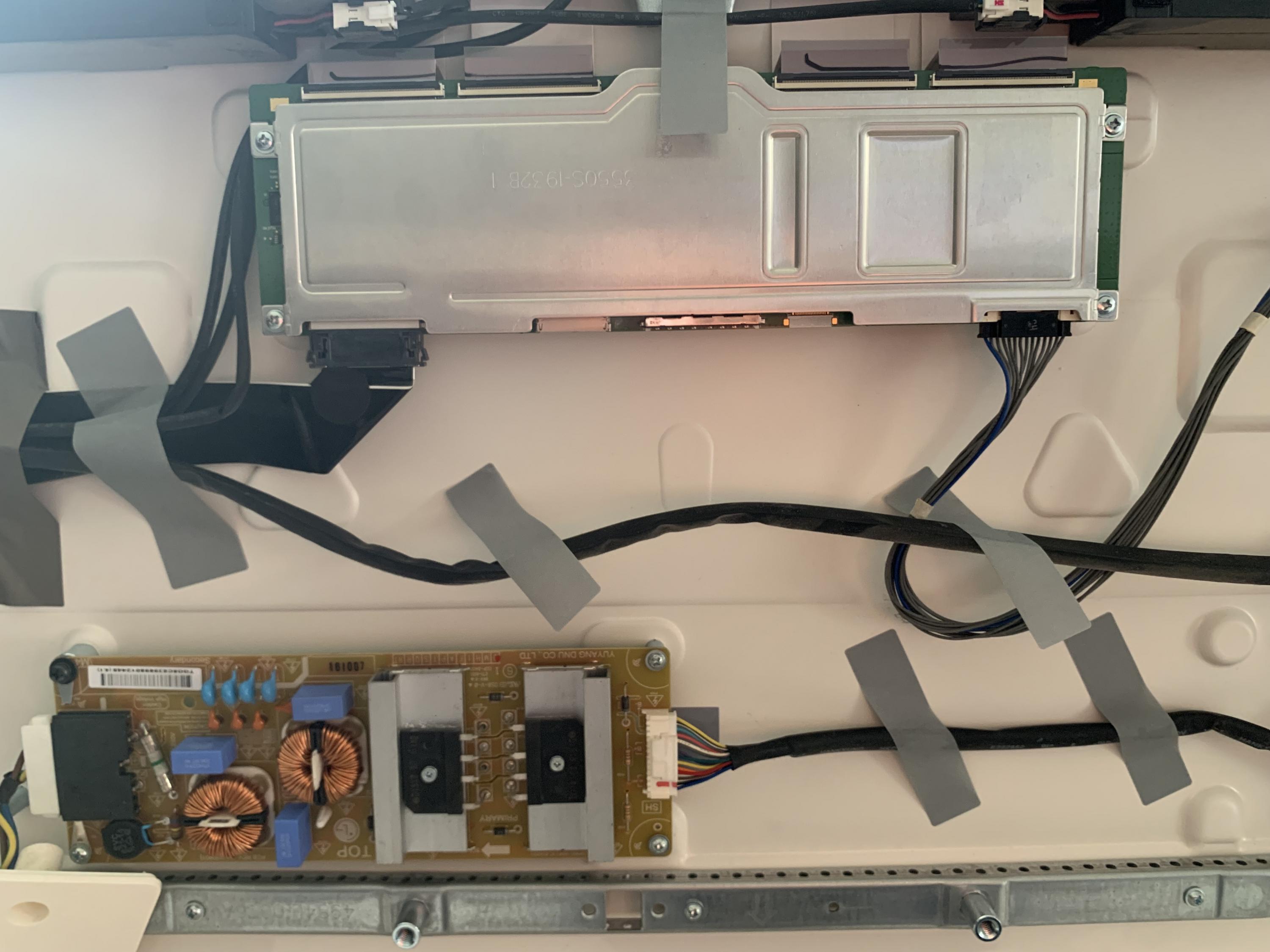

                        LOL.... wait... where are the cable of the T-COn 12V between the PCB and the T-CON driver boards... ???????

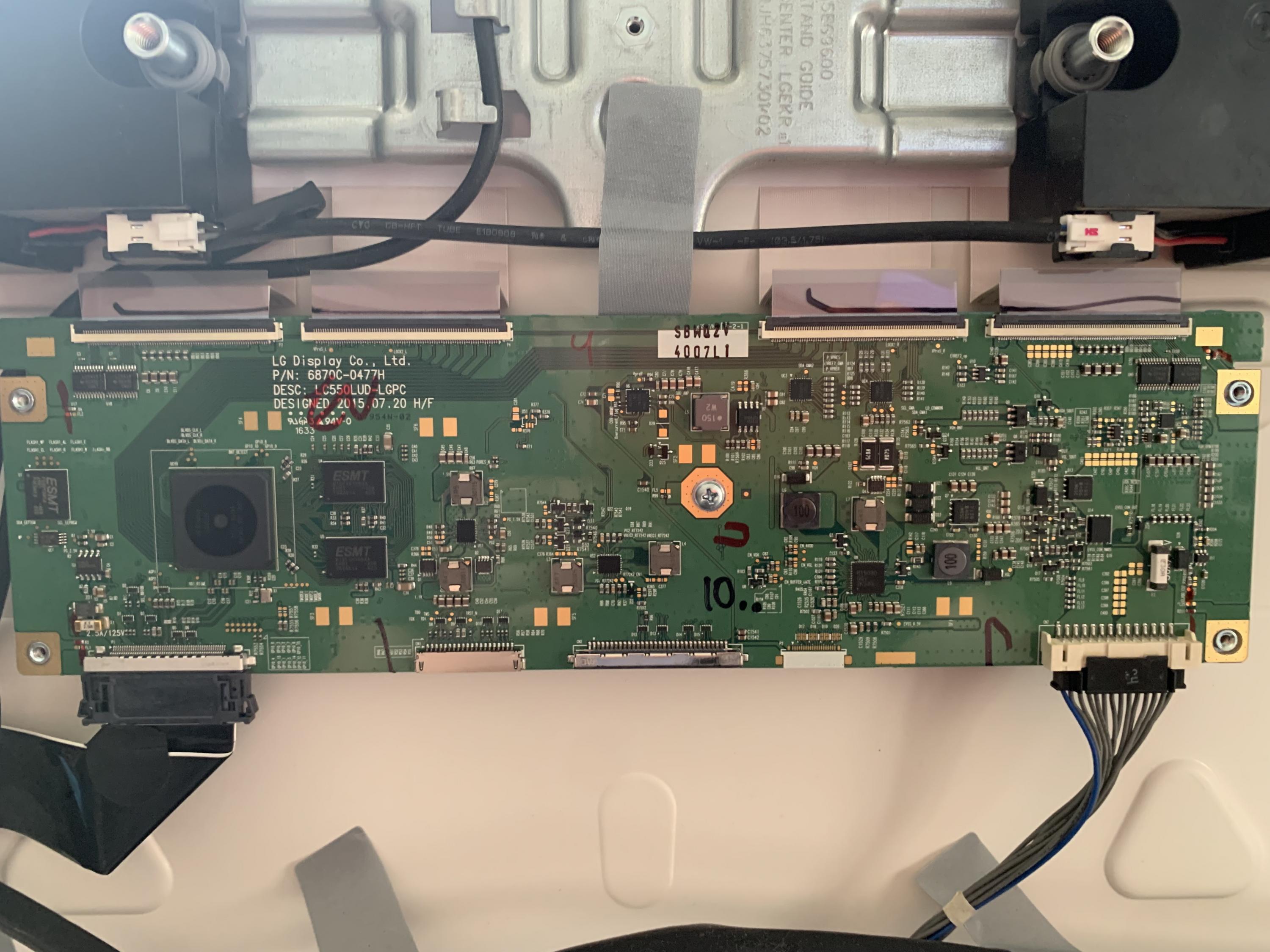

                          remove the heatsink of the T-COn and show here close photo
                            there was no cable
                                TCON left fuse F1 i got 12V from MB
                                  so the t-con recieve the 12V from LVDS... did you have 12V when you turn on on the T-CON F1 from both side?
                                    yes
