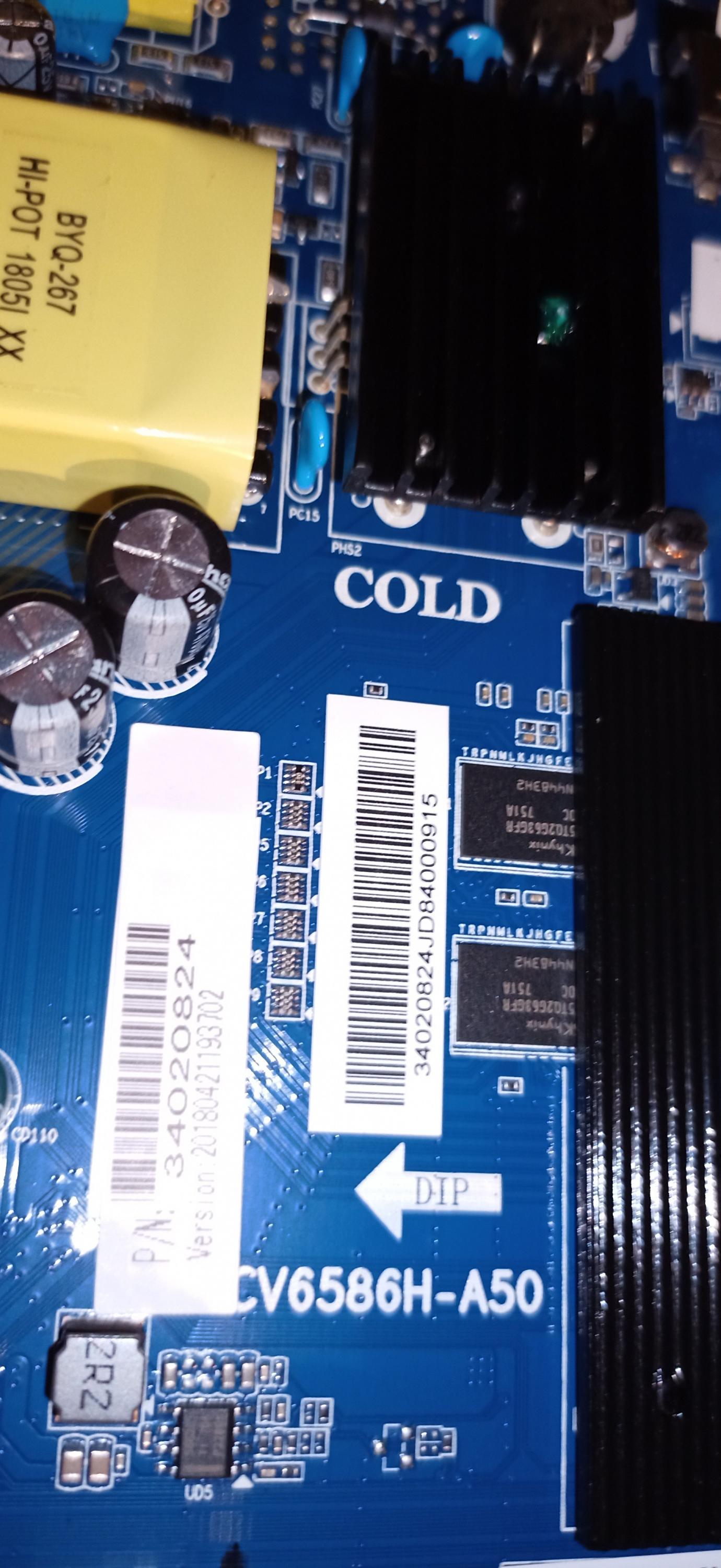

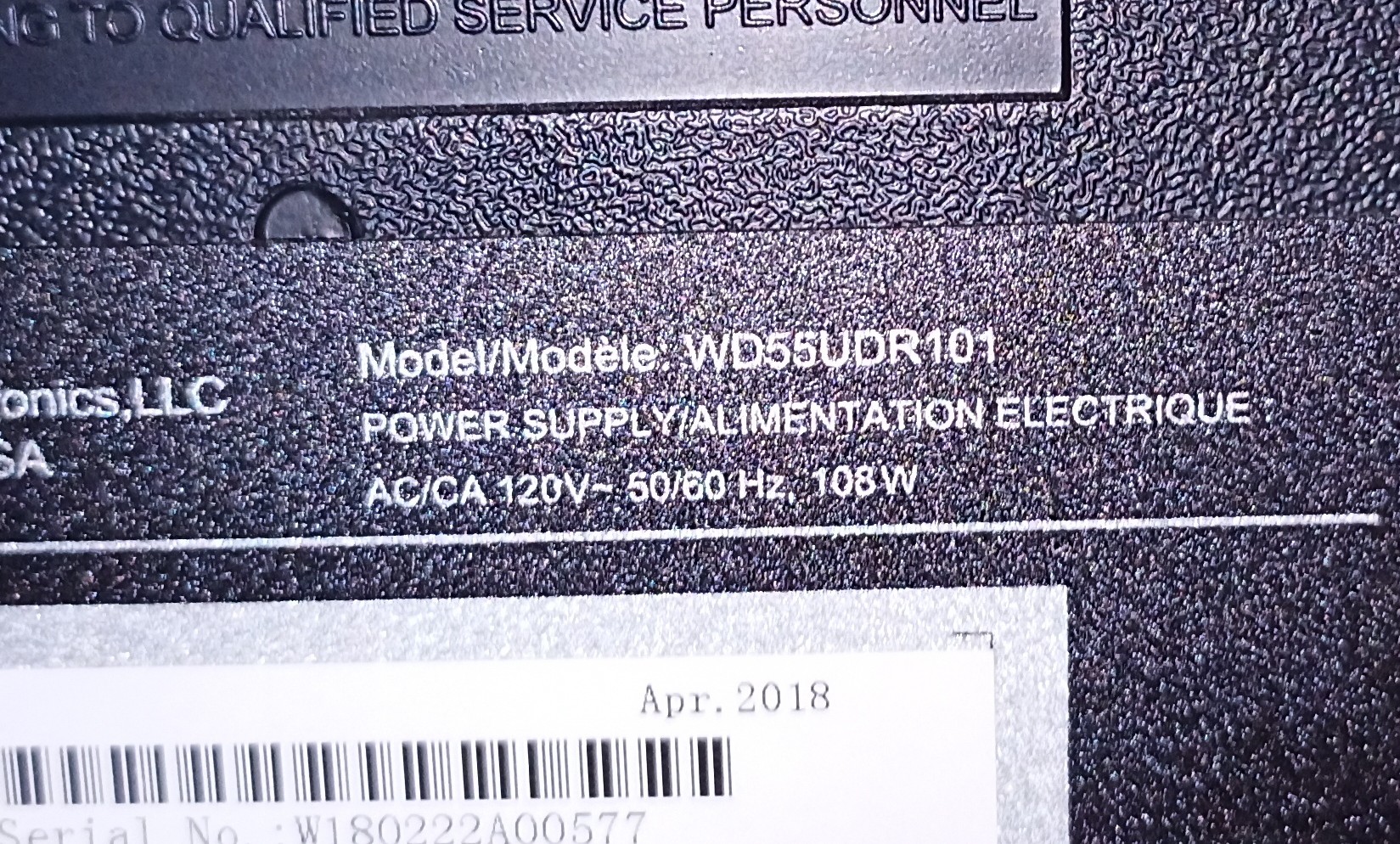

    Model WD55UDR101. I believe this was sold at Canadian Tire here in Canada.
    Want to limit the current to the leds - the standard Picture menu is useless for that. Trying to find it in the service menu before doing a hardware mod.
    Anyone know how to enter the Service Menu on this set or even other Westinghouse tv's ?

    Tv label and main/power board sticker.

    • Diah
      • Feb 2013
      • 6494
      Re: Westinghouse Service Menu ?
      search after Chinese main boards all in one service menu. like JVC too... you could also find at service menu the solution of yours other thread no speaker
        Try menu-0-0-0-0 source-2-5-8-0 or menu-1-1-4-7
          I believe I've tried the last two will try the first soon. Thanks.
            Was thinking that's a possibility will of course check it out if I can get into the service menu.
              Winner winner chicken dinner!
              Menu-0-0-0-0. Thanks neilc6.
              I haven't went through all the settings yet but what's better (or what's the difference?) between eeprom_init and factory_reset ?
