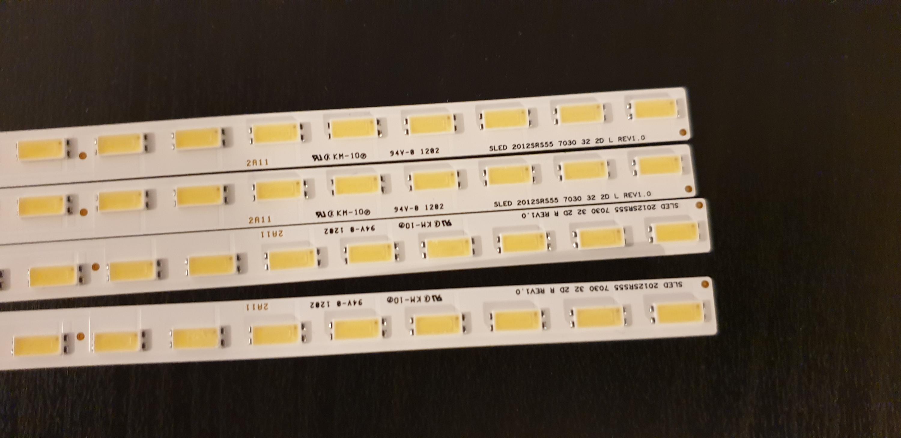

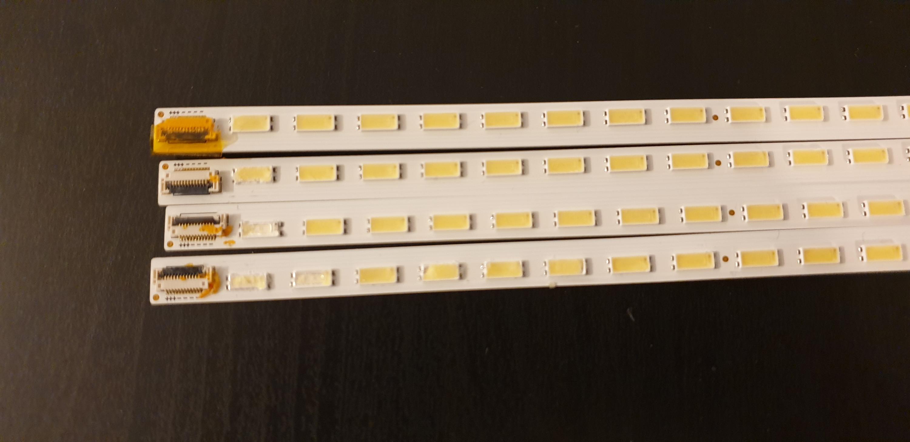

                            So I got some time today to dissasembly it...
                            It was a nightmare, but I got the 4 led strips. One led was down.
                            But during disassembly of each, the first led self destruct itself (sticked to one of the reflector layer). When testing the first led never light up (I suppose broken during disassembly) but every other do... except one lost in one strip, it sure be defective befor I didn't touched it.
                            I'm ordering all 4, I hope I didn't destroyed any other thing (I reassembled it without screws and it seemed ok, even the picture seems ok but not sure if there is any lines... I will see.)
                            Thanks.

                                Re: SONY KDL-55HX850 : No backlight, no error code, rest OK
                                Can we see the LED strips?
                                What did you use to power up the strips? So how many strips are bad? Two?
                                BTW, pin 1 Voltage which is the Boost Voltage sensing pin to make sure the PFC Boost Voltage is not too low, it should be > 2V on that pin 1, at 0.1V it thinks that the PFC Voltage is bad so it will stay in protection mode.

                                  #36

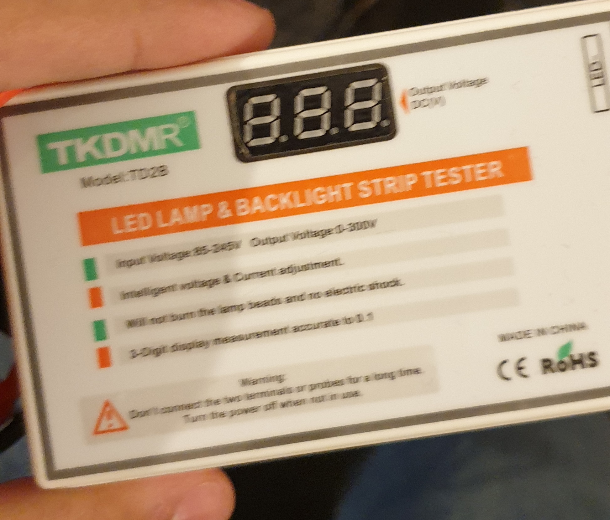

                                  Here are the pictures of the led strips.
                                  All 4 are defective now (the first led was "sticked" to a plastic reflector, maybe by heat...
                                  I got a led tester. I put LED + to one of the + of the strips, and with the LED - I go to all - of the strips, each - illuminate 8 leds.
                                  Just one led was already defective it seems, looks cracked. By disassembly it I certainly broke the first leds of each 4 because they were sticked to the reflector, IDK why, there isn't tape.

                                    #37
                                    i don't think its your fault... because heat and the reflector very close to leds surface. just dont forget to clean the edge of the reflector to have clean display..before 3year or more i had got this edge 7030 led. i removed them all with heat gun and placed pasta then stick new ones after all are in place and straight i applied the heat from downside of the strips so all got in place with good middle ground contact.. on aliexpress i got them 100 pieces for about 5$
